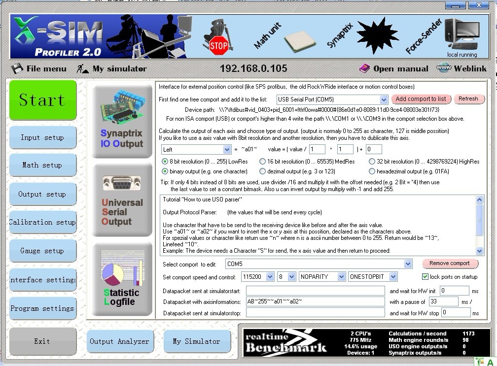

    but the G27 axis can not output .....
    I use AMC1.5. DSMhb1.2b. worm gear motor

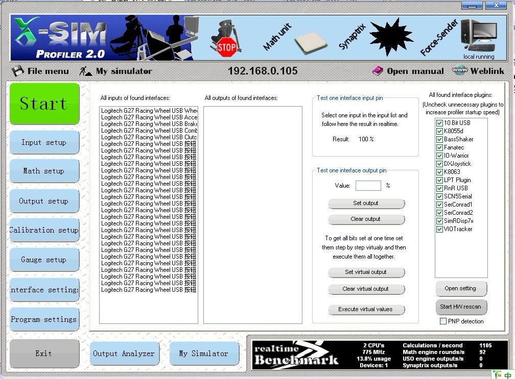

    My g27 steering wheel throttle ..... axis movement. Motor no movement ...
    xsim 2.0.8.9 and xsim 2.0.1.3 axis can not output. Search not see any axis outputs.
    Datapacket with axisnformations: AB ~ 255 ~ ~ a01 ~ ~ a02 ~?
    IRFZ44N IRLZ44N work the same?
    I use IRFZ44N. How can I do? Please help me!
    connect Start.
    move the slider left and right.
    two motor motion ..
    but the G27-axis motion.
    two motor no motion.
    x-sim search no output axis.
    Can you give me x-sim set pictures and x-sim set video it?

    connect Start. move the slider left and right. motor motion .
    but the G27-axis motion. motor no motion. x-sim search no output axis.
    I use z-tek ZE533:Chip FTDI-FT232. Support serial.
    Support RS232. Support automatic handshake.

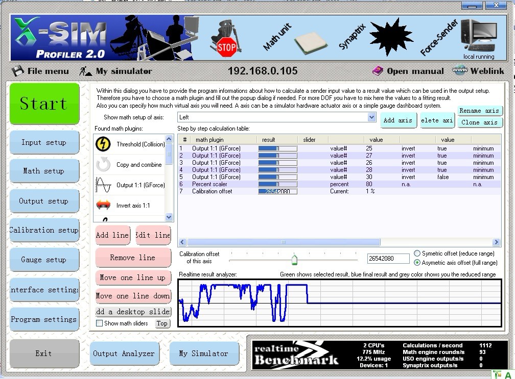

    Thank ua6aak sharing! Download the game in the settings file ua6aak_RBR.rn2.
    COM5 port set printer support.
    run Force-Sender try send data.
    Force-Profiler load file ua6aak_RBR.rn2.
    Set COM5 port.
    Start ......
    Click Math setup calibration offset of this axis.
    two motor motion ...
    but the G27-axis motion....
    two motor no motion....
    Where the error?
    Can you give me your set picture or set video?
    Thanks!!! Please help me!

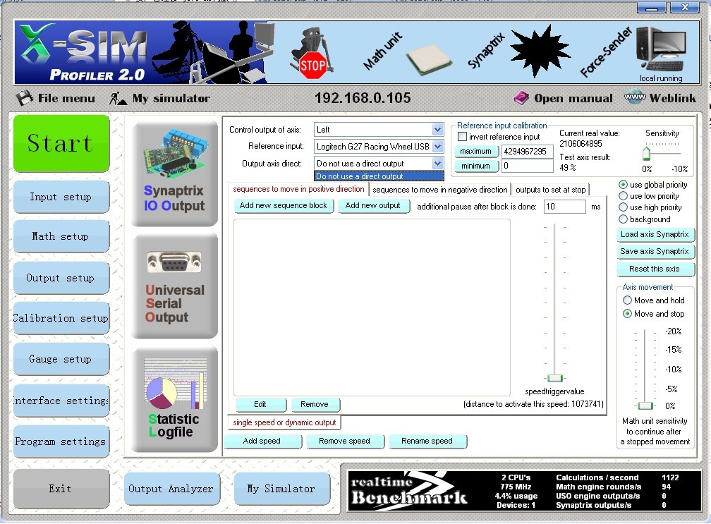

  8. Hardsteel73
    Hardsteel73 Hardsteel73
    Nov 28, 2011
    53
    Self employed
    bergschenhoek
    162Coins
    I had the same problem. I had the 24 crystal with 18 pf. Changed to 18 mhz and 22pf. Disconnect h bridge. Clean the back of yuor board with paintthinner. Because the slack of welding can cause a short circuit. Also look if no mistake is made with welding. Then star force sender with testplug in. In profiler make two axis and in uso do the com port and AB a01 etc
    Then it worked for me
