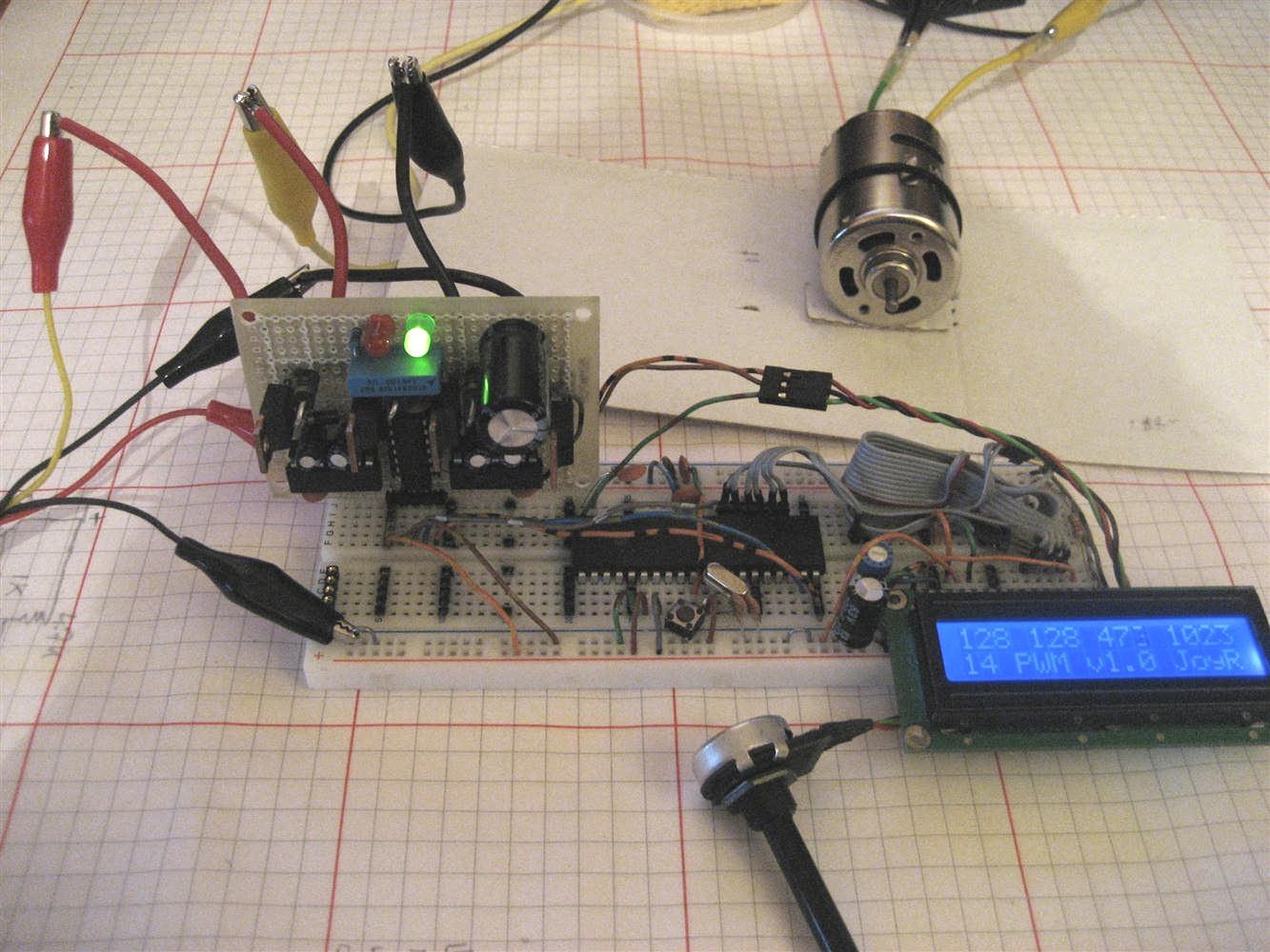

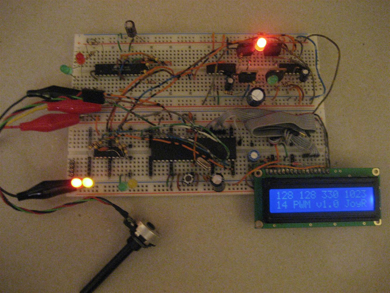

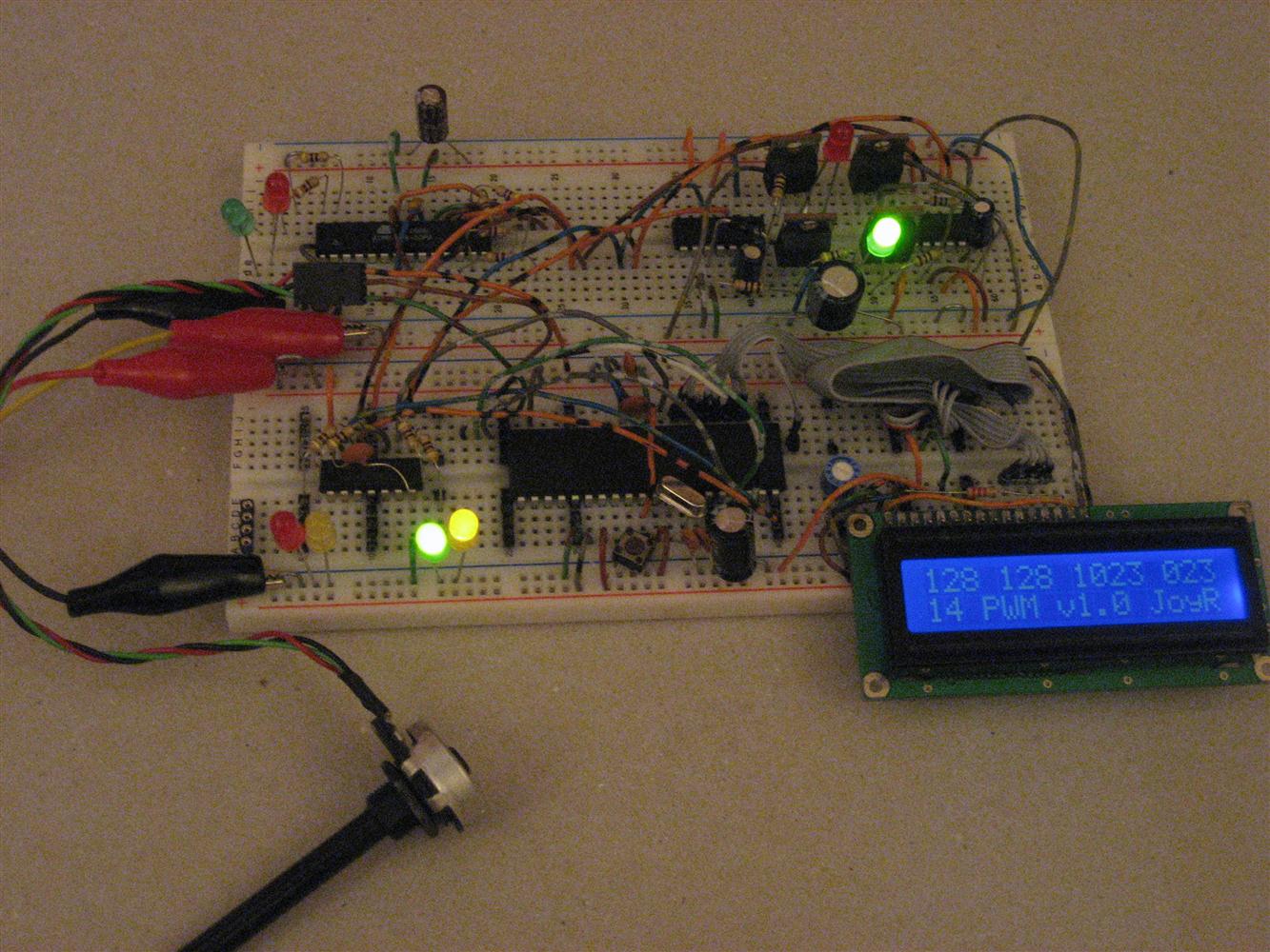

    Just a little update:
    I put together the AMC and the H-Bridge for proof of concept. The digital circuitry and the IR2110 control logic is running off of 5V, the H-Bridge and gate driver part is taking 12V from a small 2A PC power supply. Everything went just as I expected, so it is great success! :thbup:
    Top right is the H-Bridge, red and green LEDs show the direction and speed of the motor by changing brightness.Bottom middle/right is the AMC, bottom left is the AND gates, part of the H-Bridge circuit.
    The 4 LEDs show the states of the MOSFETs (ON/OFF). Red and Green is the two bottom ones, the two yellow beside are for the top MOSFETS across them.
    I changed the circuit just a little bit around the AND gate. The new configuration turns the bottom transistors ON and pulses only the top one across it, instead of pulsing both at the same time as in the original DSMhb. This reduces switching losses, improves efficiency and makes the PWM more accurate in the case there are switching delays of the top and bottom sides.

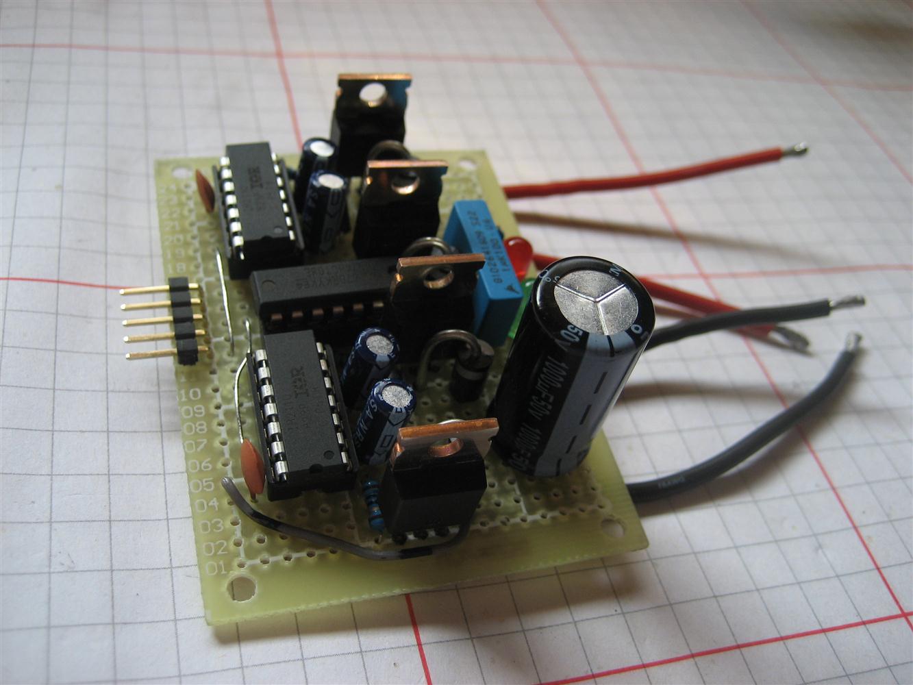

    First prototype is ready to be tested. :clap:
    I just ran some initial testing, after re-soldering some misplaced connections everything was fine!
    Have to install some cooling fins, bullet connectors and the fuse still.
    I'll take some scope shots when I get a chance, and also get a REAL DC motor! :cheers:
