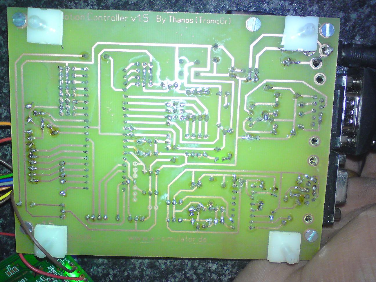

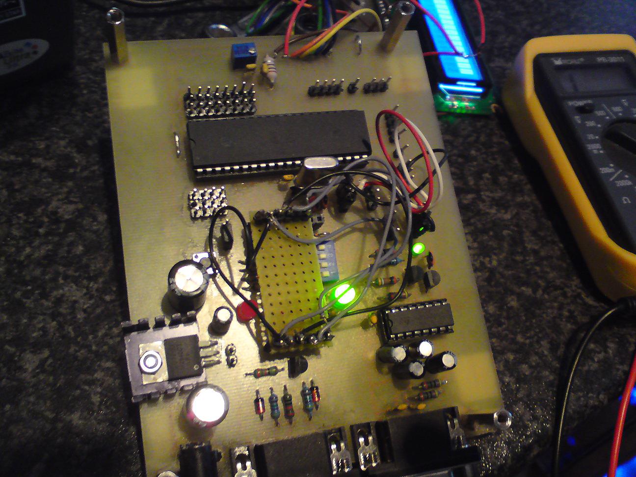

    I know i'm almost there, but there seems to be a problem with recognizing the atmega 8535.
    Everything goes well untill I click the read-button. The red led is on while attempting to connect
    to the amc, then I get the message missing device or unknown device -24.
    What can this be? Is it a bad connection on the amc?
    gr. Jeroen

    Re: missing device or unknown device -24
    It is most likelly a cold solder spot, a shortcut, or a backwards placed part. Or perhaps the wireing is wrong. Please make high res pics of your AMC (both sides). Use a scanner if you have one available.
    regards

    Here are 2 pics of the amc1.5...

    I had the same Message with my ATMEGA. Did you try a another Crystal?, which Crystal are you using?. For example my ATMEGA wont work with a 24MHz Crystal, so i downgrade the Crystal to 22,18 MHz and it had worked. But you must use the correct firmware for each Crystal ;) .

    Tried all 4 crystals. Same message.
    Can it be a software problem?
    gr. Jeroen

    Ok... re-installed xp 32 bits on my old computer. I installed the converter software and ponyprog2000. All went well...
    I plugged the amc1.5 in and tried to read out the atmega. No succes... Still getting the
    device missing -24 error.
    Both chips are powered... measured the pins.
    What to do now? Does this mean that it is a hardware problem?
    gr. Jeroen

    The atmega8535 was broken. Got a new 1 and now everything works ok. Installed the 22mhz hex file.
    Program succesfull.
