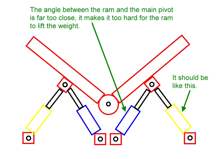

    I am a member of the forum, and have been observing all the interesting things that so many invent. I want to thank the creator this incredible software, X-SIM. I also would like to take a moment to say that Thanos work has been an inspiration, he is obviously an expert. I would like to humbly post a few pics of my beginning stages of my flight simulator :blush: . I will continue documenting my progress as I go. Any suggestion for improvement is welcome, I am new at this. Regards to all. :hi:

    Do you have an idea about the motors already? I guess you will need much power to move your construction.
    Thanks for looking at my post, and moving my thread to the appropriate forum section.
    I plan on using pneumatics to move the beast:
    80 mm Festo cylinder
    3/8 mid-closed valves (for pitch)
    50 mm Festo cylinder
    1/4 mid-closed valves (for roll)
    I have done some preliminary tests, and the pitch moves at 2 bars very easily.

    Hi Aviomsim.
    I have just seen the photo's of your Sim and noticed the angle the rams are mounted on in relation to the main pivot point. With the angles so close it makes it very hard for the rams to move the weight of the Sim, because there is no mechanical advantage, so if it is having trouble moving the Sim once all the extra weight of the seat, controls and the Driver are fitted you will have to move the bottom mountings of the rams out from the centre of the Sim so they are more at right angles to the main pivot point
    Regards Senetor.
    Your configuration is correct ....but Im my design the cylinders are so powerful, I can move the all structure with 2BAR...Thank you for take look ...... :highfive:
