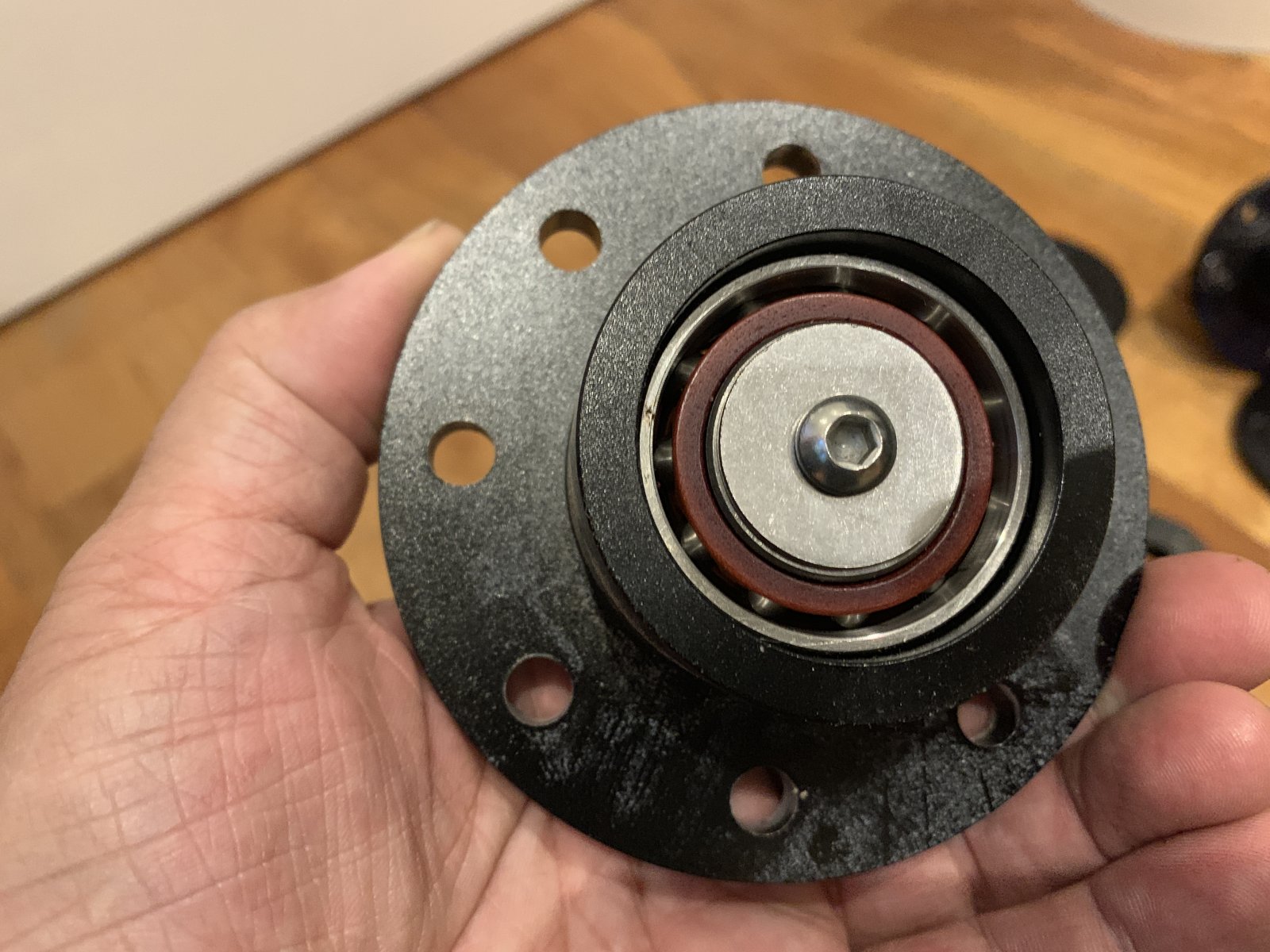

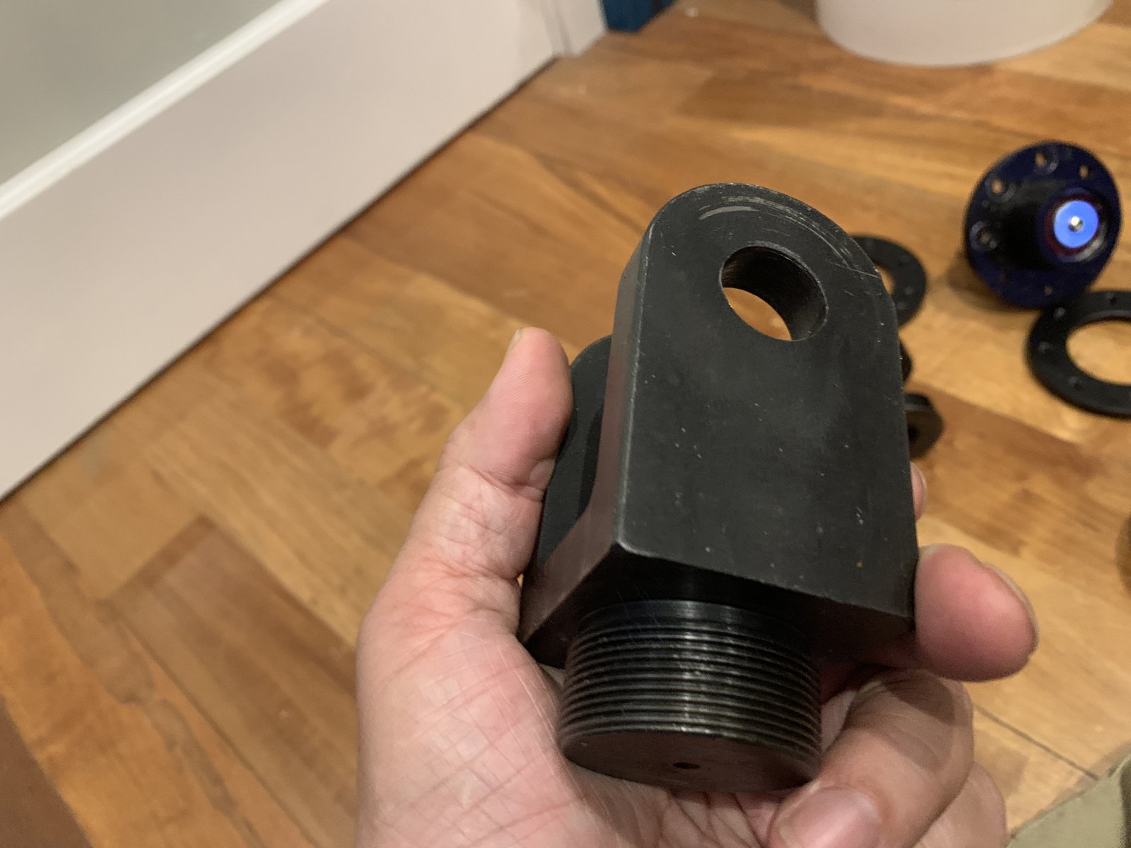

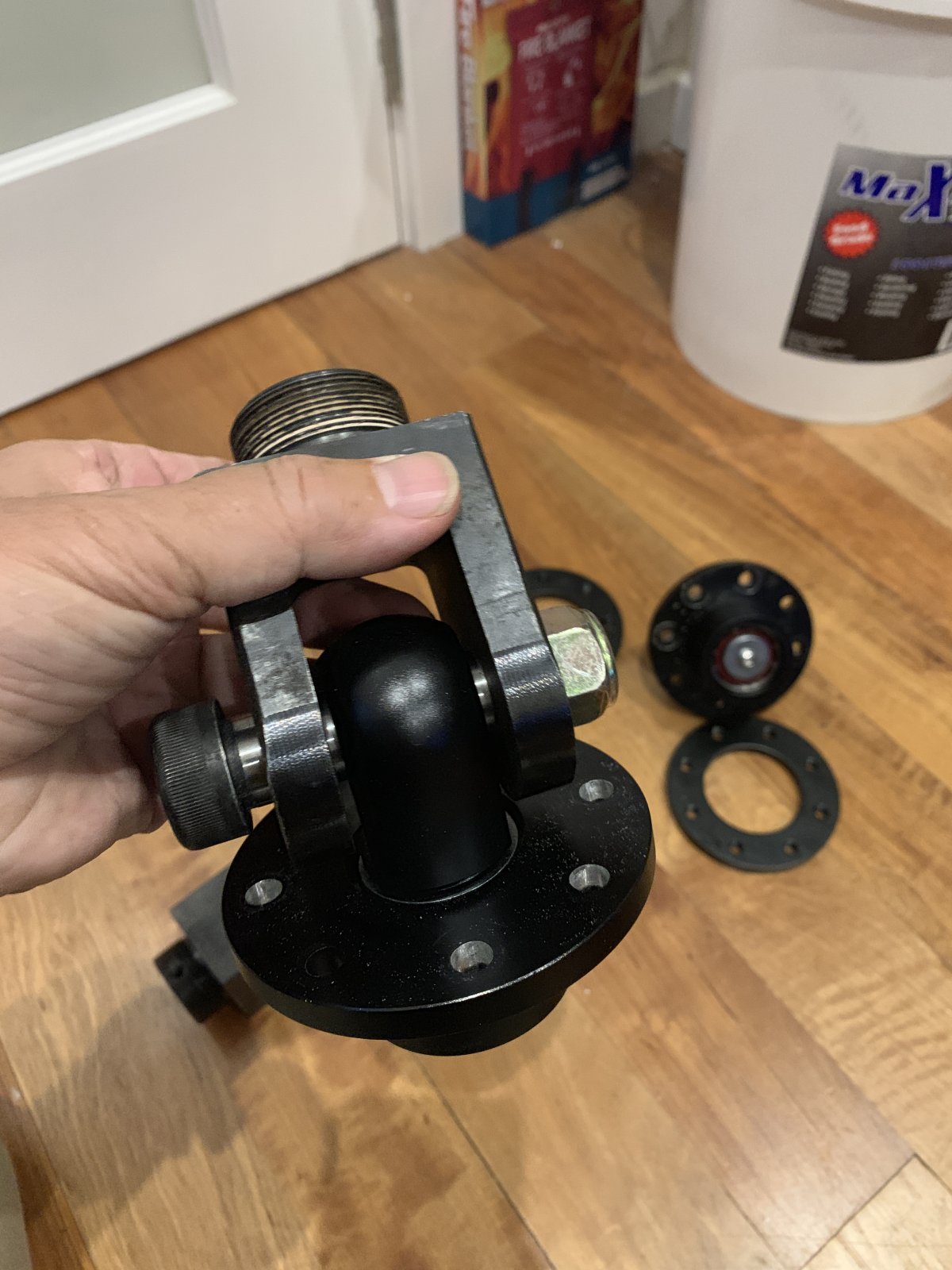

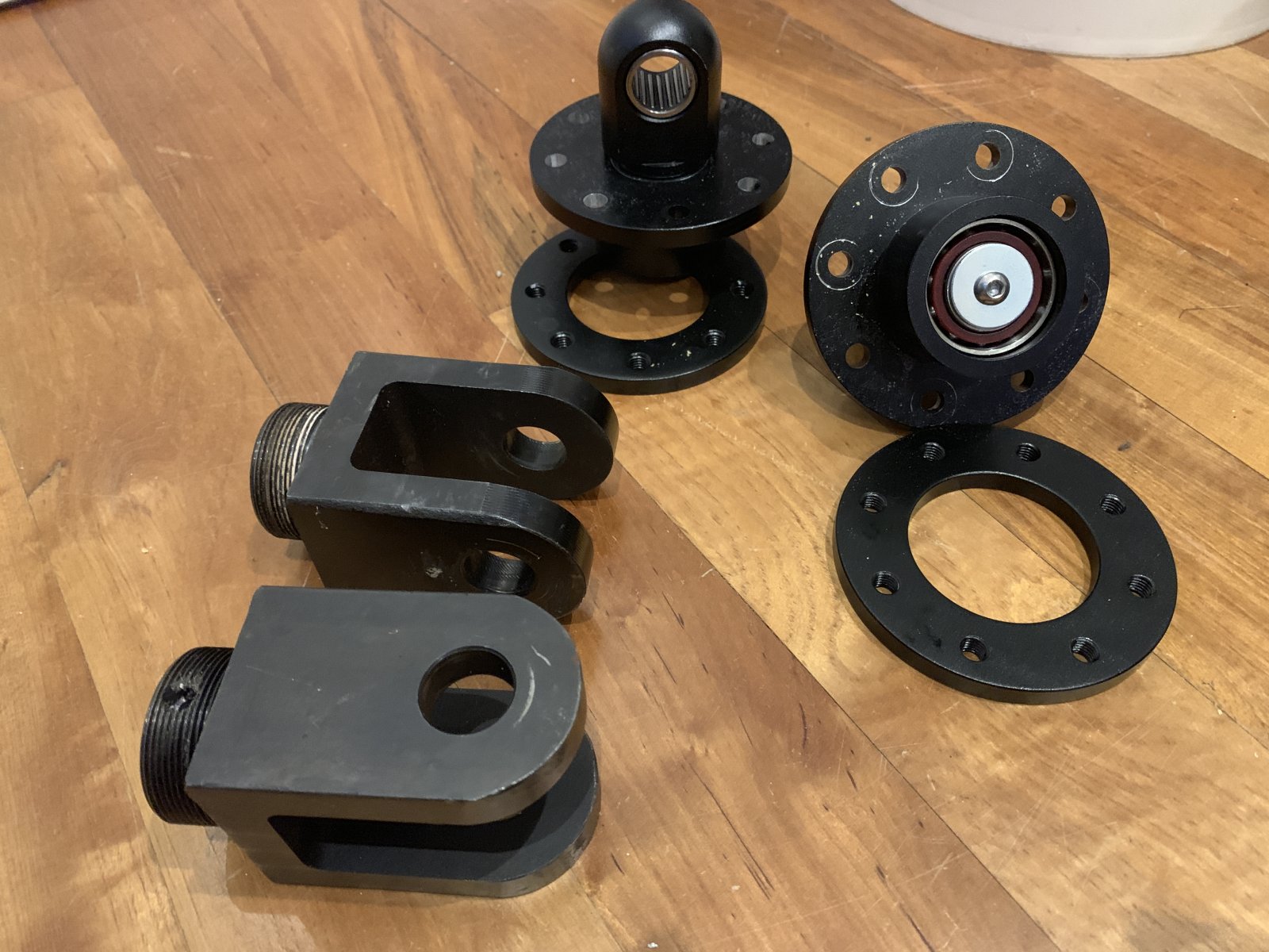

    Motion platform, 6DOF
    I developed some universal joints last year based on the Chinese style platforms I'd seen. These are 6061 grade aluminium, with dual thrust bearings and they attached to each end of my large linear actuators.
    I have since developed some others, so these are now for sale, preferably to someone in Australia.
    I have 12 bearing sets
    Material: 6061 Aluminium
    Bearings: 12 pairs of dual angular contact bearings (20 x 42 x 12mm)
    Bearings: for actuator top end 20mm x 26mm x 30mm needle roller bearings
    Pins: steel 20mm x 65 mm shoulder bolts
    I can supply exact tech specs if required.
    Screw in actuator top x 6
    Teflon spacer washers x 24
    You will need to provide a "fork" for the bottom end of your actuators.
    My total investment in these was about $950USD or about $1380AUD
    For the geometry of my Stewart platform (very upright legs), they had slightly too much slop/tolerance for me, so I developed a whole new yoke & trunnion style of U-joint to replace them.
    Happy to answer questions and/or take best offers for these.

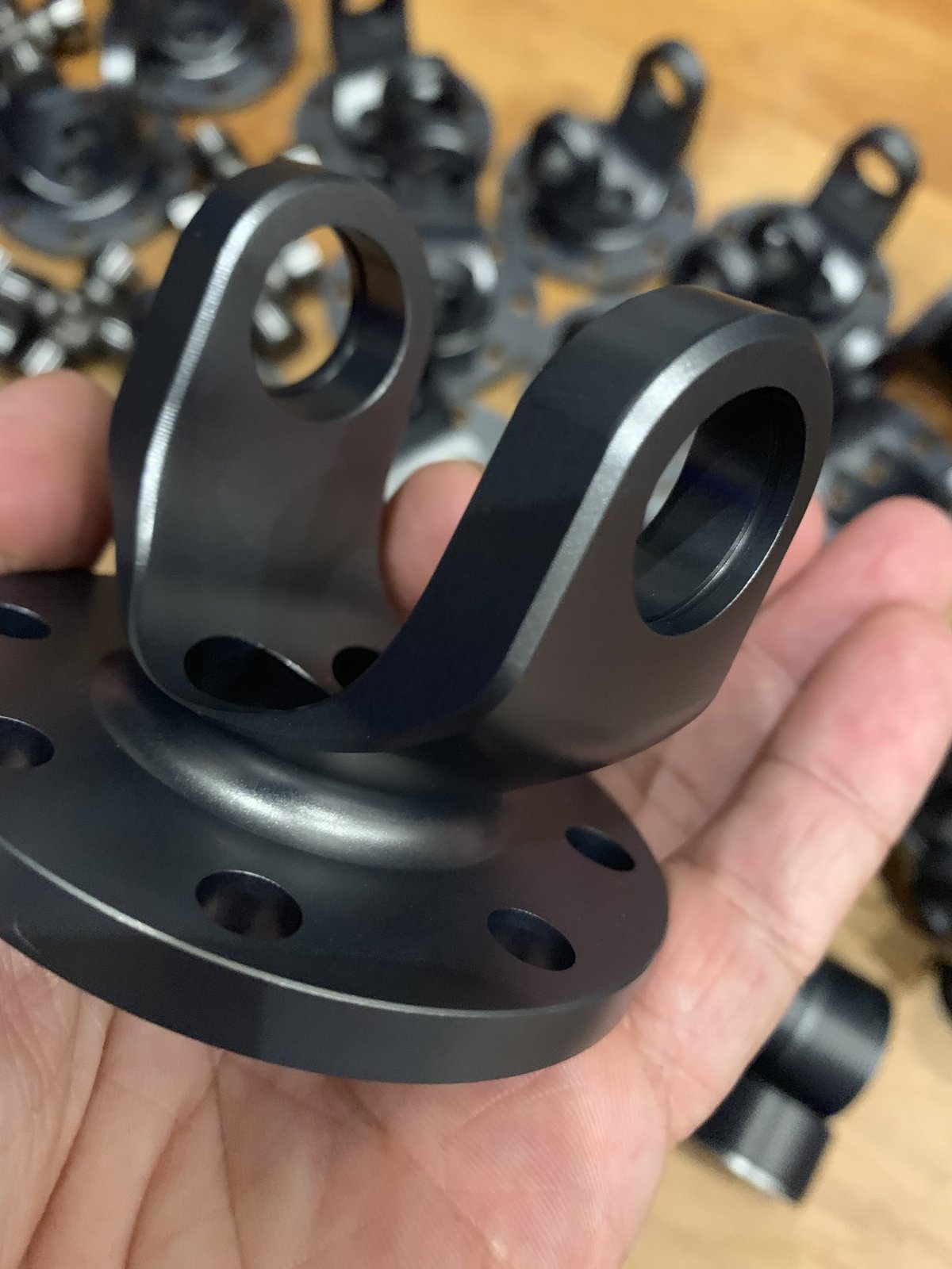

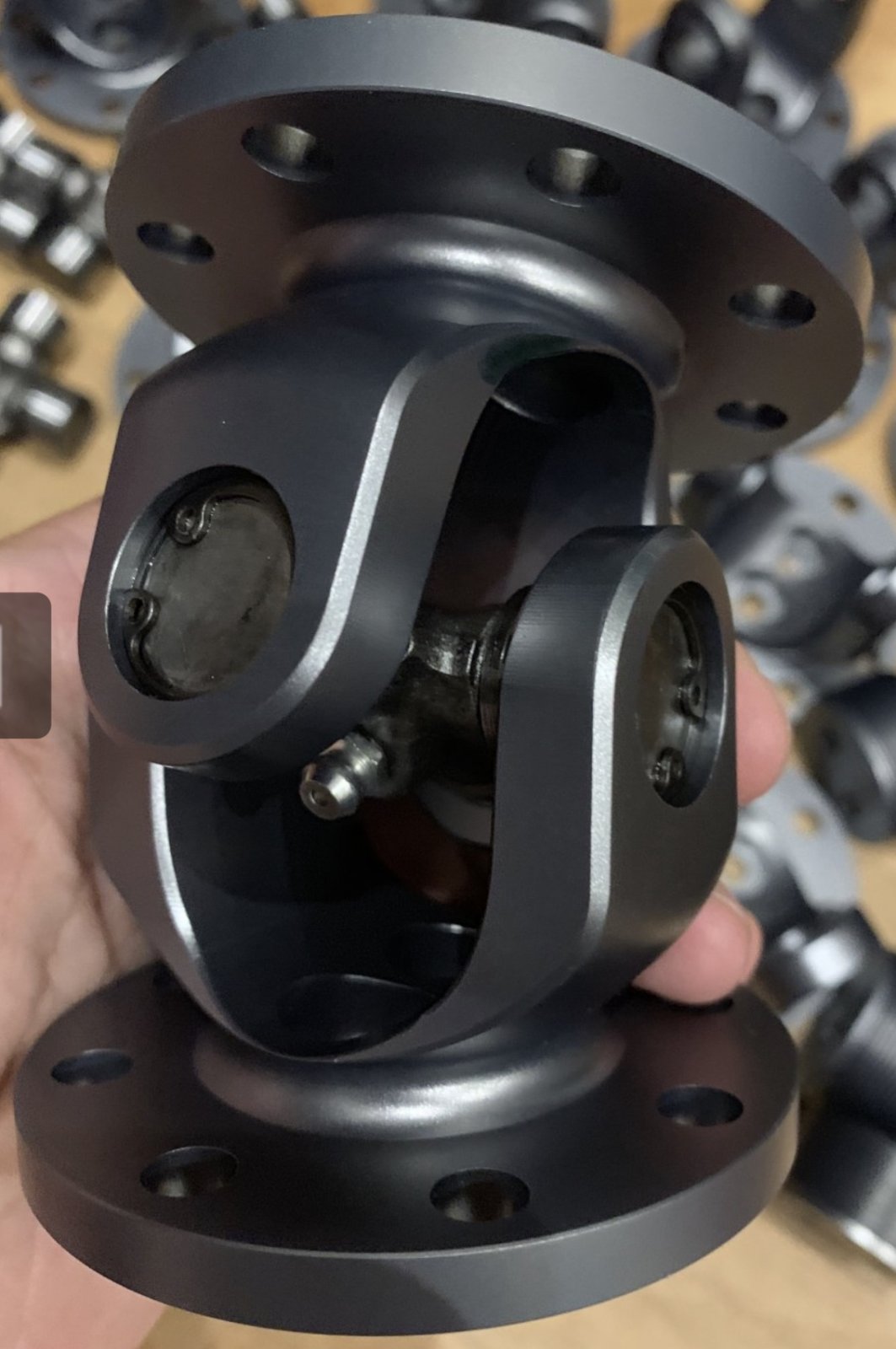

    My custom universal joints are excellent but expensive to make. They are 7075 Aluminium yokes with cross trunnions.
    Still, you may be interested.

    Oh, small misunderstanding... I was not talking about the U part... the other bearing ... the 360 one:

    There are two bearings. I’ll send you a pic later when I get to the office.
    I think we should design a custom one for you.
