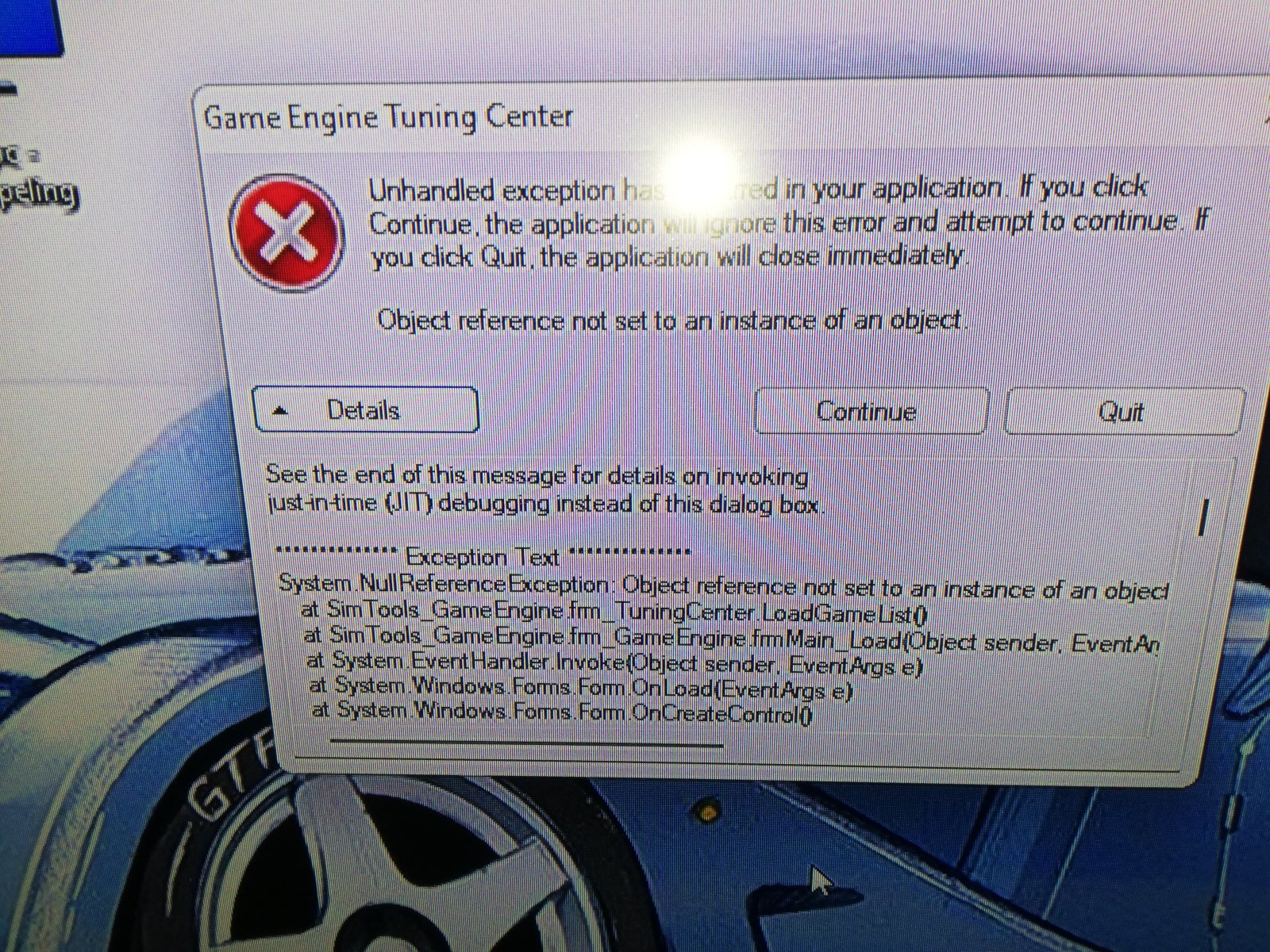

    did have simtools 2.25 installed for testing and did work with lfs . did test/drive IMG_20240218_175359.jpg lfs all week and did buy me diy license . after instal and activate , then try to run game engine and game manager getting the same error ? someone did have this problem also ? help !!!!

    .net frame work is installed . fresh win 11 install .... repairtool .net also did not do the job ? before that it workt good with the demo versie , no errors , just after buying the license and install and activate it, i did get this problem/error ...

    Did you maybe try to install a v3 plugin into v2? (or visa versa?)
    The easiest thing to do, would be to re-install SimTools and start over. (as I don't have enough to work with here to tell whats wrong I'm afraid)

    ok, that maybe could be happend , did install some plugins i did got ... in the demo . software uninstal and reg edit removing simtool? so complete from the windows? if that could be a problem then that maybe did happend . i wil look into that tomorrow , wil let know if it works ..

    did reinstall simtools from 2.2 to 2 .6 , complete uninstal 2.2 simtools , also in register .. it is working now with license key diy , can now move the seat with my old ..settings .. in the output testing prog ... just did test it with the lfs plugin , it ,s working , but now for my plugins ? i dont trust them .....downloaded them from https://simtools.us/plugin. are these the same as for this simtool plugins download from the xsimulator site ?

    No the plugins from https://simtools.us/plugin are for SimTools v3 (currently in Beta testing) only, and are incompatible with SimTools v2.
    SimTools v2 and v3 can be installed on the same computer and the same license can be used for both.

    did instal the v3 , with the license key , all the plugins are working now . motion rig is working great , did take me some time, but i,m happy that i put the time into it to get it work , and ofcourse with the help of this forum ... great job ...thanks ..
