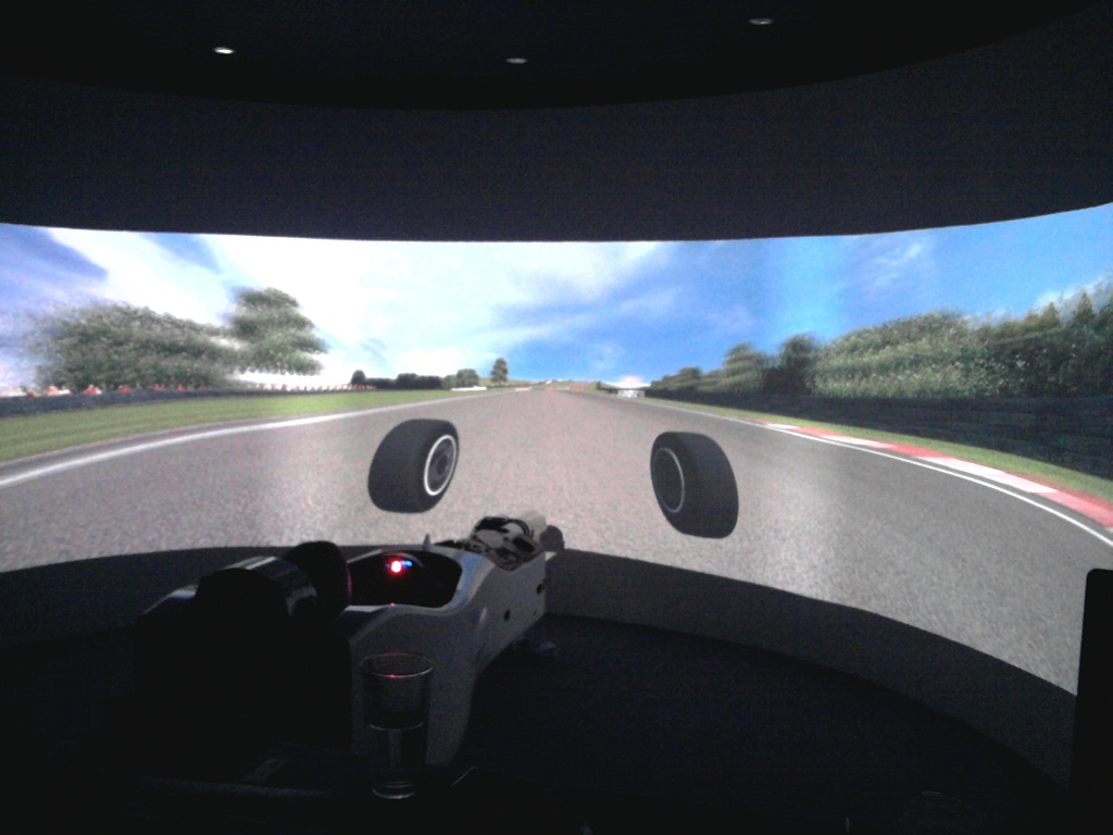

    Quick pic, warping and edge blending only at initial stages...

    ... Looking good!

    Please show us more details about your screen, which software you use for edge blending and distortion correction of the picture, whats the size of t? Its really looking good and very immersive due to the enormous size.

    The software is warpalizar, which enabled me to do both edge blending and distortion correction. Screen has a radius of 2 metres and an arc length of 6 metres. Its pretty immersive when at the centre. Now just thinking of a way to incoporate tensioning belts on deceleration as it feels alittle cut off, any ideas?
