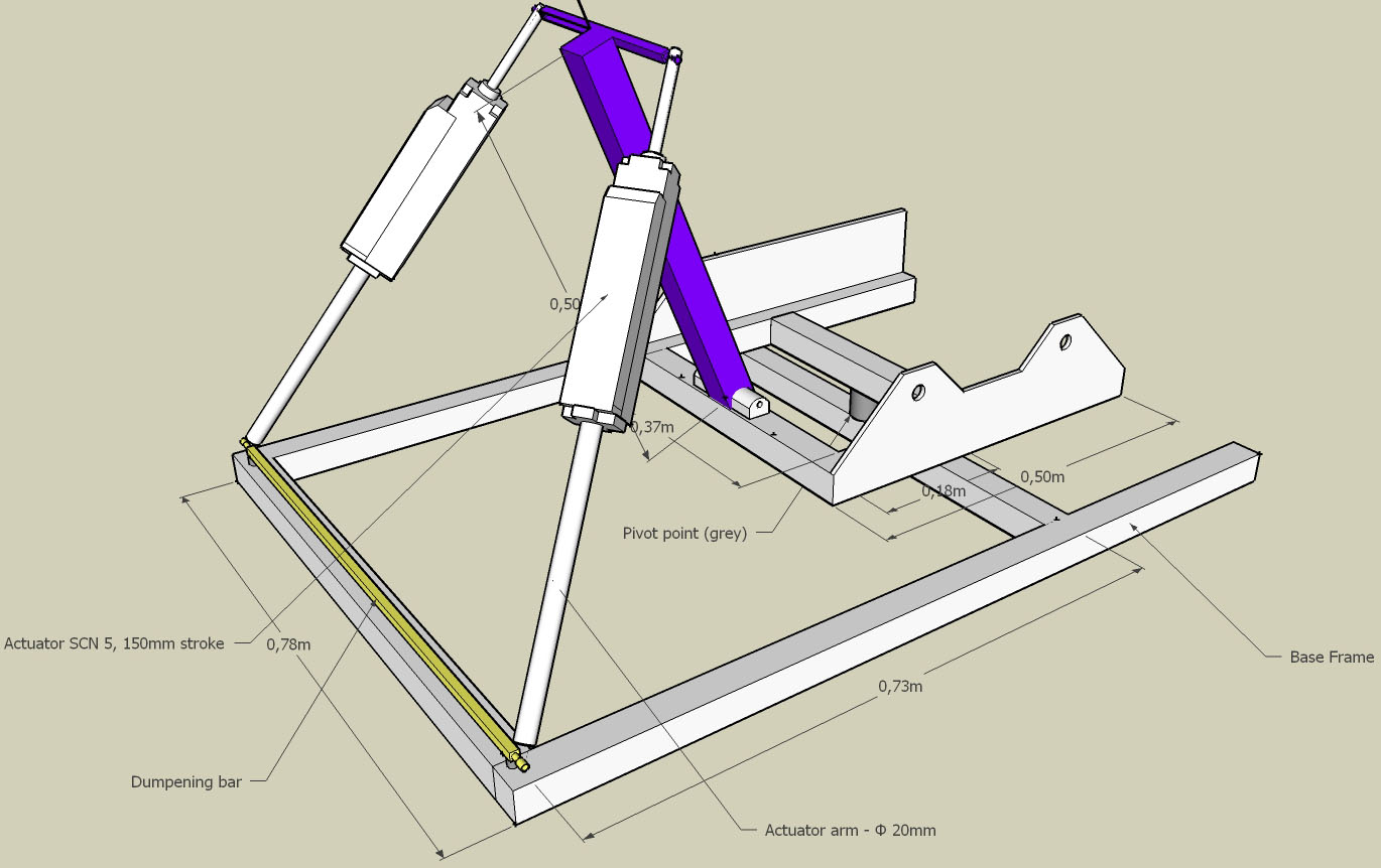

    So I think I have decided on welding up a steel frame for my 2DOF seat mover. Is 1" 16ga square tubing going to be strong enough or do I need something bigger?
    thanks!

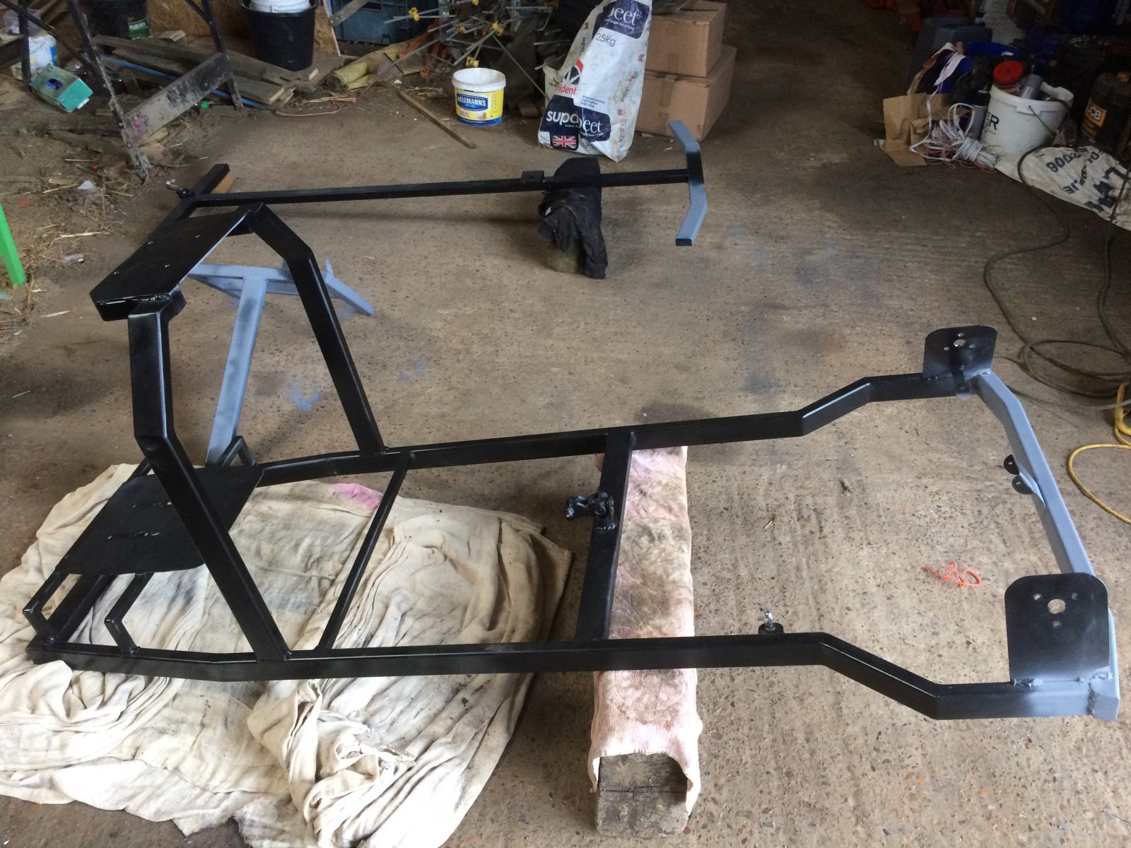

    hi there
    I'm not sure I can offer a direct answer to your question as you haven't given any idea on frame design or measurements. when you mention 1" 16ga square tube I assume your referring to 25mm square hollow section with a 1.5mm wall. If your 2 dof seat mover sits directly on the floor then yes I guess it will be strong enough for a seat frame and wheel stand but if you wish to add traction loss at a later date then u will probably find as I did that as the frame will then be supported from a swivel point at the front and rollers at the back and that the frame will deflect in the middle under your weight then straighten as u hit the brake. I use 50mmx25mm ( 2"x 1") with a 2mm wall for my side rails and rear bar then used lighter steel for most of the other parts to stop this.
    The most difficult part I found to welding up a steel frame for the first time was getting everything set out for my size ( pedals the right distance from the seat and steering wheel height, distance and angle) this is where aluminium profiles have the advantage as in un bolting and moving is better than cutting, re welding and re painting if you find the driving position to be wrong. It took me a week in the workshop working long hours to finally be happy with my frame at a cost of £200 for the steel here in the uk with delivery and £70 in paint.
    Ive added a diagram on the suggested geometry for a 2dof scn5 setup I used to build mine and adapted the design for motors trying to keep to the same measurements and connecting rod angles. Also a picture of my frame once welded and half way through painting. IMG_0027.JPG
    hope your build goes well and be happy to answer any questions you might have on the way.

    Thanks @yellofella yes 16ga is pretty close to 1.6mm. I have only been planning for a 2dof so far but you bring up a good point. It might be better to beef up the bottom frame in case I want to add traction loss later.

    yes that butt joint will be under more stress than most of the other parts of the frame and using a beefier piece of steel there would be wise. I used 25mm box section 1.5 mm wall for the seat frame and 50mm x 25mm with 2mm wall box section for the back post the same material I used for the side rails. I tried to keep a common measurement of 25mm with all the steel to avoid overhanging steel on the joints. As for the welding @frankrizzo2 was right when he mentioned that thinner steel is trickier to weld. I found that using an arc welder had the advantage in being able to use different thickness welding rods for the weld I had to do, 1mm rod on 1.5mm steel and 1.6mm rod on the 2mm. if u need a stronger weld then clean up the first weld and weld over to strengthen it. once a join is welded put some stress on it once it has cooled and try to break the weld. if you cant break it by hand then its prob good enough for the stress a sim rig will produce. as mentioned there are loads of great sims on here to get an idea of what u want to build and look forward to watching your build progress.
