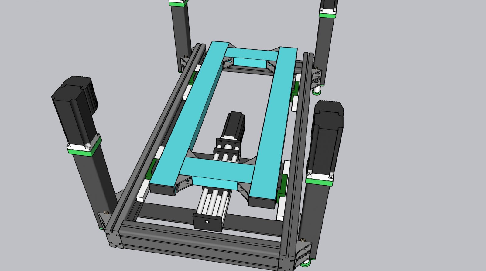

    Now I just finished adding surge DOF and want to show how I did it here.
    This is how I planned to install it. The cyan color frame is the new platform that I put inside the existing structure. I put it inside instead of adding another layer because I didn't want to add too much height to my simulator.

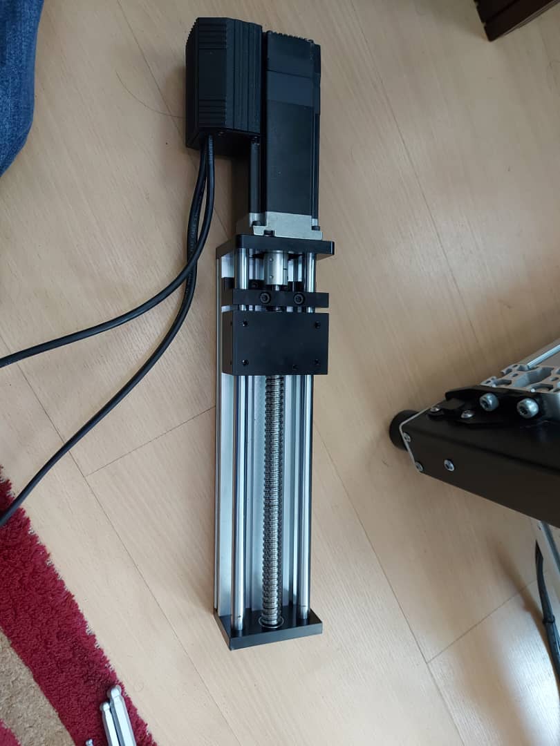

    For the actuator, I am using the same setup as my t/loss platform.

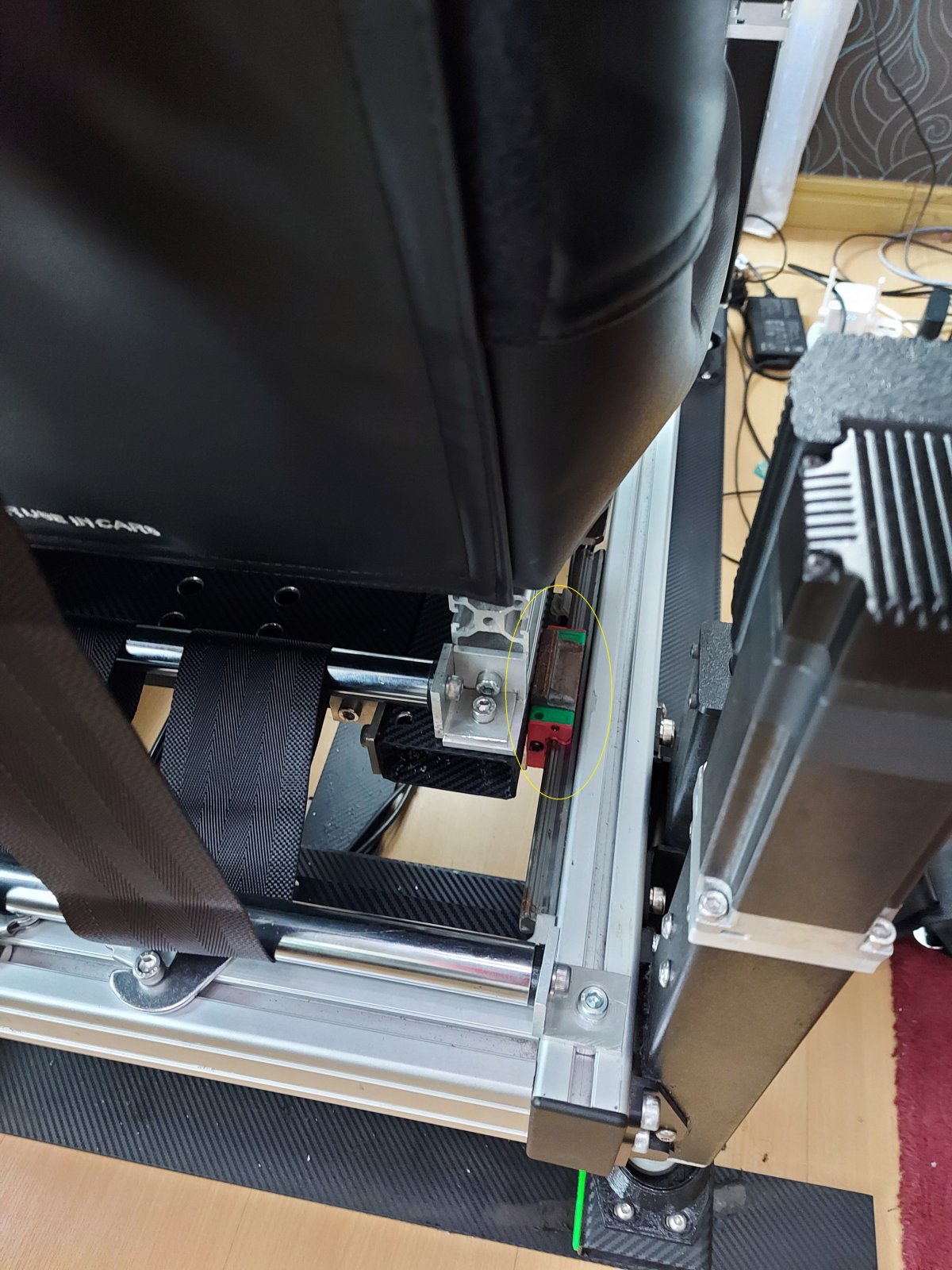

    To suspend the surge platform inside the existing frame, I use this type of linear slider.
    Good thing about this slider is that they can be mounted in any orientation and still maintain the rated load. So I just mount them at the side of 8040 alum frame sideways without the need of additional support structure.
    I use 4 of them to hold the platform at each corner.
    This is the front right one.
    And this is the rear right one.

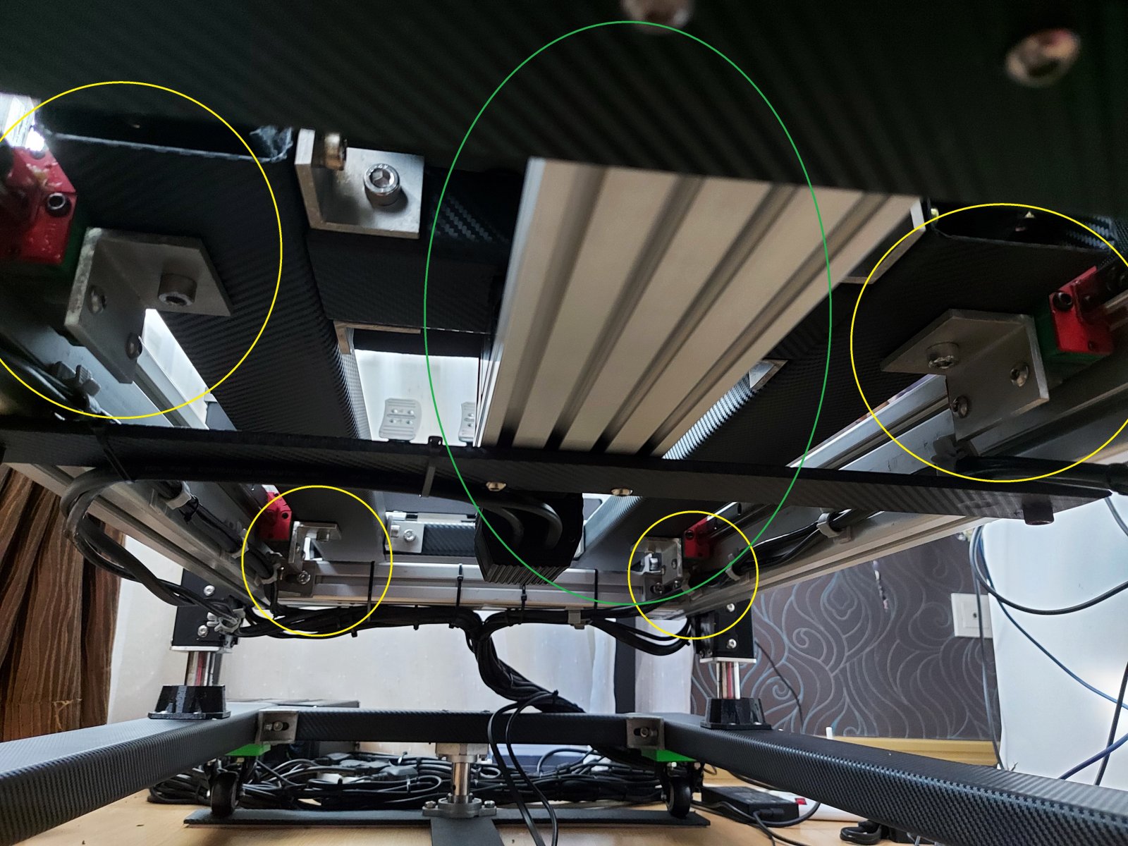

    From under neigh you can see how I use aluminum L bracket to attach the frame to the slider (yellow circle).
    The green circle is the actuator seen from below.
    This is how it looks like finished.

    How many mm/s are the actuators ?

    200mm. But only use 160mm(80mm one way).

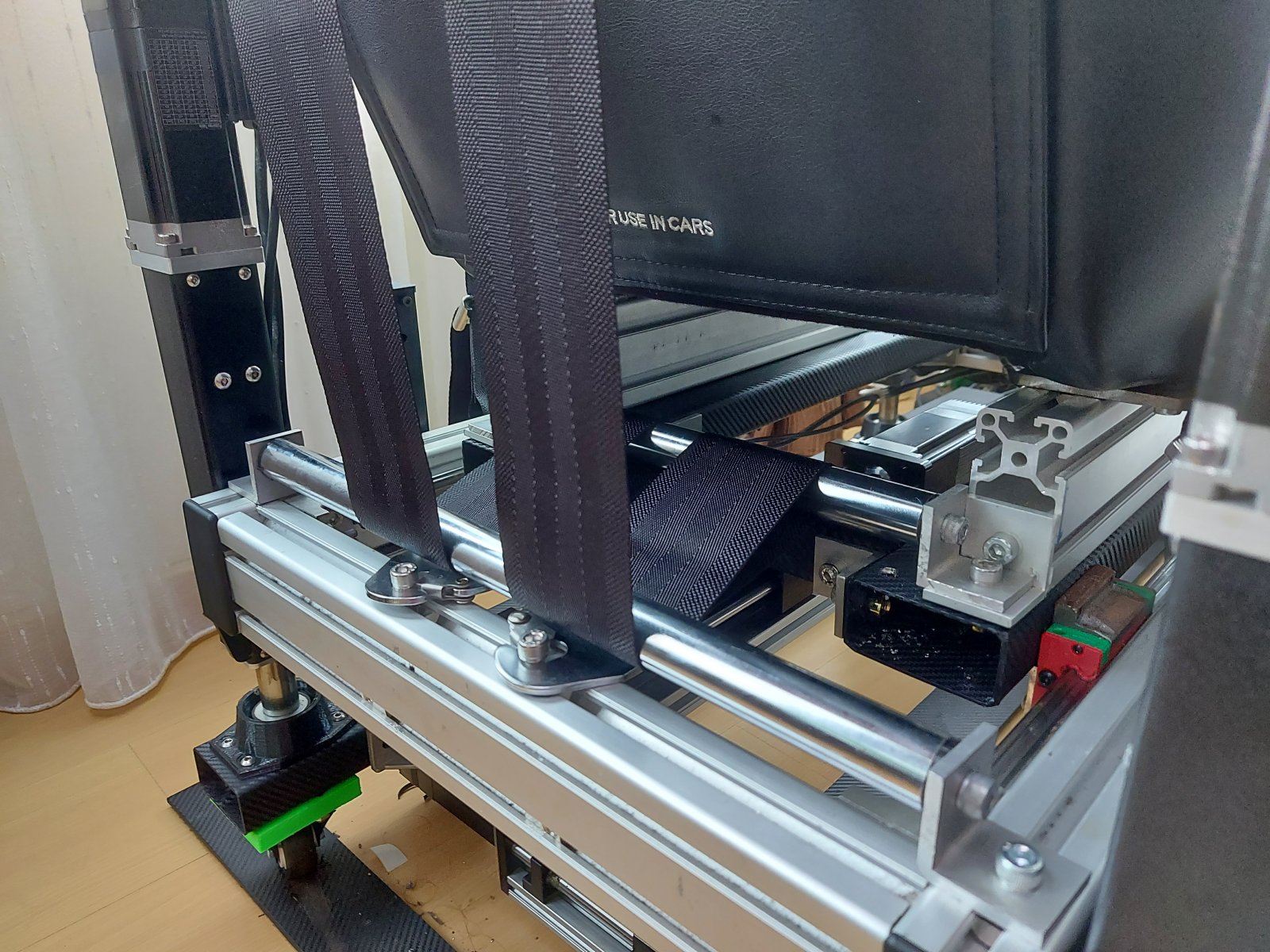

    I took advantage of the surge motion to create a seat belt tensioner system.
    Those 2 shining chrome plated tubes are used create a pulley system where the belts are pulled 2 times the surge motion length when braking.

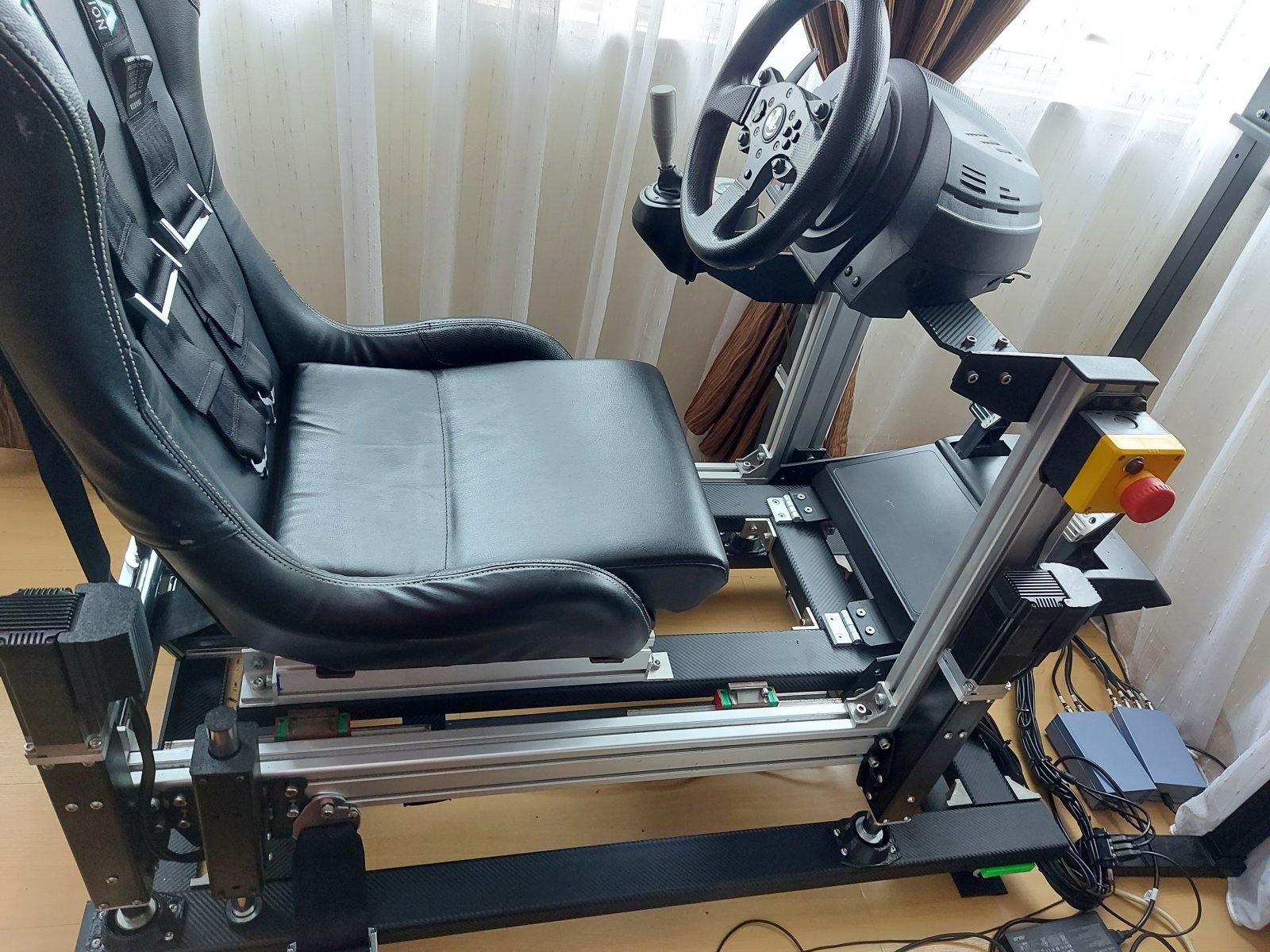

    I found out that for surge axis there are 2 ways to do it.
    1. Seat, pedal & wheel move together. It moves forward when accelerating and backward when braking like real car but gives temporary sensation of acceleration & braking.
    2. Seat & pedal move together while wheel is static. Moves backward when accelerating and forward when braking. Gives prolong sensation of acceleration & braking by pulling and pushing the driver against the wheel.
    I choose the 2nd one. If you notice in this picture, wheel posts are attached to the static frame.

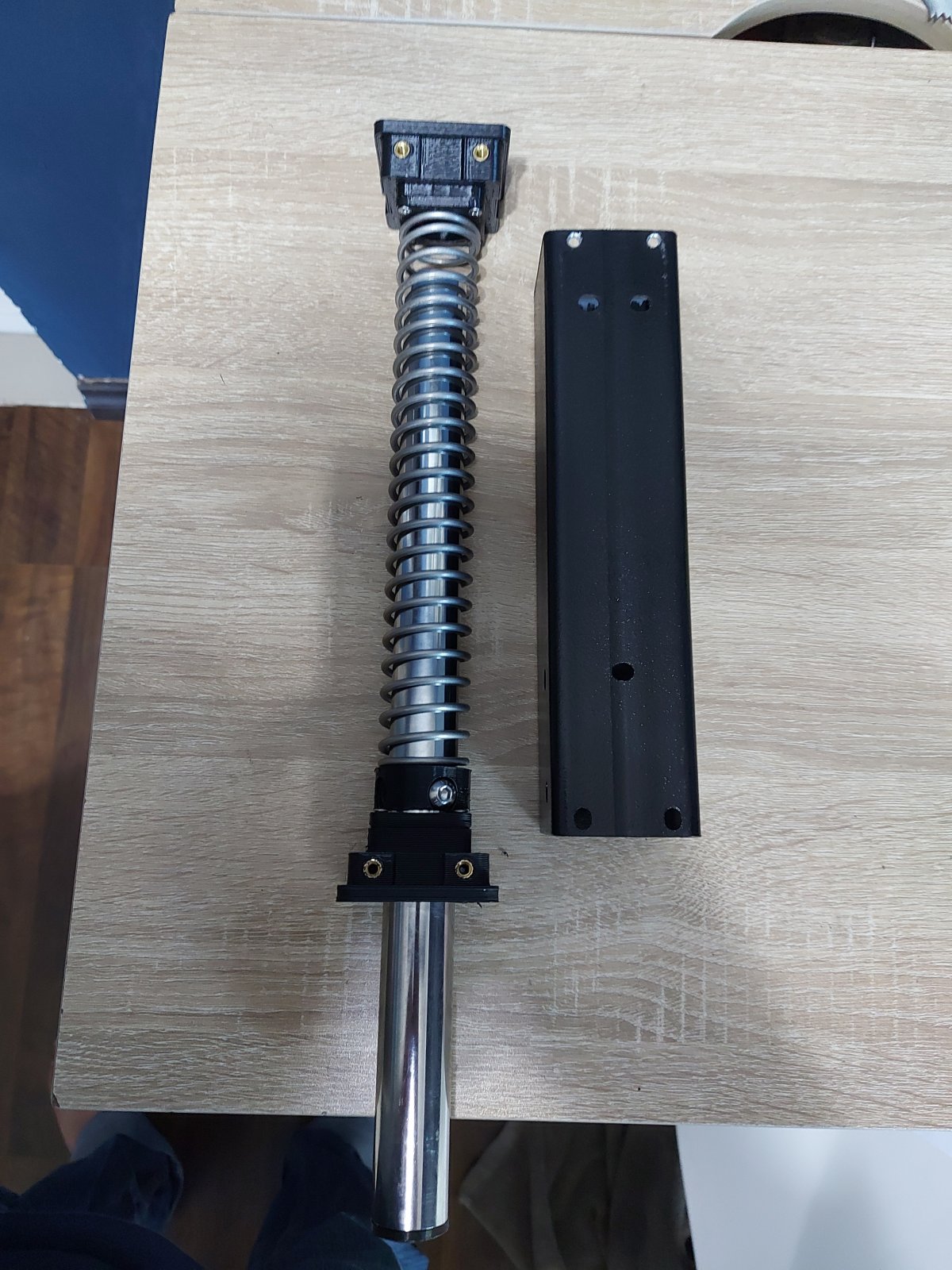

    Paired with 4mm pitch ball screw it can lift 80kg at 100mm/s per actuator.
    Also since I added surge platform, I make a spring actuator near the rear actuator to lessen some load.
