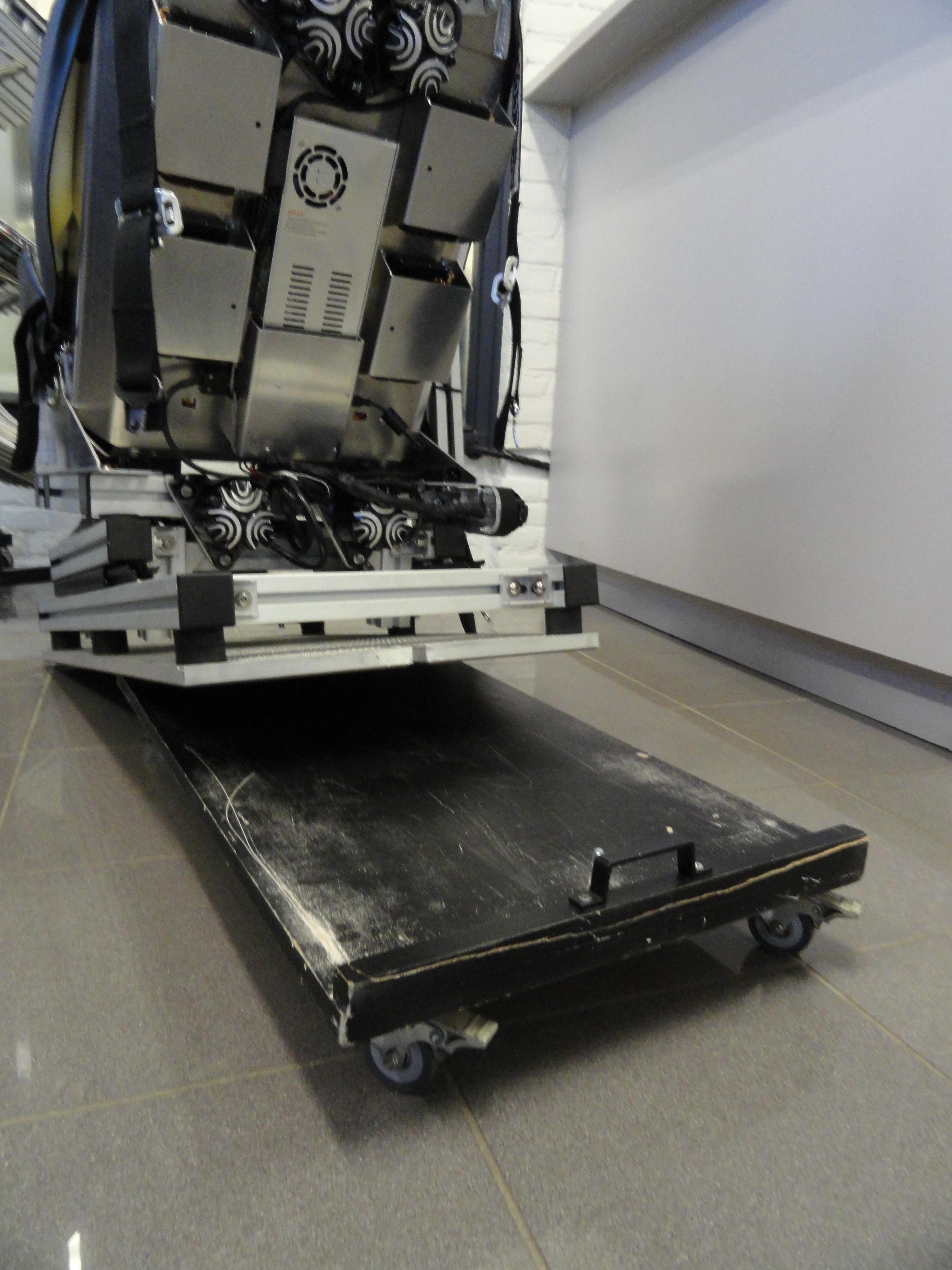

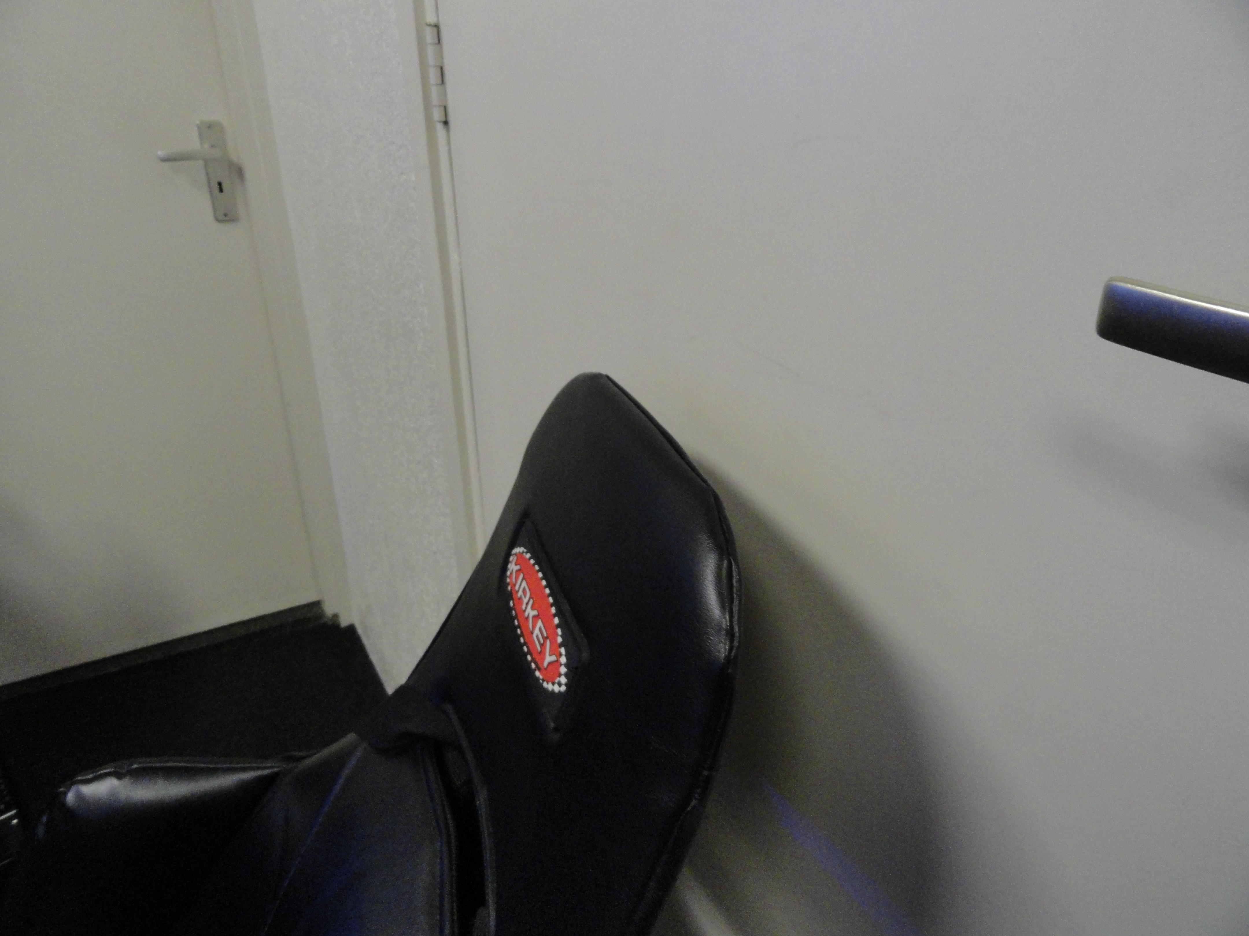

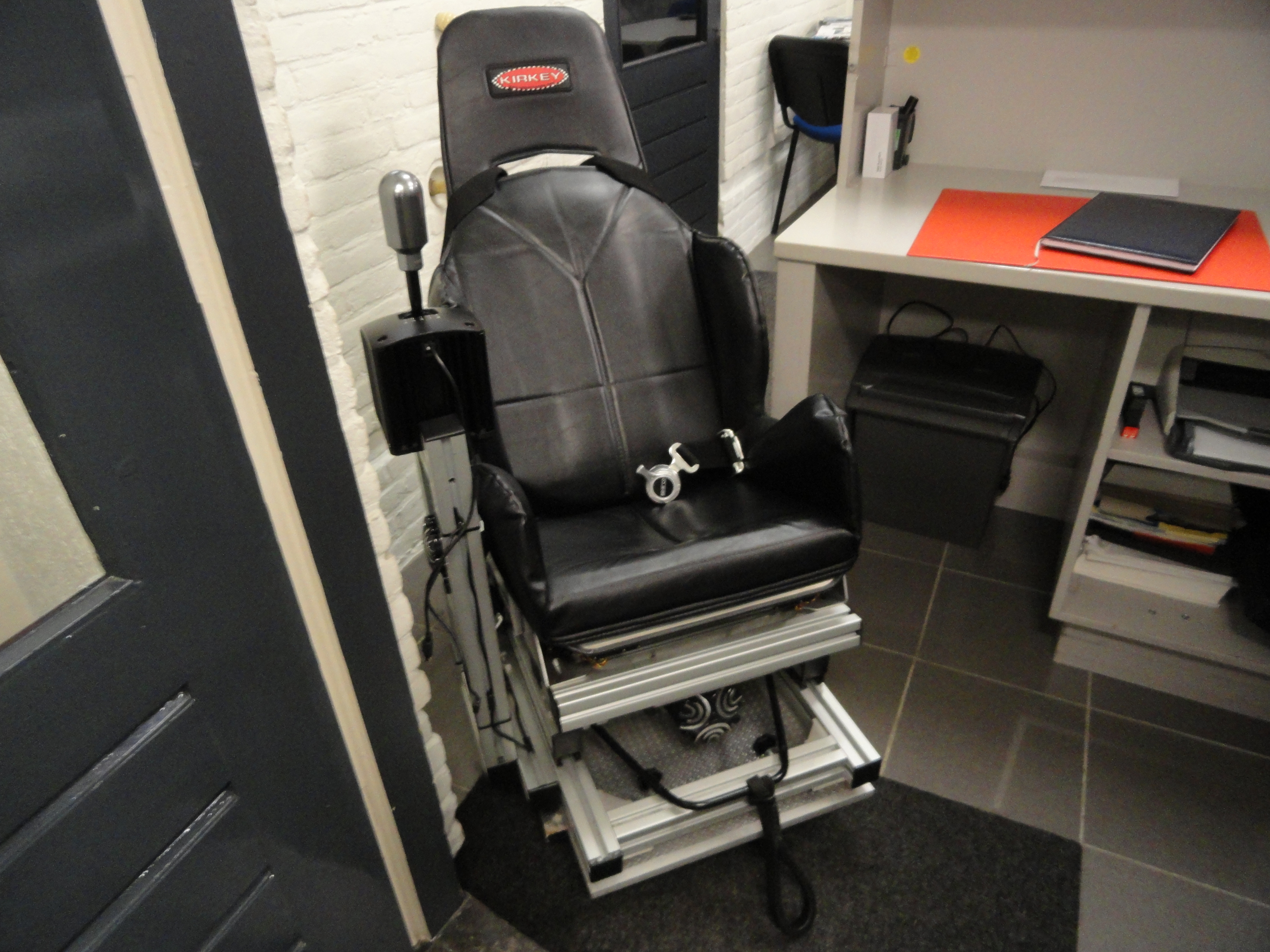

    Always wanted a motion rig, last september i bought a GS-4 (one of the last ones) and it's awesome.:)
    I have been bitten by the bug, and i want to expand to full seat / frame motion.
    Two problems :
    1. i do not have a lot space
    2. the rig is not a permanent one.
    Here are some pictures to illustrate my space problem:
    The front of the seat almost touches the sides of drawer kabinets of the desk.
    There is no room for seat movers at the front of the seat.
    There's no room behind the seat either to mount any seat movers
    I have to disconnect the seat everytime and slide it onto a cart and move it out of the office.
    (that's why i only want a very limited amount of electrical connections)
    I have to move the seat through this a door and a very narrow corridor beside the counter to the other room. That's also why i need to maintain a very small footprint.
    I'm still exploring the option of a DIY motion, but i looks pretty difficult:
    -No room in front of the seat for movers
    -No room at the back of the seat for seat movers
    -Almost no room below the Seat
    -Weight : The seat already weight a ton.... :) don't want to add to much too it otherwise it will be impossible to get it on the cart.
    -Minimal amount of electrical connections to be made when installing the seat in front of the desk
    The seat is already at it's lowest level possible and my knees are now about 5cm clear of the desk.
    If i raise the seat any higher, my knees will touch the bar of the desk when the seat moves.
    The seat is mounted in a backward angle on the frame.
    The seat angle is the sweat spot for me and i definatately want to keep the default stationary angle the same.

    You already have a really cool rig @HoiHman, thanks for sharing the pictures.
    That is very tight for room and some things would have to change, such as the Buttkicker underneath being in the way of any sort of pivot point. Can you actually give some dimensions and angles of the seat and base and how close it actually is to the cabinets and door behind it. We first need to establish if it has enough room to actually move.
