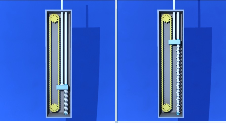

    Hello everyone
    I am preparing my 3DOF sports seat project, plan to use the worm motor for the actuator, the forum did not find a similar thread, before the start, I hope to get some advice, any suggestions are good, thank you very much !!
    This is my design.

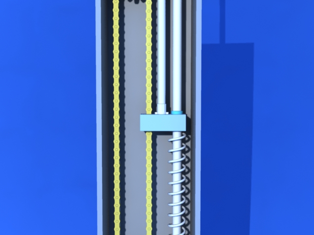

    Use springs to increase lift.

    English is not good, with Google Translate. This design is very simple, but also reduce noise. Hope that experienced friends can give some advice. Thank you!
  4. RandomCoder
    Feb 19, 2017
    185
    Control Engineer
    UK
    1,674Coins
    +142 / 0 / -0
    What is the reason for choosing to use a chain? Would a belt be quieter and cheaper?
  5. xiatian
    xiatian Member
    Sep 5, 2017
    78
    Xi'an, China
    262Coins
    +28 / 0 / -0
    Fear the belt is not strong enough, only to choose the chain, if we can find a suitable belt, I will use.

    However, this shaft drive is not suitable, can not use the spring to increase thrust.:)
