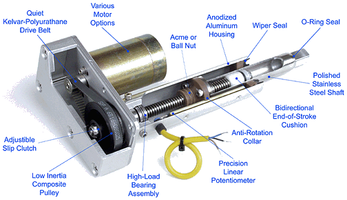

    @Pit : you can add feedback with a pot on the pivot :) rather than on the actuator itself

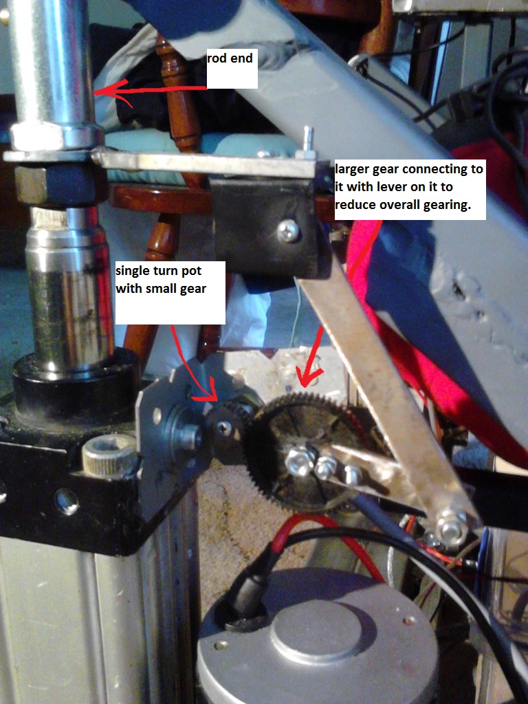

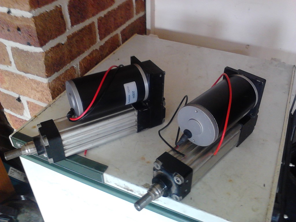

  15. bsft
    I converted some actuators I was given by chance a while ago.
    Mind you, they are fast in the first place and industrial strength. I just had to re-motor them with 12v motors.
    I use 4500 rpm motors, 1:1 drive
    and then do a custom feedback setup to suit the motor controllers, in this case, the JRK
