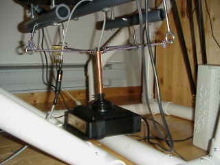

    I am interested on the ACESIM flight simulator http://www.acesim.com/main.html , I think the prototype is easy and cheap , and I hope that I can make it soon.
    However I did not understand what they choosed for the actuator, I can for sure use two acutators (one for each DoF ), but I wan't to know what is the gadget that they used(similar to a joystick), if someone could help
    https://postimg.cc/RNmSx7WL
    Regards.

    That is not actuators, its a plain joystick... the initial system is purely manual mechanical.
    Here is a motorized version I made 14 years ago:

    Thank you for your reply, I think I should read those plans again to understand how that arm move the entier chair.
    so that joystick was used just to translate the movements of the mechanism and send it to the computer?
    Your work is outstanding, do you still have some ressources(used actuators, codes,..)? I checked the link in your description ,but unfortunately it's out of work.

    Yes, those links are really old, much was lost all these years.
    I can tell you what I used back then, the actuators were made by car wiper motors paired on a tower pulley system with metal wire that was push-pull each frame to tilt to the desired angles. One of the towers was mounted inside the frame moving along as well. The position feedback potentiometers were mounted inside the casters used to allow rotation of the frames, so they could measure the angles.
    The power for the motors was from a marine 12v deep cycle battery, via a h-bridge I designed myself, controlled by the first prototype AMC controller back then, that was only for 3 axis...
    You can see some more mechanic details on my old videos:
