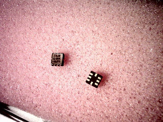

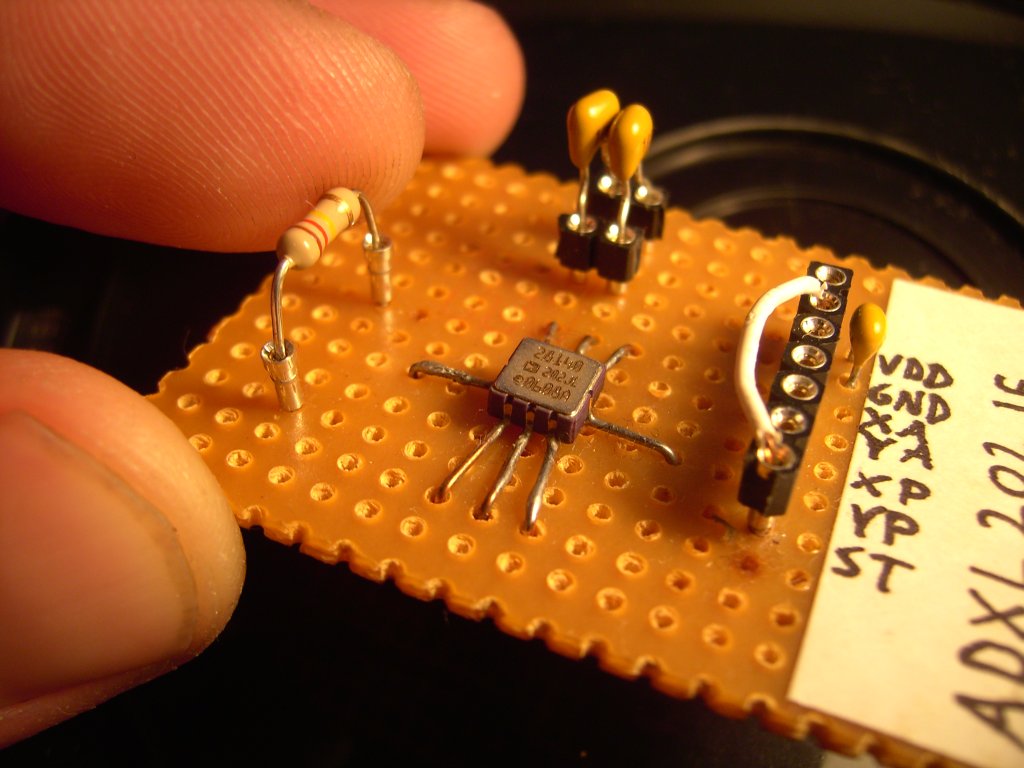

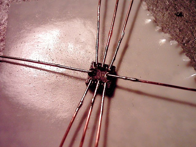

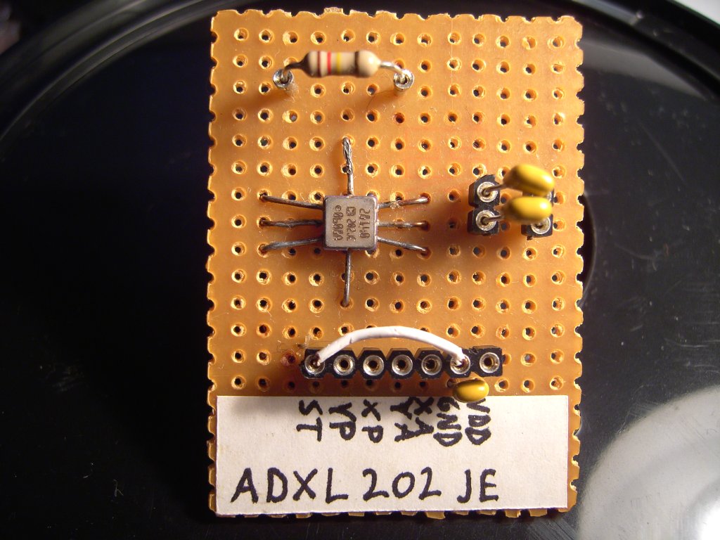

    I have thought before the use of accelerometers for position feedback, but usually they are microscopic SMT parts that require special boards to interface to them. I already have several accelerometers (and gyroscopes) and build some SMT boards to use them in my robots long ago. My accelerometers output Pulse width signal that represents the various angles or accelerations... I have the ADXL202 dual axis accelerometers...
    EDIT: By the way my ADXL202 accelerometers also have analog output 0 - 5 volt !!!

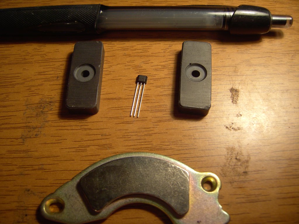

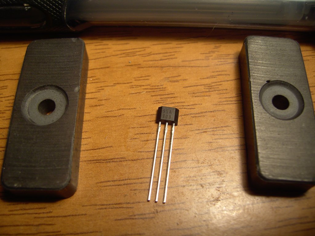

    I'm working on such solution right now. I have in my hands several SS495A Ratiometric Hall effect sensors... If you place it between two magnets you get an almost linear output 0 - 5v !! And it can work as usual pot if rotating a magnet in front of it. Its the mechanical part that is concerns me as I want to use simple materials for a setup that is easily reproducible from others!

    I think, besides encoders, hallsensors are the best way to go, if you can keep strong magentic fields (valves/solenoids) out of their close range. They dont wear out, are very precise, and the moving part does not need physical contact to the sensor. As well you can put them in place of pots without additional hard or software.

    Anyway, the ss495a ones should work, as they do output 0.5-4.5 Volt and 2.5V in center position if operated with 5V supply voltage.
