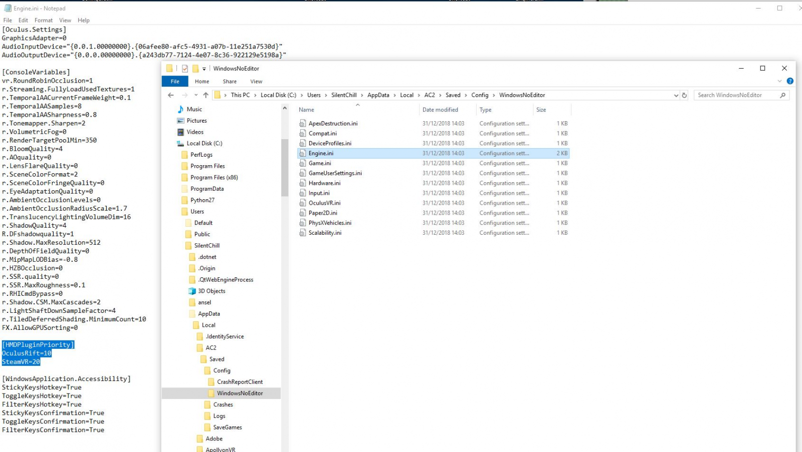

    Very new at this, so forgive me for my ignorance.
    I just got a 3DOF platform and everything works fine. What I am trying to setup at the moment is the motion compensation in Assetto Corsa with Oculus using OpenVR Input Emulator v1.3.
    So far I can setup OpenVR without any issues, it seems, but once I open AC, it is very obvious the motion compensation doesn't work.
    Everything is setup correctly:
    - Two Oculus cameras (OK)
    - Oculus Touch Controller attached to my seat by my head (OK)
    - OpenVR Input Emulator v1.3 setup:
    - Device identified
    - Device Mode: Motion Compensation
    - Motion Compensation Settings: Set Zero
    - Press Apply = OK​
    Do I have to keep OpenVR open after setup is done?
    Is it because AC does not use Steam VR to work with Oculus?
    I saw in AC there is an OpenVR render mode, should I use that instead of Oculus?
    Thanks for any help concerning this issue,
    TheCalVRsimer

    Yes you need to edit a line in the ini I found it randomly whilst trying to get Oculus Runtime v1.7 working , wouldn't need motion cancellation if I could get it working . Hopefully below screen grab makes sense :)

    Just realised you are talking about the old AC ?? if so you need to select openvr in the display option in game :D

    Hi again,
    As of today I am still unable to get the motion cancellation to work with AC or RF2 with openVR Input Emulator v1.3.
    I have been following the DOF Reality's instructions, looking online for other tutorials, nothing is really helping.
    Could you describe the exact steps required to make it work with both sim?
    Hope you can help,
    Thank you very much for your time spend on this issue. Sorry for not being better at this.

    Finally got it to work : )
