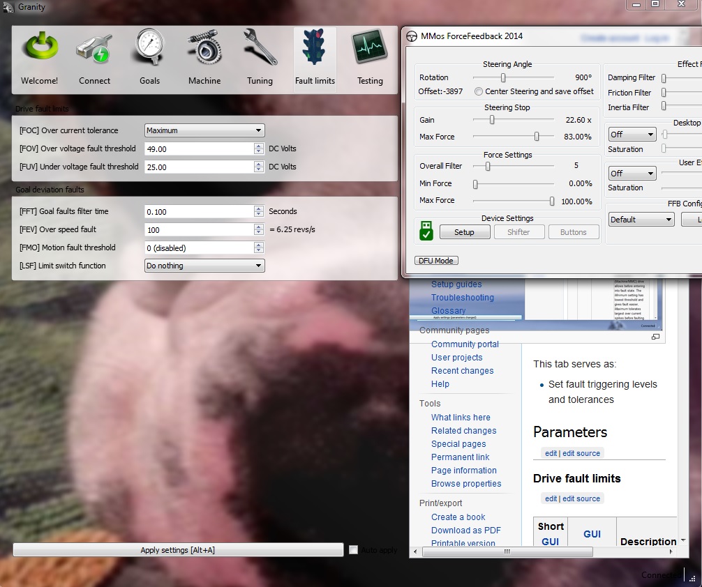

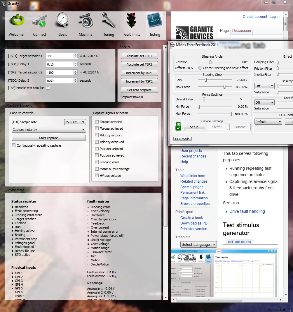

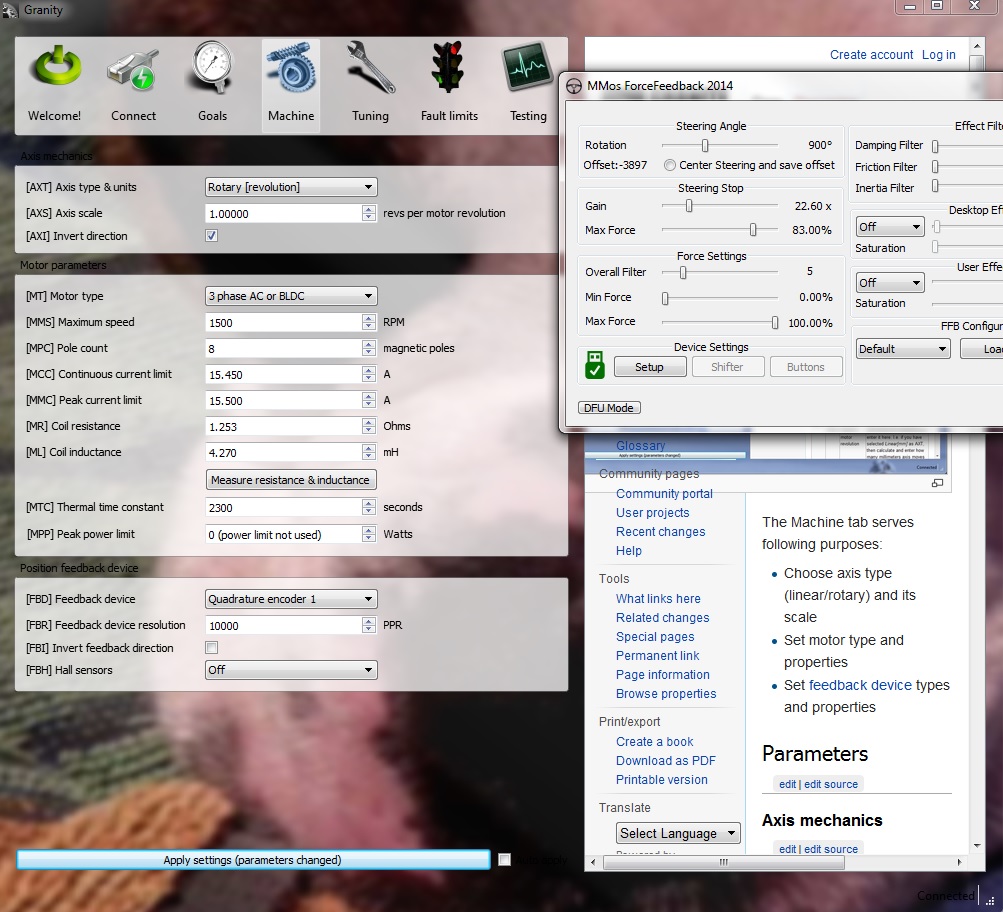

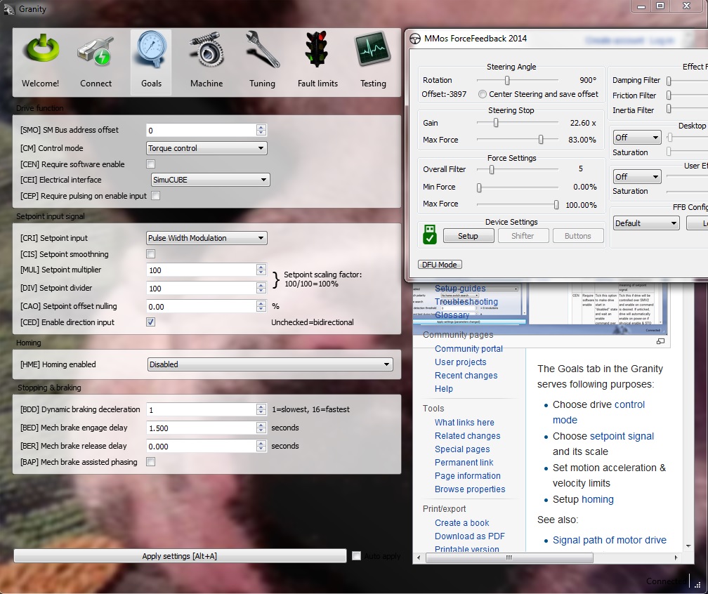

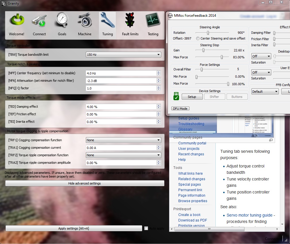

    Here's mine,
    lets see yours.

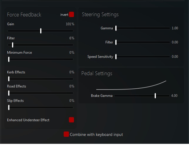

    One thing ill say is that I read alot about Wild Oscillations when letting go of the wheel, Ya when its at 100% in an Old Group C car or something with NO power steering where im running it at 100% gain For that particular car, I still dont get much for crazy oscillations, ya there's some but who the F lets go of their wheel anyways.....so ya...curious what other's thought are on this.
    Is it because im @ 50% gain in the Ac settings...which now reminds me, i forgot to include my AC settings.
    Its easy anyways....50% gain with 6% filter and nothing else except Soft lock, I haven't tried out the Gyro effect yet.

    Which part exactly ? The Wiki has a lot of info, but lacked one major area, A Solid KNOWN working set of #'s for My Mige motor and the Overall Granity/MMO's setting's....Those i had to essentially Pull my hair out for 2 days, then asked for help on the SimRacer's Facebook group, A fellow Canuck ended up helping me out Immensely and i was off to the races.
    You wound't have to worry about that cuz I have linked said Important #'s above. So the wiring and everything else can be handled on the Wiki No problem. What are you most curious about ? Encoder wiring ive also got marked down, so as long as you get the Same motor as me, it'll be a walk in the park.
