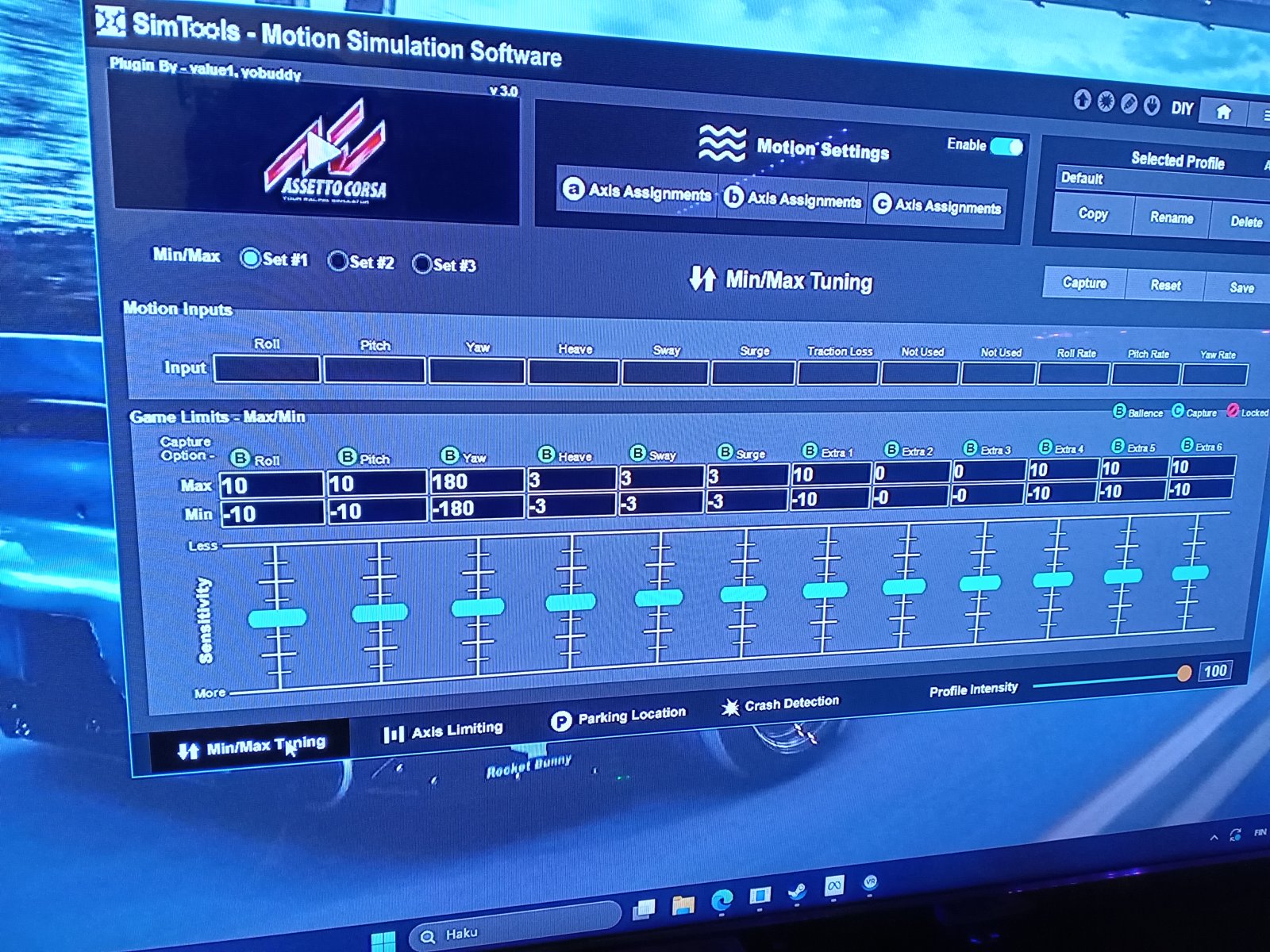

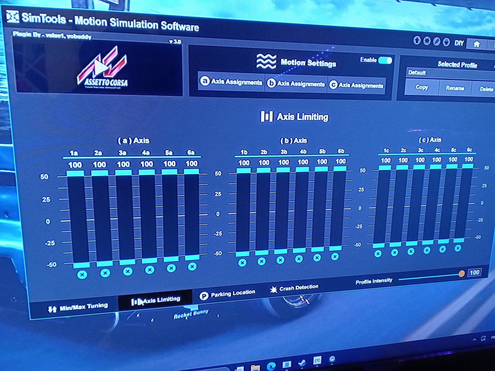

    Why my seat follows more track telemetry than car behavior? I think it would feel more realistic if my seat could move like my car behaves. I dont like that when I go downhill, seat pushes me towards the wheel. Uphill seat goes back etc.
    I would like that my seat moves back when I accelerate and brake and so on..
    Hard to explane What i mean because my bad english skills.

    You can configure a rig however you want, but with a 2DOF you would normally configure surge (simulated), sway, heave (simulated), then roll and pitch, doing one axis at a time.
    See here for tips to refine a motion profile: https://xsimulator.net/community/faq/steps-to-create-a-motion-profile.228/
    Rigs that have a real surge axis are traditionally configured to move back when braking and forward when accelerating, but as surge is simulated on a 2DOF traditionally they are configured the opposite way around.
