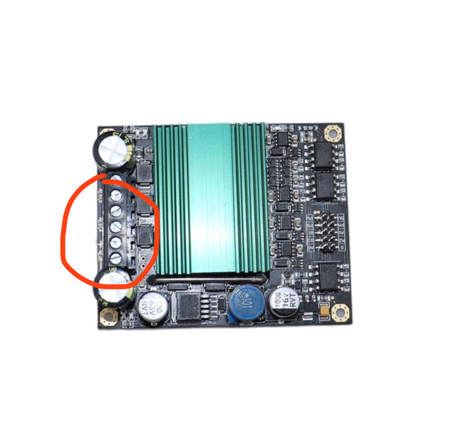

  18. Stefzouille
    Stefzouille Member
    Dec 25, 2023
    105
    601Coins
    +20 / 0 / -0
    2DOF, DC motor, 4DOF
    but why do they do this? with 3-4mm2 cable, these connectors are not great
    In ibt2 too..

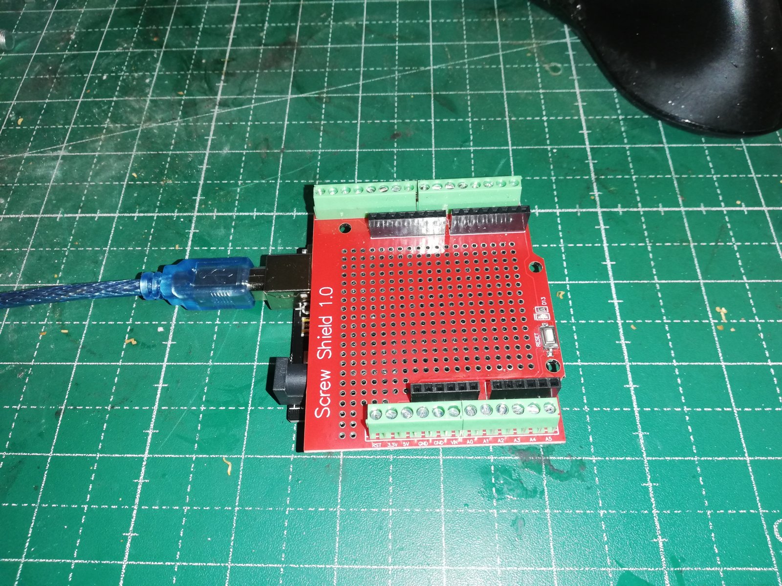

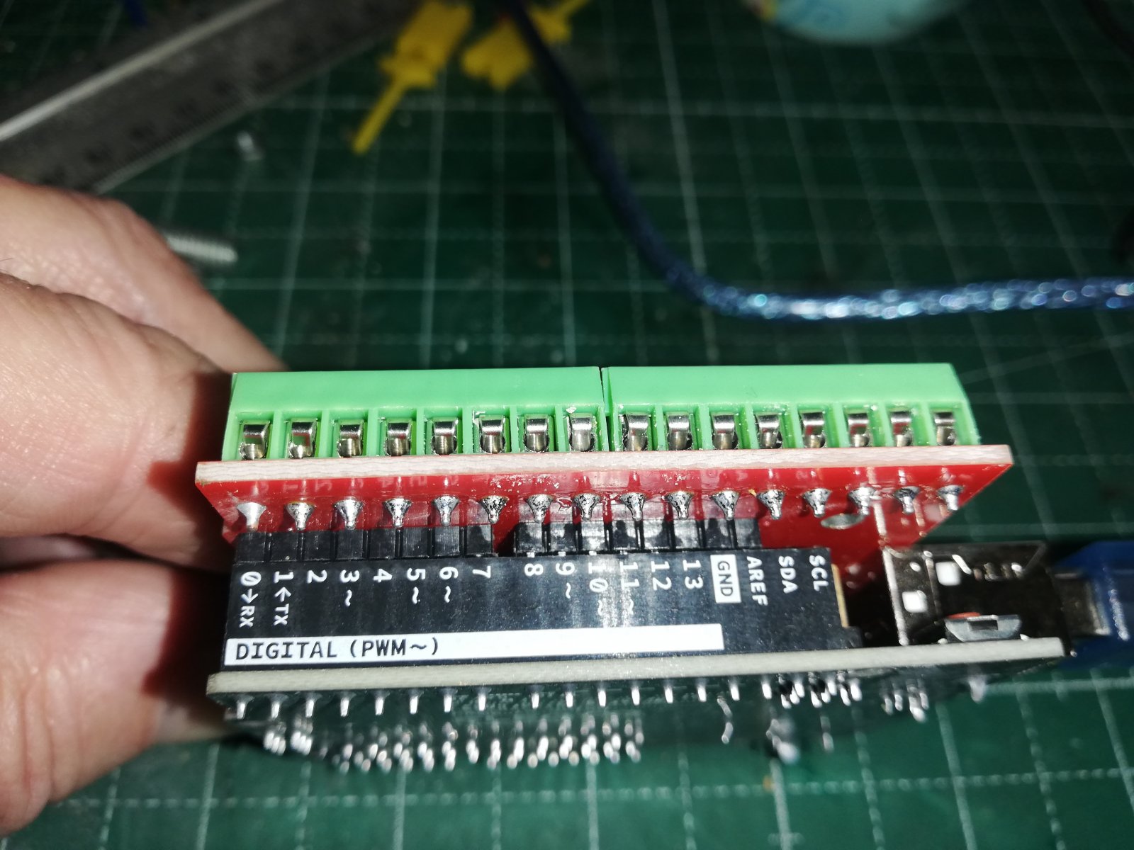

  19. harrie
    harrie Member
    Oct 1, 2022
    48
    coevorden
    221Coins
    +20 / 0 / -0
    Arduino, 4DOF
    i use awg 12 with krimp connectors , and stil hardly getting them in .. and yes connectors design for a 100 amp board is not great . had a same problem with arduino connectors , but a shield for arduin with connectors solved my problem

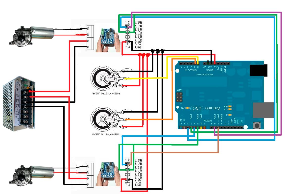

  20. harrie
    harrie Member
    Oct 1, 2022
    48
    coevorden
    221Coins
    +20 / 0 / -0
    Arduino, 4DOF
    site imagen
