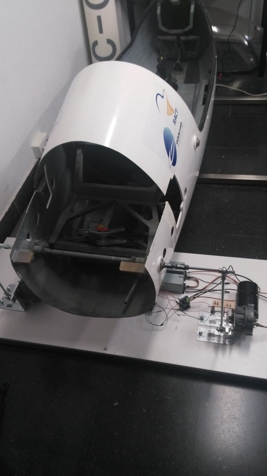

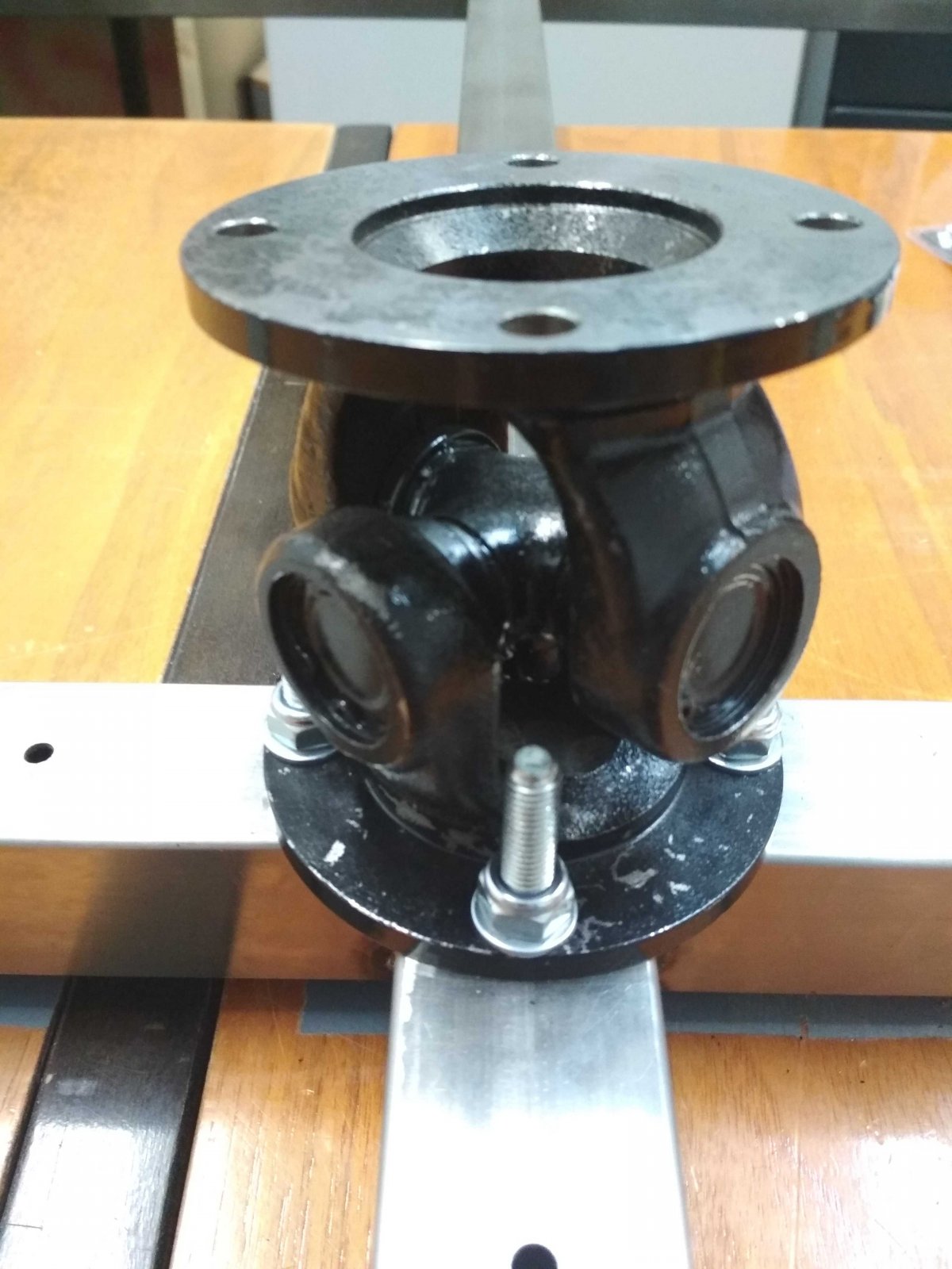

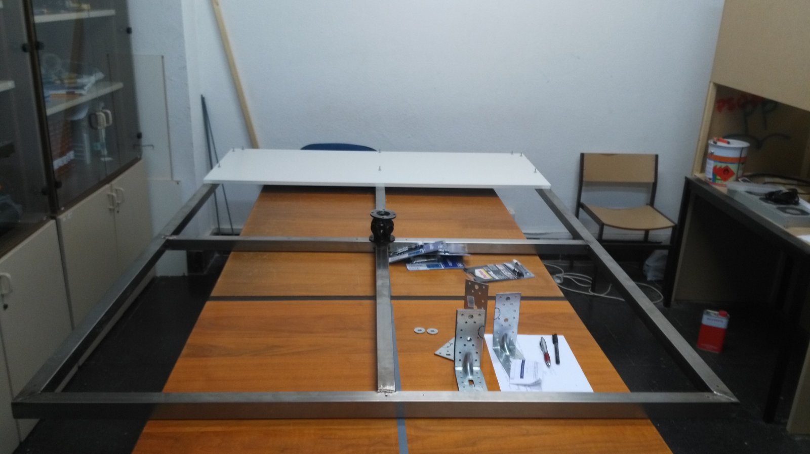

    After a lot of work, we have the base of the cockpit and currently working on the cabin itself, due to being made of fiberglass it needs a reinforcement just below the cardan.
    If all works properly in about 1 week we should be able to mount all the pieces and have all the "hardware" installed, only waiting to install the software

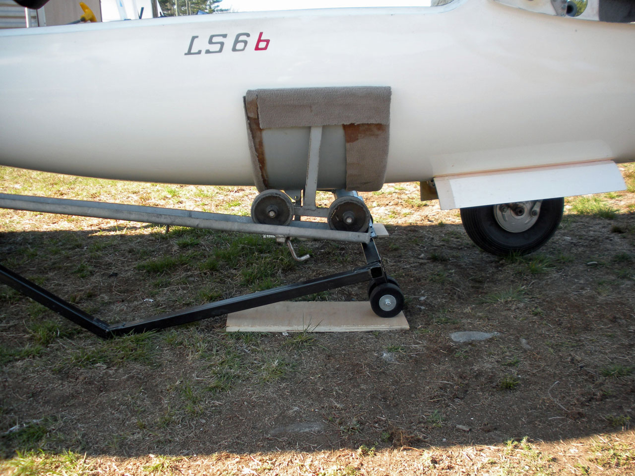

    Of course! As we are planning to use it in events, we balanced it using an (very convenient) old ramp jack from the glider, (image Below). We simply mounted all the stuff in the sim (screen, instruments panel) and 3 people, from light to heavy, measuring the cg position with every person and marking the average.

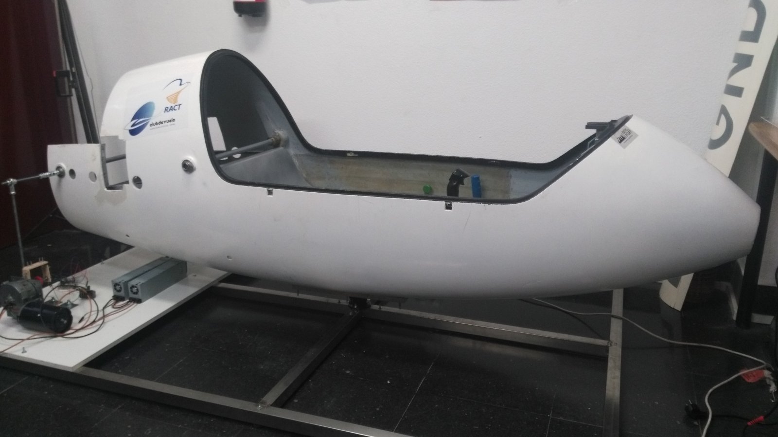

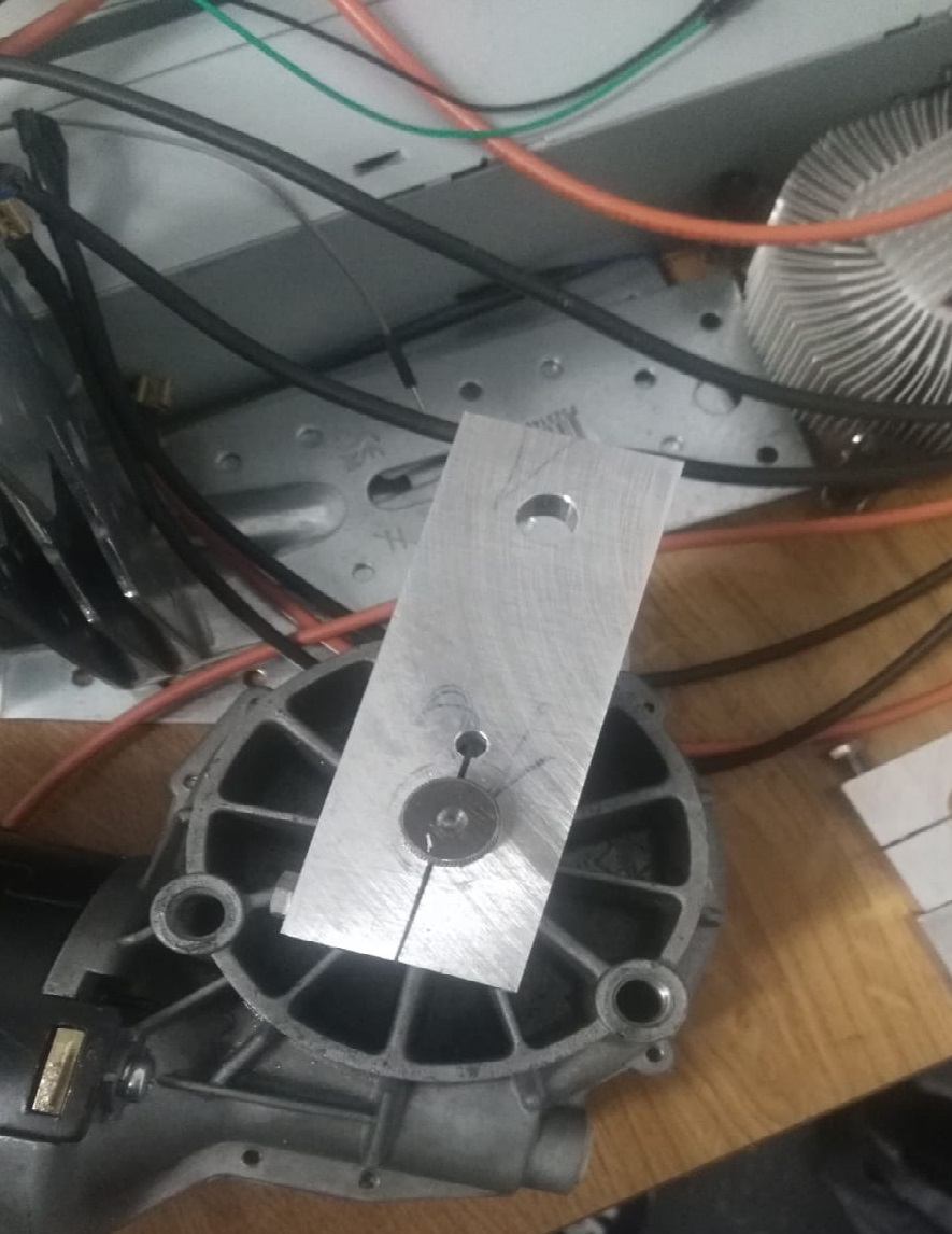

    Small update from today, rods finished:

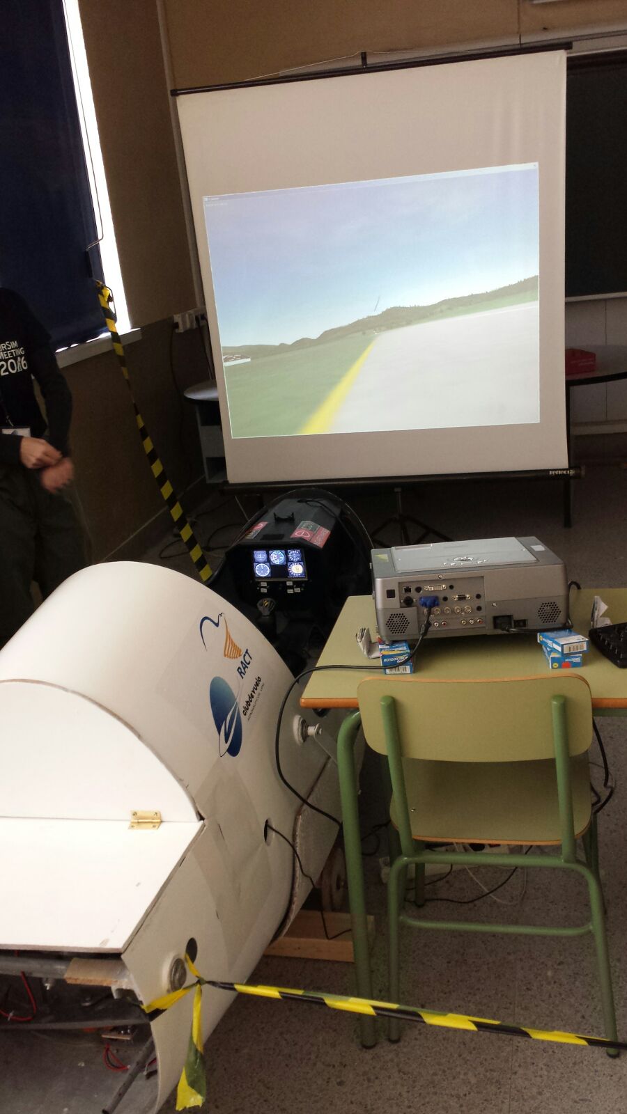

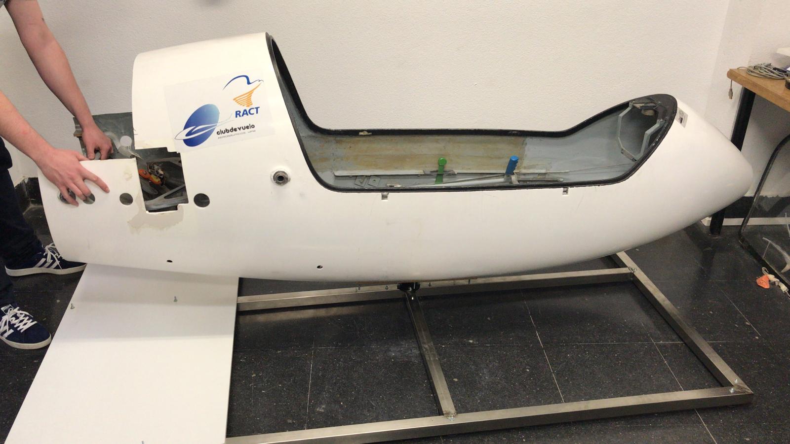

    Cockpit finished!
    Today we have just finished all the "hardware" part of the project, 2 photos:
