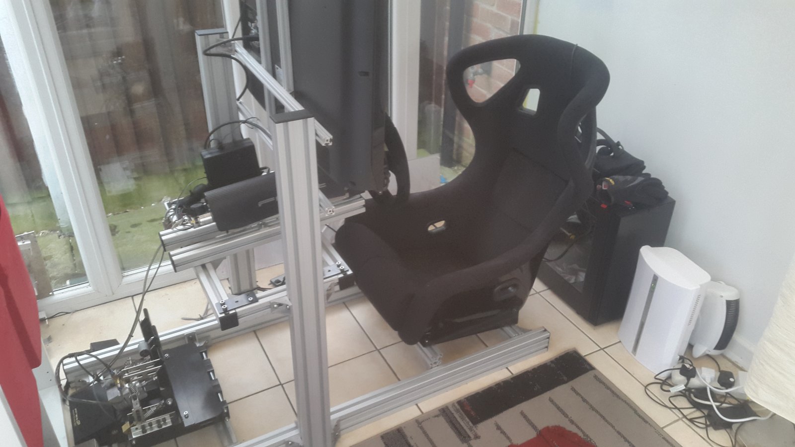

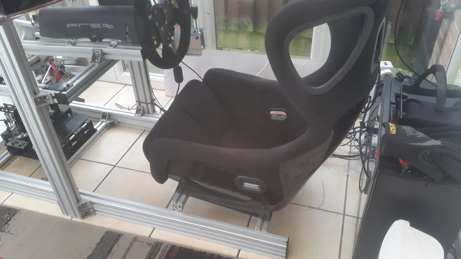

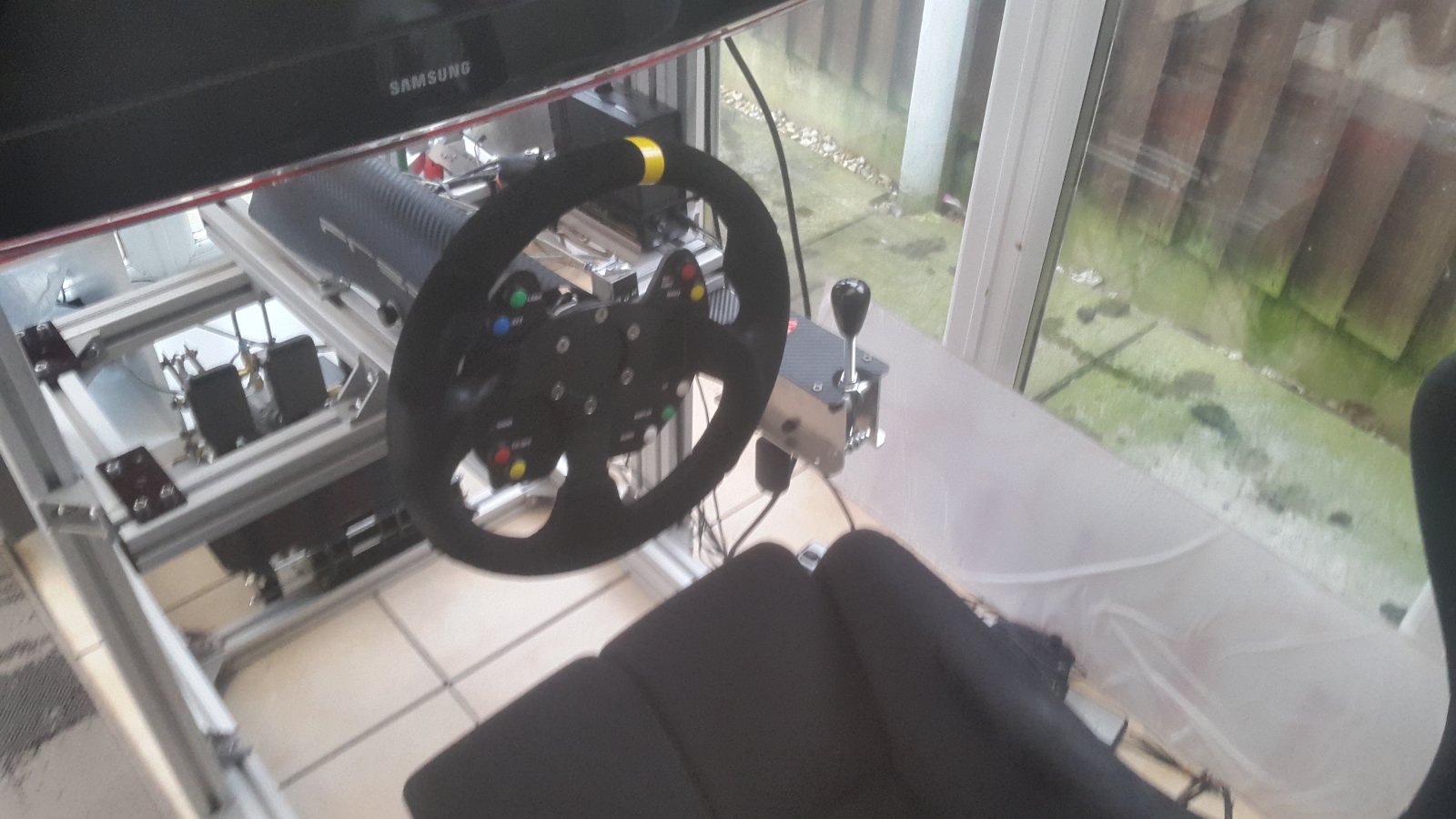

    Im planning on modifying my existing 8020 rig with a 2DOF seat mover.
    Im going to move the rig forward and add it onto the back.
    These are the motors Ive just ordered. I think these will work?

    Your compact build is really impressive. Do you lose any performance compered to a more standard setup with shoulder height mounting points?
    I weight 100kg so it needs to be pretty sturdy.
    20,551
    145,124Coins
    +10,778 / 52 / -2
    With a shorter design leverage length you do need the type of motors you are getting for a compact design, as more torque is required to drive it.
    But the upside is that you only have to move the base a small amount and the seat back height acts to influence the linear speed of the seat itself.
    All designs have their pros and cons, I was just mentioning the option because you seem to have limited space. With a compact style sim you still need to maximise the leverage design length as much as you can, but it can work well. Mine has had people around 130-140kg use it:

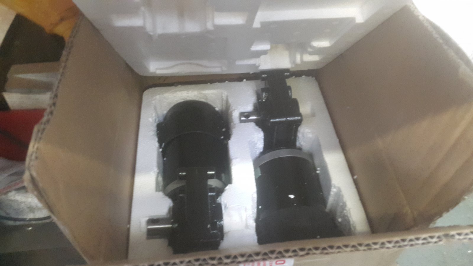

    My motors have turned up. Now I've got a dilemma before I start. I already had it planned in my head even finding materials at work I can use for a shoulder mount.
    I can see the advantages of a compact design but I'm I going to loose any performance? Compact looks like there is a lot less leverage to play with.

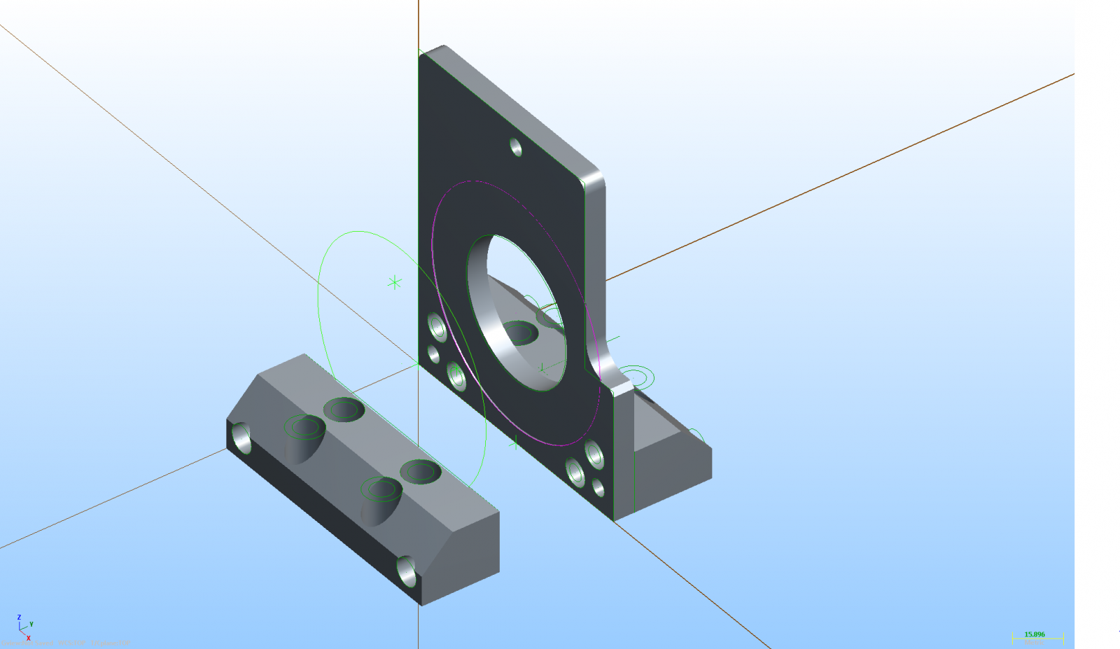

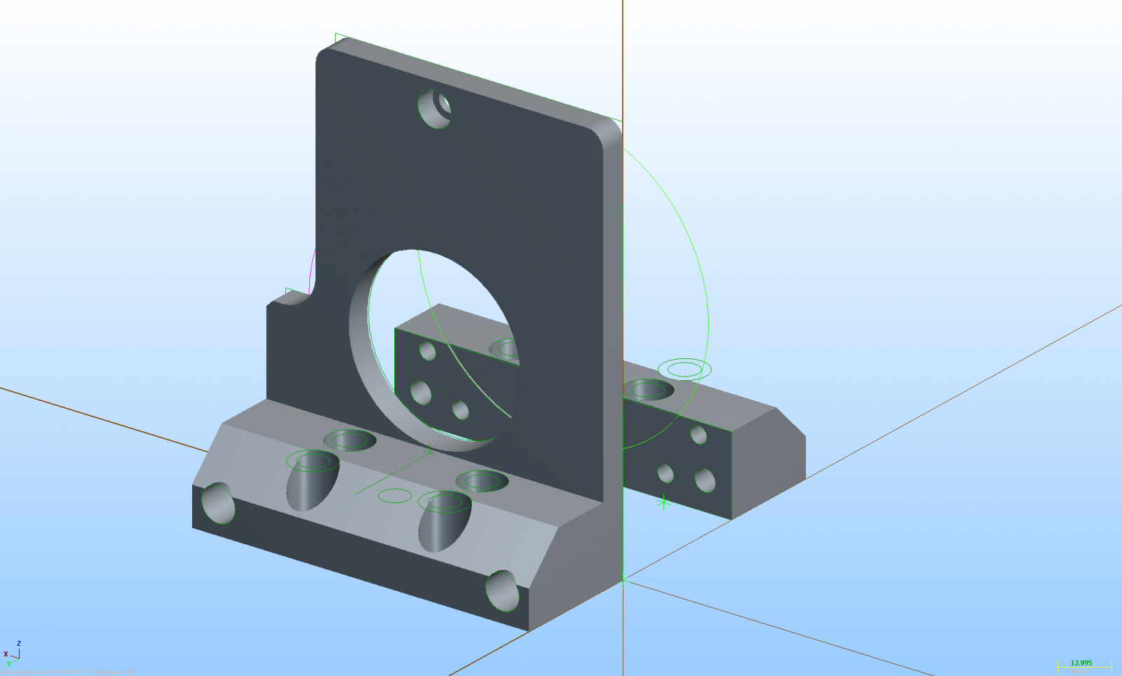

    Here are the motors.
    Im not in any rush with this project and I want it to be to a pretty high standard. Im going to build a 80/20 base then CNC the parts that need to be made.
    Here are the brackets im going to join the motors to the base with.
    They're pretty over engineered but I wont be paying for the material and I dont want any flex at all.

    I see that on most shoulder mounted seat movers the motors are facing straight forward. Would it not be better if the motors where facing in at the front, say at 10 degrees so they are pushing the rods in more of a straight line? Would this not put less strain on the motors?

    Ive been playing around with that app. Very useful. It would suggest putting the motors at an angle would be a good idea. I was just wondering if there was a reason nobody did it.

    i was wondering the same thing too. it has to be how motors mounts can be attached on the rig easier if they face straight and not with an angle.

    Yeah , I thought it might be that or if it alters the geometry of movement. Ive been trying to go over it in my head but cant really imagine how it would in a negative way.
    If I dont get a good reason not to do it Ill do it like that to start off with.

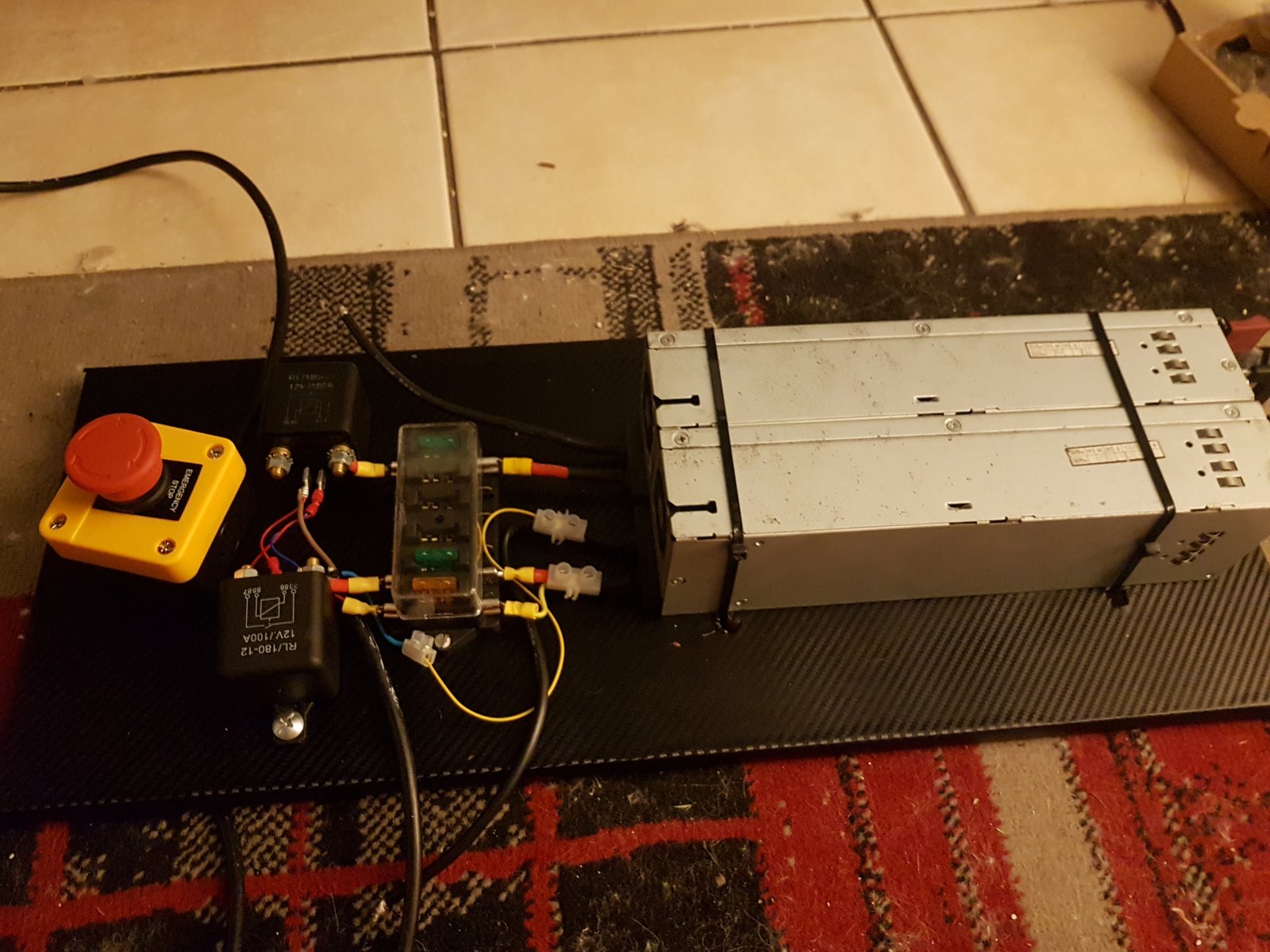

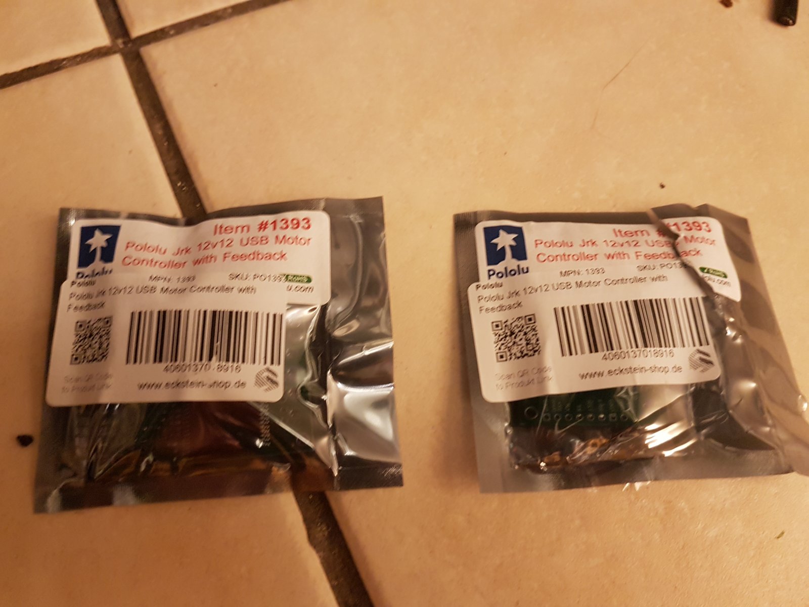

    After some delay Im now in the process of building. I was planning on using mm's mainly for cost issues but after buying 5 from 2 different sources non of them worked. 4 had dead channels and 1 worked but heated up the heatsink while just running smc3 with no load on the motor so hot I thought it was going to start smoking.
    So, what to do? Buy more mm's and throw good money after bad? If id had any that worked then I probably would have done but as all 5 didnt work I decided to go for JRKs. 20171019_201928.jpg

    Power supply, fuses and relays all wired up ready for the JRKs to be installed.
    The aluminium extrusion for the rear frame should arrive tomorrow. Ive been machining parts so am looking forward to showing you what ive been making.

    They look interesting. I didn't know there was any other dirt cheap options other than the mms.
    Do they work with smc3? I've already bought the JRKs now but could be something to look at in the future.

    yes - i use the SMC program
    i am also using one for a FFB wheel design
