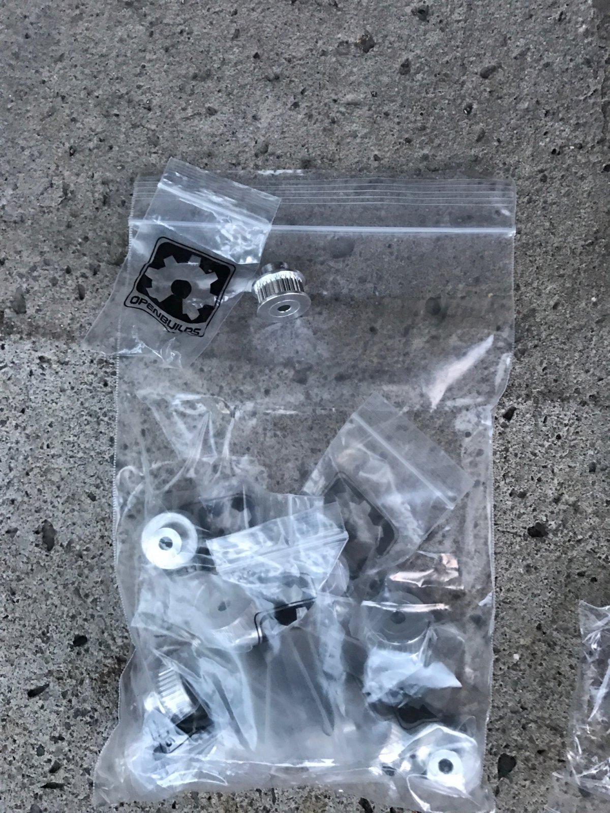

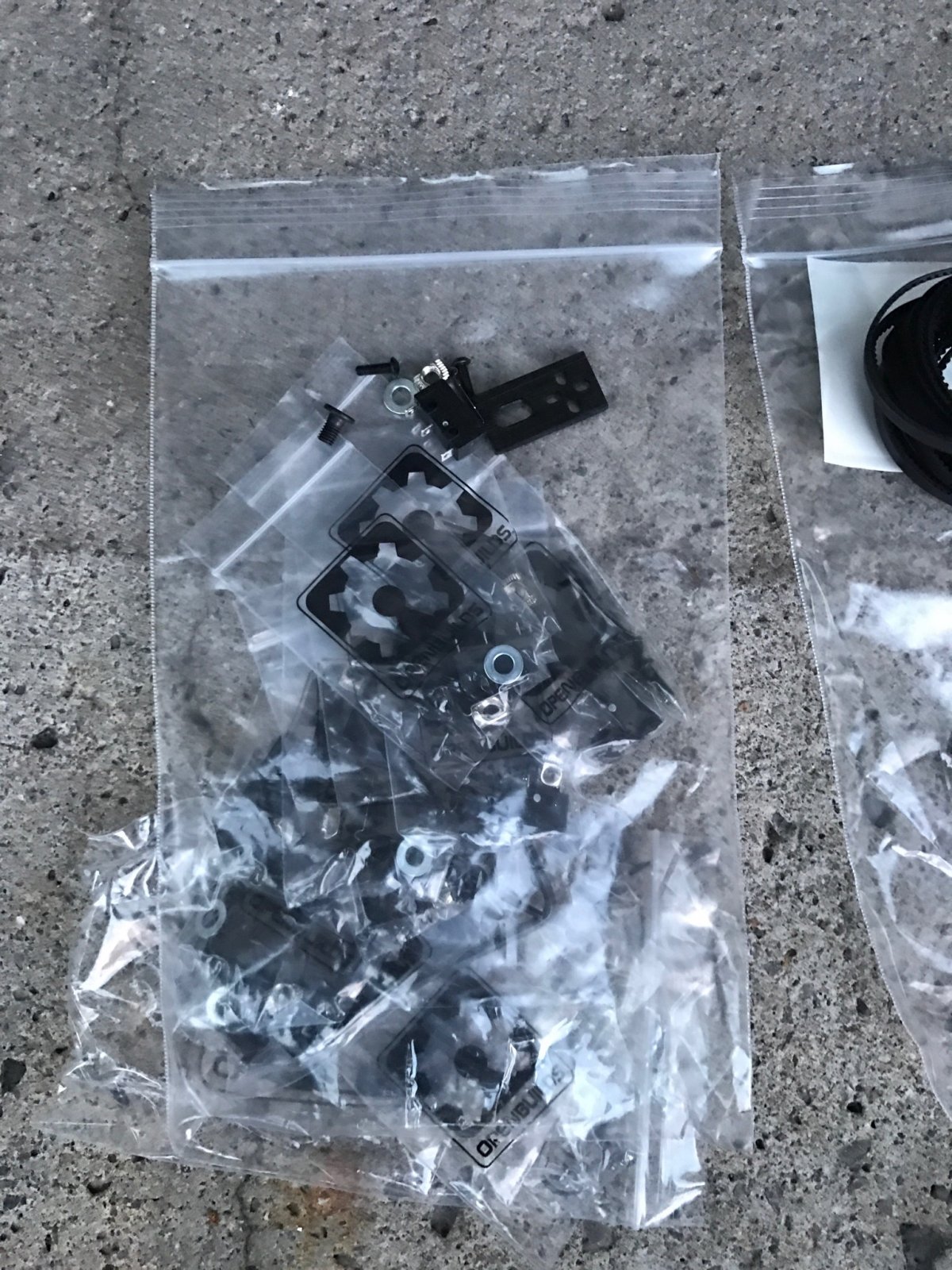

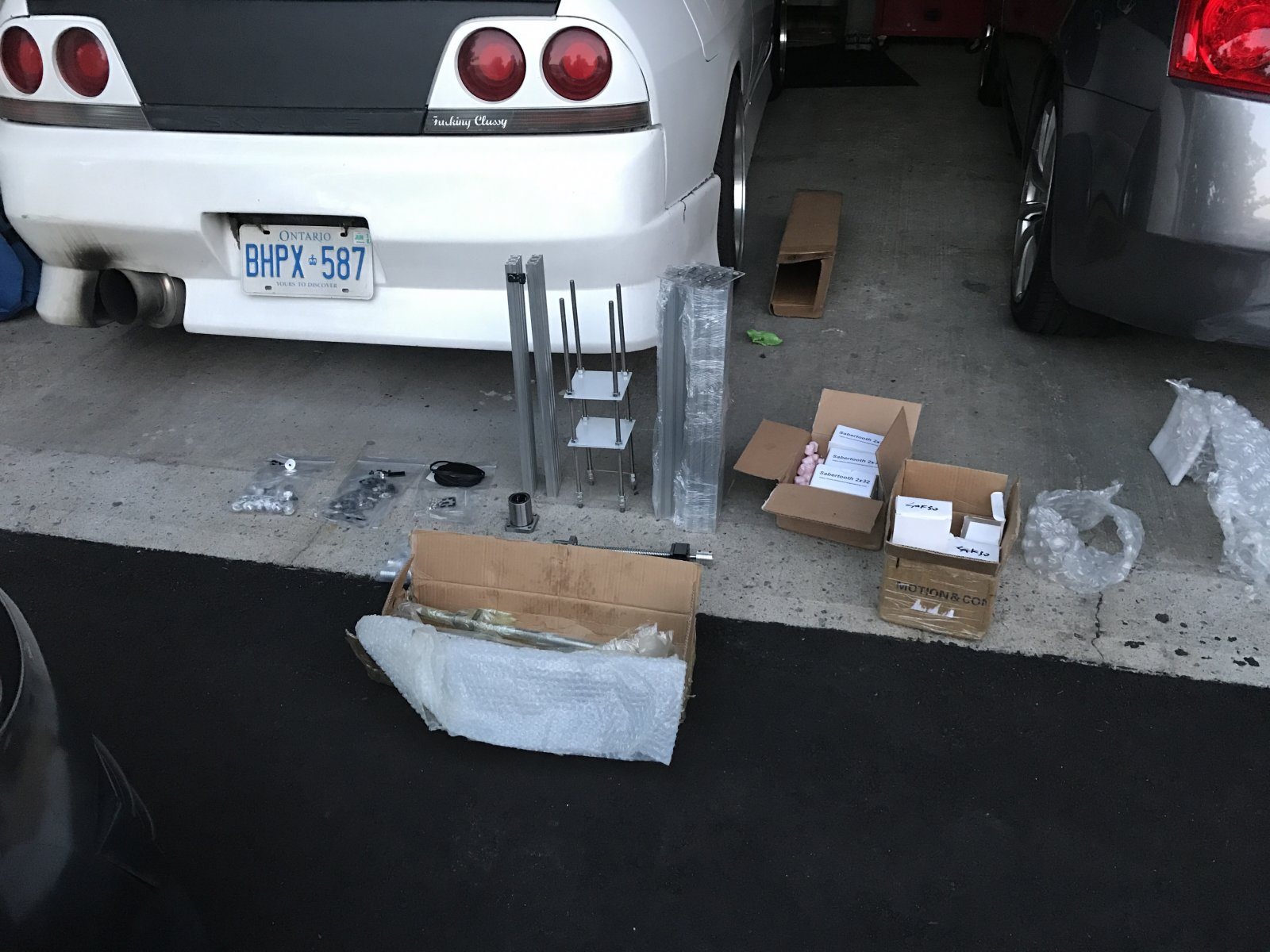

    Thought it was time to start a thread. Have been reading so much since I tried a very basic sim at Formula1 this year. This forum is a wealth of knowledge that it almost makes building one of these seem simple LOL.
    So after much reading I opted to use @wannabeaflyer2 DIY linear actuator setup. I've received a bunch of goodies as well. Didn't realize how much this costs with the crappy USD to CAD Exchange rate.
    Guess I could call it Christmas in July.

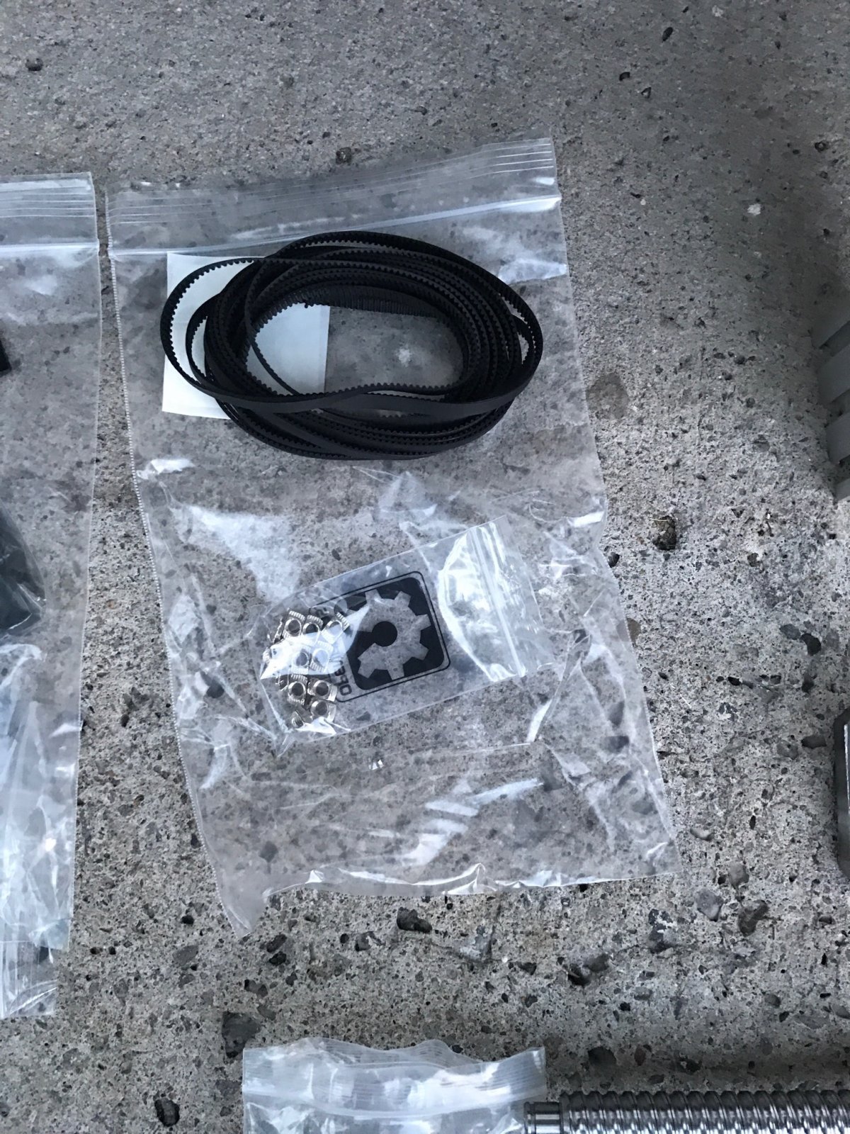

    Openbuilds belt
    Openbuilds switch with mounting plates
    Gear pulleys

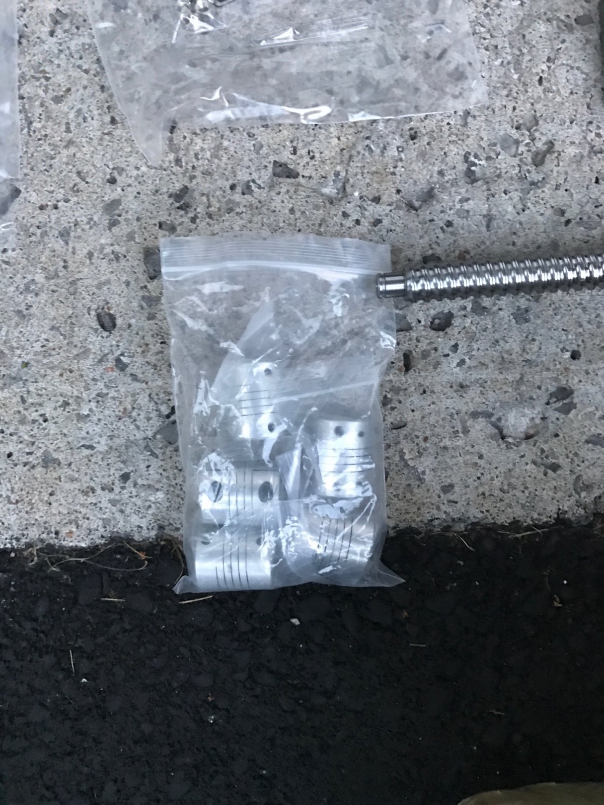

    Ballscrew to motor coupler

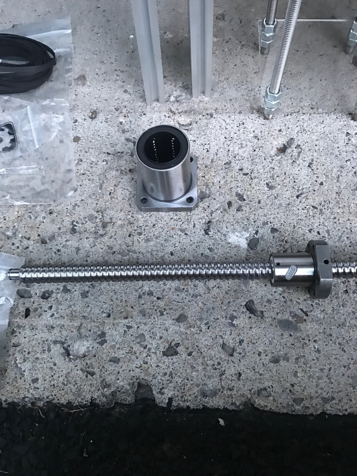

    Cheap Chinese linear guide and 1605 ballscrew

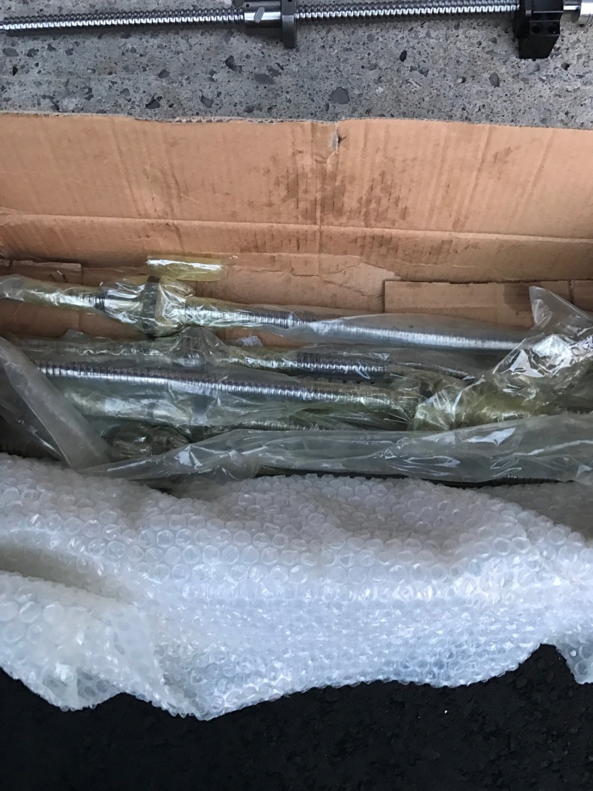

    Box of ballscrews

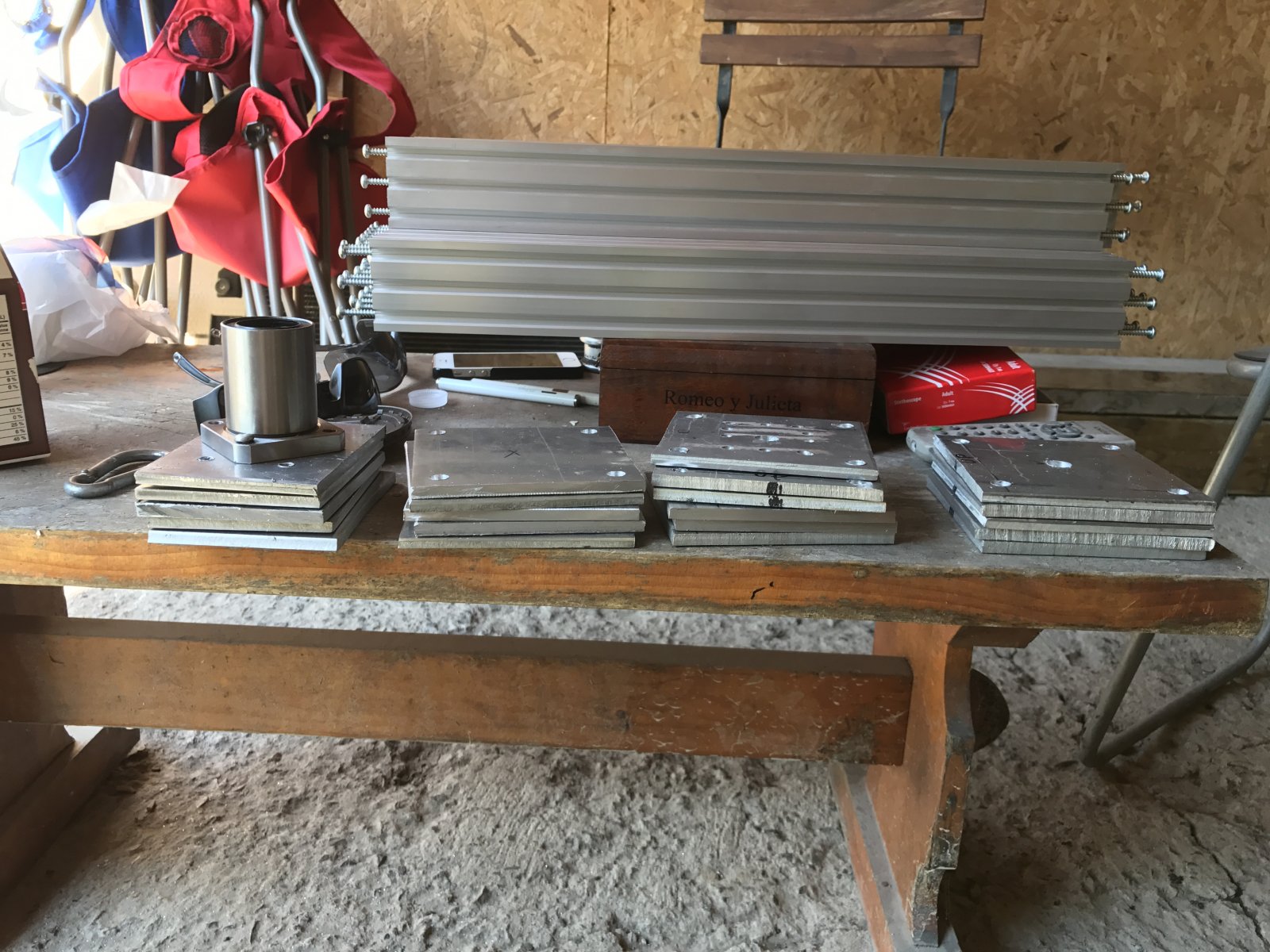

    Mini mockup out of plexiglass to make templates for easier production and all the parts acquired thus far including
    20x60 openbuilds linear rails
    32x2 sabertooth
    Bk12 ballscrew base
    I'm likely to have a million questions once I move and can start building.
    Thanks to @wannabeaflyer2 @SilentChill @Pierre Lalancette as these were largely the threads and videos that drove me to this madness.
    I hope the kickstarter campaign for the AMC controllers pans out as I have yet to source that.
    I also am having trouble picking a good motor. I seem to think these amp flow e130 motors should fit the bill. Any advice or recommendations?

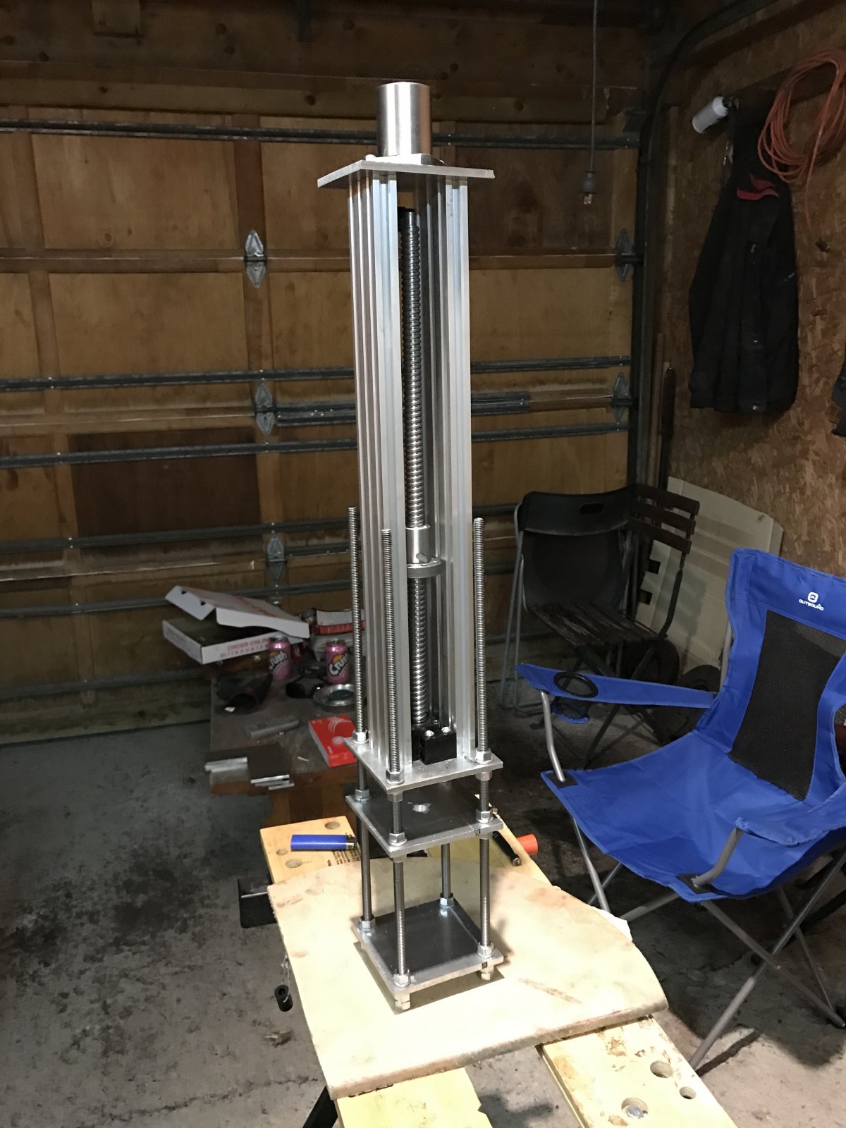

    Got to working this afternoon and whipped up the first linear actuator in rough form. Took me about 6 hours to drill and plan it all out.

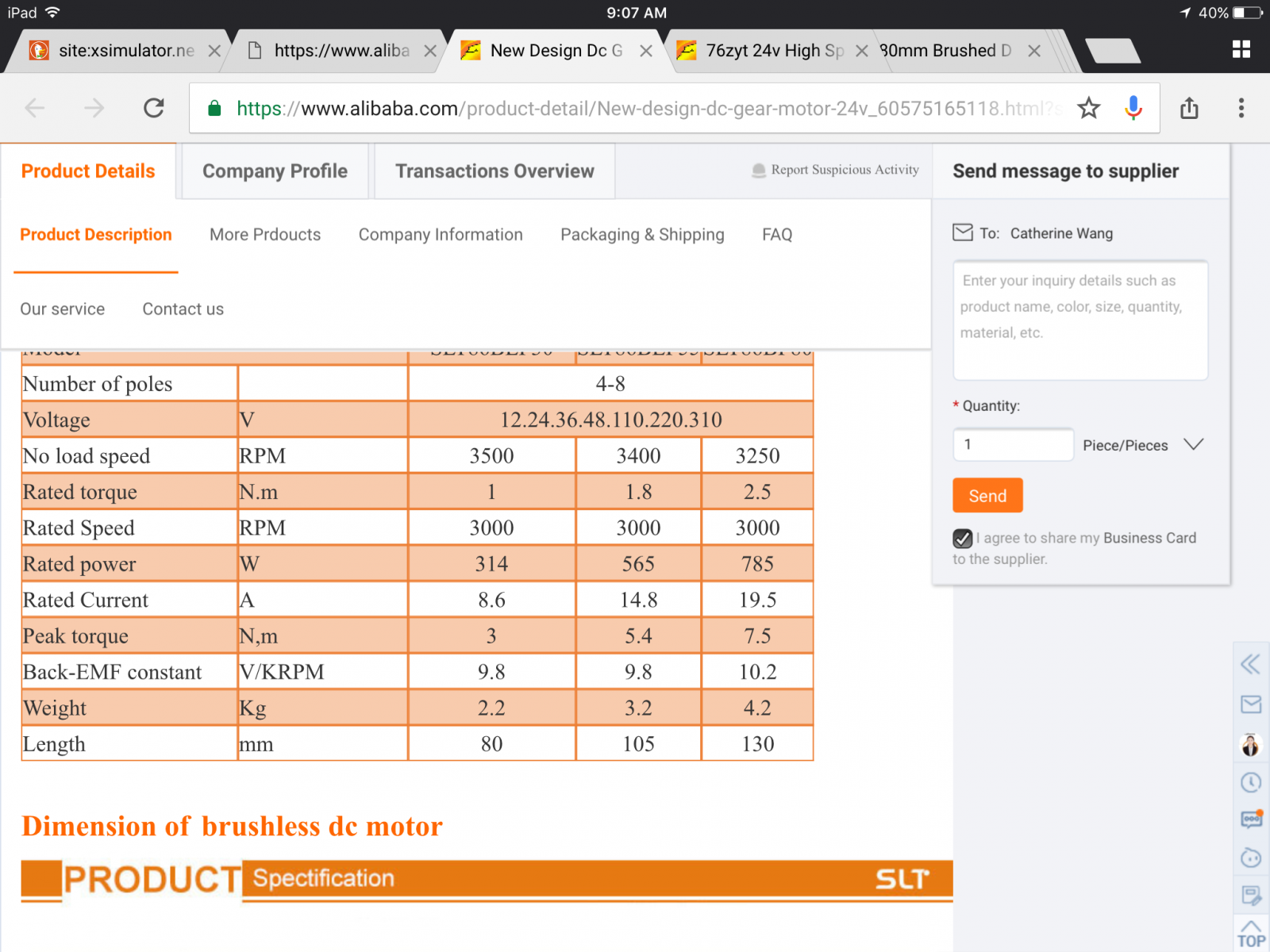

    Any help with motor selection
    This seems to be an option to me SLT86BLF55 model

    It's the middle column motor 565w

    Depending on your body weight and the weight of the upper frame, I would think that 565W may be a bit on the high side. Over engineering is OK but once you start drawing more than 32A or you go to 24V the driver board selection comes into play. So it might be best to consider the motor and driver board at the same time. @SilentChill and @wannabeaflyer2 diverged at this point with Craig going for 2x60 Sabertooths and batteries whereas @wannabeaflyer2 stuck with 2x32 and resistors.
    You really need to read both of their threads carefully and weigh up the pros and cons of both approaches before you buy the motors.

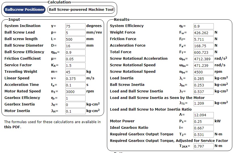

    Hello @beng2k. Sorry we all brought you into this simulator construction madness, fellow Canadian. ;)
    If you read my thread, you came across this:
    https://servotak.eu/tools/engineering_calculator
    I tried to remember/understand the way to calculate all this, using an inclination on 75 degrees and a load of 45 kg. Please, verify everything again as I am wrong most of the time. :think
    So, if I did not do anything wrong, you need 250 W of power, so you are covered with the 565 W. All torques are well below the 1.8 n-m rated torque of your motor. But the 0.667 Ideal Gearbox Ratio raise a warning into my head that I may have overlook something. Let's hope someone more qualify takes over my calculation and give you all the right info.

    Some have found that the motor couplers you have got snap pretty easily. For this reason I went for the 'Plum' couplers with a polyurethane core. Just a thought :cool:

    My.stAr Active Member
    Sep 7, 2012
    151
    Engineer
    1,064Coins
    +61 / 0 / -0
    DC motor
    Can you use a brushless DC motor with the sabertooth?
    I have no clue, but afaik usually brushed dc motors are used with sabertooths :roll
    /edit: on the DimensionEngineering page i found this for the sabertooth 2x32:
    "Easy speed/direction control for pumps, conveyors, automation and any application that uses two brushed DC motors"
    So no BLDC possible!
    Also found this short video that shows, that it's not working. In the comments it's also explained.

    A great tool to play with:) i calculated everything in excel:D
    Some points to consider:
    The "traveling weight" is the axial load on the ballscrew, not the load from the top (~(your weight+rig weight)/6). so if your actuators have an angle γ of 45° (what could happen if your platform goes completely down) you will be able to lift not45 kg but only sin(45°)*45kg=31,8kg. So you Motor has to lift more than 40 % more than the load from the top. This is the first point.
    The second point is the gear box :D
    No one would you a gearbox with an linear actuator. The "ideal gearbox ratio" is given because of the difference of your ballscrew pitch, rpm of motor the wanted linear speed. If you enter the right values, the "ideal gearbox ratio" is 0. You have your ball screws with 5 mm pitch. If you have your motors, you can calculate your linear speed: rpm [1/s]* pitch [mm] = Speed [mm/s]. so for 3000 rpm you'll get a linear Speed of 250mm/s and for 4500 rpm -> 375 mm/s.
    The angle γ for your calculations should be the lowest for you rig, since there is the biggest load for the Motors. And for the construction you should set γ as big as possible ;) But not too high, because you'll lose the way in sway and surge direction;)

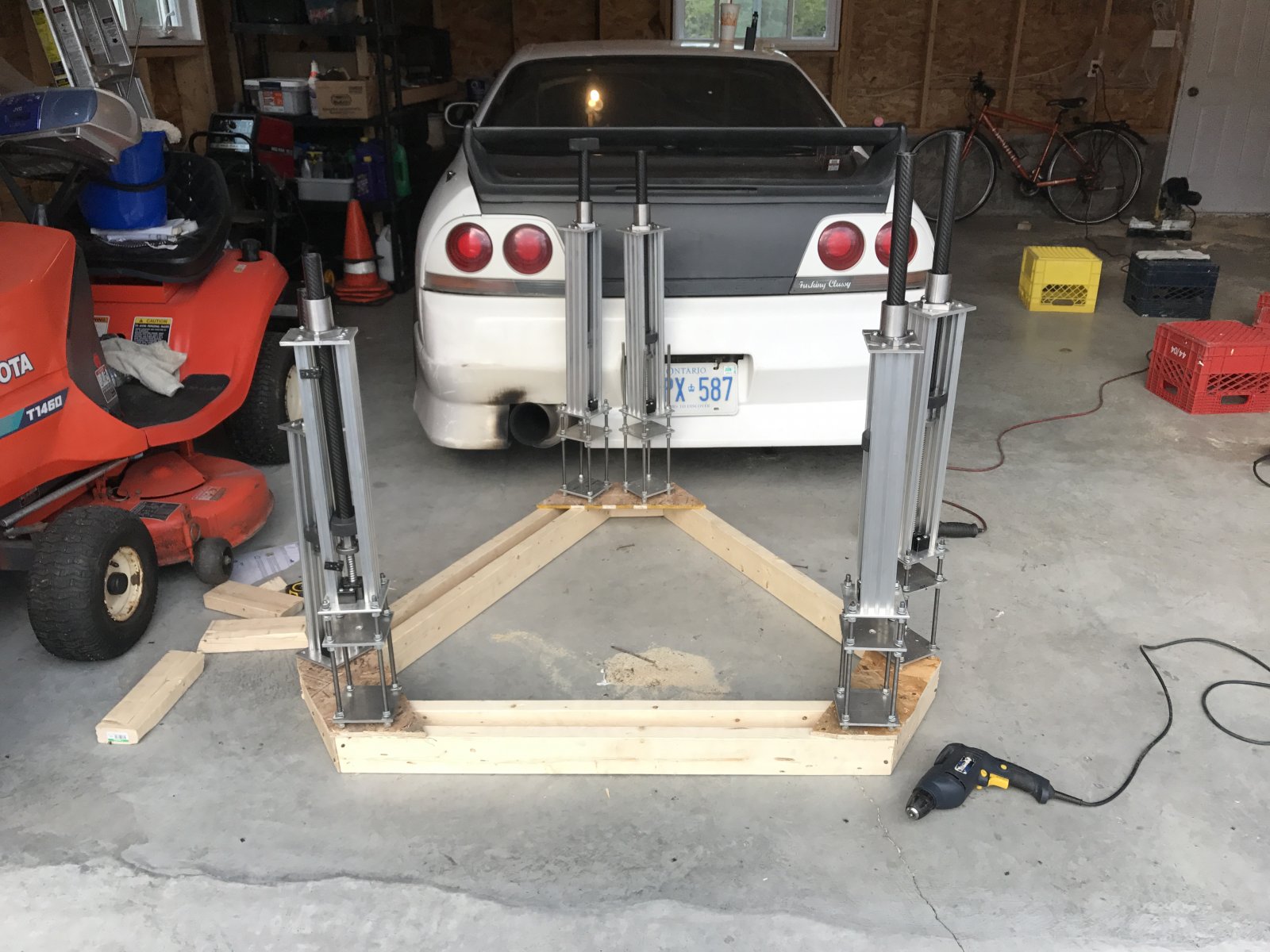

    Progress has slowed. Bought a new house so lots to keepe busy including my home automation projects.
    I have ordered motors similarly spec'd as the parvalux motors being used from China. Well see how they do.

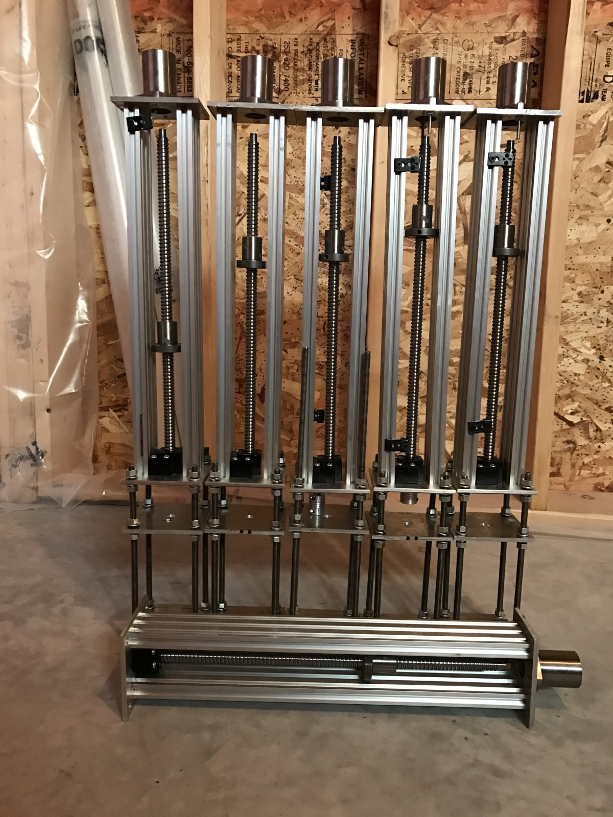

    Finally built the main actuator arms. I did run out of nuts on the last arm but I now live 45 mins from town so not as easy to get things now.
    Here are my completed arms minus the motors. Started to mount some limit switches and working on sourcing the shaft components and joints next.

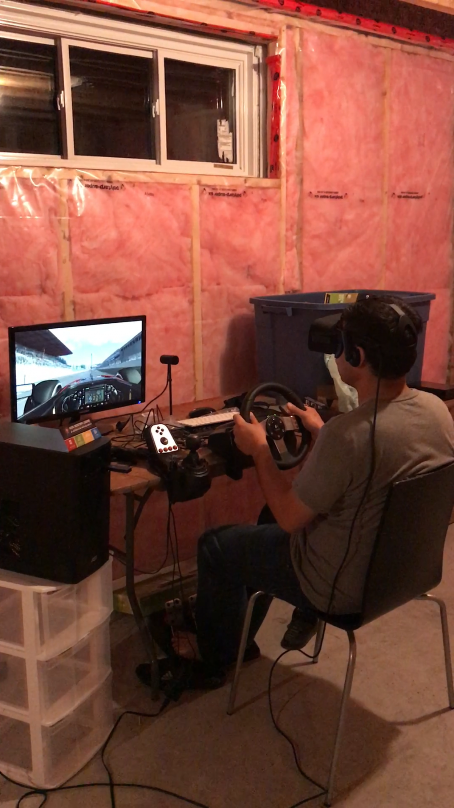

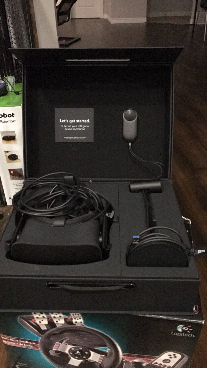

    Bought a GTX1070 and Rift. Got the Rift for a great deal $400CAD used. Even with a no motion setup it's insanely fun.
    Been practicing my F1 Rally and Drifting lol (I do drift in real life)
    Built the base mostly and looking at options to fix the arms to the base. Should to u joint be fixed at both end or can they rotate on a rod and not be fixed to the rod. Ie dropping the u joint between the base and arm without actually fixing the u joint to the rod sitting on the base
    Do you guys think that a 30mm OD 28mm ID carbon tube will be strong enough or should I get a 28mm OD 26mm ID to bond them together?
