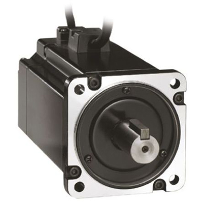

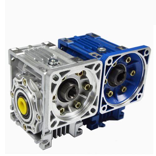

    1-08/2017 : choice of motors and wormdrives
    I will buy 6 of : http://www.schneider-electric.com/e...ey---20-bit-encoder---w-o-brake-straight-con/
    with 6 servodrive : http://www.schneider-electric.com/e...-23---single-phase-200...255-v---750-w---can/
    I have really good price @work !
    And for wormdrive : NRMV040 with 80:1 ratio : http://www.zetek.ru/files/en/Gears/pdf/wormgeared_motor_nmrv.pdf

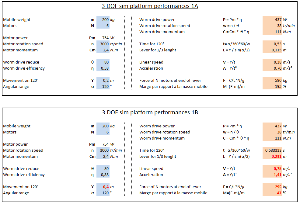

    And here are my final specs for around 20cm and 40cm of heave movement :
    Excel files is available if needed, just PM.
    I made a lot of attempts before choosing these ones, with different ratio, motors, levers ... to have good linear speed/acceleration and enough torque.
    My motors will work on 120° to have less radial movement.

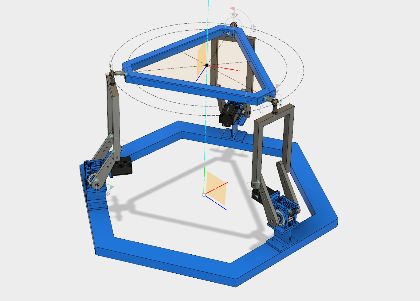

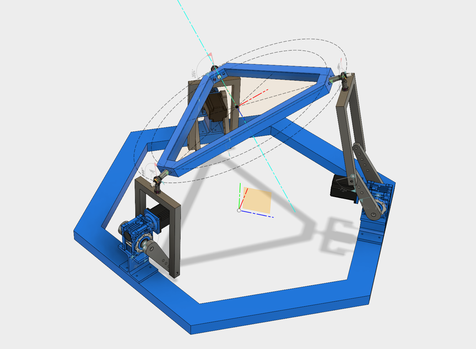

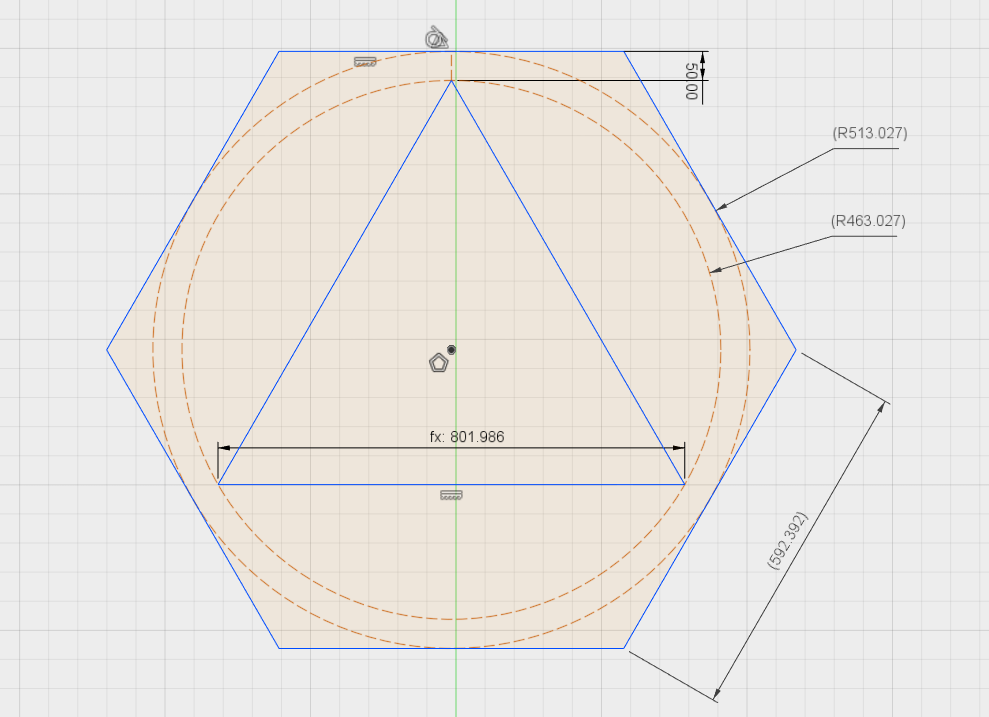

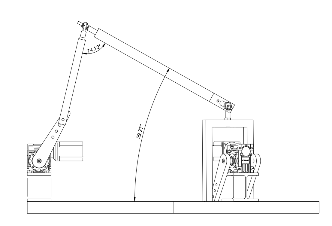

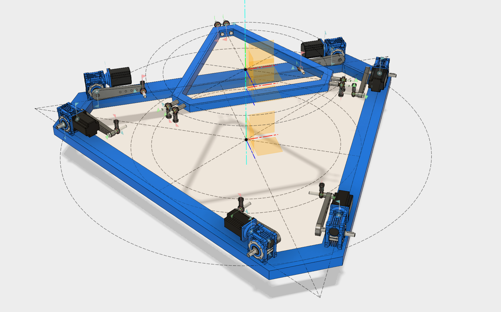

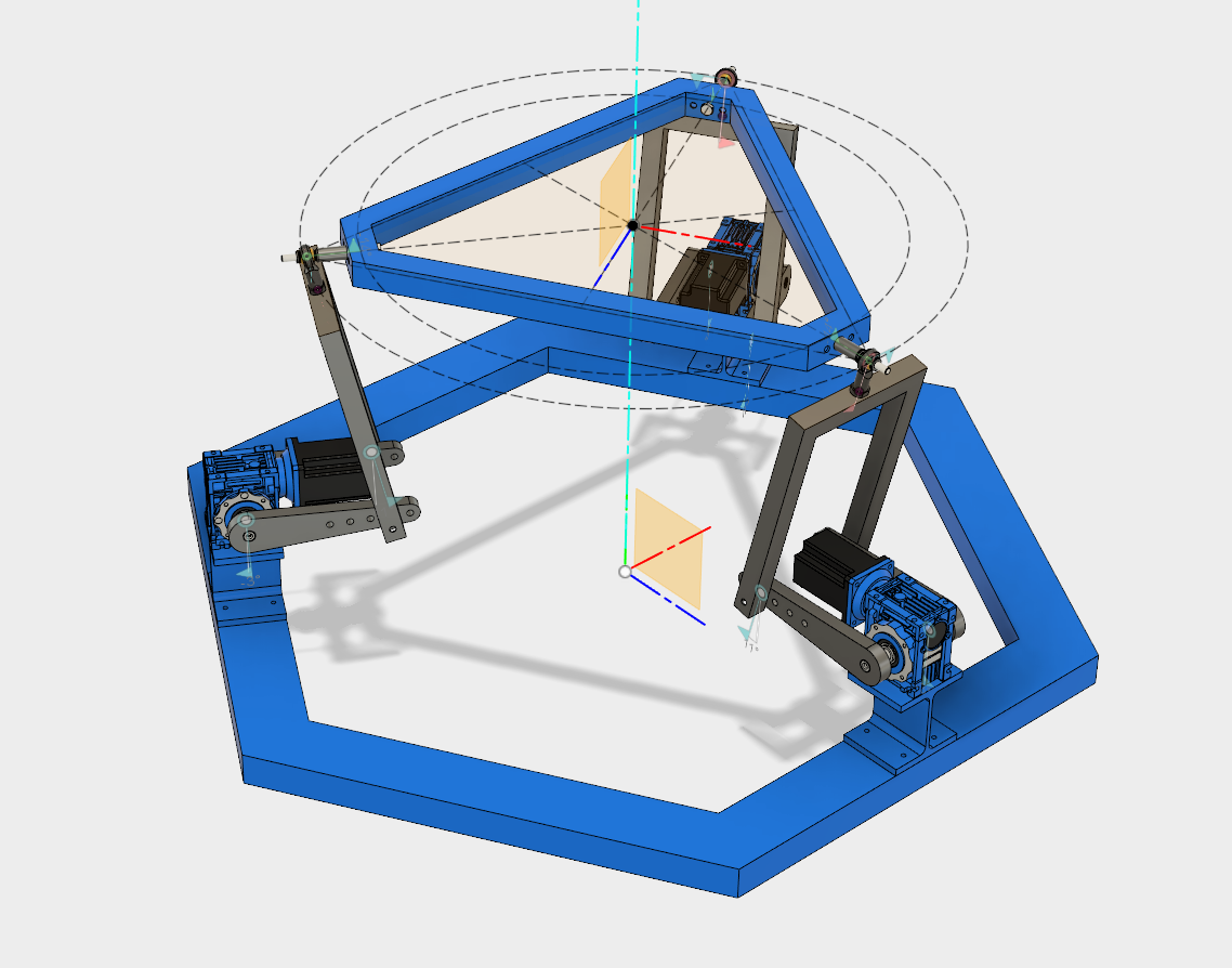

    2-08/2017 : a little bit of design
    Sorry but I'm beginner with Fusion 360 software.

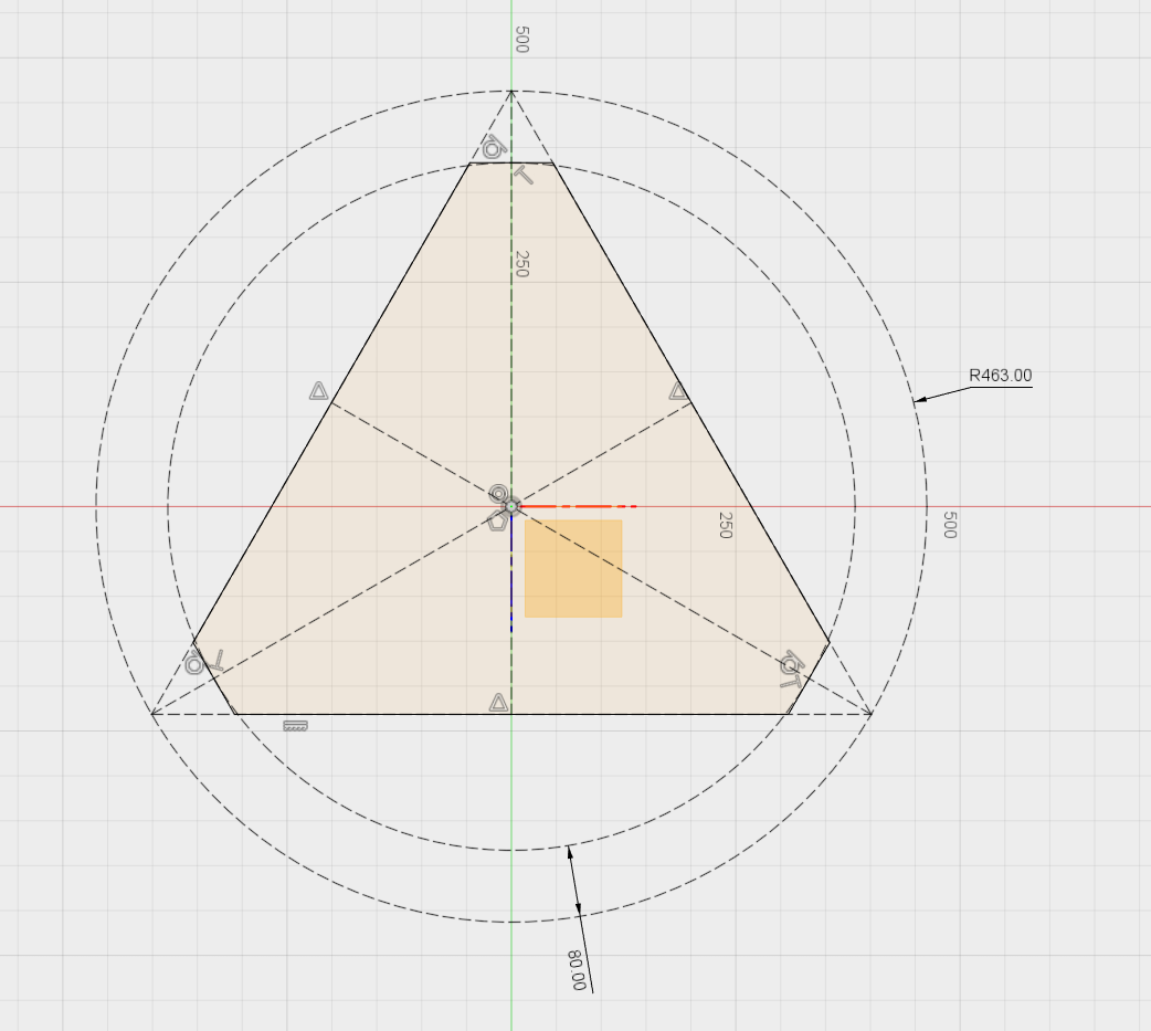

    Determination of global size, function of angle and lever :
    Static part :
    Mobile part :
    And beginning of 3D :
    And a draft :
    And now ? I really have no idea how to put mobile and static part, which angle, radius are the same ?
    I would need your help now to continue the project ! @Thanos @noorbeast
    Thanks a lot

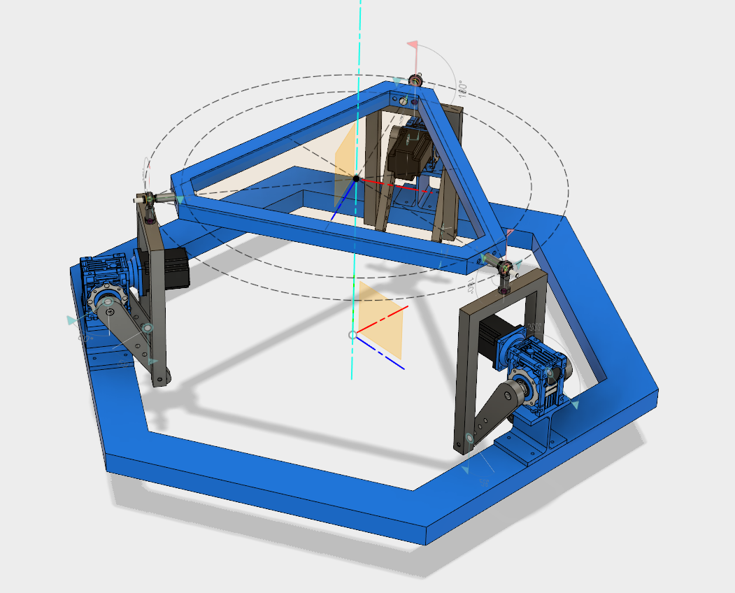

    Hi guys,
    to begin with design, I start this morning a simplier 3DOF platform
    Middle :
    Down :
    Up:
    Total heave : 350mm

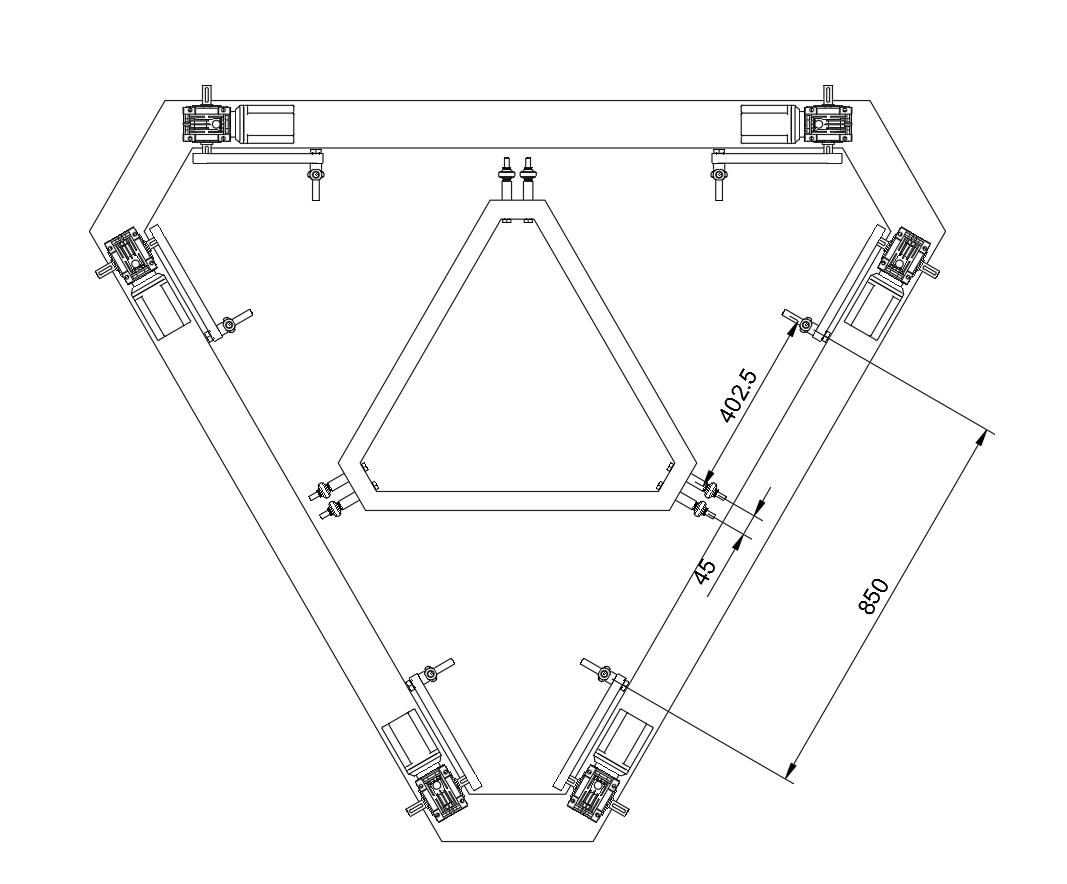

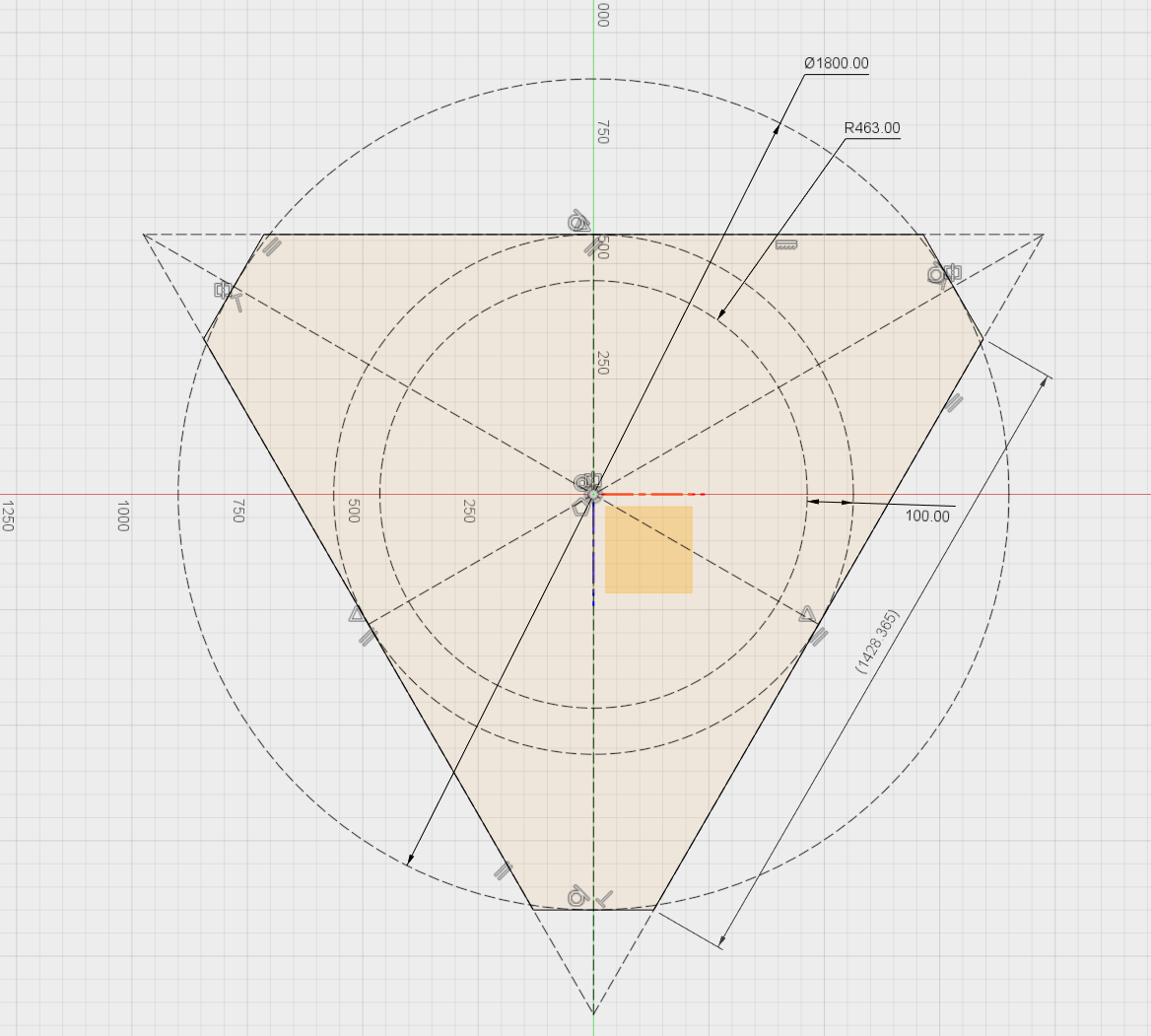

    Design of the platform
    Linear actuator can move by 450mm, and rod ends are fixed to 35° max (will adjust once I get them). Radius of mobile is 40mm less than base platform.
    Here could be a design with 500mm of space between 2 rods on the base, 6 DOF :
    https://www.youtube.com/watch?v=MxrOtjXoJ88&feature=youtu.be
    I also tried with 1000mm between rods
    To sum up values :
    My questions are :

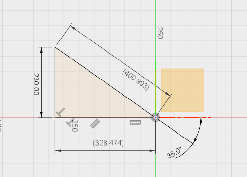

    1-I see a lot of people with radius of platform nearly the same, I put 40mm, is that good ? how to choose ?
    2-We can see that with 500mm, all movements are better than 1000mm, Is there a limit ? is that a stability problem to have a really little space between rods ? what is the limit ?
    3-A lot use U-joint for base rod end, is there a special reason ? M14 rod end couldn't do the job ?
    Thanks for your help guys !

    I tried with u joint at the bottom and the top of linear actuators but I cant do anymore Yaw. I assume it's due to the lack of rotation in the u joint ?
    We need a rod end and a u joint right ? Thanks

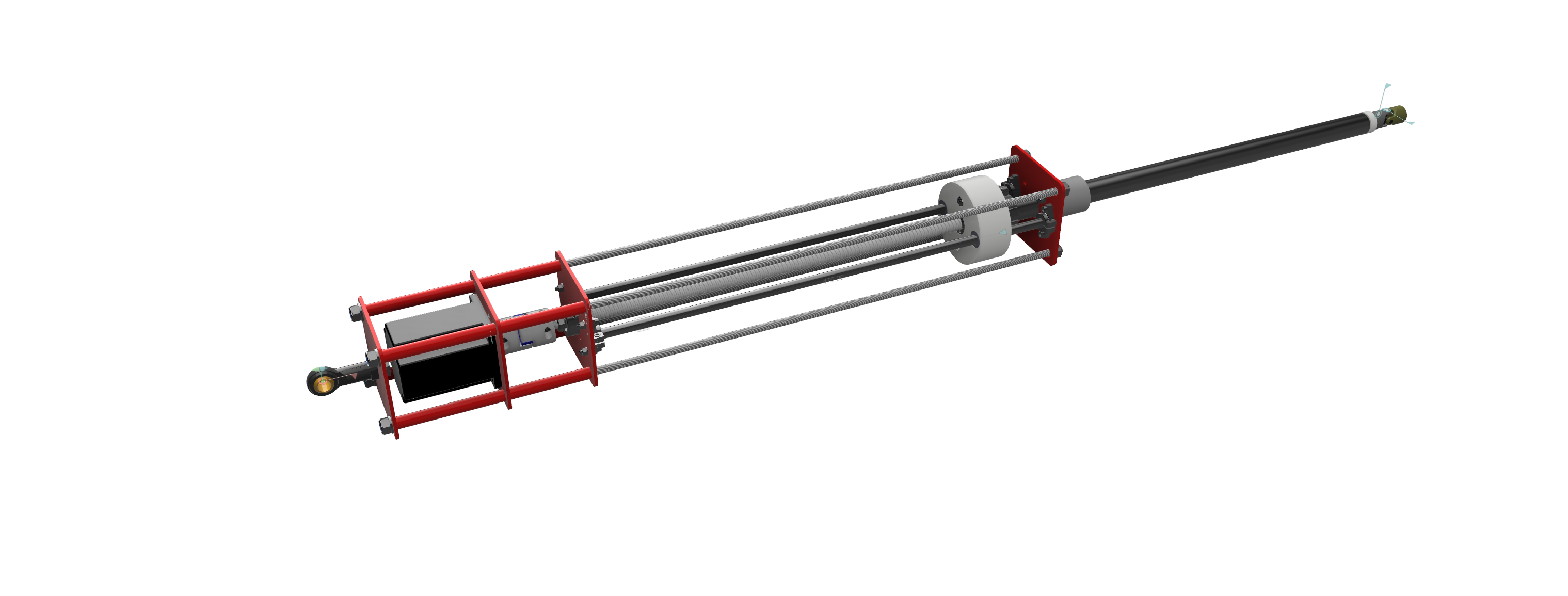

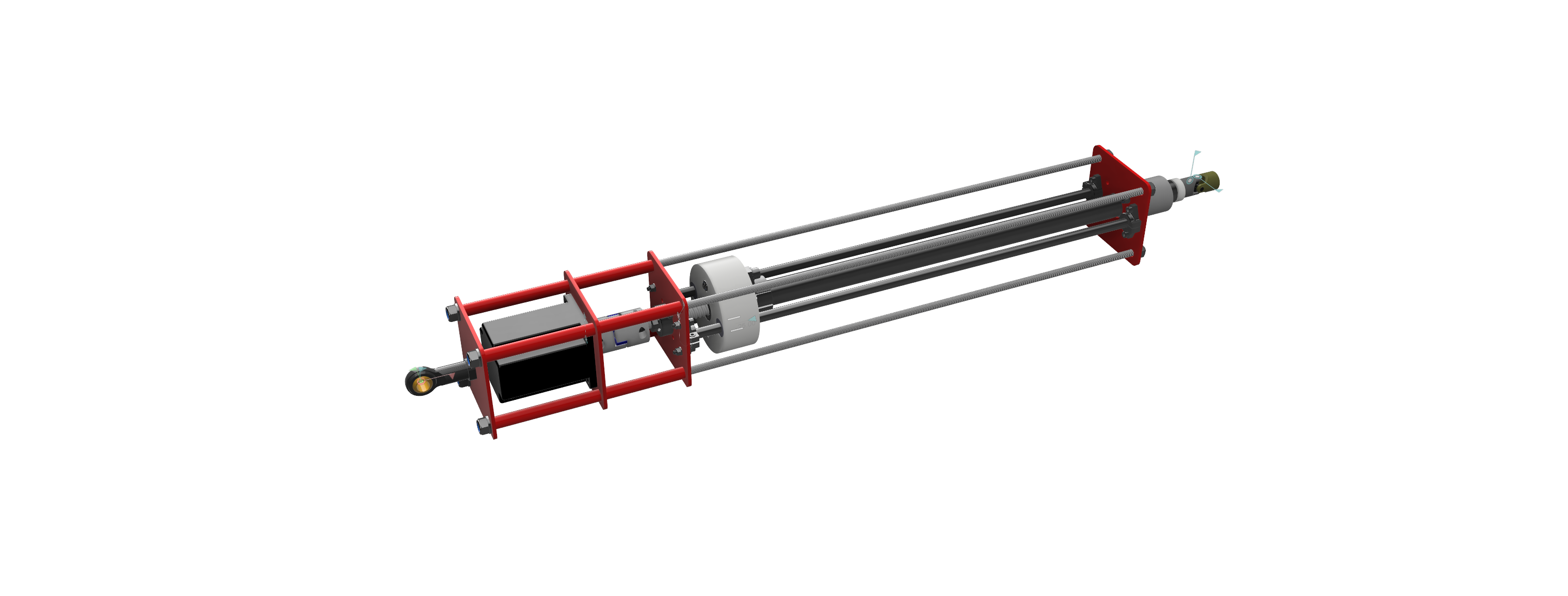

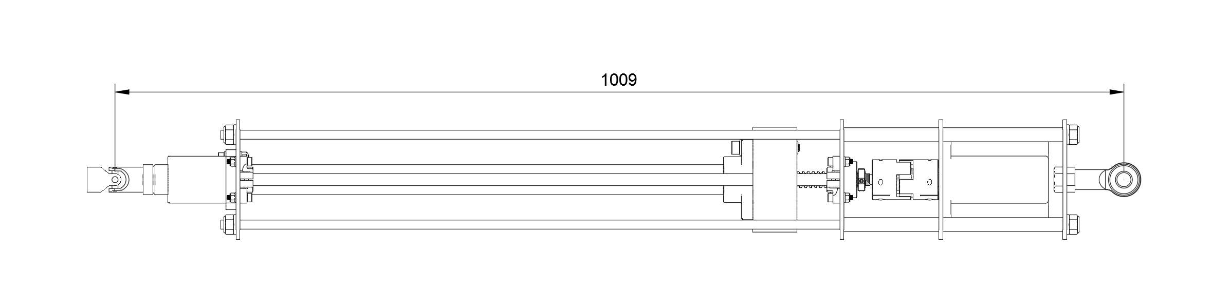

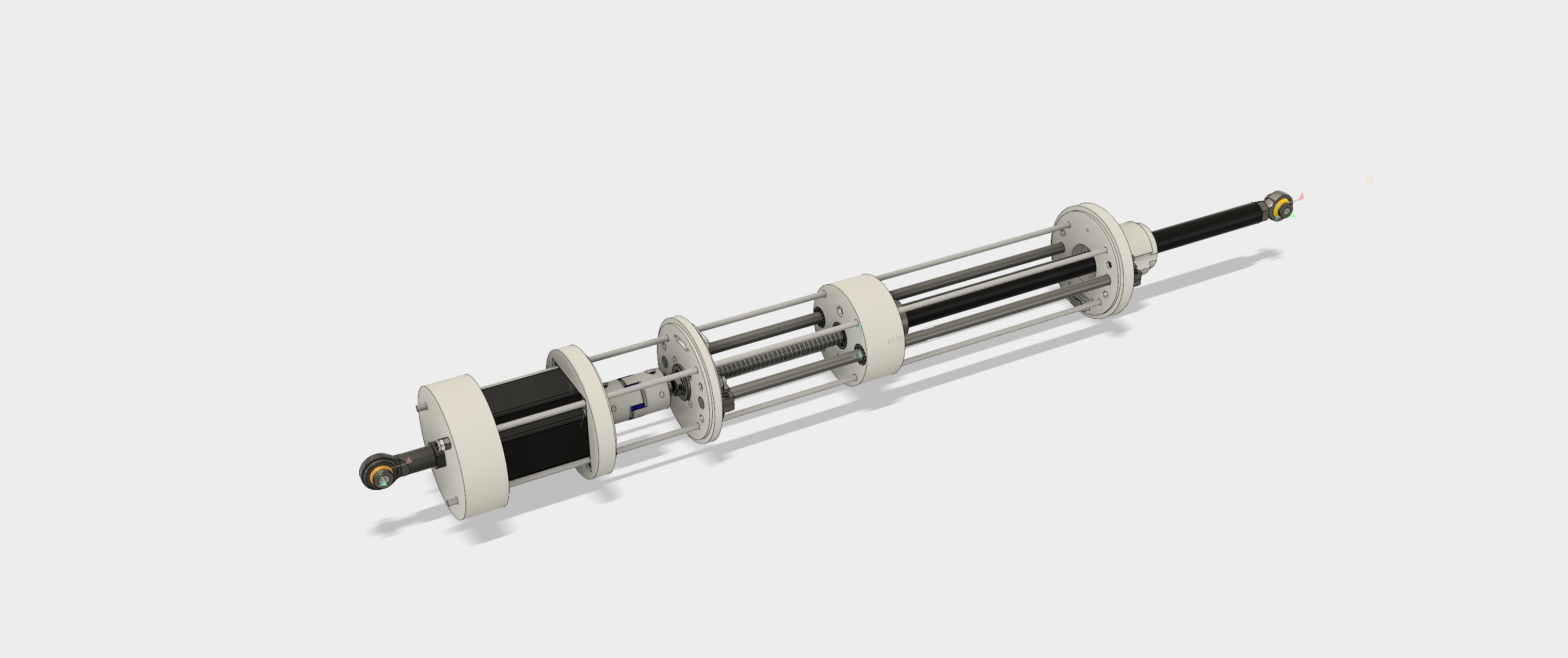

    Hi guys,
    I made some little progress, here is my linear actuator, inspired from @Hoddem and @wannabeaflyer2
    using 2 12mm linear guide for 12mm bearings and one 30mm flange bearing on the top.
    Just CAD for the moment :)
