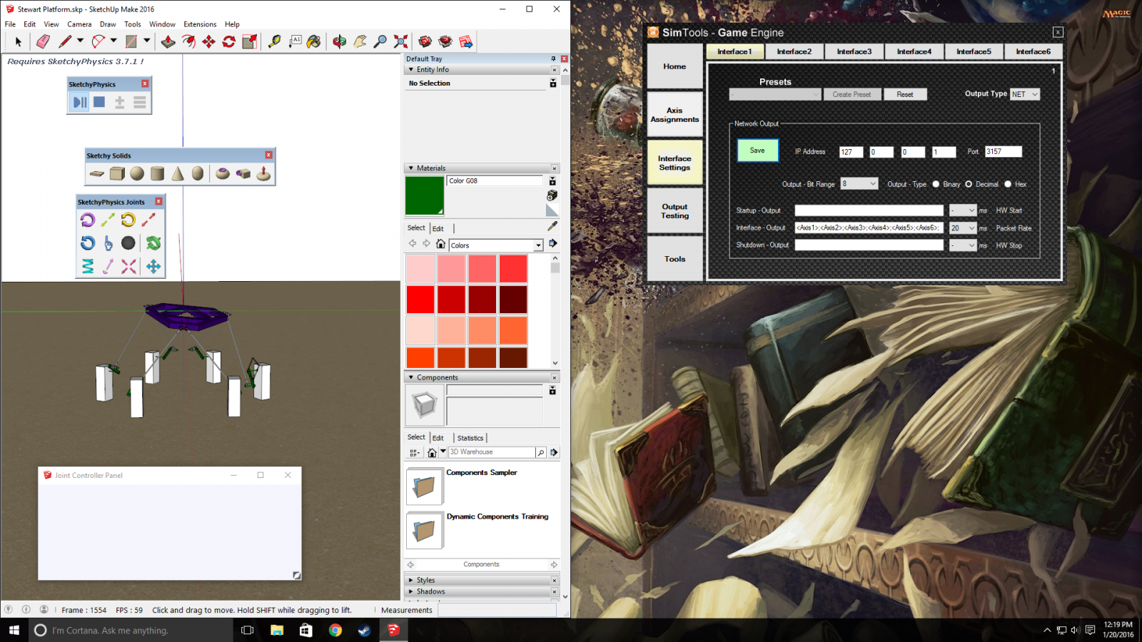

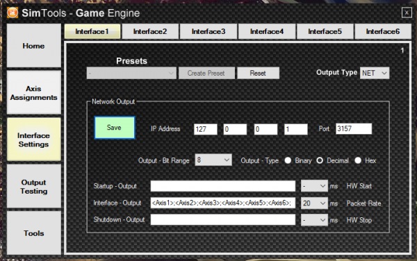

    Hit a hiccup with the simtools controller in sktchup... For some reason it only outputs to axis 1, 2, and 3. Also I'm curious why it says requires sketchyphysics 3.7.1! in the top left corner. I have the 3.7.1 installed.

    Before moving on to other things did you run the simple model I linked to with the settings I provided with LFS?
    I just want to verify it is all working before the complexity of a 6DOF model is added.

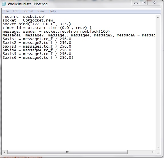

    You will also find axis 3 inverted ... maybe this next link will help ... plus maybe " I didn't try this " adding a 4,5,6 Axis in the ruby file " when edited as text" will solve your 6 DOF Single Interface output controller problem in SimTools .
    http://www.xsimulator.net/community/threads/sketchup-sketchyphysics-simulation-faq.7864/#post-95596

    Thank's speedy, that was exactly the solution!

    Thanks @noorbeast ... I guess it will be like this ...
    require 'socket.so'
    socket = UDPSocket.new
    socket.bind("127.0.0.1", 3157)
    timer_id = UI.start_timer(0.01, true) {
    message, sender = socket.recvfrom_nonblock(100)
    message1, message2, message3, message4, message5, message6 = message.split(";")
    $axis1 = message1.to_f / 256.0
    $axis2 = message2.to_f / 256.0
    $axis3 = message3.to_f / 256.0
    $axis4 = message4.to_f / 256.0
    $axis5 = message5.to_f / 256.0
    $axis6 = message6.to_f / 256.0}

    It's alive!!!
