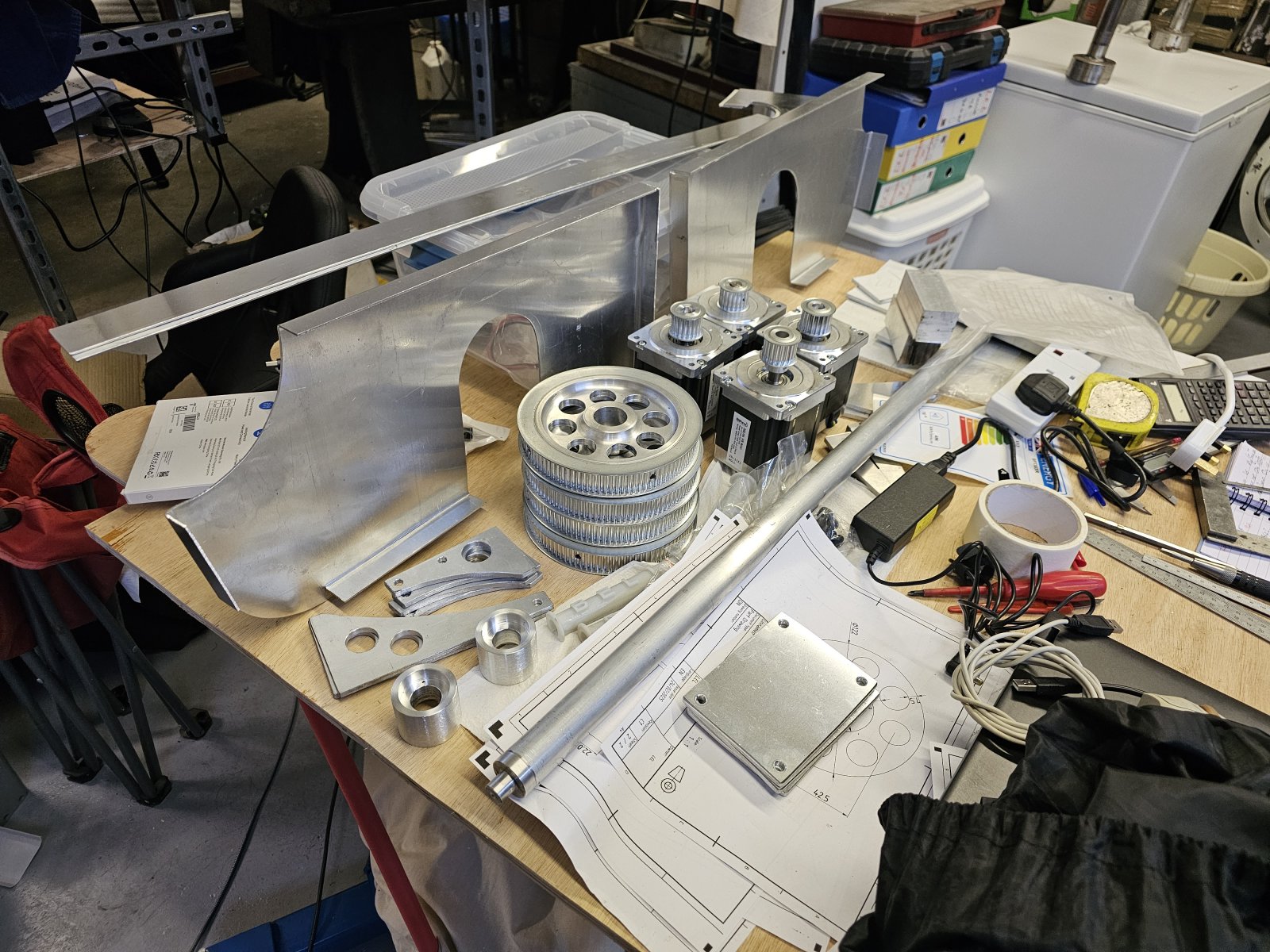

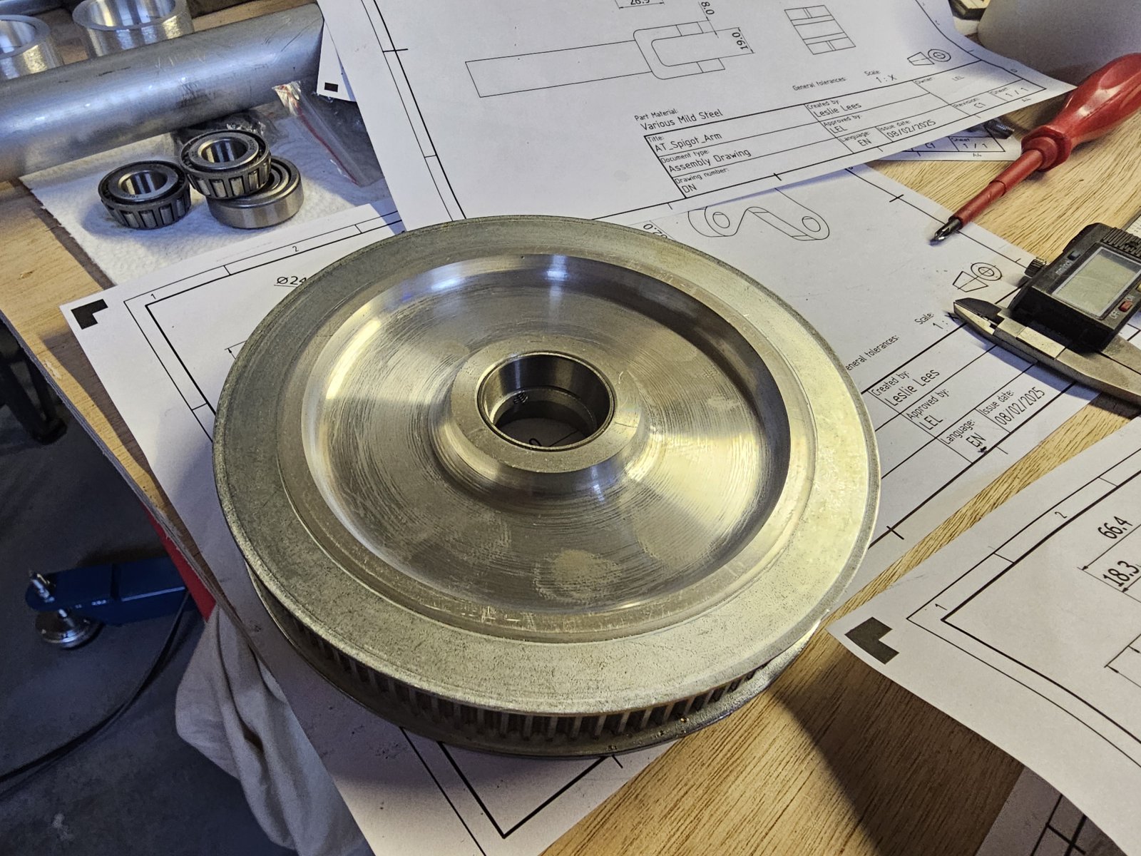

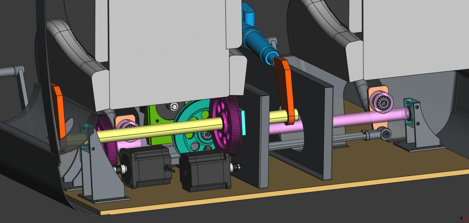

    So....my four pulleys turned up and I was dissappointed, at the weight of the box. So the concept I'm going to apply is that I'll turn all the hello parts into something resembling swiss cheese.
    In that I make holes in every part that I can, as long as it doesn't detract from the visual look of the helo. The pulleys for instance can be both hollowed out by dishing both sides and then create holes through the web that is left, that should by my reckoning, reduce each pulleys weight by half, after all it's not like they have a great load on them.

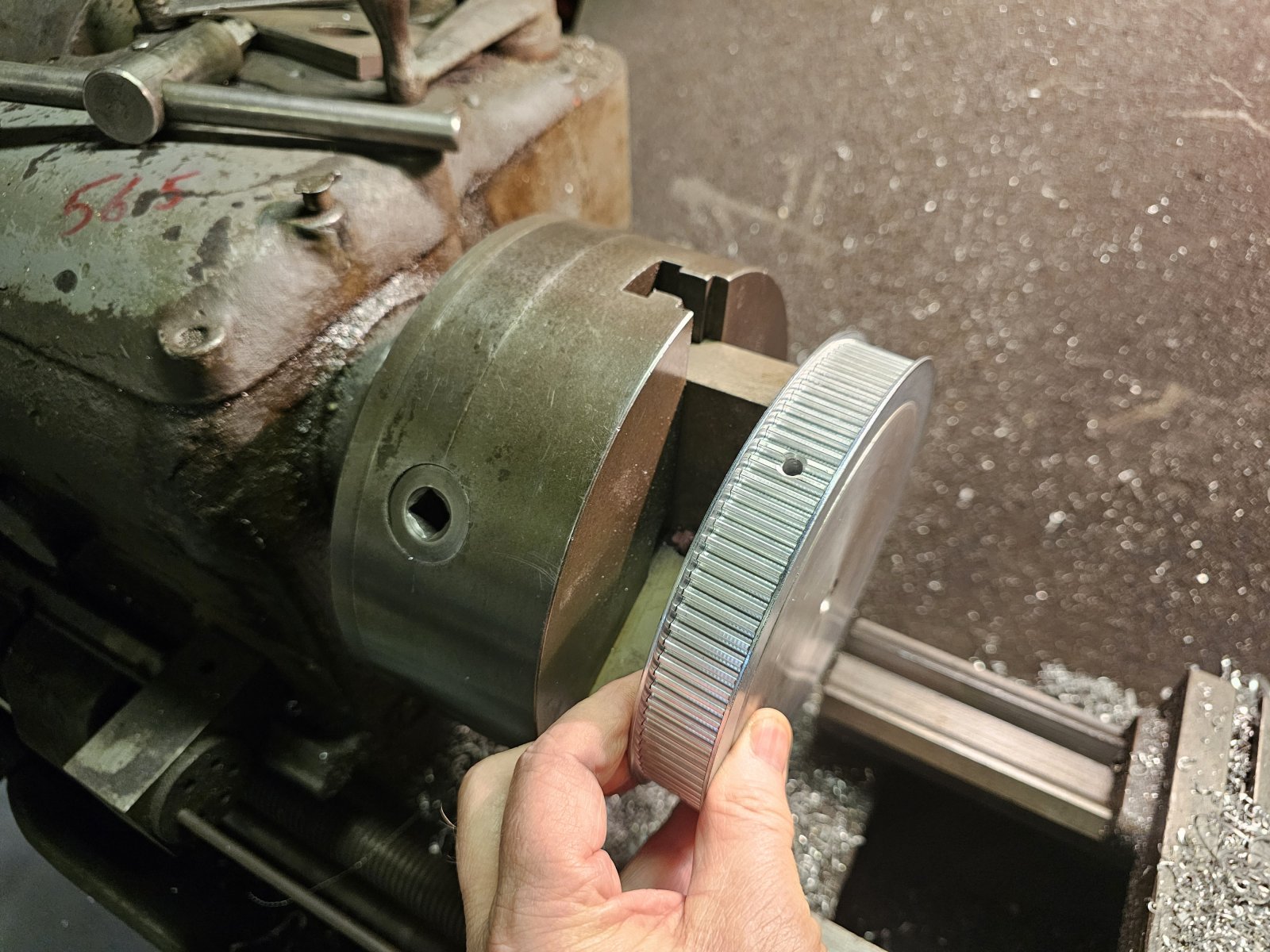

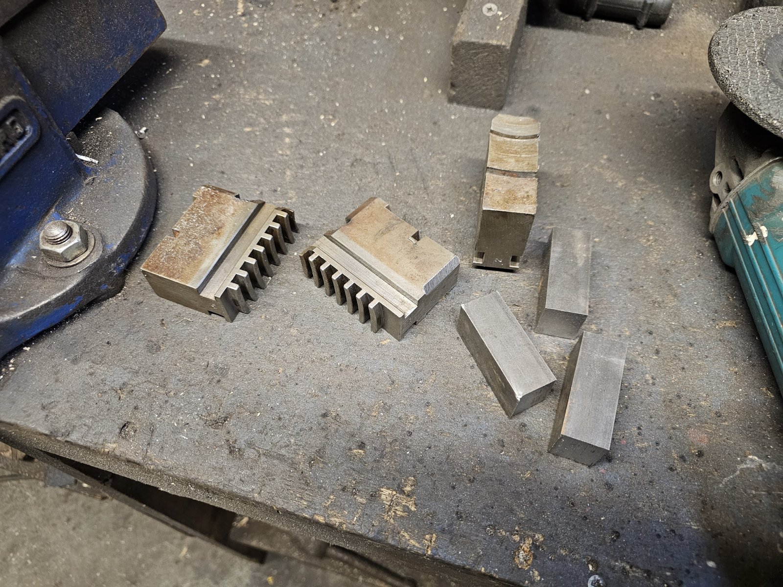

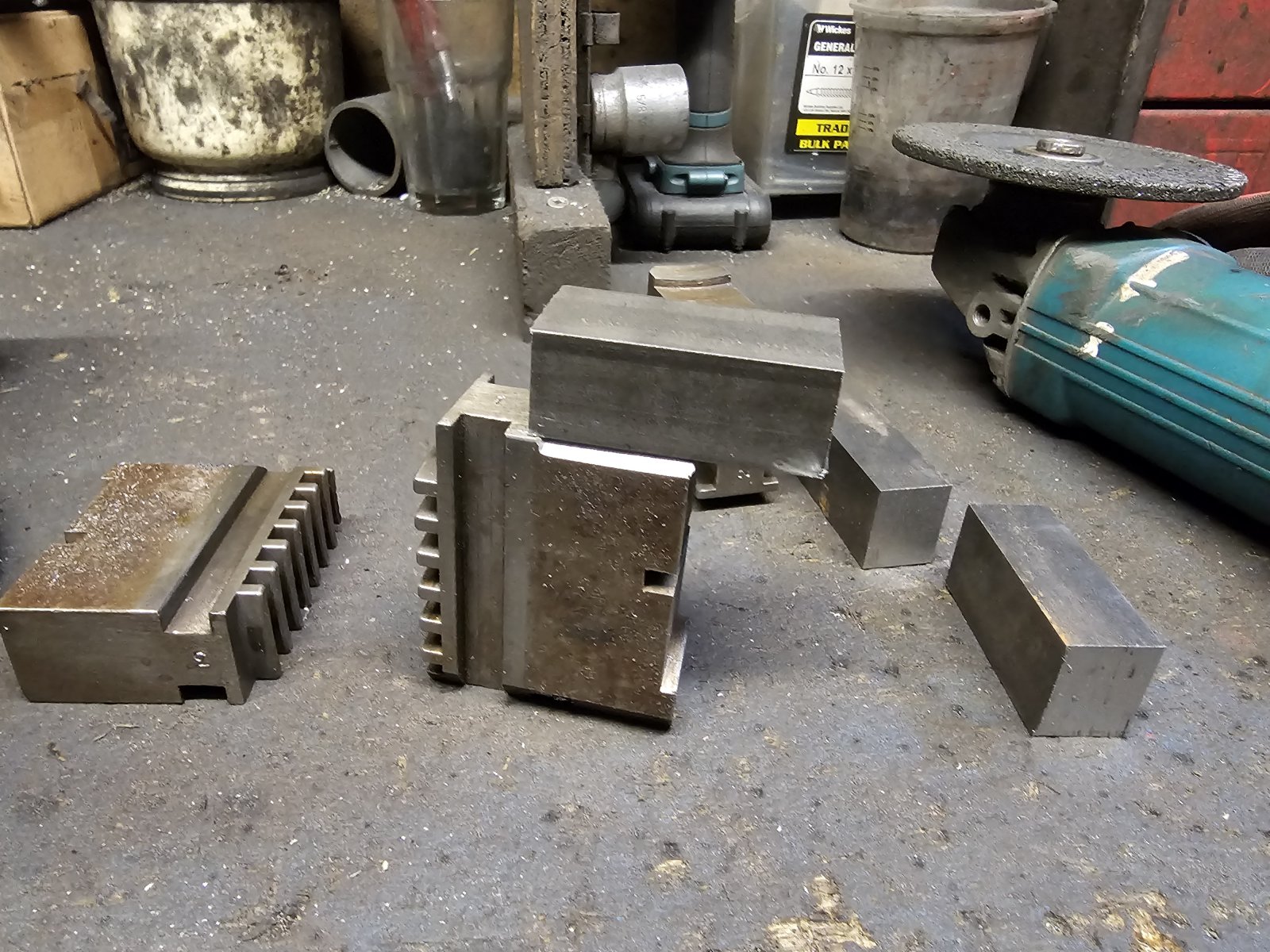

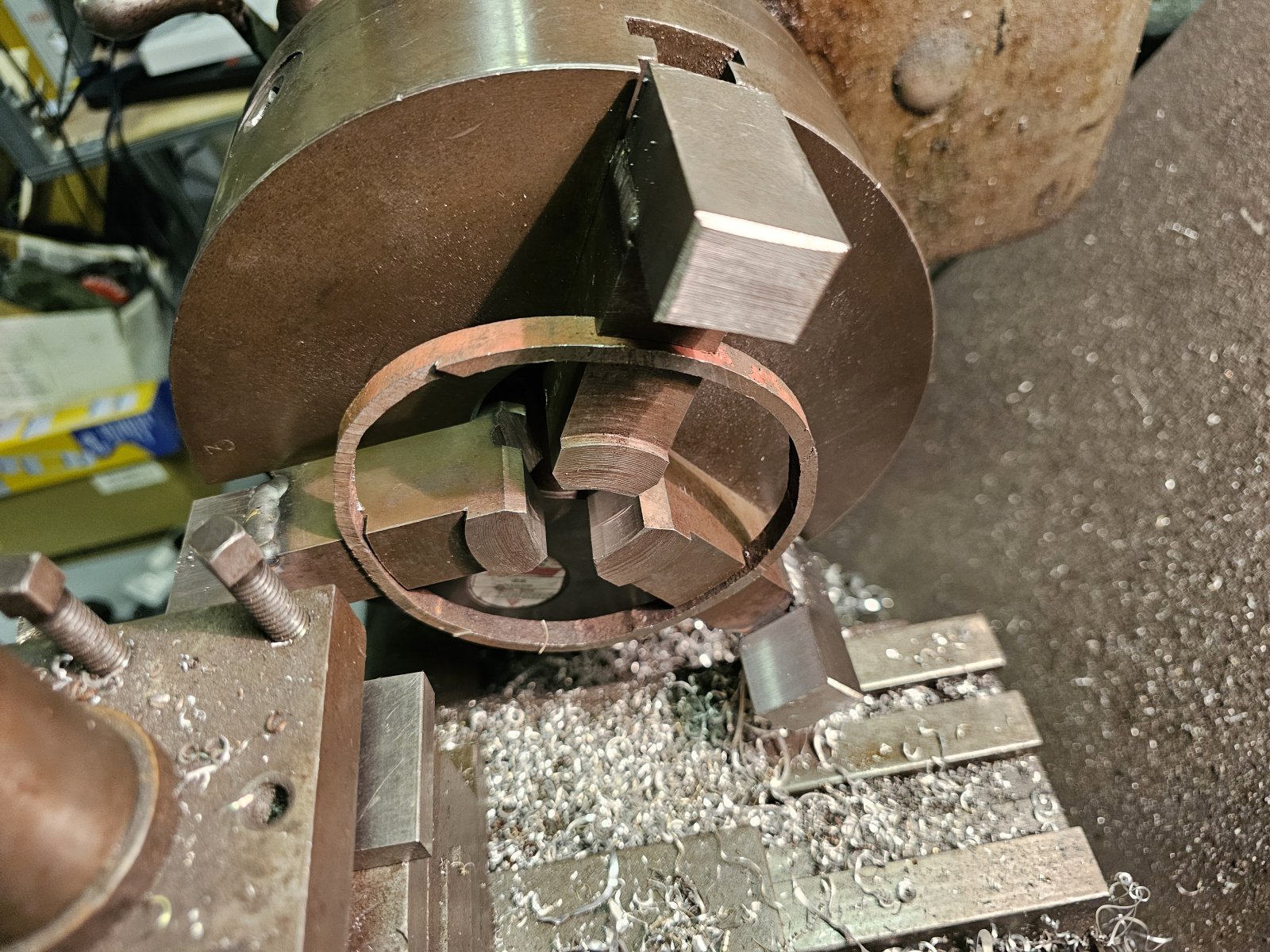

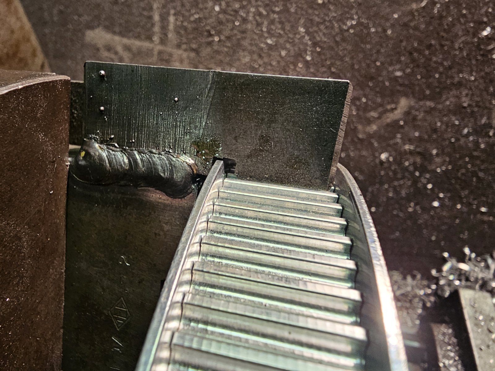

    My efforts to date include making the spigots to go in the cyclic main shaft and machining the pulleys.

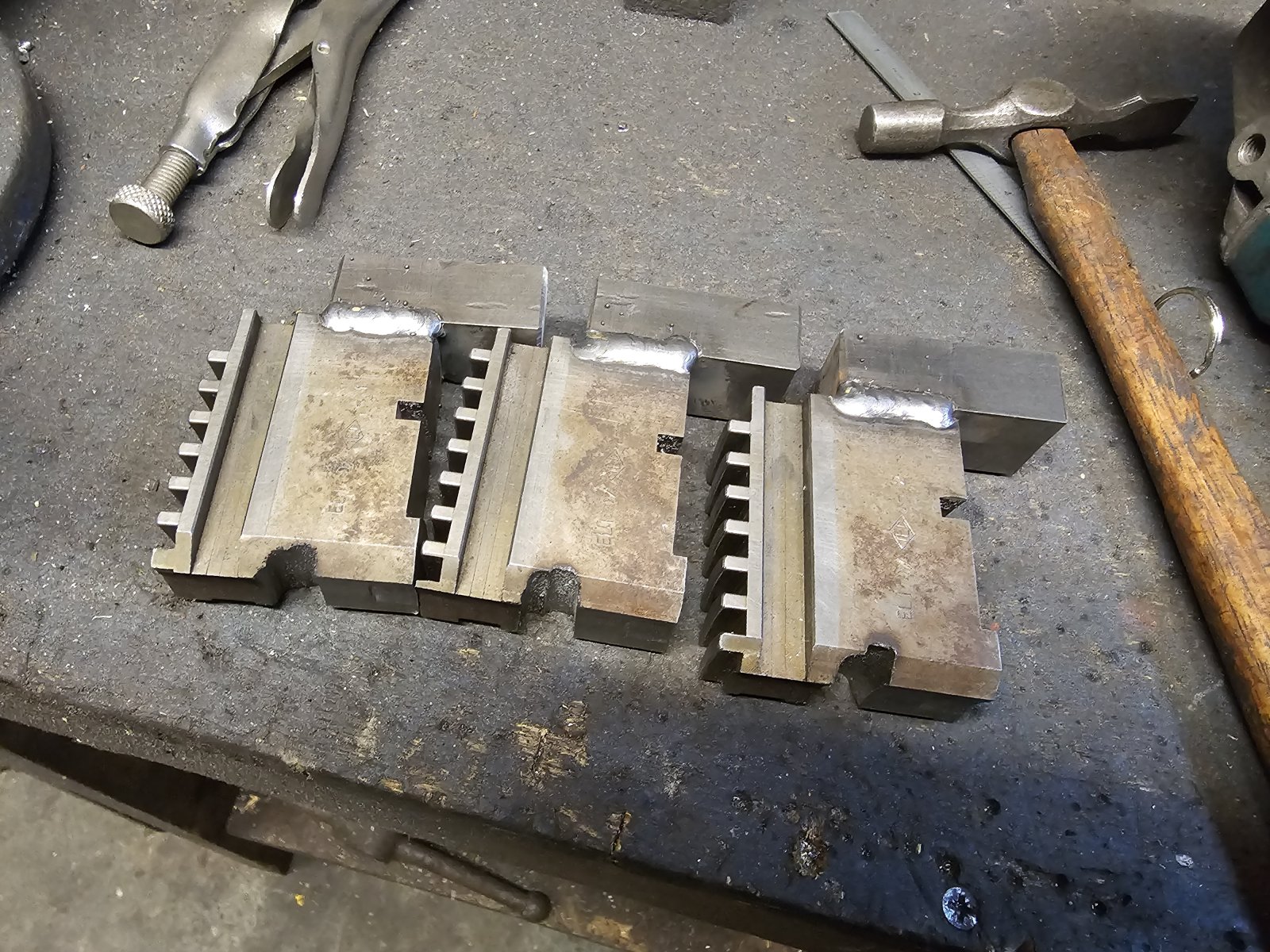

    My chuck jaws were unable to hold the pulleys without some modification.
    So...after offering one up to the chuck, decided to do the following.
    Cut some extension bars..
    Remove and prep the existing soft jaws.
    Weld the extension pieces on...
    After putting them back in the chuck, set about machining them to run concentrically..

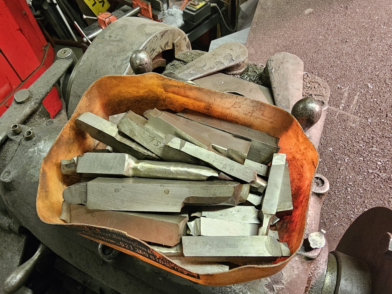

    but needed a tool that I didn't have to do too much grinding to..
    Also the jaws will flop about if I don't restrain them with a makeshift ring, and tighten the jaws onto it.
    Also I undercut the jaws to ensure that I only clamped onto the toothed part of the pulley and as the clamping part is the same diameter as the pulley and wide enough to extend across several teeth, there is not damage to the teeth.
    So far I have the weight down fom 1394 grams to 978 grams , and have worked out I can get 8 x 22mm diameter holes in the web area, so should be well under half the original weight.

    I usually just put 3 dowel pins onto the teeth and clamp them in a standard chuck with the jaws reversed. This centers the pulley perfectly (as long as the number of teeth is divisible by 3) and avoids damaring the flange rim.

    Great idea, will do that for the smaller pulleys.
    IMO the bigger pulleys needed something more solid due to the forces put on the pulley when plunging the radiused tool in when dishing out the sides. I didn't want to risk any damage/distortion, as they took forever to get here, and are quite expensive for what they are.

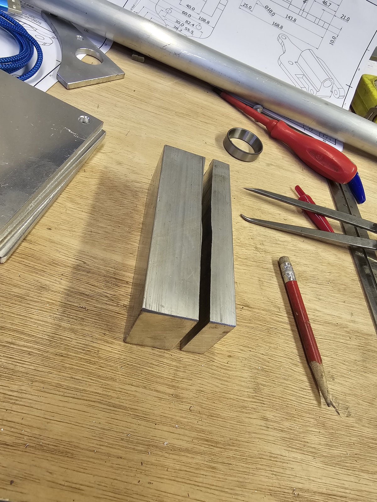

    Pulleys all drilled, didn't actually make less than half original weight, but the reduction is acceptable.

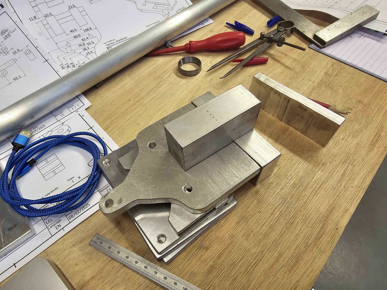

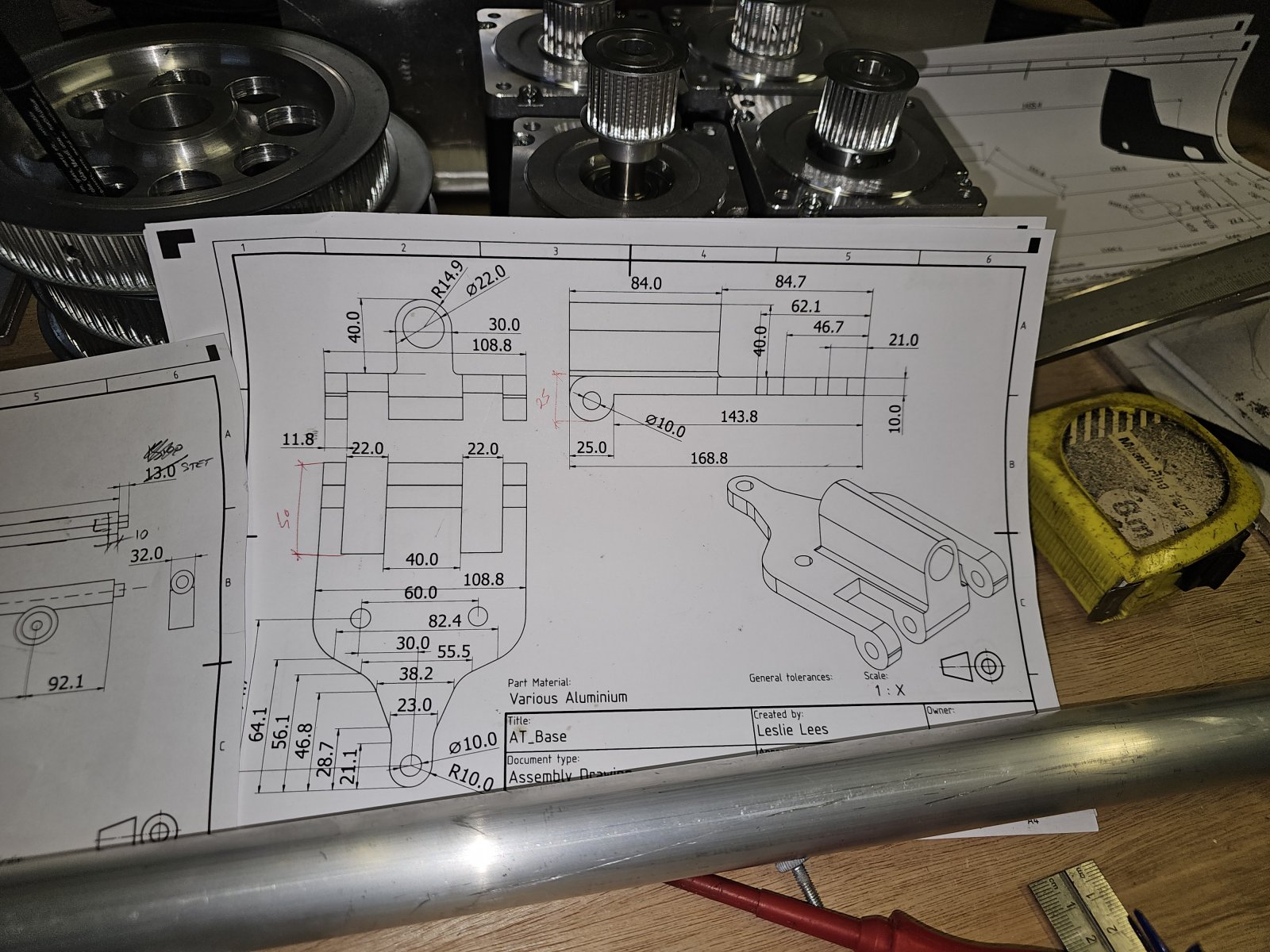

    Onto the pedal assembly now, and this isn't going to be a five minute job, but hey...
    Pedal assembly drawing.
    Haven't actually got the material in solid form, and want to utilise the material Ive had knocking around for years. So..
    Will have to make it in sections..
    This gives me the lower part, with the top added after...
    I want all the holes in the lower part to be concentric, so thats where my thoughts are now, so will probably drill after welding. I only have a small bench drill and a lathe, so...mmm

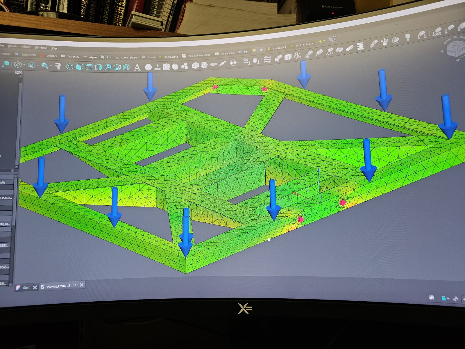

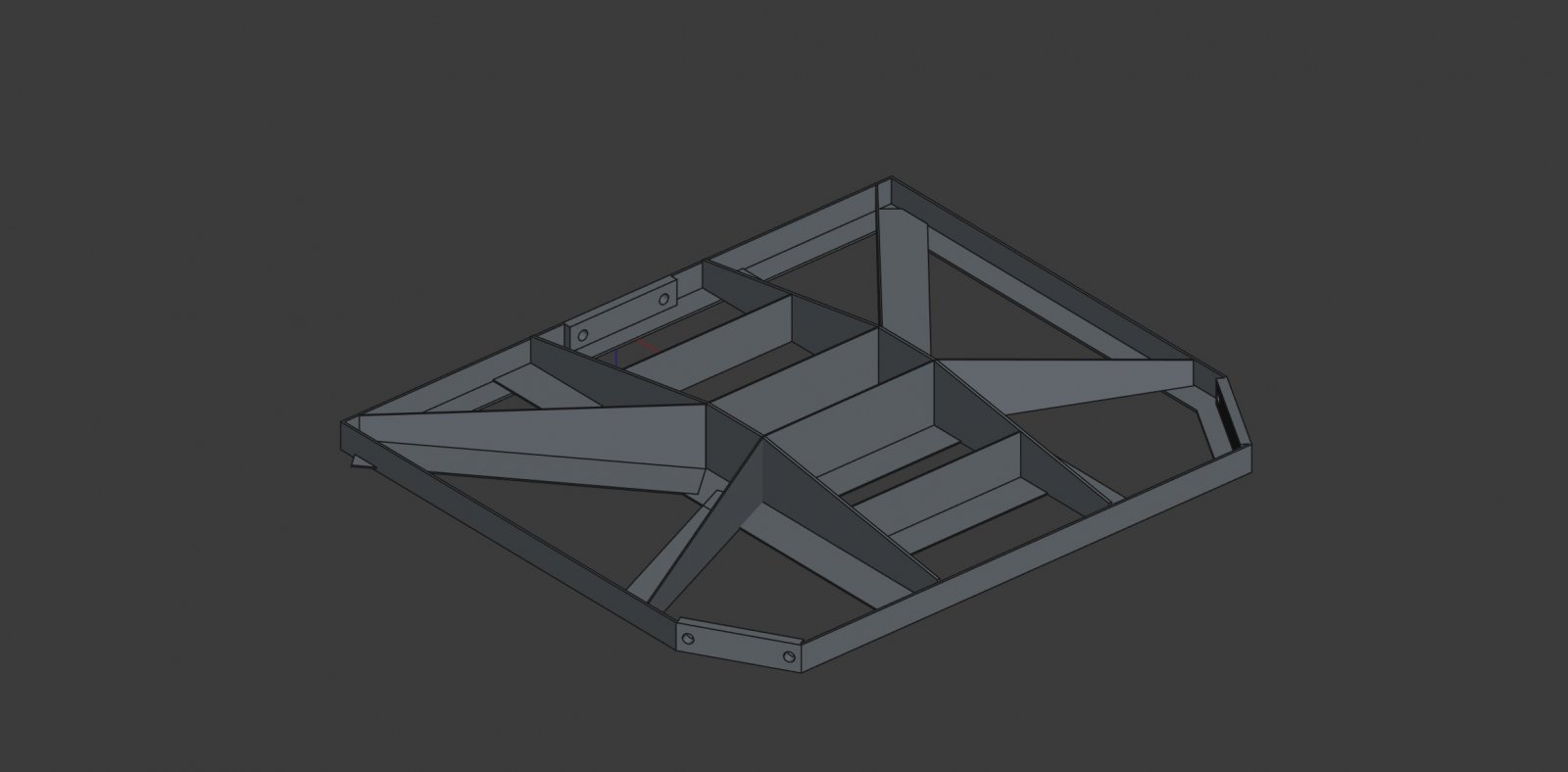

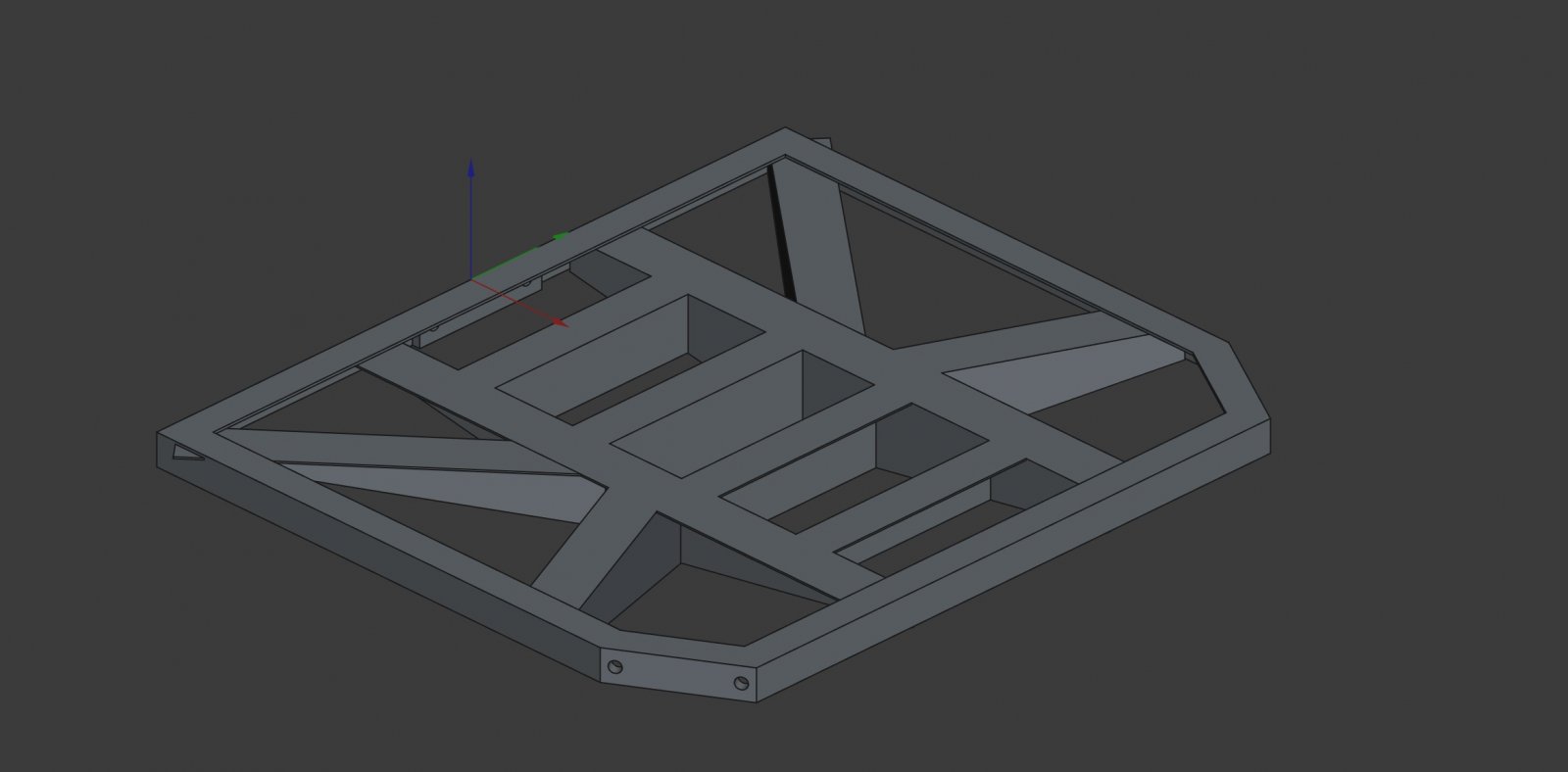

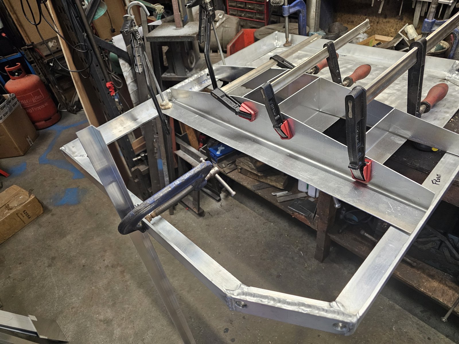

    Parts still not been folded :popcorn... and I managed to get a blue light trip to hospital.
    Under instructions to take it easy, I decided to work on strengthening the top frame.
    Prior to my trip, I had started to manually place extra material in strategic places,
    I wanted to use materials that I'd already bought, i.e. 2mm thick ali sheet mainly, which I could fold with my folder, and not have to wait upon anyone else.

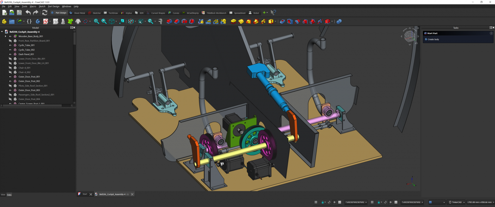

    Then I got to thinking I should model this up and do some analysis on it (something I've always wanted to play with)
    So I got to this...
    Bottom_View_Top_frame.jpg Bottom View
    Top_View_Top_Frame.jpg Top View
    Creating a decent mesh is proving difficult with such a crap model (I need to fix it properly)
    But I was wondering what supporting materials and shapes initially come to mind for other people.
    I've been a manufacturing engineer all my life and these are the angles and shapes I initially 'see' when using materials available. Not that I won't buy any more materials but not just for the sake of it.
    Any thoughts
    Model Zip attached.

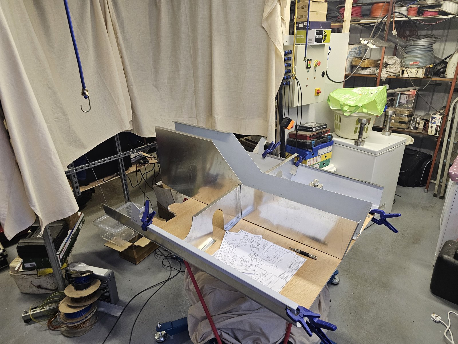

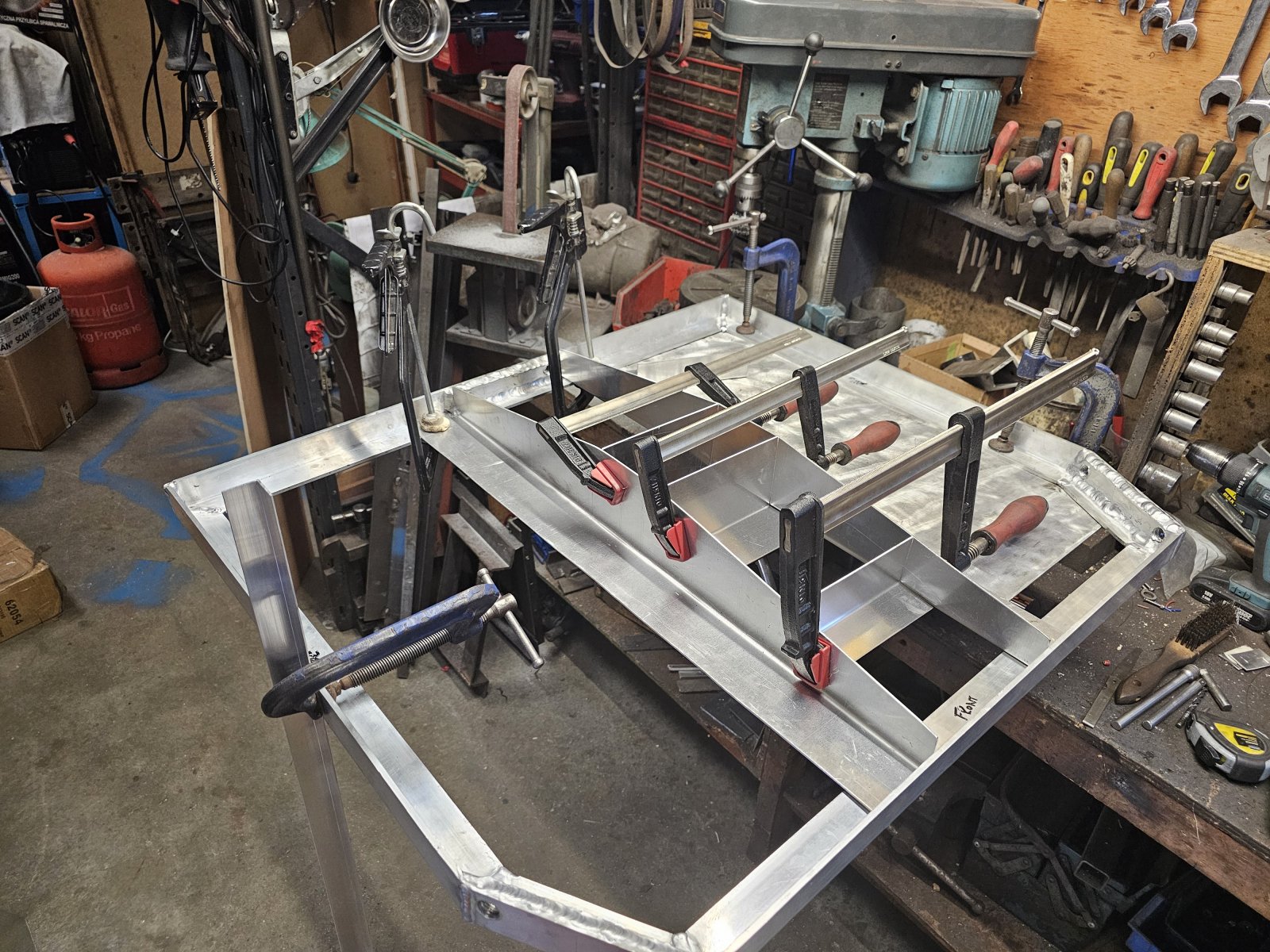

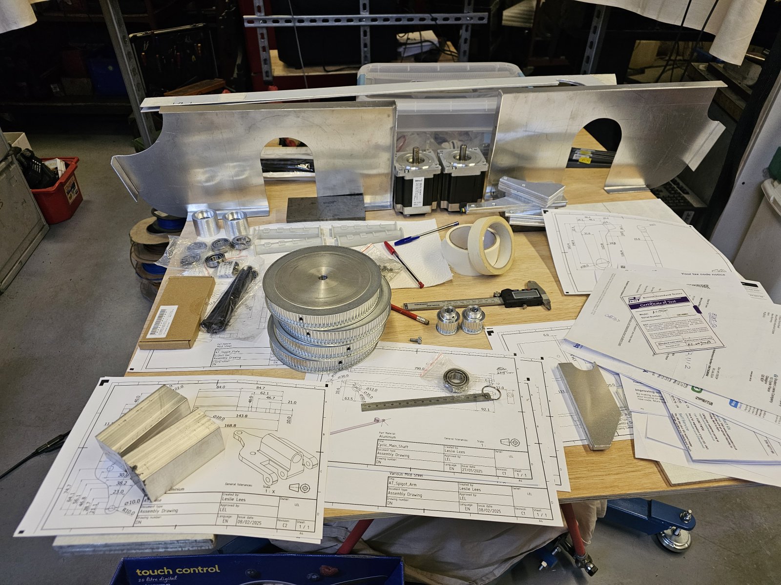

    Went to the sheetmetal workshop today, and picked up a few bits...
    Just clamped in place for photo.
    just waiting on last two, before I can make any real progress.

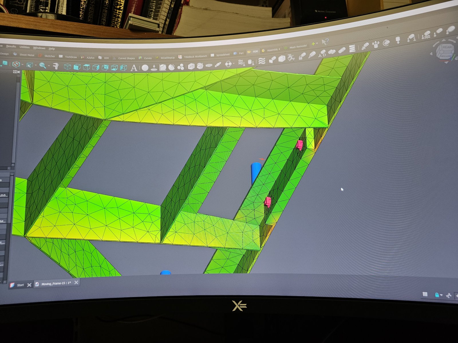

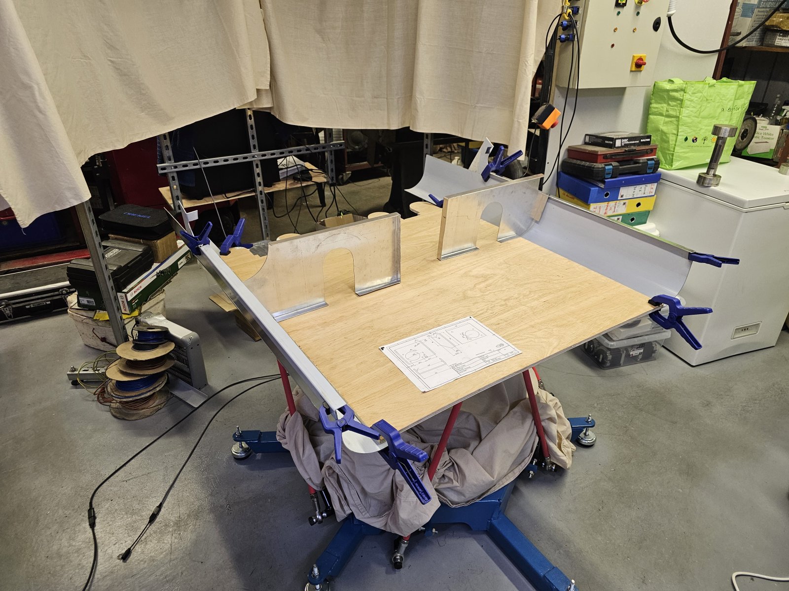

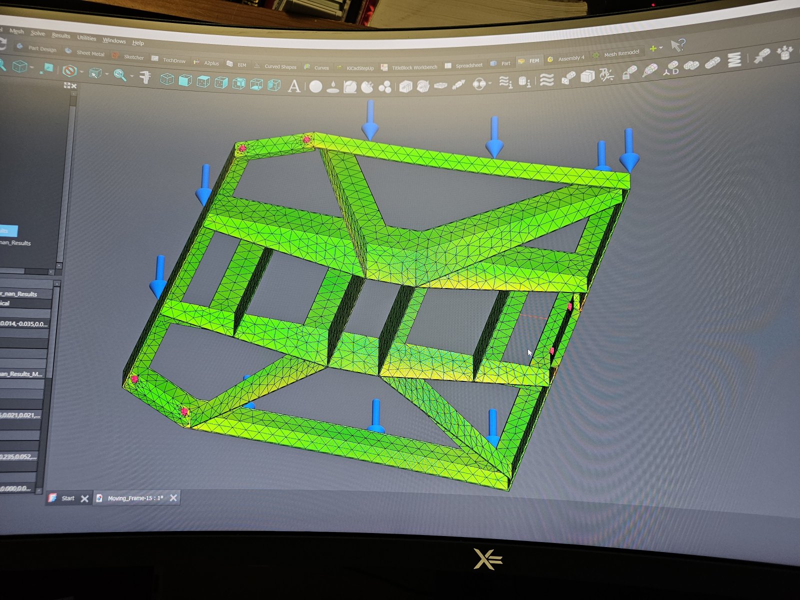

    Good news is that I got the last two bits back from the folders, not perfect however but nothing I can't fix.
    Made a new model and got some analysis completed.

    Here's where I left the base.
    Analysis showed up weak points just beyond the where the bolts attach, so I moved the two central pieces closer to spread the load.
    The changes in the actual base compared to the modelled one are that I will be adding four (possibly 5) diagonals rather than the 3 in the model.
    In this space here.

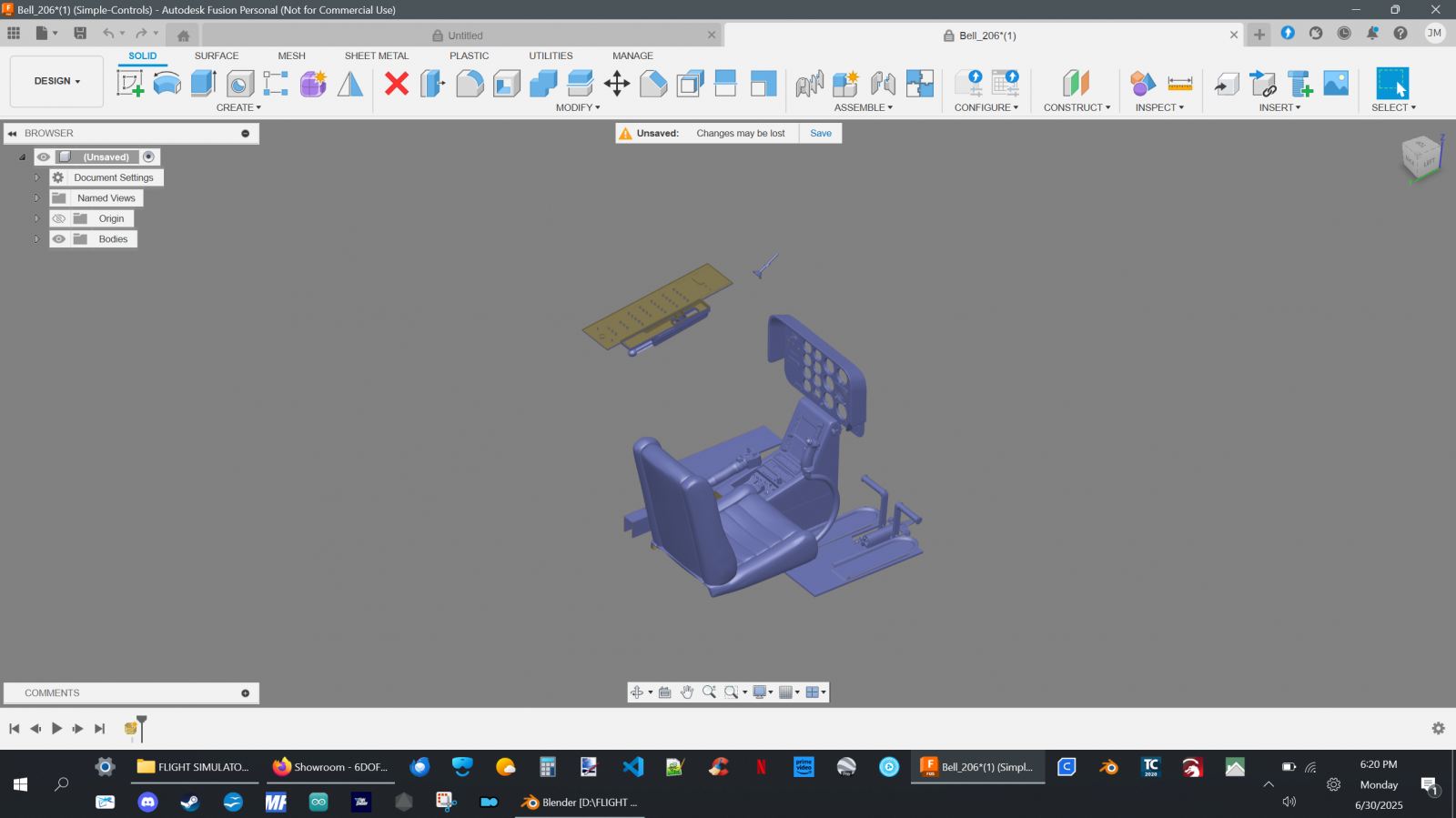

    I Have an older version of Blender with an even older version of the MSFS mtlf importer plugin. It allows me to import aircraft and save them as stl files. I'm working(?) on a 206 cockpit. If you would like an stl let me know how much of the bird you want. I use Fusion to break apart the stl file into separate shells then measure and draw from them. Not sure if you can do that with FreeCAD. I've tried FC several times but keep returning to Fusion.
    I'm doing a single seater without the shell elements. So I just strip down all the stuff I don't want in blender, then export it as an stl. It's great for getting measurements and such.

    I did a survey of a 206 at my local helo port, and have loads of pics if you would like them? in fact I could load them up to Github for others too.
    Ah, yes I started like that, untill I found a guy on YT, by the name of MangoJelly. He's just the best source for learning FreeCAD (Oh, and Joko Engineering, although he hasn't got so many vids). I managed to get much of my helo (well the first draft anyway) done over the xmas hols using these guys vids for assistance
    Stick something up, and I'll see what I can do with it. Thx.

    Here's the STL that is pictured above. Let me know if it works for you. I have stls of the complete interior and exterior, but the files are too big to upload here.
    Blender is free as is the plugin.

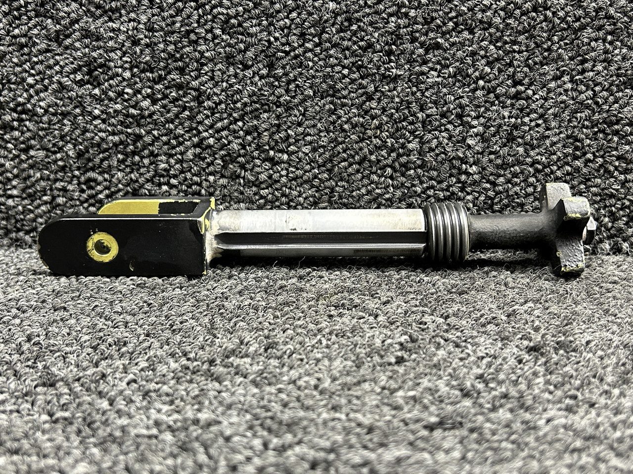

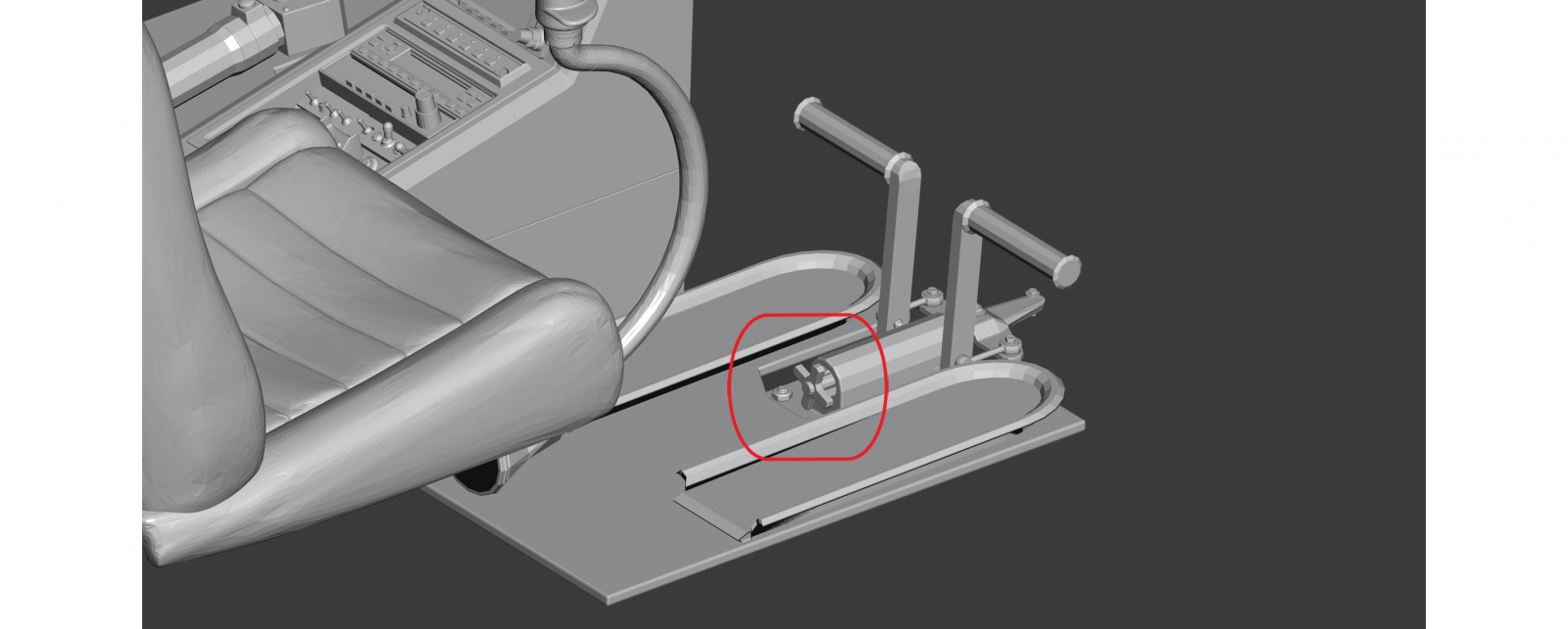

    Opened in FreeCAD no problem. There's quite a lot of detail there, but one thing caught my eye, see attached image.
    I was wondering if you know how this knob is manufactured. I know it adjusts the position of the pedals, but I want to make it, and can't quite work out from current photos etc, where the threads are. I'm assuming there are two threads, one outer in the main casting, and a smaller LH thread into the central shaft. But trying to get confirmation.

    Not to worry, I managed to find a proto of the nut assembly
    Seems the adjuster knob has a single thread, attached to the knob assembly which is attached to the shaft by a single bolt which is loose enough to let it turn.
    I think the knob assembly may lend itself to being 3D printed.

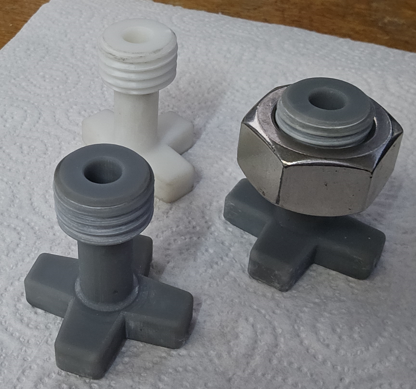

    Managed to get the Anti-Torque pedals adjusting Knob printed. I mixed standard resin (black) with and 'ABS ' type resin (white).
    With the first one (the white one) the thread was created by creating a body with am M24 threaded hole, which I used to do a boolean cut on the body of the Knob. Which initially worked well, but upon inspection of the tolerances showed there was no negative values and hence couldn't make the thread smaller to fit inside the nut.
    My first thought was to run a die down it, but after a few attempts realised there was just too much to remove and I risked breaking the shaft of the adjuster, and then having it stuck in the die.
    I remodeled using a thread profile and 'subtractive revolve' on a helix, which gave me complete control of sizing.
    First attempt wasn't perfect, and I ideally didn't want to print more, tried the die. This time it was much easier to remove the little that was causing it to be tight. I was surprised at how much pressure I was able to exert on the shaft without it breaking it, so I am happy it will be good enough to do it's job.

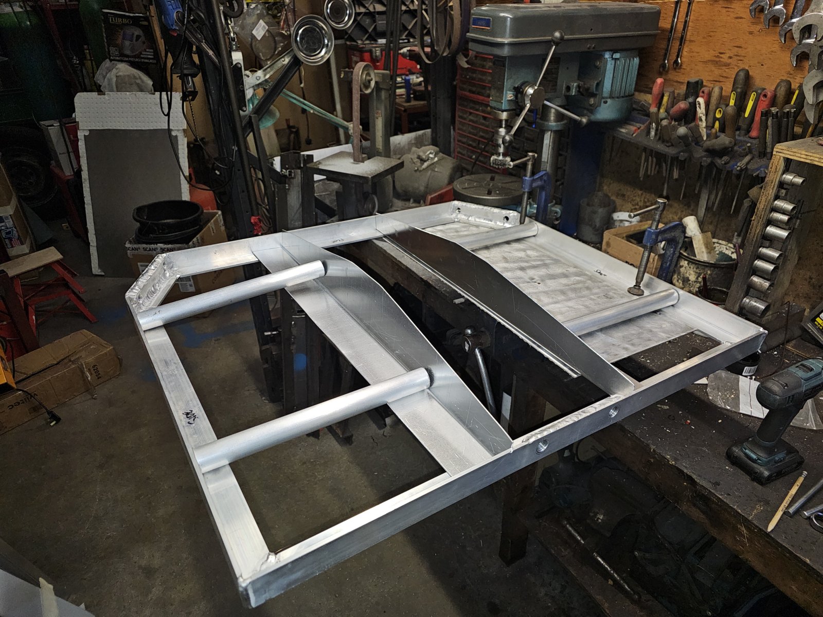

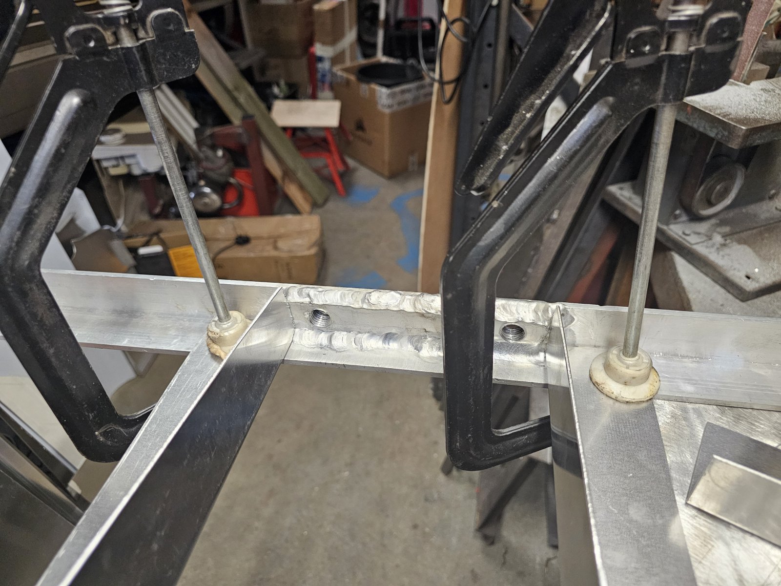

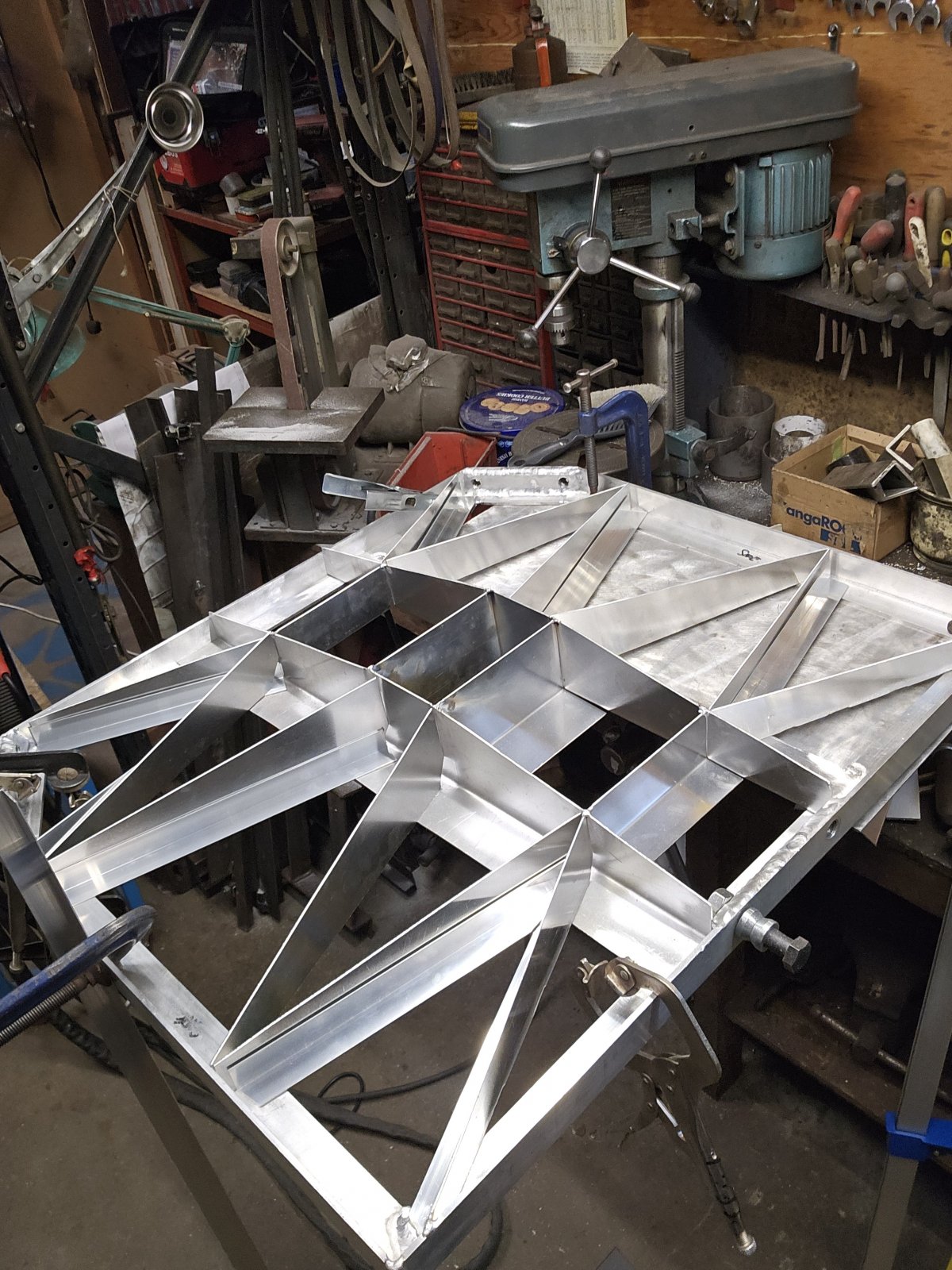

    Managed to get all the small diagonal parts cut and prepped on the frame. I added few more diagonals to be sure about flexing, some parts are tacked, the others should be done by this weekend. Then start the final welding.
    I must admit, this thin aluminium welding is a whole new ball game, not the prettiest in some places, but secure, and on the underside :grin and I'm getting better at it so quality is improving, and I don't want to do too much griding/sanding.
    I have also been giving some thought to the joints at the top & bottom of the rods. In the past I had to make some neoprene bushes for the battery pack on my customised electric bike... so I thought I could create a mold in FreeCAD, chuck in some releasing agent and pour in some neoprene, to create a stretchy boot.
    That way I can grease them up without worrying that they are collecting dust & grit.
