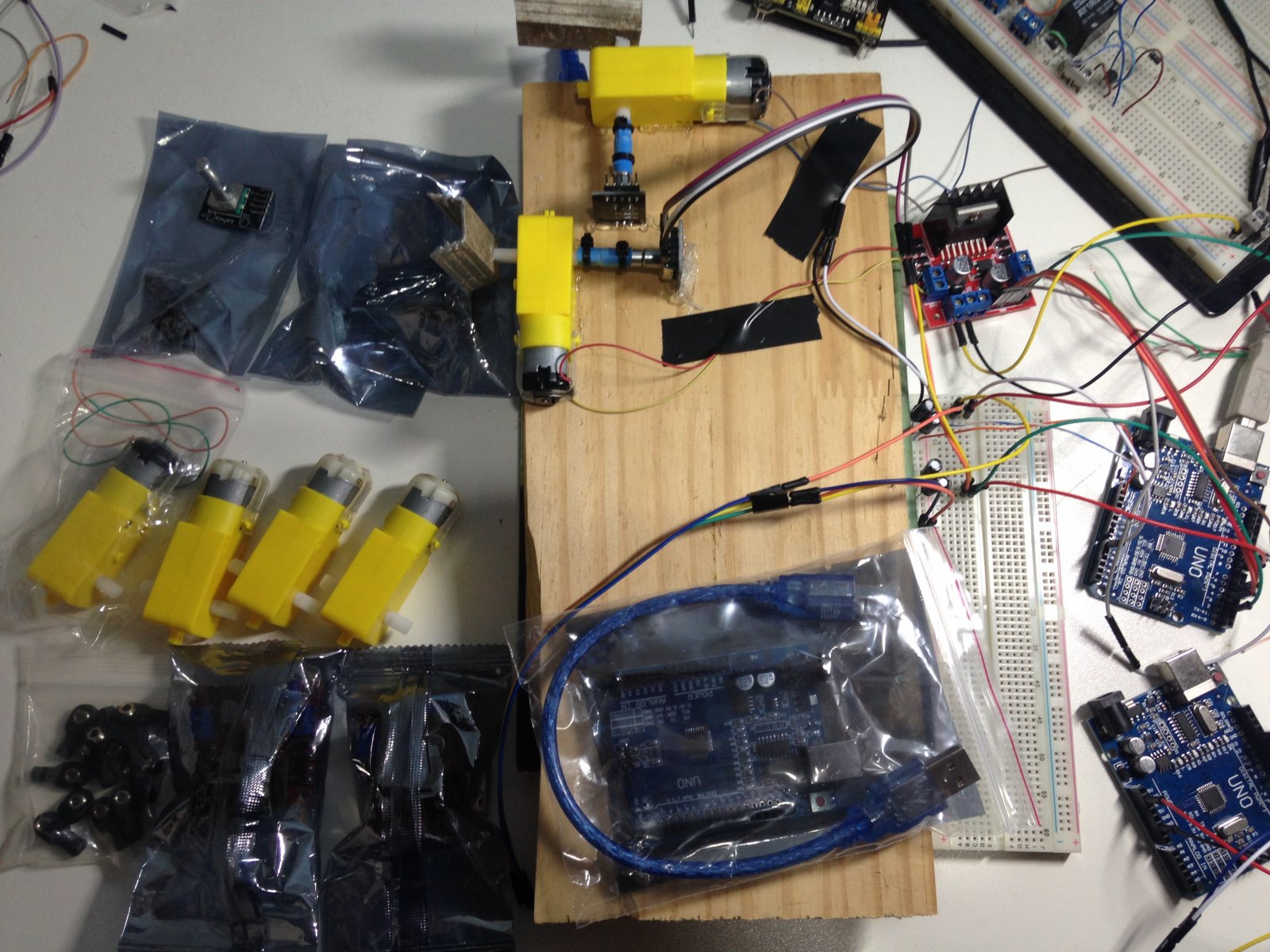

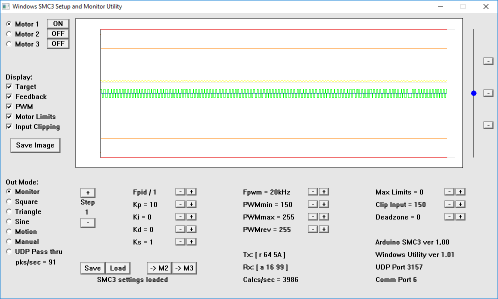

    The feedback seems to be working fine with the rotary encoder, but it seems that the dc motor gearbox has a lot of slack, something is wrong:

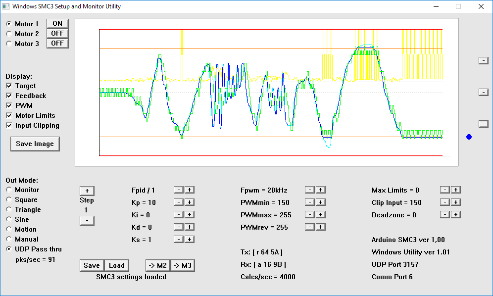

    Now testing the Axis1a using the SimTools Output Testing:
    I would like to have your opinion about the feedback using the rotary encoder, what is wrong? The code is attached.
    Also, I need to use something to get the current position of the rotary encoder after power on/down, some type of calibration based on the min/max angles, maybe using 2 sensors for min/max angle to calibrate the rotary encoder and go to center position.

    What type of motors do you use ? Do they have a gearbox ?
  3. SeatTime
    2,572
    Yes, he has a gearbox on his small motors (see his first picture - gearbox in yellow). I'm not surprised that they have some slack :). You could use limit switches and some code for initial calibration.

    My rotary encoder direction was inverted, it was causing initial failure of the software with invalid feedback values.. And I thought the problem was the L298N board :(
    The range of SimTools axis is just 100-923, why? Shouldn't be 0-1024?
    I'm planning to use Optic Sensors TCRT5000 as limit switches, I will test the min range of them and check if they work as expected.
    First test of the motor after some regulations:

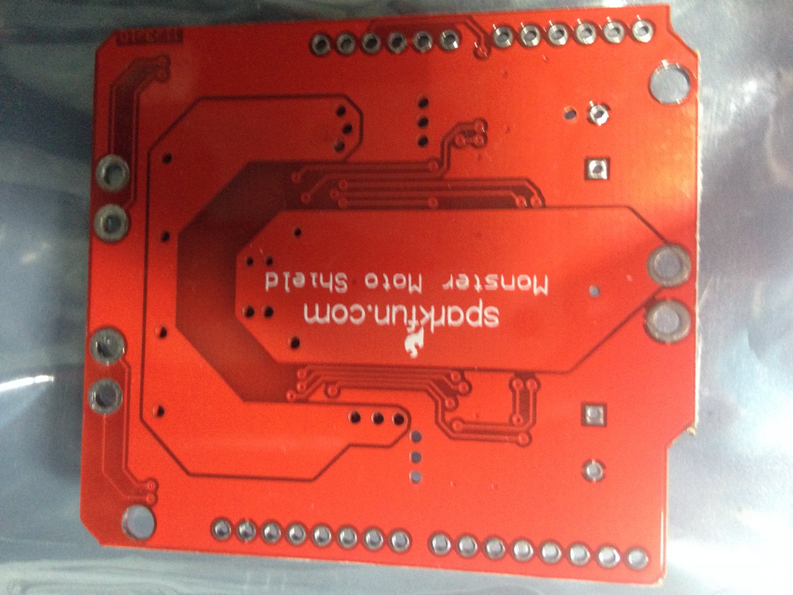

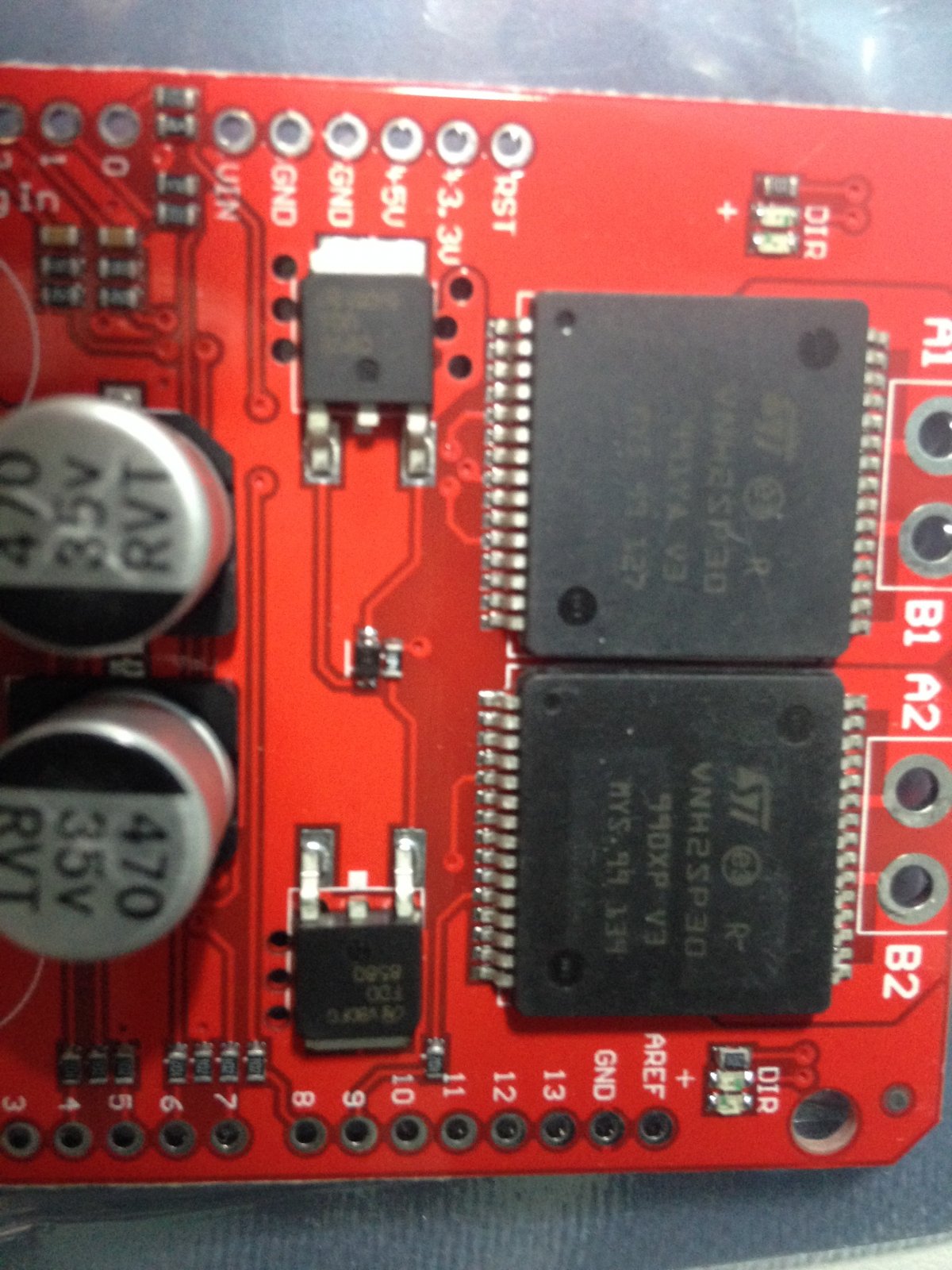

    I bought 2 monster motor shields, lets see if I have lucky with them.
    The first board has poor soldering on the chips and a short circuit ping soldering on one of the chips. Also I can't even read the chips info.
    The second board looks better, I can read the chips info and the soldering is better.
    I will test the second board and re-solder some pins of the first board.
