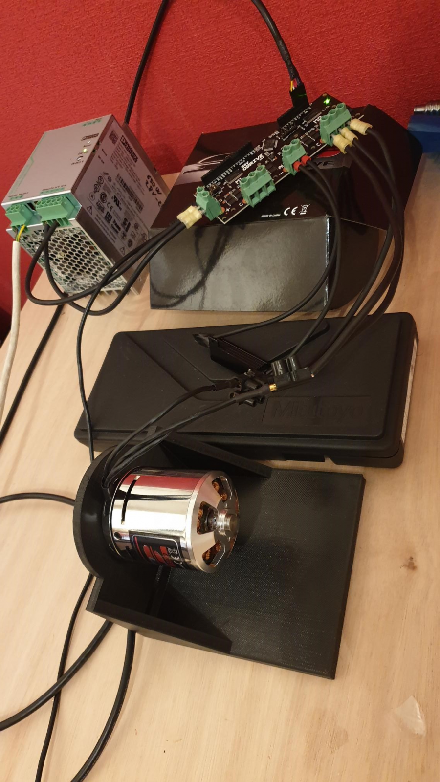

    I would like to build a 6 Dof Simrig
    I already bought :

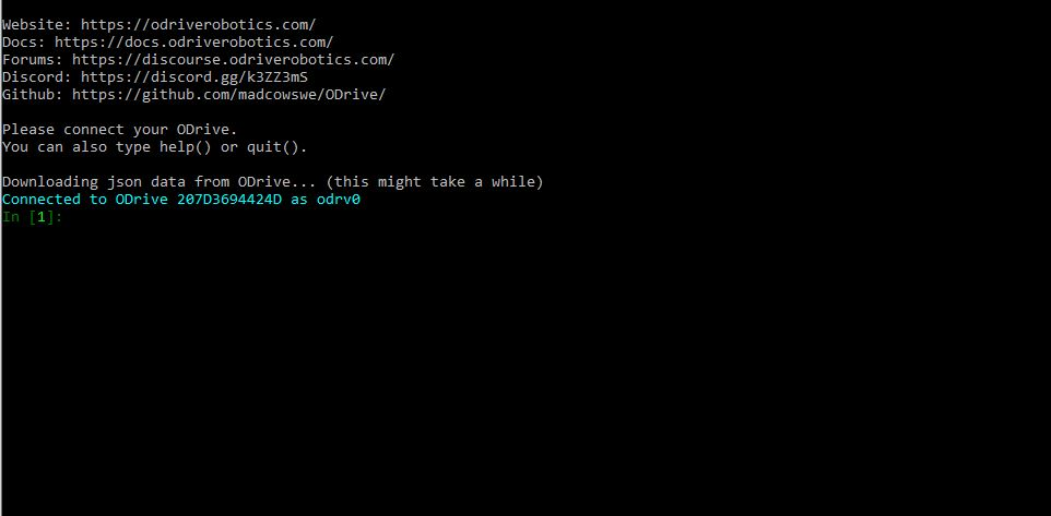

    3 Odrive 3.6 cards for 6 Actuators and my problem is really big because i don't have any knowledge concerning programming...
    So i started to follow the steps and i don't know how it works ...
    I succed to communicate the odrive card with the computer ok ...
    I followed your step by step video @SilentChill (thanks a lot) explaining how to program but at the step when you are on the odrivtool configurator i didn' found the "main.py" .
    I did a small rig test to know if it works but i don't know how to try it ...
    I wanted also how can you make the link between the simgame and the odrive card ?
    How can i be sure that this communication can work ?

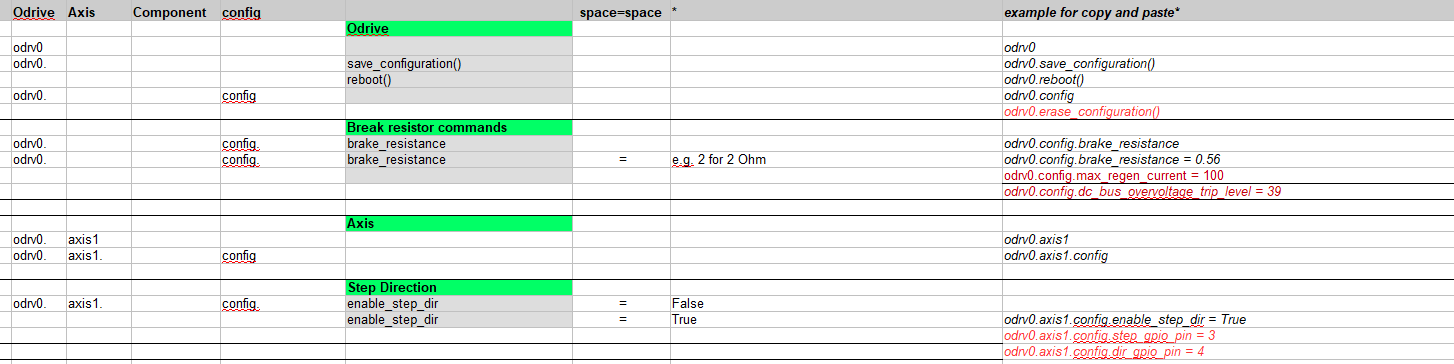

    I also have the command table from @PeterW
    But i'm clearly lost ... i found an Odrivegui.exe
    But it doesn't work i don't know how to fix that problem also...
    I would be greatful if someone can take time with me to succed and resolve my problems ..
    1-connection to odrive ok but i don't know how to setup and config the odrive correctly.
    2-I have AMT 102V but doest i need end switches ?
    3- how to make the link between game engine and odrive card and all configurations .
    4-how to config an odrive on the easiest way ?
    5-I can give you my discord, can someone can take time to axplain me on live how to approch this config step by step ?
    I hope someone would like to help me , because im in a road-end.

    There are some main steps that you have to follow to get the Odrive working for sim use:
    1. Read all Odrive building threads here in the forum...
    2. Install the firmware from @SilentChill (that is a custom made firmware from the great company insectatech)
    3. Install the matching my_config.json from silentchill
    4. Swap wire A and B on one side of your AMT102 encoder cable (if you have this encoder)
    5.Check the motor pole-pairs.
    5. Make a motor calibration sequence and save
    After restart, the motor should turn a little (making the index search) and stop in closed loop control (so you feel the resistance when turning the motor by hand).
    Ok... this are the first steps...
