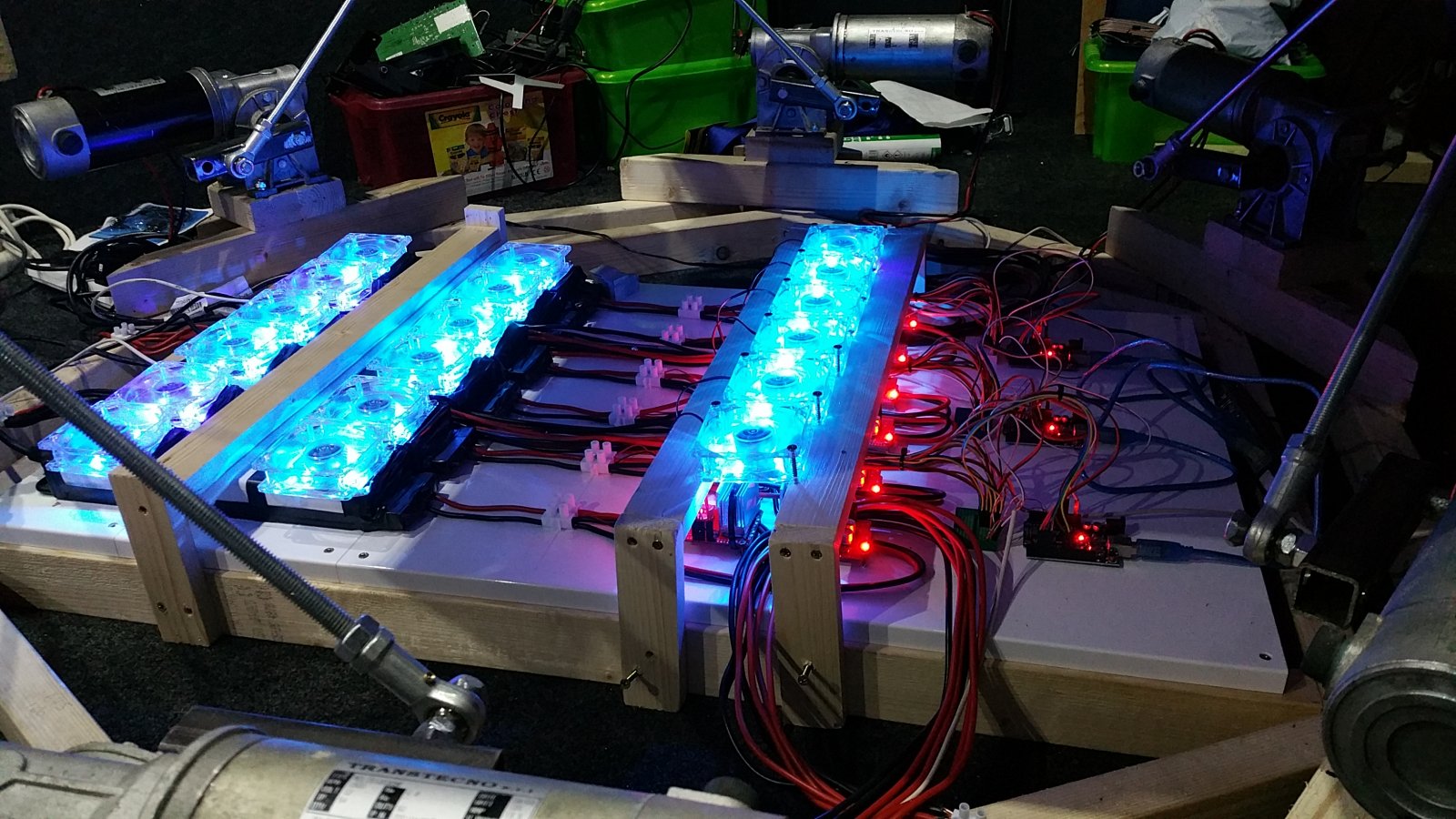

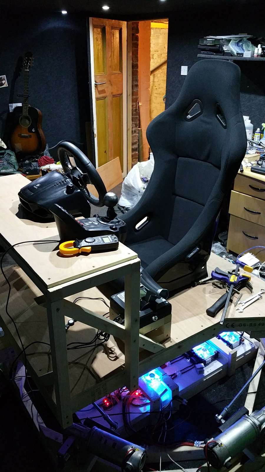

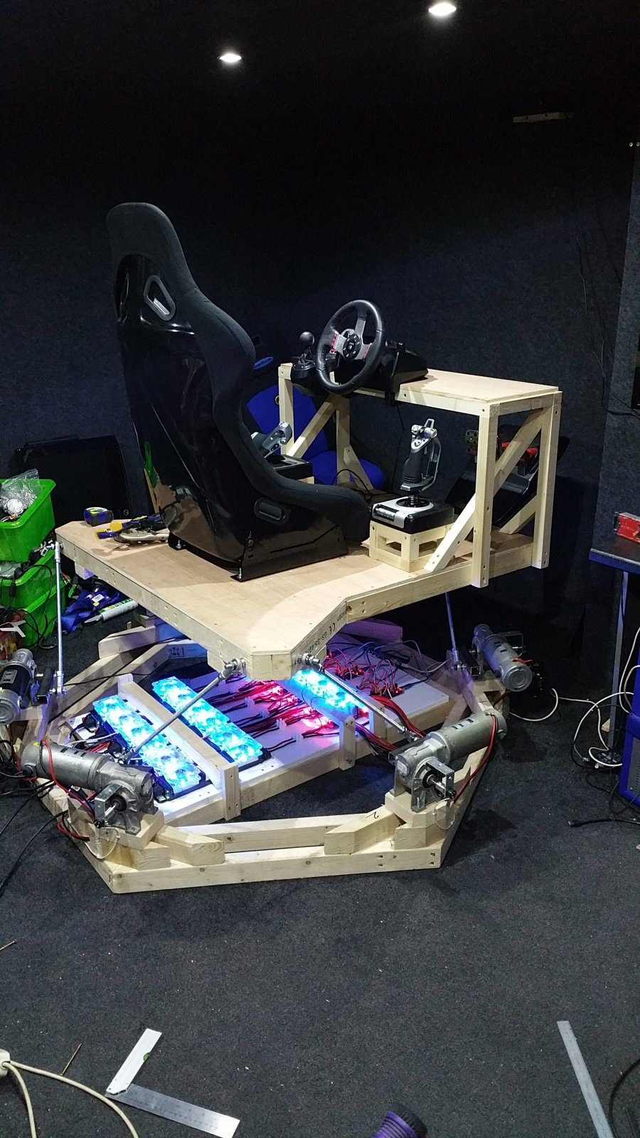

    Quick update nearly ready for full game testing :D

    Where is the step ladder :grin

    OMG - do you own a extinguisher - only if the MMs are burning holes into the wood :p

    Hahaha @Pit with all those fans it's cool as a cucumber in a fridge heats inks don't even get close to being hot.
    But yes I do have a fire extinguisher :thumbs

    Do you have an idea of the power consumption?

    I have no idea lol 6 x 675w psu's so when fully operational i bet its quite a lot :D

    Nice:thumbs, cannot wait to see it in real action (I bet the Wife will be happy :grin). Do you have an idea of what the moving part of the rig weighs?

    @SeatTime I think the platform and stuff will weigh around 20-25kg
    I will get all the controls connected up tonight and try and get some testing in. It moves it all very easy without my fat arse on it so fingers crossed it will cope with me on it.

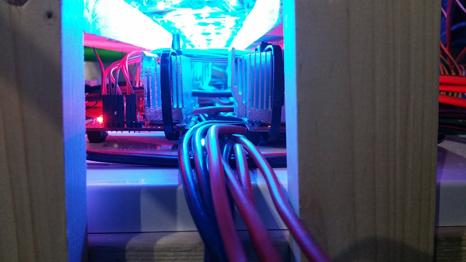

    Hi @ji3200 i will share it all eventually just having a few teething problems at the moment :(
    MM's dying and motor magnets slipping around inside the housing nearly burning motors out so hopefully I have it fixed fingers crossed. Been a bad few days lol but I will get this damn thing moving with me on it !!!

    Hmm, not to be negative, but I think you do need those, otherwise the MM drives will keep burn out because of regenerative currents. Also you may need to install extra bypass diodes to redirect the extra current to the capacitors instead of the MM's and the power supply...
    https://www.dropbox.com/s/w71z3r2v3uxt3ie/IMG_20150618_131945.jpg?dl=0
