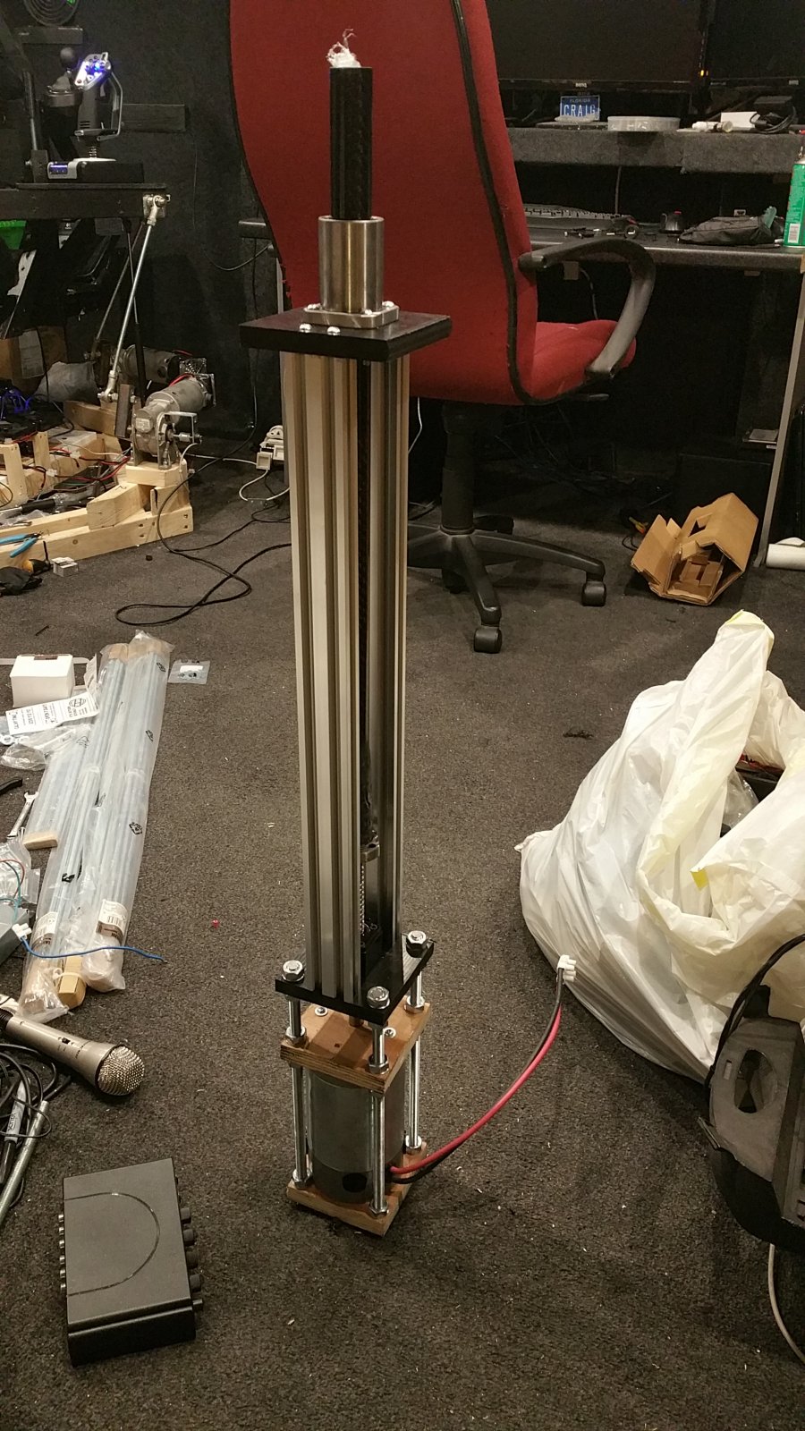

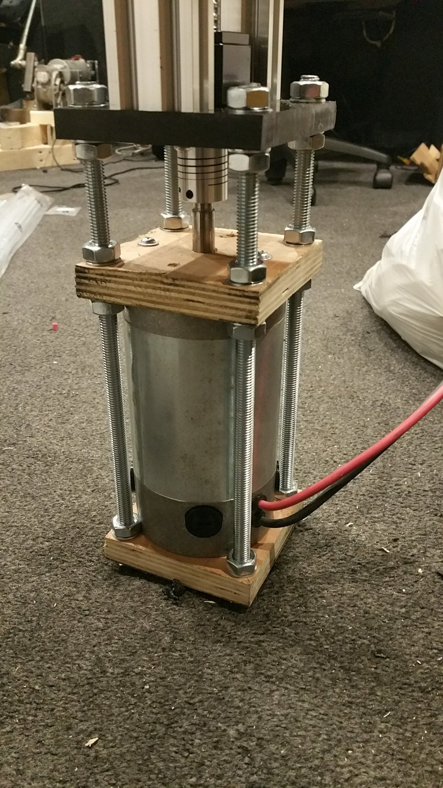

    Little update, ruff around the edges but its work in progress :p
    • Like Like x 8
  15. wannabeaflyer2
    Jun 12, 2015
    724
    london uk
    8,351Coins
    +958 / 7 / -0
    Yeah baby, now thats what im talking about :) nice work and love the fact your using Plywood no fancy CNC stuff mate, so you have shown a great alternative material ... eyeing this post as always :) well done @SilentChill
  16. SilentChill
    2,645
    20,596Coins
    +3,570 / 34 / -0
    Thanks dude :) I have to use what I can use lol looks a bit crap but once it's painted it will be ok....... I hope.
    I've been custom designing lots of bits to print for the limit switches and pulleys and stuff.
    It's all taking far too long for my liking :D

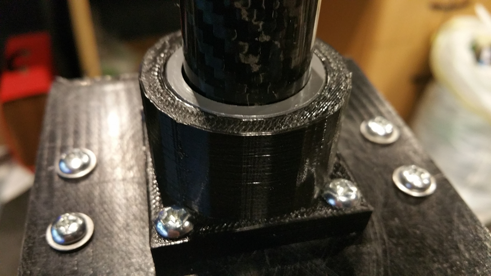

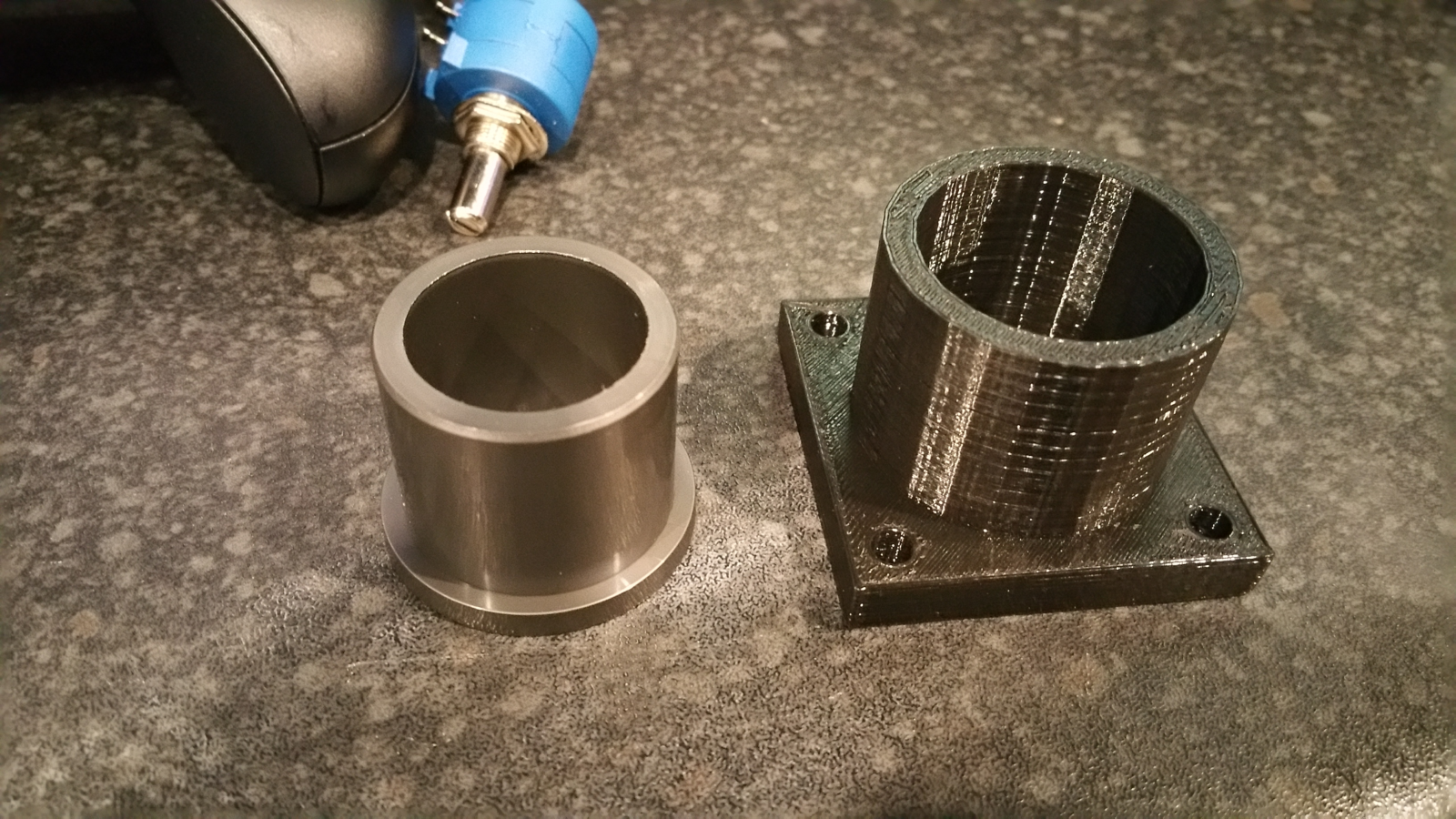

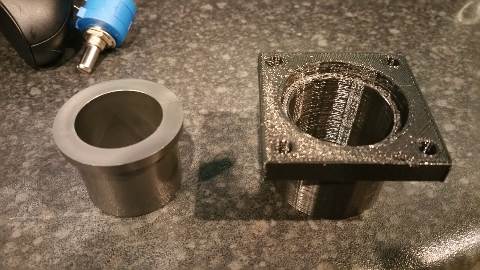

  17. SeatTime
    2,572
    Looking good @SilentChill :thumbs. Noticed in your picture what looks like a linear flange type roller bearing for your main shaft :think. If it is, just like to point out that I found them to be a bit noisy and will wear over time the hollow carbon tube - I changed them out to a poly bush. As for taking too long - try 12 months for mine...:rolleyes:.
  18. SilentChill
    2,645
    20,596Coins
    +3,570 / 34 / -0
    Yes @SeatTime I had already bought them and I do need to replace them with plastic bearings. I have asked for a sample like @wannabeaflyer2. If I can't get any I will get some soon as ibcan afford them as they are not very cheap for the housing and everything.
  19. SeatTime
    2,572
    I never priced a housing for the bushes, just purchased the bush and made a housing out of carbon fibre, so not too expensive. Unfortunately not everyone may be able to do that.
  20. SilentChill
    2,645
    20,596Coins
    +3,570 / 34 / -0

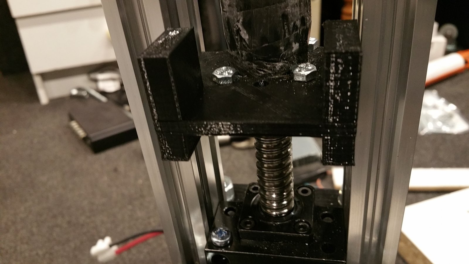

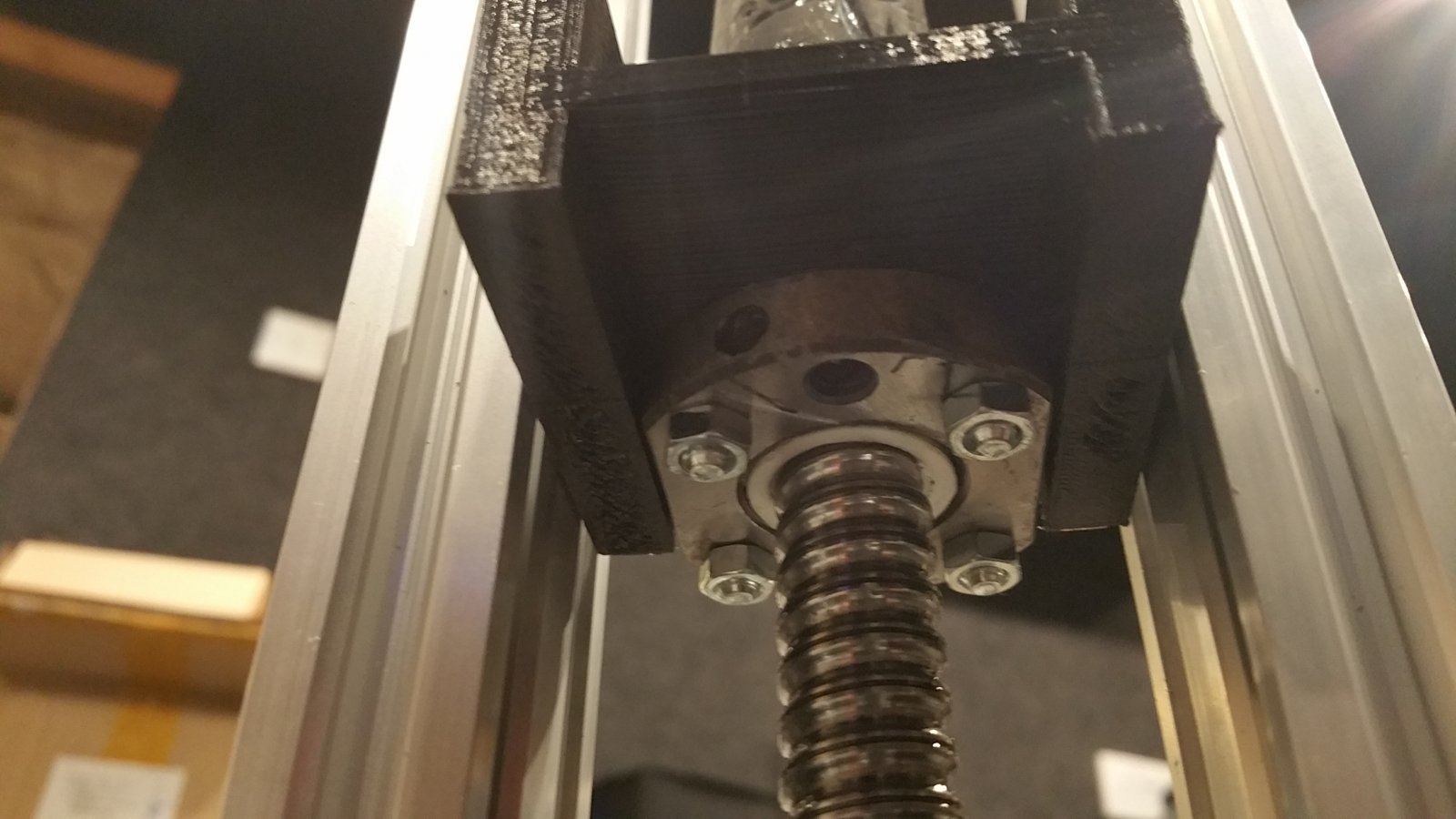

    Ok so I forgot I got some flange bearings from IGUS lol
    I have 3d printed a housing for them hopefully it will be strong enough.

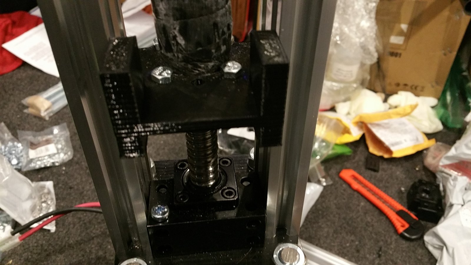

    Also I have printed the addon bracket for the ball screw which I will attach vslot wheels to stop any unwanted spinning.
    Please forgive the horendous bonding of the carbon I made a right mess of it, but it has worked that's for sure.
    20160925_200332_001.jpg 20160925_200400.jpg 20160925_200931.jpg upload_2016-9-25_20-17-20.png
    That's all for now :)
