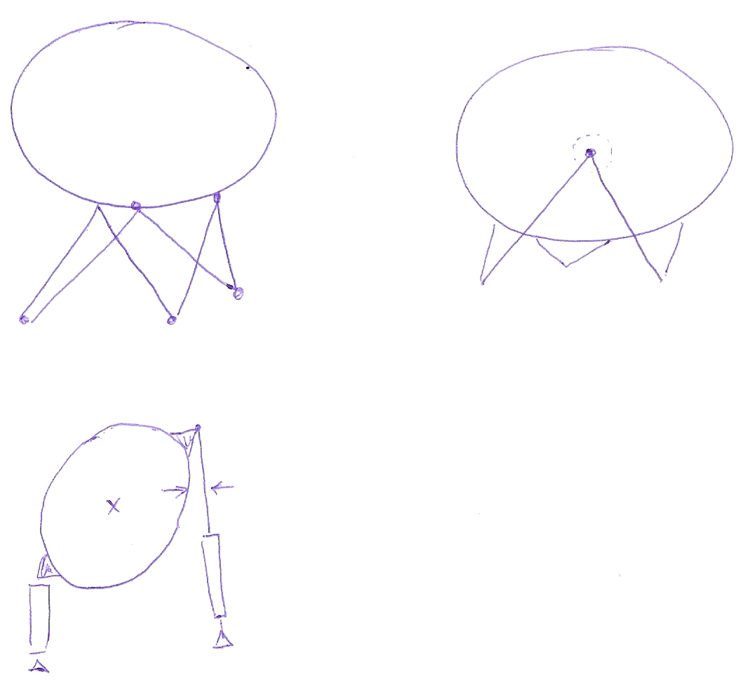

    There are different ways to attach the actors to the cockpit.
    Commercial simulators often use the "overhead" arrangement (top left). The cockpit sits completely on top of the actator plane. This requires more vertical space but allows more surge and sway movement for a given actuator stroke. DIY rigs usually use an arrangement where the actuators are horizontally further away from the center (topp right picture). I don't know the exat reason but I guess one of them is to avoid requiring a ladder to mount the rig.:D The disadvantage is that yopu need more actuator stroke to achieve the same roll and pitch angles and it limits the horizontal movement and also roll&pitch angle. Horizontal spacers/struts have to be added to avoid that the actuator rods hit the nacelle (bottom picture). This requires even more space and actuator stroke.
    Example for DIY rig: @PMVCDA
    Example for commercial rig: Delft university

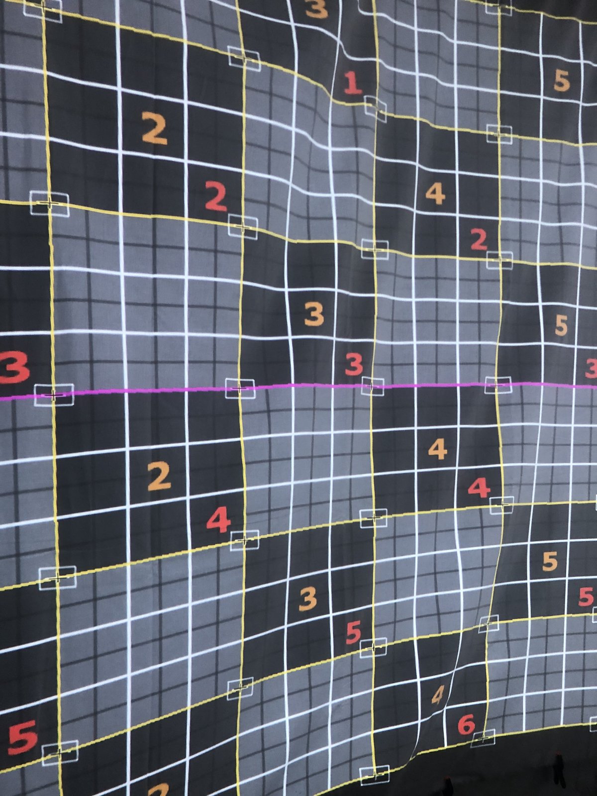

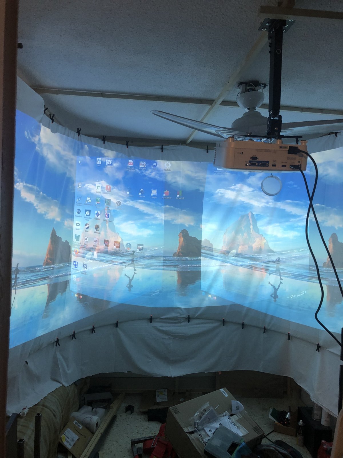

    Hello
    180 screen requires 2 projectors with short focal length.
    I have 3 because it's a 180 with 1 more straight meter on each side. It's a horseshoe so I can see the sides all the way to the wings. It's easier than making a total curve of 240.
    If you really have a lot of space, you can project onto a 360 sphere and have a visual of everywhere.

    I bought the BenQ TH671ST DLP full HD 1920X1080 short focal and 1 zoom
  9. Gadget999
    1,988
    12,132Coins
    +492 / 10 / -0
    thats a neat projector :)
    do you have any pics / video of it running ? - what do you use for the projector screen ?
    is there any noticeable delay in the image ?
    Regards

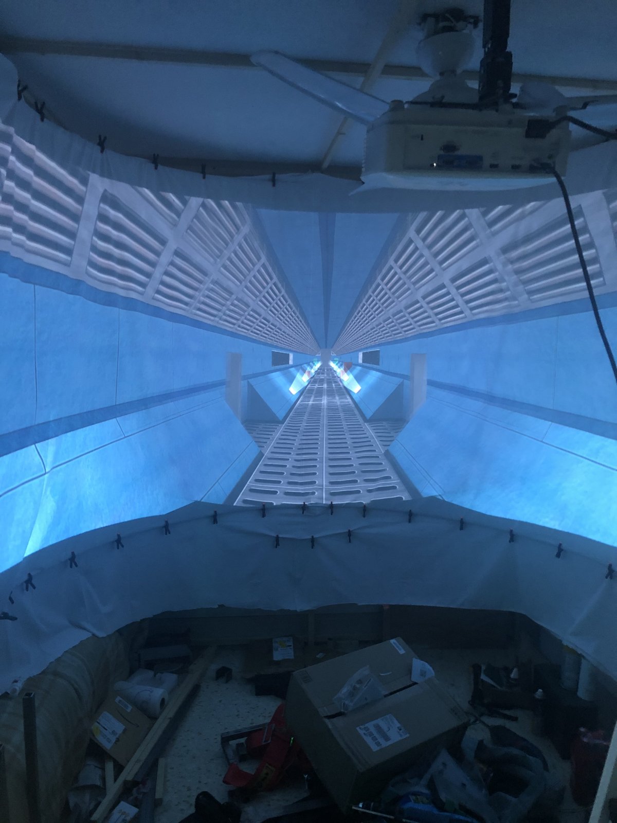

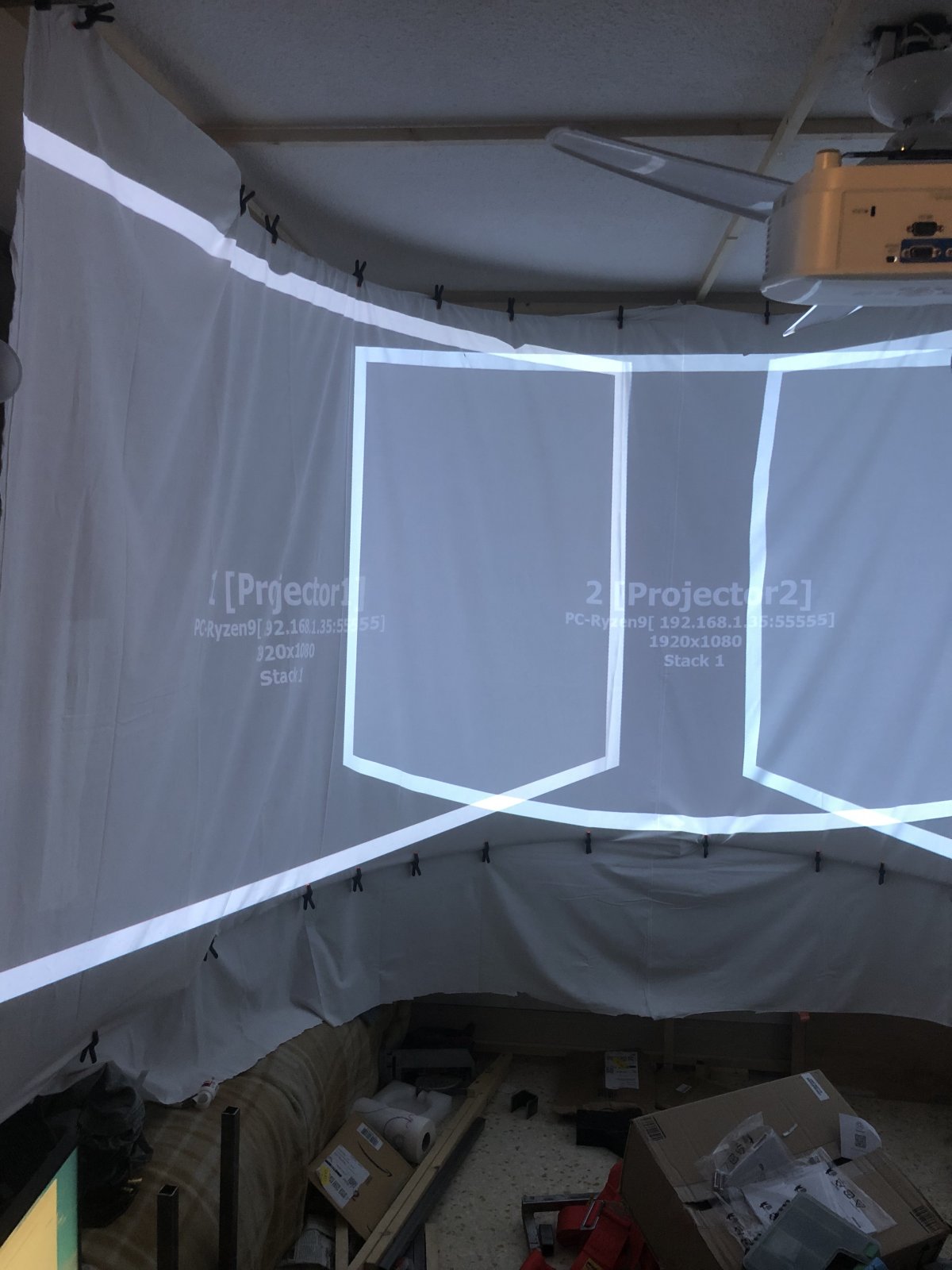

  10. GRAP
    GRAP Member
    Nov 4, 2023
    32
    Dog handler, Maitre chien
    Montpellier
    214Coins
    +36 / 0 / -0
    Delay it s one game beamer, 19 ms, so it s good.
    i m still in test. i just fisish the actuators last week.
    screen ?
    simple bed sheet to make the curve with a circle at the top and bottom.
    I'm going to look at a soft plastic to make it better.
    my simulation is in the dining room and everything has to be dismantled with just 1 person.
    with the 3 projectors, I can use FS2020 fully in the options. 4080 super graphic cards
    I just have 2 or 3 test photos. I use fly elise program to display the curved image.

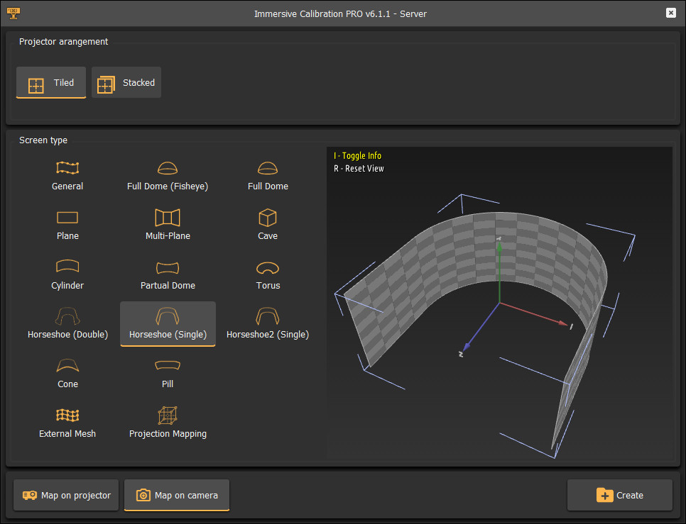

    Wow, I just googled "fly elise". That really looks interesting. As I said, I fear I don't have enough space for a full 180° screen and 3 projectors. But something like the Cobra Venom could be possible. IIRC, "fly elise" is also mentioned there (see thread by @peter stolmeier).
    Is the software for correcting the distortion of the curved screen and the blending of the overlapping areas affordable?
  14. GRAP
    GRAP Member
    Nov 4, 2023
    32
    Montpellier
    214Coins
    +36 / 0 / -0
    For 180 screen, you need 2 projectors.
    Yes, fly elise is to project on any curves or 1 full sphere if you have enough place.
    fly elise does the job but the automatic setup with webcam didnt work so i did the setup by hand. The price with usb key is little too much ...500e ... and update is for 2 years only . I find only this so no choice.

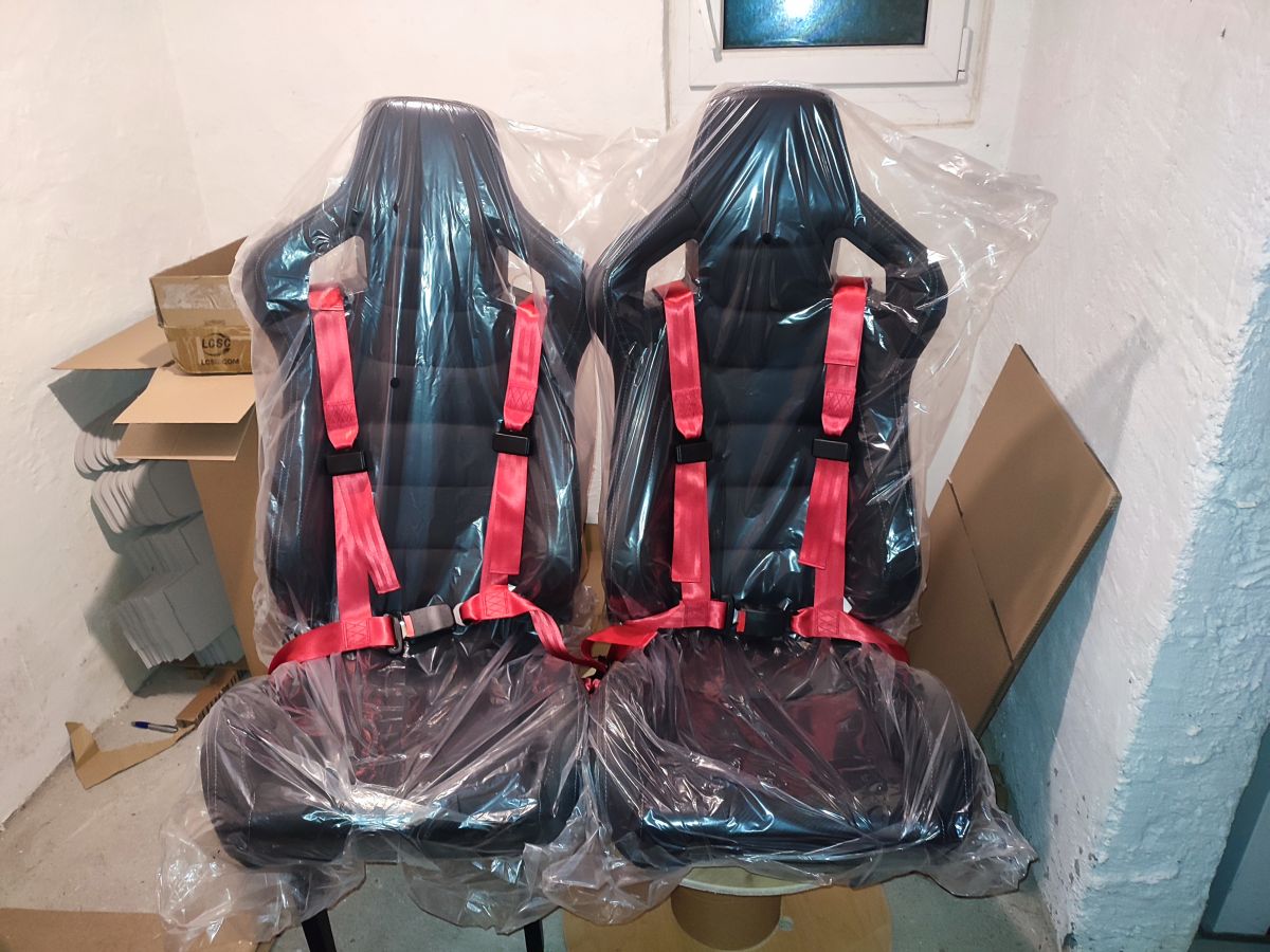

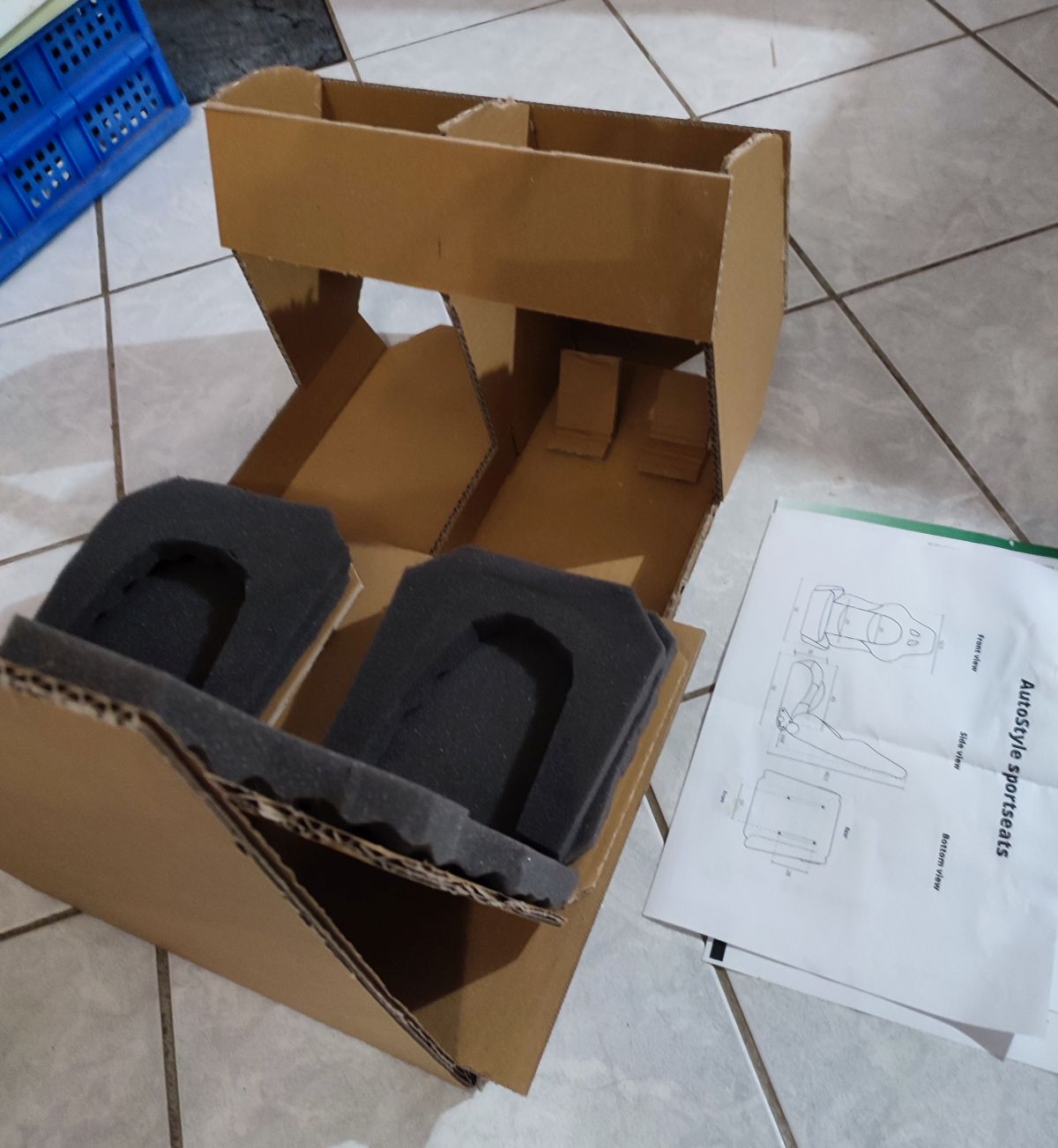

    Unboxing time, again.:) The seats and harnesses have arrived.

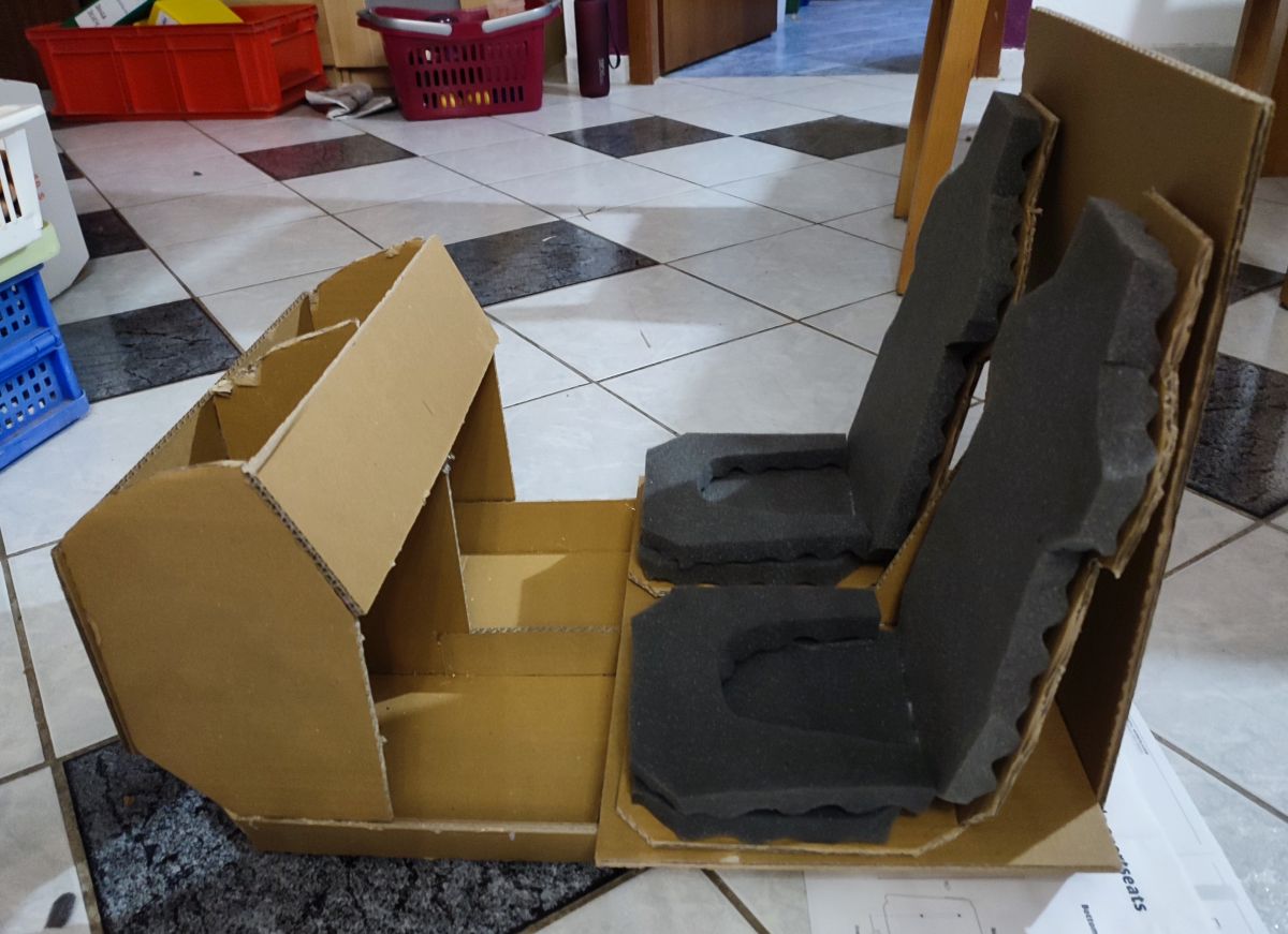

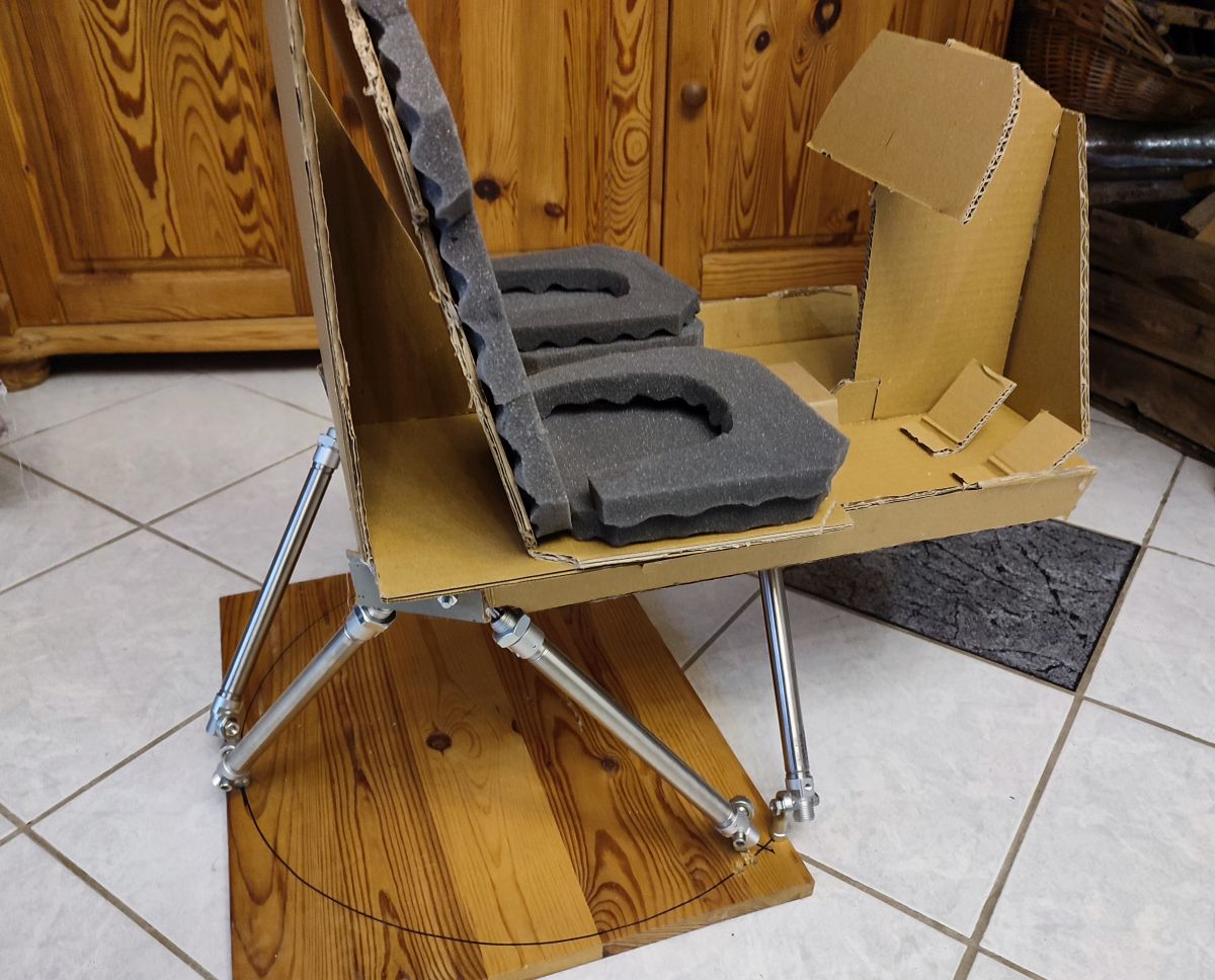

    To get a better feeling of the dimensions I made a scale model out of cardboard. (1:3)
    This is the abolute minimum space required for two persons. Now I have to find the best pivot points for the actuators. A triangle with two corners in the front and one in the rear is easier and leaves more space for doors. But it applies the roll torque at the weaker side of the structure. Two corners in the rear and one in the front center results in more rigidity. But the drawback is the pedals are in the way. I'd have to put the actuators under the floor which limits heave and pitch. I'll try out...
    Next thing to check is how much space I have for the screens.

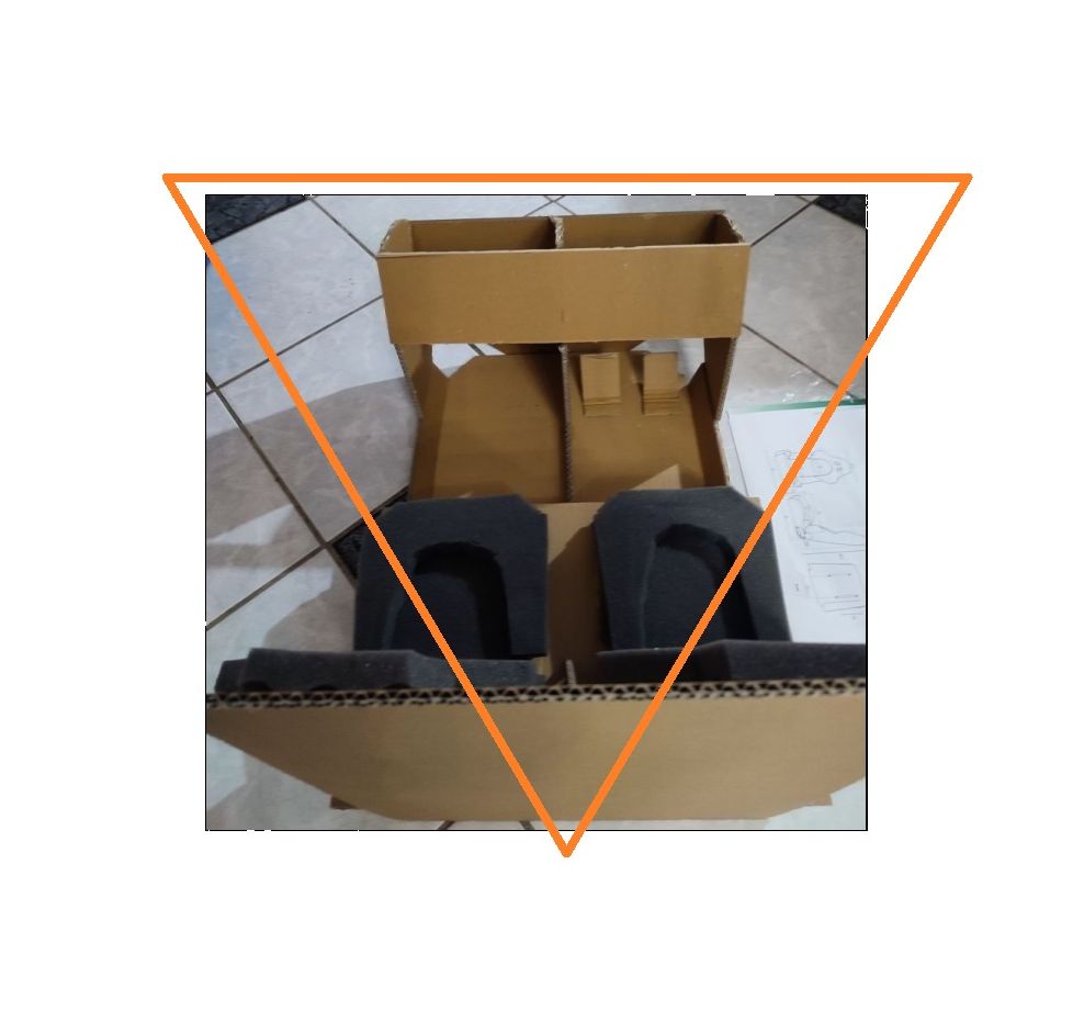

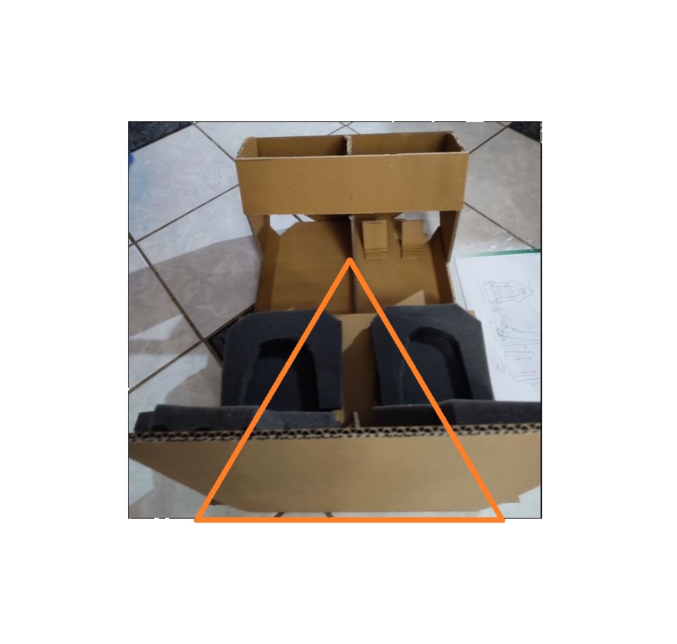

    :thinkI fear this ain't gonna work, at least not as I planned it, first.
    My first plan was to put the joints relatively close to each other. This way I could get more pitch and roll angle and also more surge and sway for the same stroke length of the actuators. But this means that the rig would sit nearly on top of the actuators. Placing the joints under the seats and in the middle between the footwells saves only ~10cm of total height. And the front screen is behind the dashboard console reaching far out. It'll hit the ceiling unless I had at least 3m headroom.
    So I have to do it like everybody else, here, and place the actuators in a circle around the rig with the top joints well above the foot level.
    But this means that everything becomes much bigger, especially, I need waaayy more stroke for the actuators, something around 700..800mm instead of ~500.

    I added the actuators to my model
    It looks a bit asymetric but the idea was that the pilot's head is nearly above the center of the hexapod base circle.
    Hexpod2.jpg :D
    The diameter of the upper joint circle is 105cm (scaled down 35cm), the lower is 140cm (46cm). In the lowest position the bottom of the rig is 70cm (23) above the ground, in the highest possible position the top is 240cm (80) above the ground. So it should fit into the garage with 2,5m ceiling height.
    Maximum pitch can only be applied with the COR in neutral position. Pitch and heave cannot be both maximum at the same time, anyway. I have to mount the screens and check if the top edges collide with the ceiling. Maybe I have to make the base circle a bit larger. This way, the triangles formed by the actuators become even more obtuse-angled and the forces rise. But in the lower position there's not much rotation possible so the forces are shared evenly and this shouldn't be a problem.
    I also found out that sway causes quite some limitation to the possible roll angle, same for surge and pitch. Especially when swaying to the left, there is still much roll to the left possible but only very little to the right.
    This is good for car racing where the rig "leans outward" during turns to simulate the cetripedal forces. But for a helicopter the rig has to do pendulum movements around the rotor head which is above the rig. So when it sways to the left it also has to roll to the right. So an inverted hexapod bolted to the ceiling should perform better. Can anyone confirm this or am I wrong?
