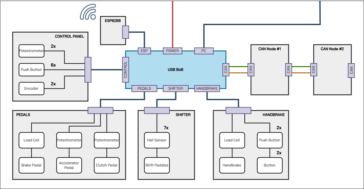

    Update #1 - Custom USB BoB
    As mentioned, we decided to make custom USB BoB. And whenever you make something, first you need to define what you want to achieve - specifications. And the picture shows more than thousand words :)
    Idea was to make ultimate expansion board, easy to use, robust and with more than just basic functionalities. Versatile. Board shall contain:
    - pedals (1x load cell for brakes and 2x potentiometer for accelerator and clutch pedal)
    - shifter (8x analog inputs with software defined thresholds)
    - handbrake (1x load cell, 2x buttons)
    - CAN (unlimited expansion possibilities))
    - USB connection to PC
    - ESP for WIFI and Calibrate-by-app
    - Controls (at least few Encoders,/Potentiometer and some Buttons)
    - I2C expansion (e.g. for OLED display)
    - Power Supply
    - Indicator LEDs
    So we have done some concepts in the past few weeks, ordered PCBs from JLCPCB and did some software for verification of the design. So far, so good! Hooray.

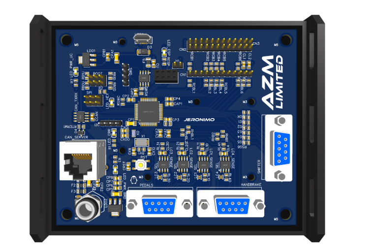

    So last weekend (incl today) I spent designing the target PCB with all connectors... and so Jeronimo was born ;)
    The front is plain 2-4mm (adjustable) single plate. It can be either aluminium or acrylic or even wood. Its meant to be removable so we can drill holes and make slots for possible buttons, potentiometers and encoders (these are not visible on the model, as that is planed for later)
    Ooopsie, that's just the aluminium case...
    The back side of the case contains the PCB. It is multi-layer and satisfies generic electrostatic and impedance standards. It has several connectors and expansions possibilities.
    - 1x DB9 connector for pedals (3x load cell / potentiometer)
    - 1x DB9 connector for shifter (8x analog inputs with software defined thresholds)
    - 1x DB9 connector for handbrake (1x load cell / potentiometer, 2x buttons)
    - 1x RJ45 (ethernet) connector for CAN (unlimited expansion, 2 amp max)
    - 1x USB Micro B connection to PC
    - 1x ESP01 connector for WIFI and Calibrate-by-app
    - 1x Control Board Expansion (2x Encoder, 2x Potentiometer, 6x Buttons)
    - 1x I2C expansion (e.g. for OLED display)
    - 1x Power Supply Jack (5-12V)
    Or better yet... in picture!
    So design is frozen, PCBs soon ordered and meanhile we will continue on Pedal and Handbrake assemblies!
    Stay cool! hug:

    Biggest advance was on USB BoB - Jeronimo. Thats where we added Fan/Blower support and OLED display connector. We are thinking to add one interface for active shifting, buuuut, we need more thinking here. Additionally, we are migrating to 4layer PCB to be able to deliver high power seamlessly.
    And we will put it on the KICKSTARTER!! :rolleyes: Because honestly, there are next to no such versatile boards :)
