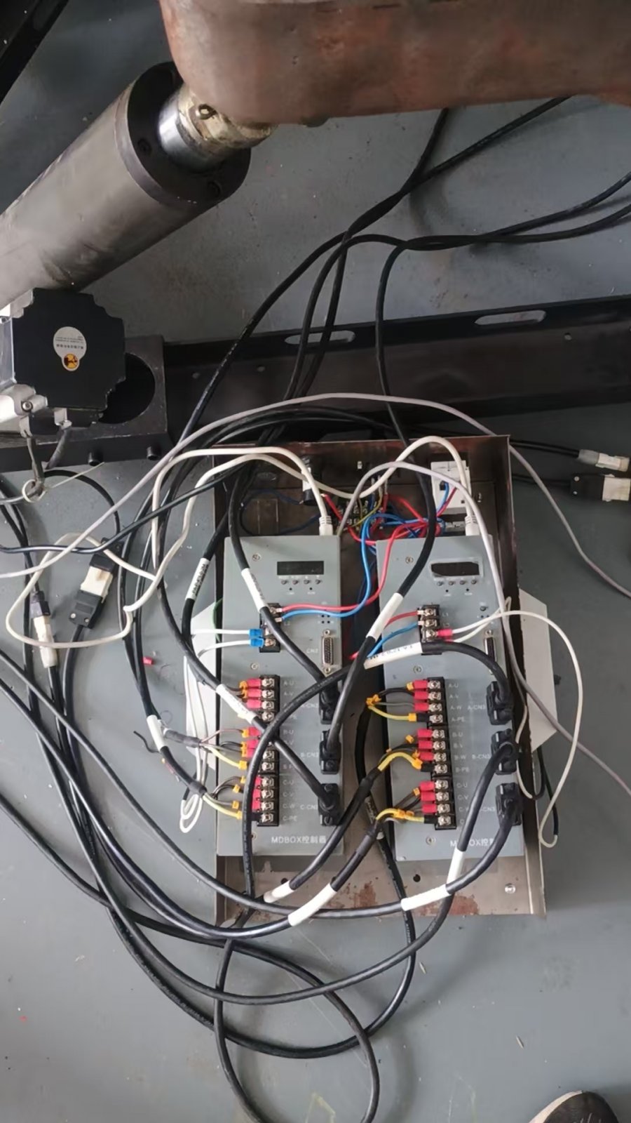

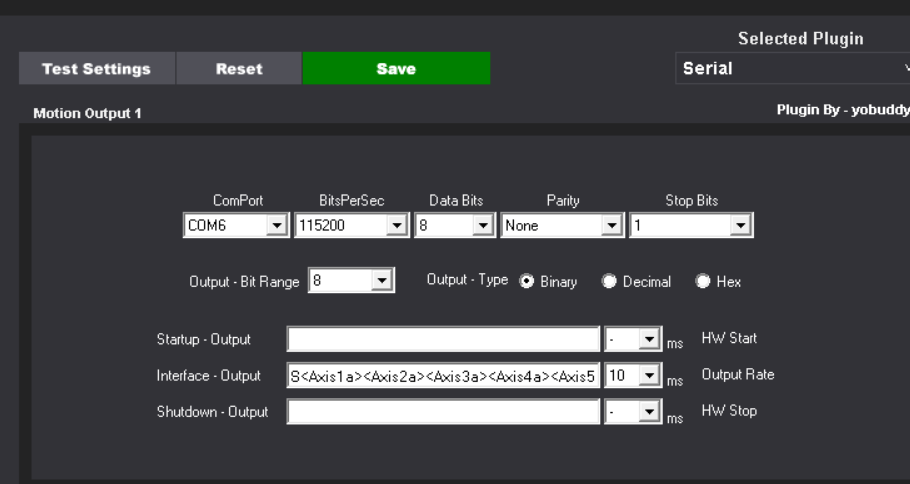

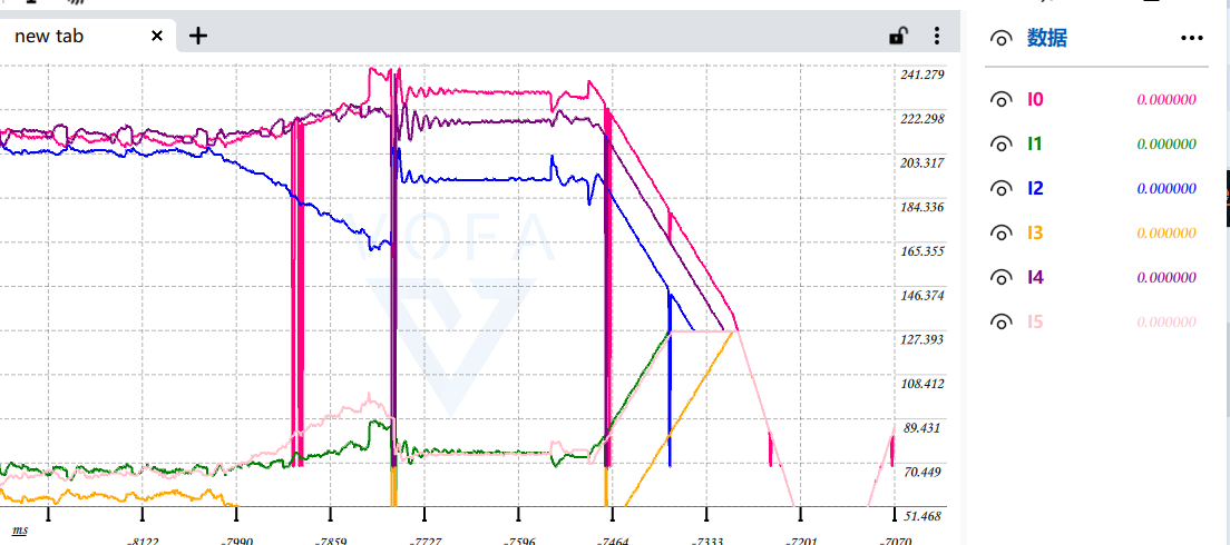

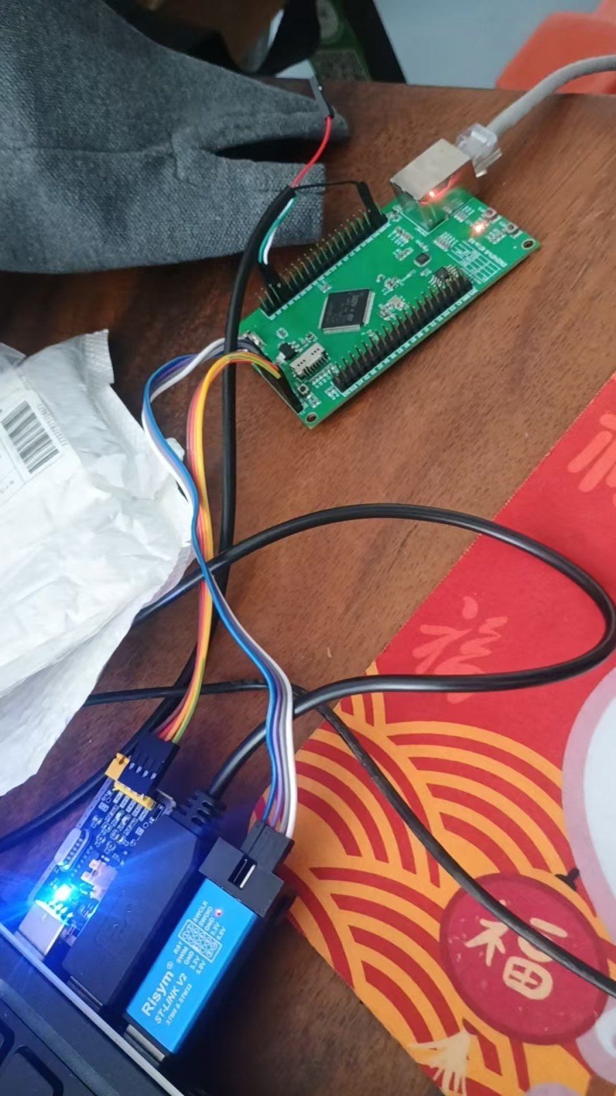

    Hello guys, I am trying to bulid a 6DOF platfor with two Syntron MDBOX. The PC is running simtools v3. Using serial port output to a STM32 PCB board. The MCU is running a small program sending UDP data to the Syntron MDBOX when it recived the serial data. The program really works. But now we have a problem: we capture the 6 Axias data from the serial port. It seem sometime the data is change very suddenly and unexpectedly. Why the data is change very suddenly and unexpectedly.
