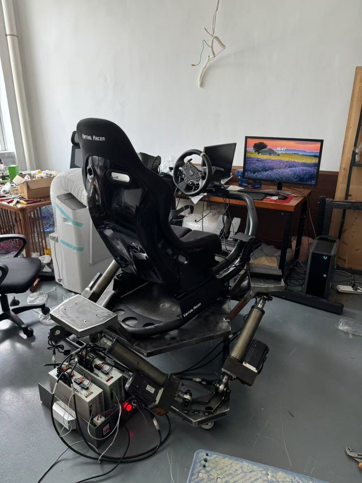

    We are building a really nice 6DOF platform with a 2pcs Syntron MDBOX.
    The actuator is 1000mm stroke length.
    What is the best method to control the Syntron MDBOX?

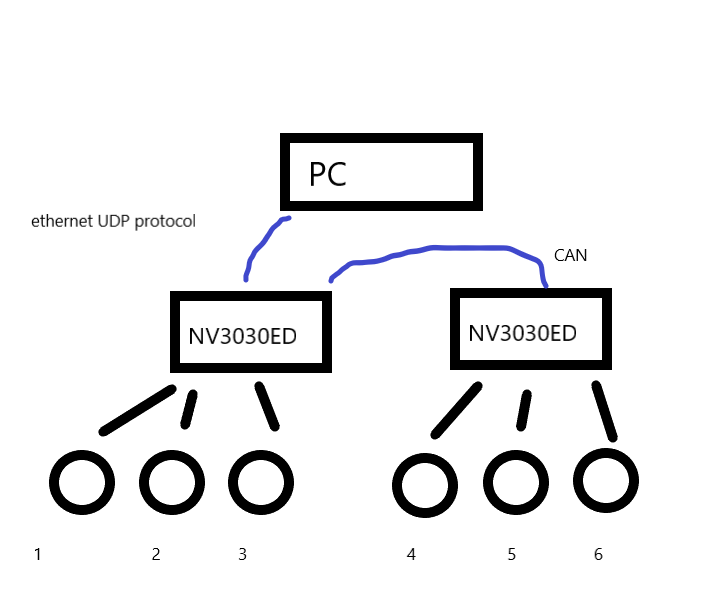

    Hello,I am from Shenzhen China.I am building a 6DOF platform too.I used 2pcs NV3030ED from Syntron MDBOX . I have install simtools v3 and MDBOX interface plugin on my PC 微信图片_20250828213854.jpg .But it did not work.Would you please tell me how to setup the Syntron MDBOX.

    Hello,Thanks for your reply.I am not good at English.I have found the UDP protocol for the Syntron MDBOX ethernet interface.Please check the attache file.Would you please help us to run the MDBOX as a interface via ethernet in simtools,Let's try togethter.
  8. linken
    linken New Member
    Aug 28, 2025
    8Coins
    Thank you for your quick response and the time you spend with me.I made you a diagram representing my installation.

    I bought an Alibaba LeaderDream 6DOF with UDP communication with a STABLECU JS-9D.
    I used the same documentation as you showed to use SimTools V3 with the DBox interface (from @yobuddy)
    My settings for the MBOX interface are: Mbox type [6 Axis], Max Axis Value [400000] (for safety), Ip address [192.168.15.201], Port [7408], Output Rate [2]ms, and Axis4a-Axis3a-Axis2a-Axis1a,Axis6a,Axis5a.
    I can use several games like MSFS2020, XPlane12, and all car racing games.
    I hope this will help you if you haven't figured it out yourself yet.
