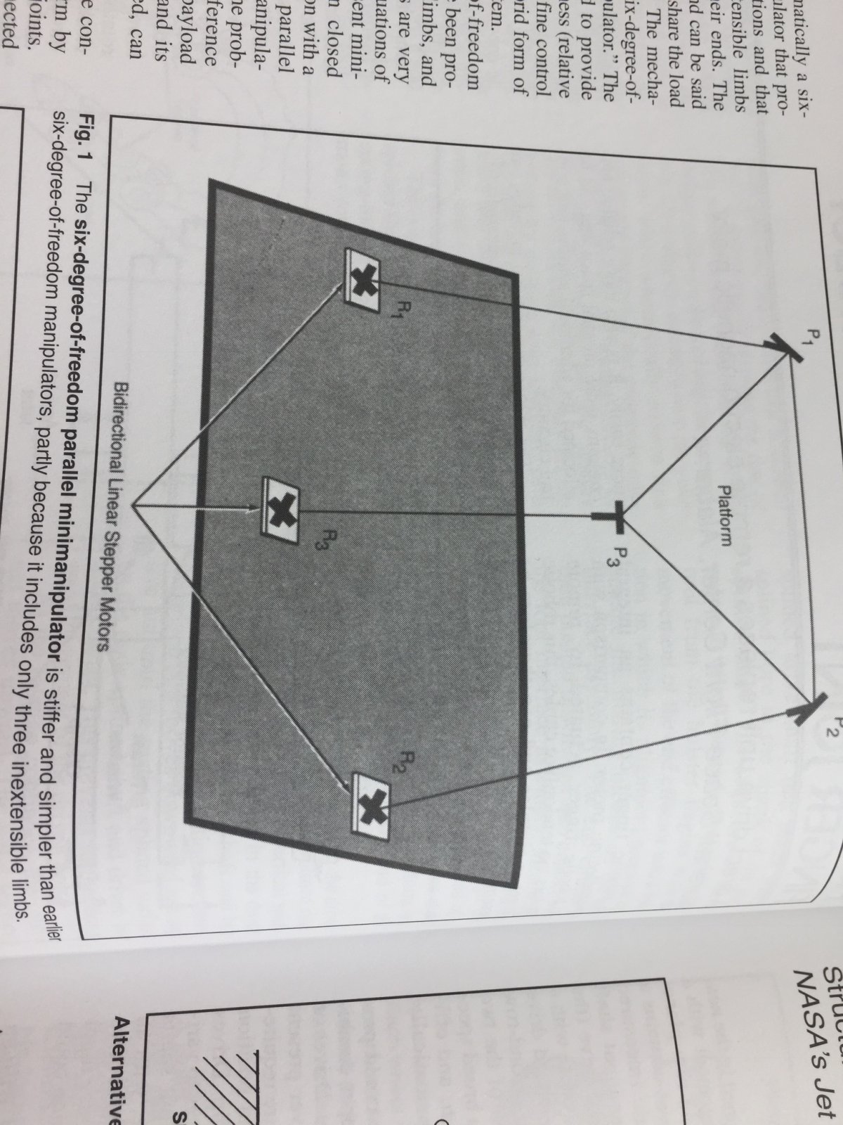

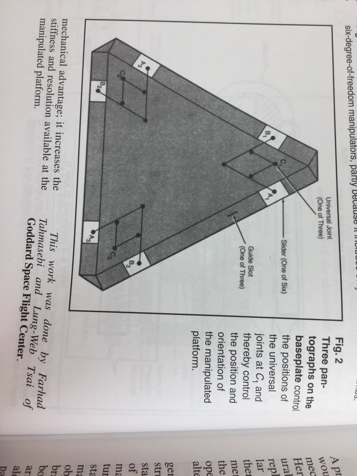

    I found this while perusing the library at school. Maybe it’s of some use here? BEBDCC19-81CC-422A-8B18-8E14E2FB6A3B.jpeg 3EB49F81-AD4F-4377-98C6-A64DC94BB3D2.jpeg 25298D1C-509A-4D90-B110-9CA64E6A8C4B.jpeg

    Looks like this:
    Thought about it while building my actuators.
    But we get less travel.

    Looks impressive.
