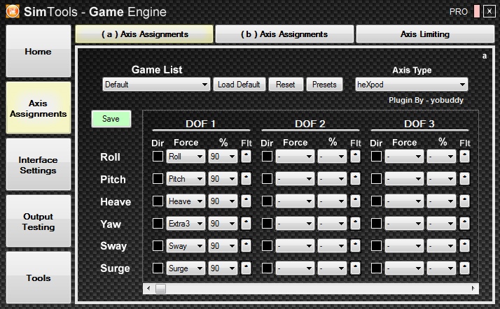

    Hi how do i load this preset?
  3. Thanos
    Jul 6, 2017
    1,347
    Electronics Engineer
    United States
    2,699Coins
    +1,043 / 9 / -0
    I'm not sure if this is for use with HEXPOD plugin...
    The HEXPOD plugin just needs to define the six axis in a single row, then it does the 6DOF mixing calculation internally...
    Just don't forget to use the traction loss axis (Extra3 in some games) instead of YAW.
