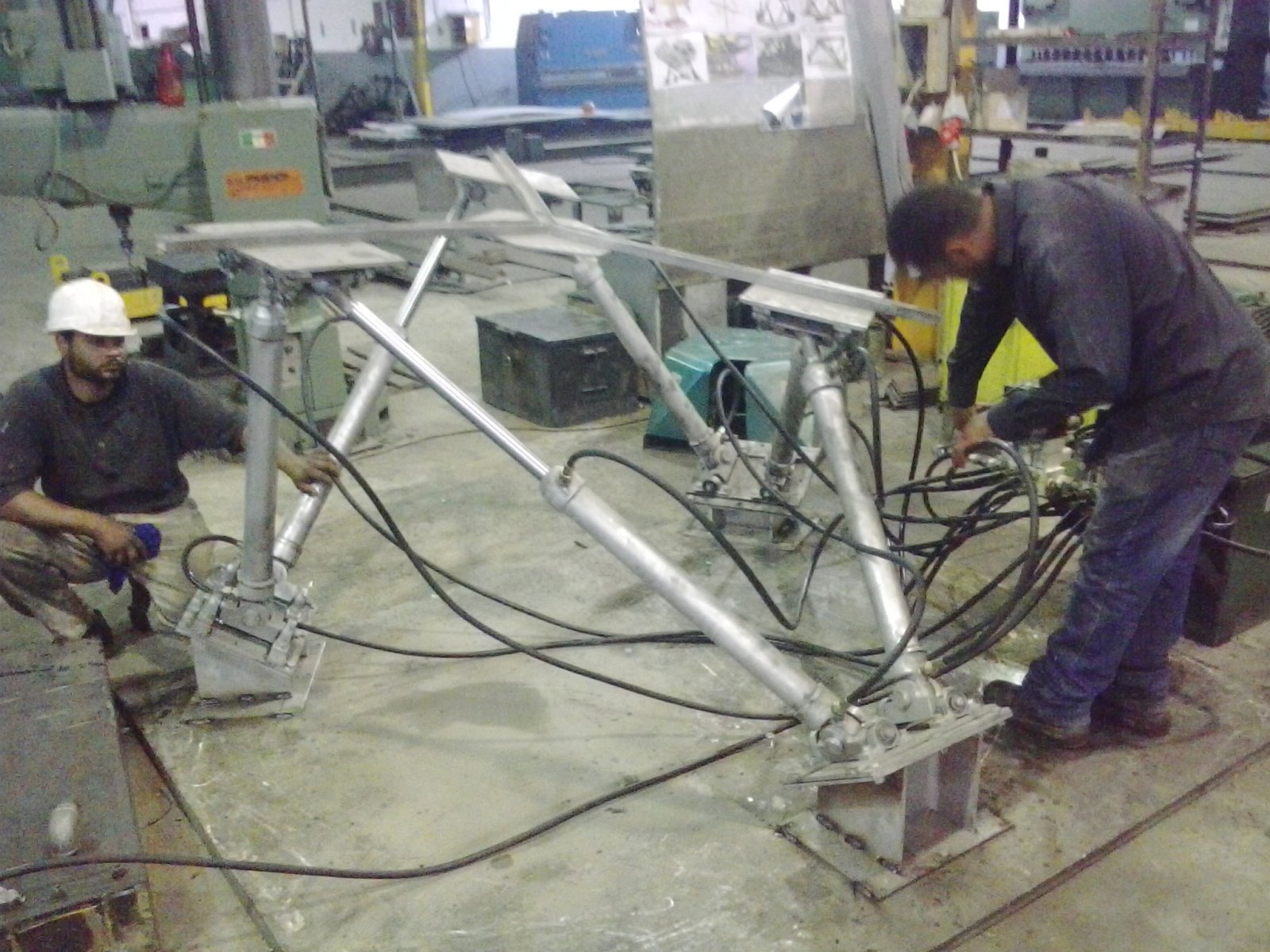

    When I first joined the website, i made a thread about the project I was getting into. But that was in a theoretical phase. Now I have some progress. Me and my buddy are looking forward to completing the assembly soon. Then we can do all our software testings on the arranged hardware.
    Basic details:
    - Stewart Platform
    - Hydraulic powered
    - Sync with X-Plane :) (this is where I wanted to implement X-sim)
    - Made of steel and trust me its really really heavy...lol
    Here are some pictures if you guys want to see. I will post details and more updates if anyone actually is interested.
    By the way... we have made some alterations here and there. But just posting to share and give you guys idea of what I am into right not.
    Top and base

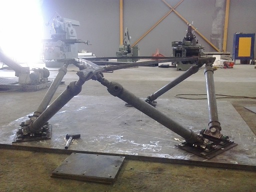

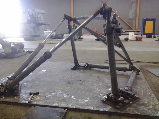

    Platform in real life with the actuator (not assembled)
    [img600px]http://img834.imageshack.us/img834/3317/41723910151387805240494.jpg[/img600px]
    [img600px]http://img713.imageshack.us/img713/6313/41936110151387805400494.jpg[/img600px]

    Trying to assemble and troubleshoot
    [img600px]http://img845.imageshack.us/img845/9485/43070410151387805545494.jpg[/img600px]
    [img600px]http://img855.imageshack.us/img855/2858/42534910151387805820494.jpg[/img600px]
    [img600px]http://img546.imageshack.us/img546/7585/41955310151387807240494.jpg[/img600px]
    [img600px]http://img33.imageshack.us/img33/4920/42278910151387806935494.jpg[/img600px]
    [img600px]http://img252.imageshack.us/img252/2455/42130510151387807115494.jpg[/img600px]
    [img600px]http://img191.imageshack.us/img191/156/42061210151387806135494.jpg[/img600px]
    Since X-Sim2 will not do it directly, trying to learn to implement the 6dofmaster software made by Robin too. As a backup plan, purchasing a 6dof software. But I am more inclined towards doing it with X-sim involved in the process.
    Feel free to ask questions or simply comment. And if you can help with the C++ modification of the source code of Robin's 6dofmaster ...do not hesitate to put me out of my misery 8)
    Regards
    MSK
