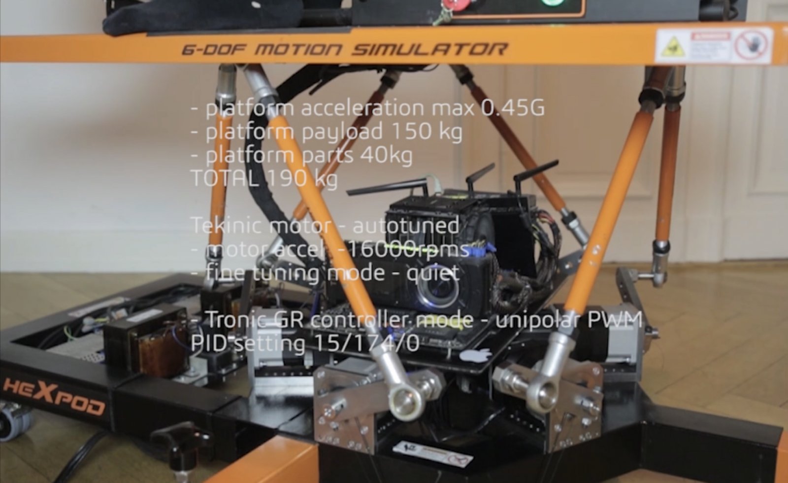

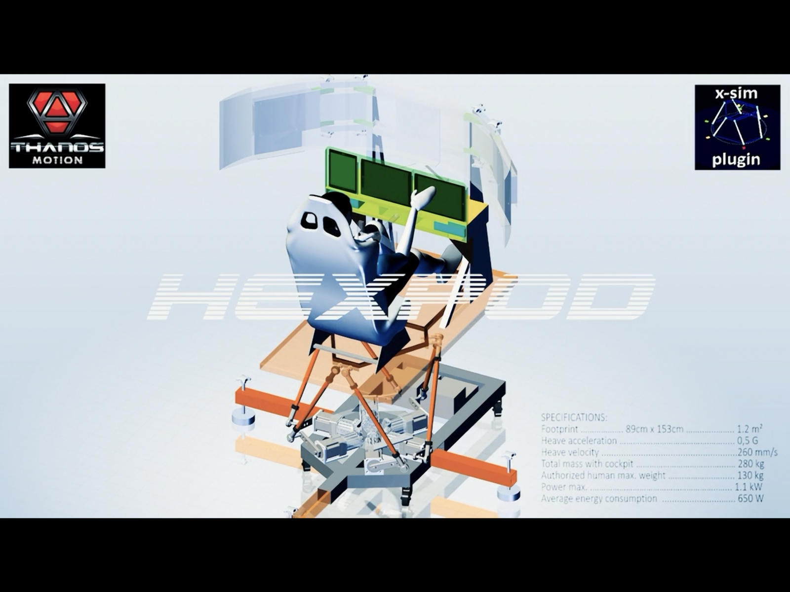

    heXpod 6dof all-in-one motion simulator is a DIY Stewart Platform based on "bare bone" AMC1280usb controller equipped with Teknic BLDC servo-motors with external feedback positioning sensors.
    Small footprint (90cm/140 once stored) was a prerequisite to reach the famous WAF* factor.
    Back than I was searching for servo-drives with absolute positioning capability but unfortunately the interface to the internal encoders was not possible due to manufacturer limitations. (That's why we switched to feedback sensors)
    heXpod 6-dof software is a thir-party IK plugin for X-Sim and SimTools ajustable for any kind of Stewart platforms based on AMC controllers.

    @hexpod - I was looking at the Teknic website and was curious which 3432S motor you used. I’m guessing MC series? If so, did you use the ASU-FR510 Analog Send Unit to convert from the AMC 1280USB signals?
    Also, the Newstart IB90 looks good. Does it take the 0.5" motor shaft directly? I’ve been looking for drawings but haven’t found them. I also don’t find a vendor that sells them. I have only found the specs. Where did you get those?
    And from the two big transformers, I bet you built your own power supply for the motors? Did you go 75 volts or a different value?
    It looks like you changed from tooth belt feedback to a drum and pull string. I like both setups. Is there a reason you switched?
    I really like the outriggers in your design. Much simpler and more compact than a full hexagon.
    Sorry about all the questions.

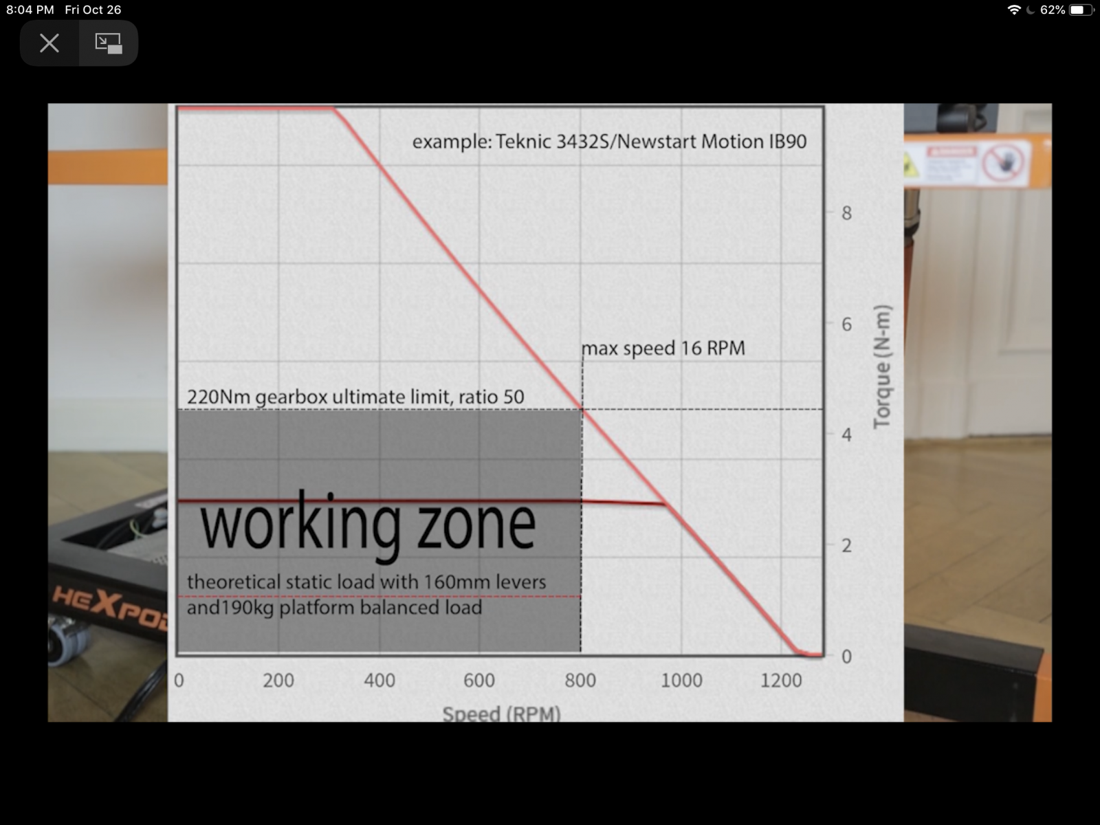

    @FoxONe42 - There are these specs from Hex's videos. The BLDC motors have some advantages over AC for me because I can use batteries to get past the average current draw issue on a 120 volt mains. I also like the planetary gearboxes over worm since it appears wear is less localized with more gear surface carrying the load. I think I have enough to get started except for a gearbox source but Teknic says contact them for compatible gearbox sources.
    Definitely a more expensive rig but Hex did a beautiful job with the design and it looks very capable and no biger than my current 2 dof when stowed.
    No, the AMC is directly interfaced with the servos in PWM velocity mode
    Yes, The IB series from NewStart are directly compatible. btw they changed the labeling since I bought them. I think it's AB now. You have to deal with the application engineer to get all infos you need.
    No, I use Teknic power supplies.
    No, it's the opposite. The timing belt is more reliable I think.
    Teknic has lounched the new AC servo. I am sure Newstart can provide a good box for it.
    You can go with higher speed and more load.
    Ultra simple wireing. Remember, heXpod max speed is 16rpm
    The only pain with Teknic is that you can't do the absolute positioning. If it would be possible that would be a perfect engine in my opinion.
    Maybe you can find on the market another brand with similar specs which allows the absolute positioning.

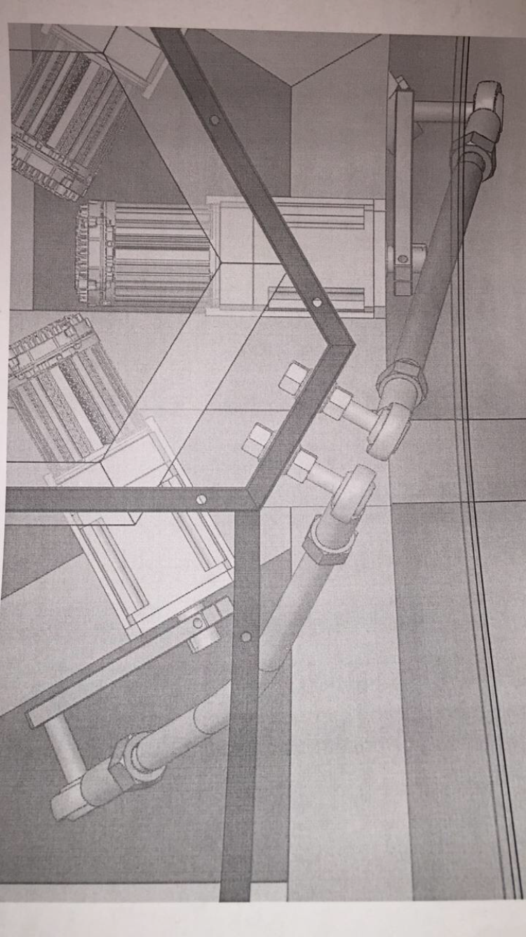

    realise your rods are bend in the latest videos
    Yes I bend them for two reasons:
    1.) the design with motors inside and a platform ratio 0.82 that I use, gives you to much collisions while the arms are operating in the lower range.
    2.)bending the legs corrects the joints starting point bank angle. see the picture below:

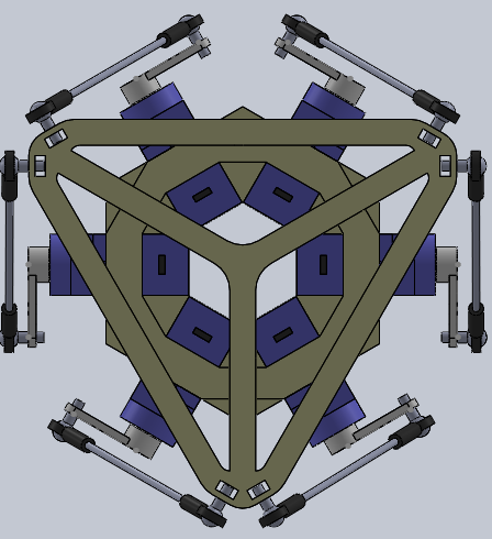

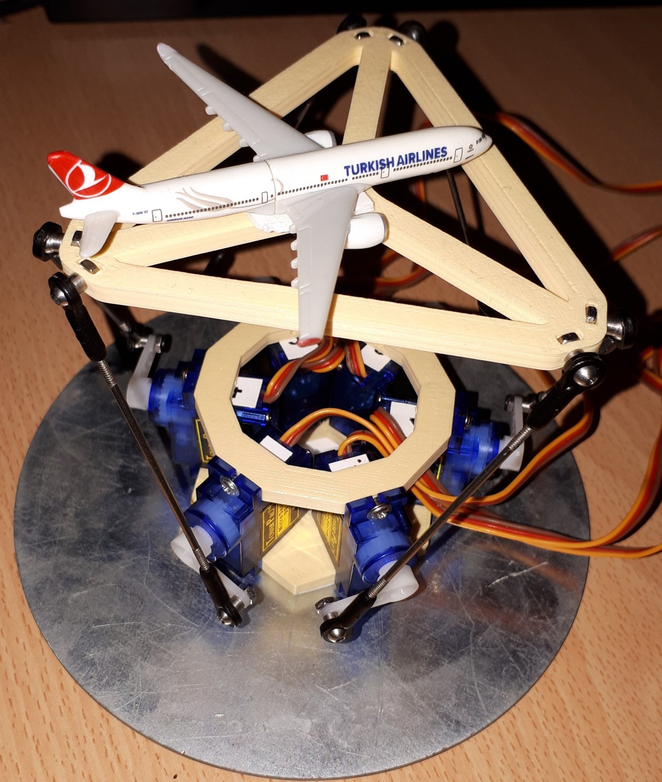

    --Regarding the rods, I understand why you did that, it makes sense. Now, I came up with the same concern when designing the RC scale model, and I made sure both joins were aligned so that at the start position, there is indeed no angle. See picture below. Any reason you didn't go that way initially ? (I mean, I just want to make sure there is nothing wrong with that if I go full scale)

    --Regarding the motor sizing, do you have somewhere the calculation you make ? Or this was done with an application engineer from Technik and newstart ? I am asking cause my knoweldge regarding this is very limited so I an trying to gather as much info as possible before contacting those guys.

    --Regarding the rods, (…) Any reason you didn't go that way initially ?
    yes, platform / base ratio. basically speaking: bigger the ratio, bigger the rotational amplitude. (you can easily simulate it with heXpod software). The rotational ability is pretty narrow in your design.
    definietly not Teknic. Newstart guy should give you all the info you ask for.
    Your biggest enemy is the motor RMS (continus power). I would advise to keep your torque below 50 percent in static calculations if you want to go with different reductions.
    ex: (RMS 2.7 Nm) * (reduction 40) * (lever length 16cm) = 675 Nm = (68kg on each leg * 6) / 50 percent = 204 kg.
    Now, you will accelerate this 204kg lets say up to 0.5g. which means that your reducer should be able to take 4.05 Nm of torque.
    As you can see in the doc., the AB90 is rated for 120Nm nominal 180Nm max and 360Nm emergency stop so you should be fine:
    http://www.newstartmotion.com/d/file/PRODUCTS/IBIBR Series/2017-07-04/1c039bae8c46a023fc2f0f82b7ec897e.pdf
    Usually, they are able to produce the ratios you dont see in the documentation.
    If you want deal with more load or more accel or longer lever or more speed, than choose bigger motor and sronger gearbox. Or reduce your lever or your accel or load :)

    IMPORTANT:
    you may want to limit your teknic motor max torque to fit the max gearbox torque otherwise you will most probably grind your boxes quiet quickly.

    --The rotational ability is pretty narrow in your design.
    Yeh I do agree, my previous scale model platform had a different platform to base ratio, and a better rotational ability. However, it was very easy to reach the limit angle of ball joins since the original position already started with a non nul angle. Anyway I guess it is a matter of compromise, as always. You say it can be simulated with heXpod software. Can this software be used as q stand alone, or it necessarly has to be interfaced with AMC 1280 USB control device ? Righ now I am using an arduino Uno to control my 6 RC servos and I am wondering wheter or not I could be using heXpod in that case.

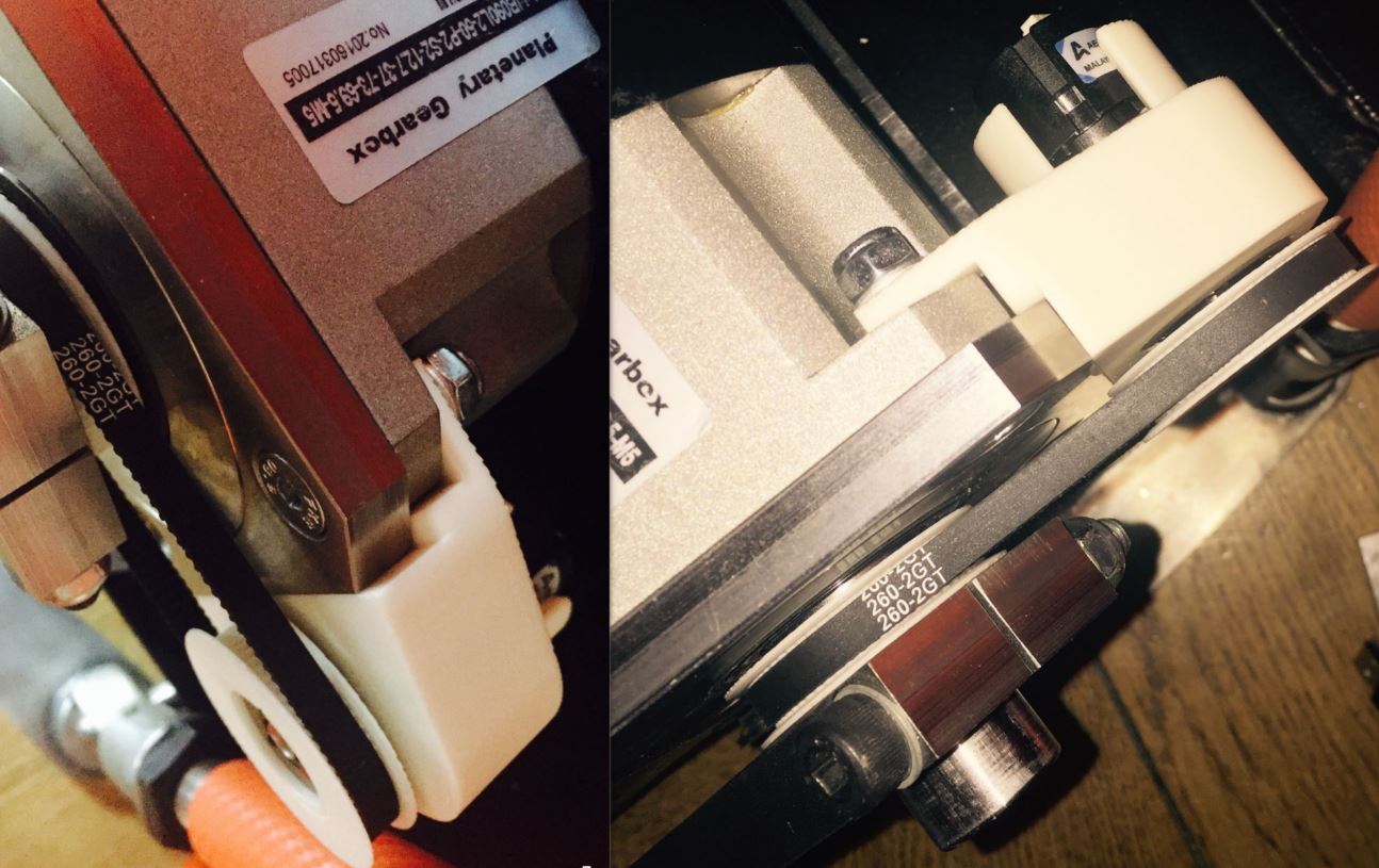

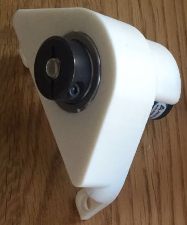

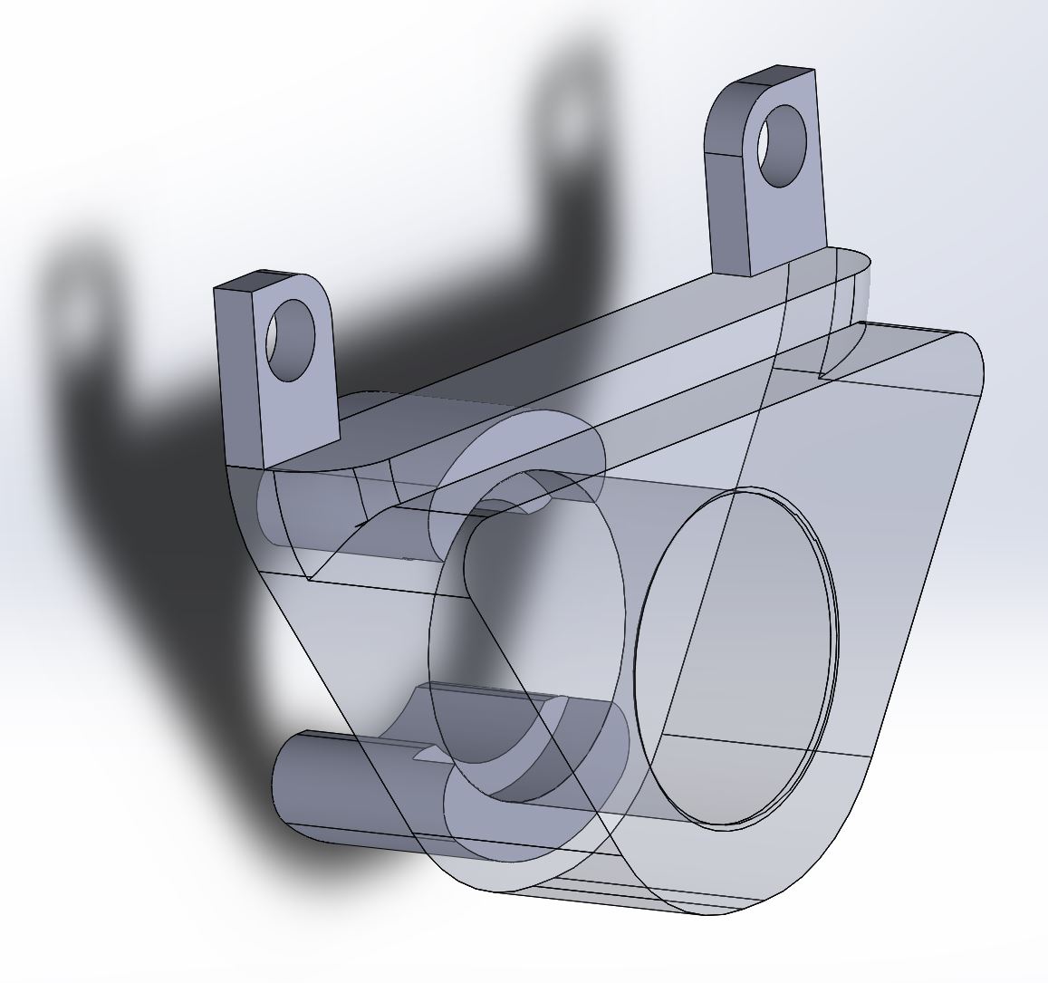

    Now, regarding the position sensor, it looks like it is your own 3D printed design, including pulleys, am I correct ? It looks like the position sensor shaft is directly connected to the pulley, isn't there any risk to damage it due to the belt tension ?
    Can you share with me the gearbox support thickness and the lever arm thickness as well ? last for tonight, what is the size of your heim joint ? M14 ?
    As usual, thanks in advance mate
    No, I've printed a socket which incorporates two bearings in order to deal with relatively strong radial loads due to the belt tention.
    I use the ratio 1:1 but in order to get even more resolution you could use a smaller one like 1:0.7.
    Theoretically even Something like 1:0.2 could be used as @Thanos can convert those sensors to multiturn by reading them multiple times. No idea if it worth the hassle to go this way. Talk with him if you are interested.
    I theory again, one could imagine even a homig function being implemented.
