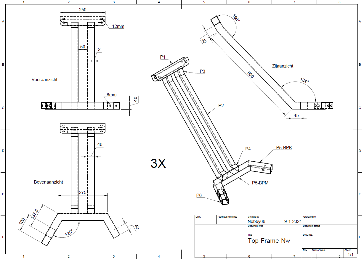

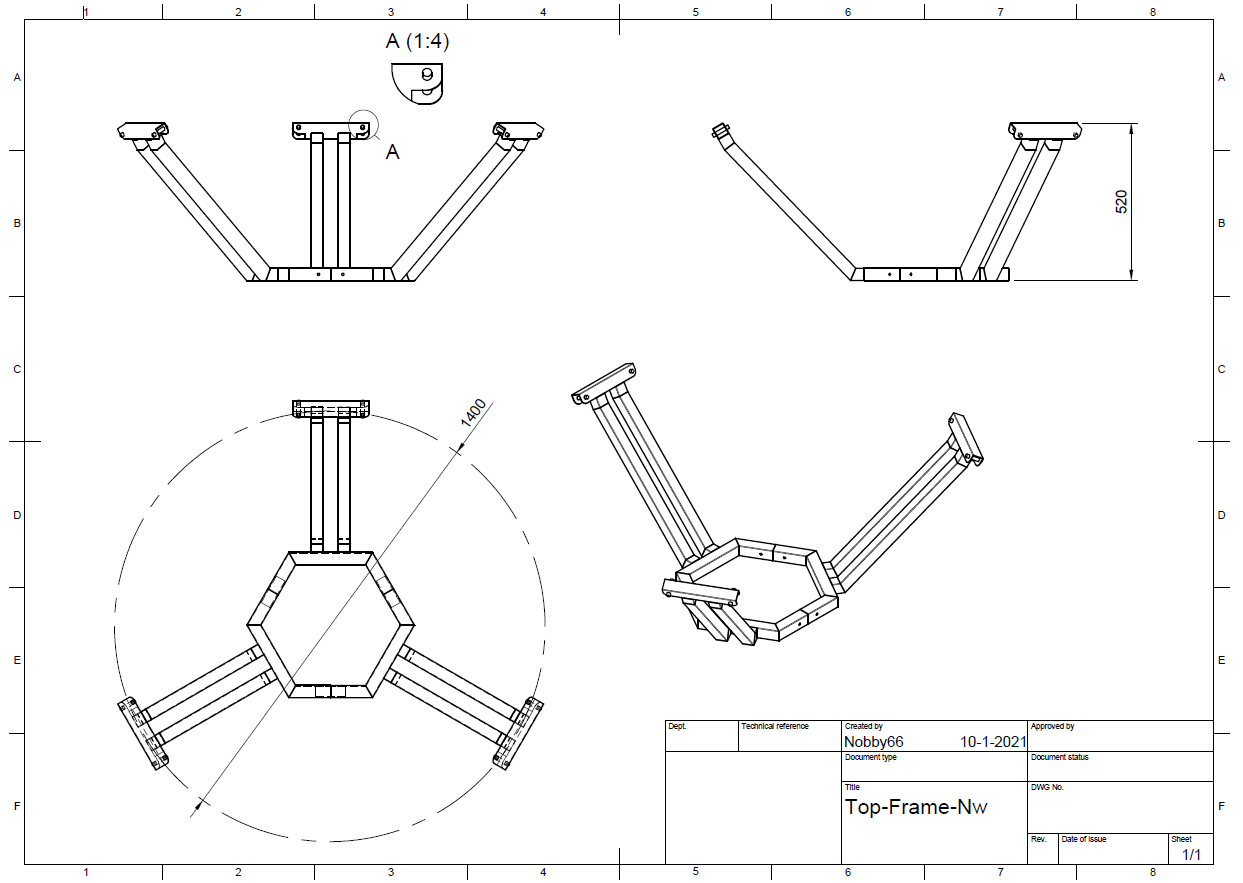

    Hi @Peacemaker105 and others,
    Thanks for your inspiring threads.
    I'm starting with my own build. On page 6 I found your drawings of the frame. I also made a design myself (for the time being of the upperframe) but I can't judge if it will be stiff enough or too much overkill.
    The intention is to make this from steel.
    Your frame looks thin compared to mine. In your experience, is your frame rigid enough?
    I read somewhere that @SilentChill has reinforced its frame afterwards because there was too much flex in it.
    Mine is designed in such a way that 3 of these parts form the top frame and can be disassembled.
    Overkill or good enough? I appreciate your opinion or that of others if they read along.
    Kind Regards, Eric

    It whill be stiffer welded in one piece, and you can get problems putting it together with a triangle
    succes ad

    @adgun I don't really understand what you mean by: 'putting it together with a triangle'
    For convenience here my concept so the pdf drawing does not have to be downloaded, I did not know how to process an image in a post, now I do ;-) (I don't know much about construction, yet)

    On youre first drawing you have 3 the same parts .that you wat to shuff it together the first 2 wil fit but the third wont fit becauce it isnt a stait line.
    (je krijgt de derde alleen in elkaar geschoven als de delen in een rechte lijn staan, maar deze komen zo in een hoek te staan en kunnen niet in elkaar schuiven)

    Thanks for the advise, I didn't think of that. (Daar zou ik te laat achter zijn gekomen ;-( )
    If I would do P6 on the outside, I think it would work. You can then slide it over the seam when the three parts are properly positioned and fasten it

    +138 / 4 / -0
    You could be lucky when you put the 3 parts together at the same time with even force, but most the time you need a hammer for it

    Only when you make p6 lose it will work, than you can put one p6 all 3 parts fit them together and shuff it over.
    You will lose stiffnes this way

    That was indeed the idea so that it can be dismantled. Question: do you think that the (more or less) diagonal tube P2 (40x40x2mm steel) can also be done in a single way? Top-Frame-Section.png

    no problem

    By 'no problem' you mean that it will be strong enough with one angled tube?
    I will still have to place a connection tube (probably made of aluminum) at the front (from left to right) for a steering wheel or something like that.
    The drawing with the double oblique tube seems much stronger to me, but is perhaps overkill? (and too heavy)?

    Yes that is what i mean
