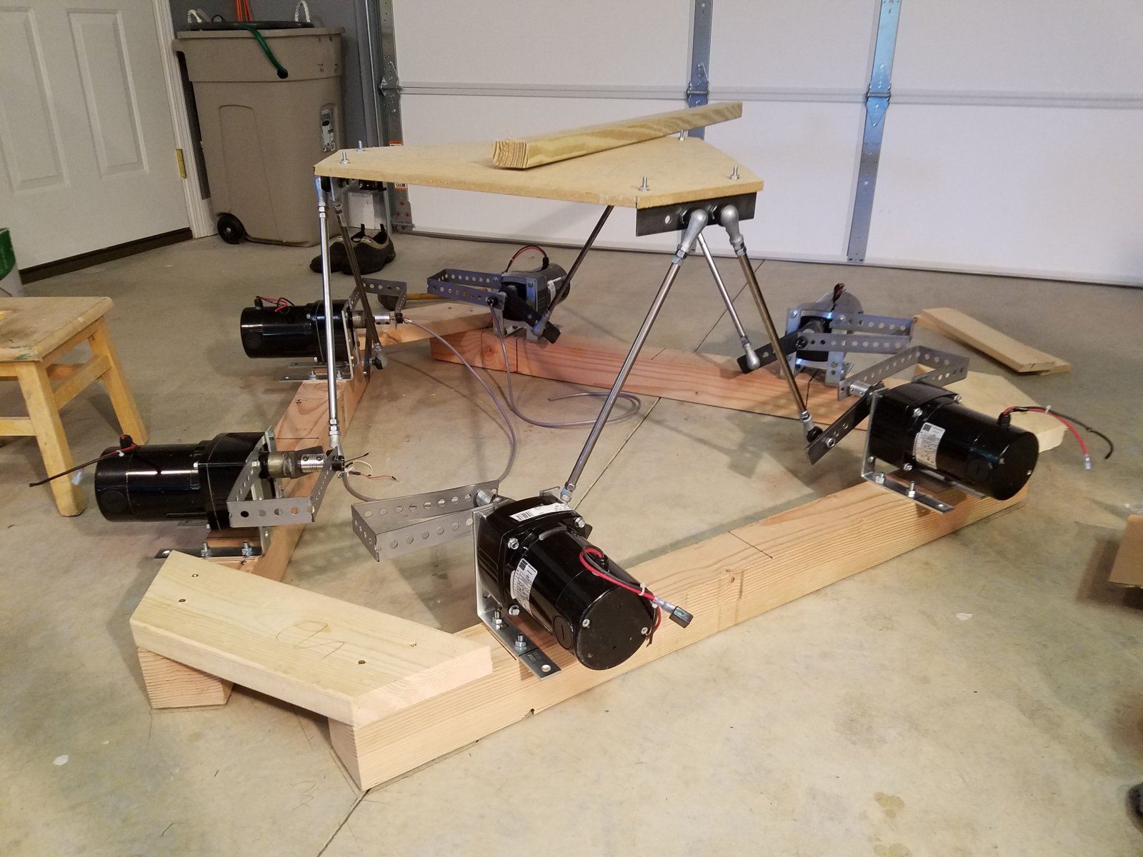

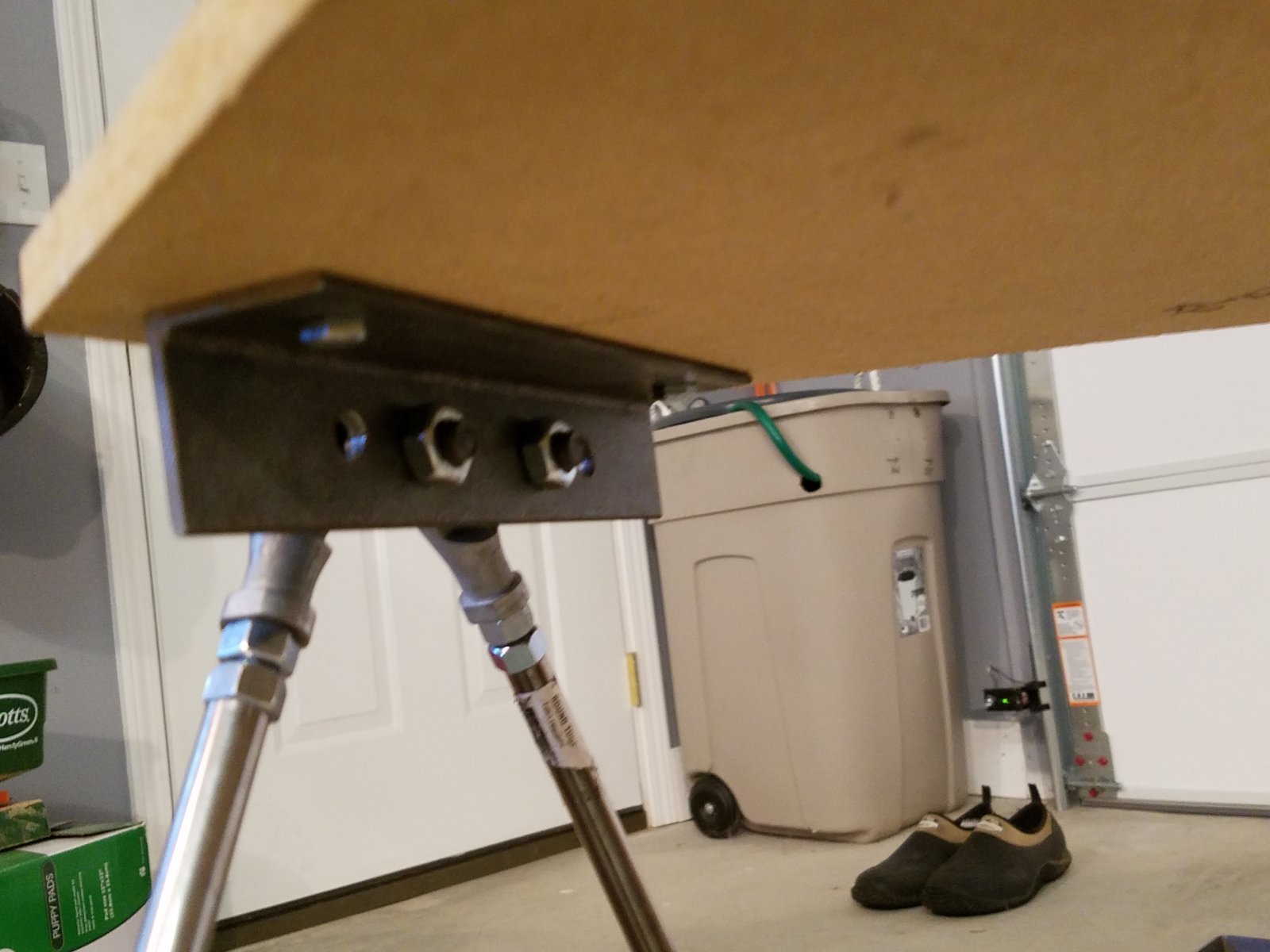

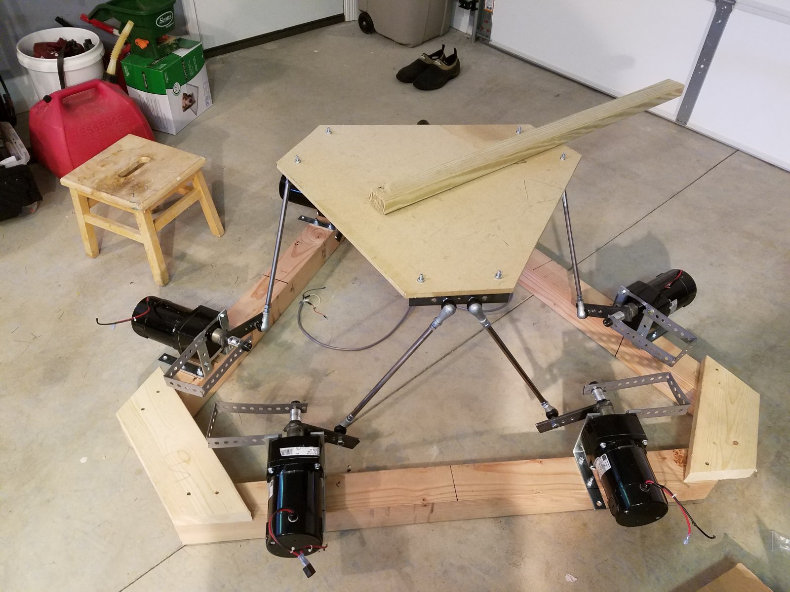

    yes a gusset would help but i still dont think that will be enough. the motors are 13lbs by themselves. it will oscillate at the least.

  6. BlazinH
    BlazinH Well-Known Member
    Oct 19, 2013
    2,145
    Oklahoma City, USA
    16,689Coins
    +1,839 / 32 / -1
    Yes, I saw that too! But while it is friendly offer, who likes to take something to someone else to do it for them when they don't have too? Also, just because they both live in Michigan doesn't necessarily mean they live close to each other.
    The facts are that although you wouldn't want to support motors by the motors only, he just needs to stabilize them a little bit. So 6 wood blocks and $12 worth of hose clamps will take care of the problem in short order without all the hassle. ;)
  7. bruce stephen
    Jun 7, 2015
    1,286
    general contractor
    michigan
    9,115Coins
    +1,243 / 9 / -0
    Thanks @BlazinH. he does live very close. 10 minutes. We've talked on the phone also. So it's not impossible. But I also understand doing it yourself. Try the wood if that doesn't work gimme a shout.

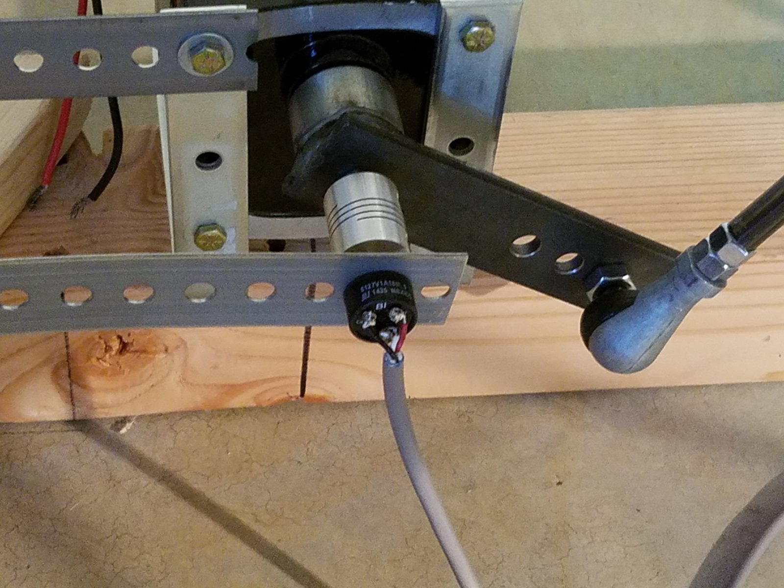

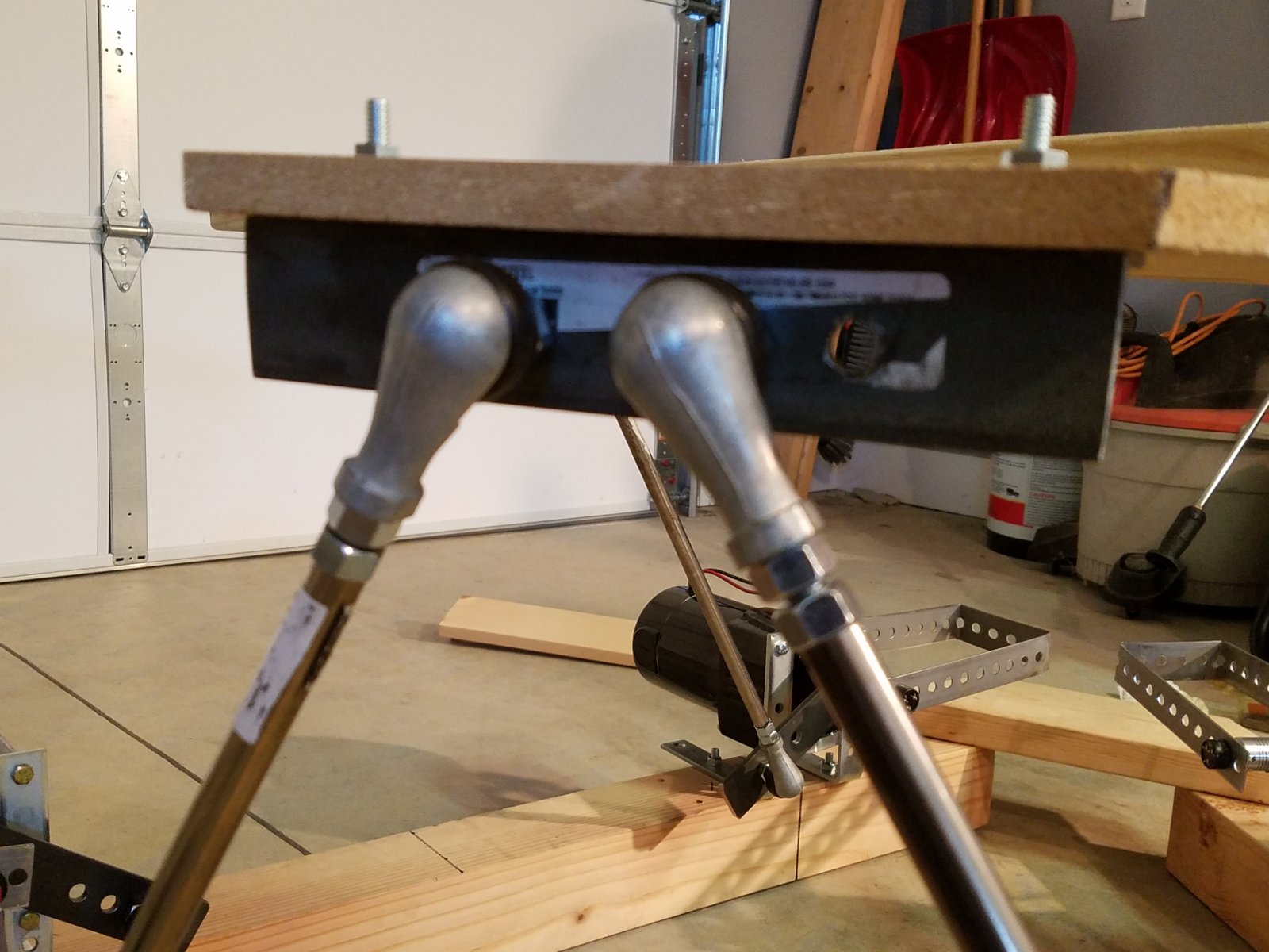

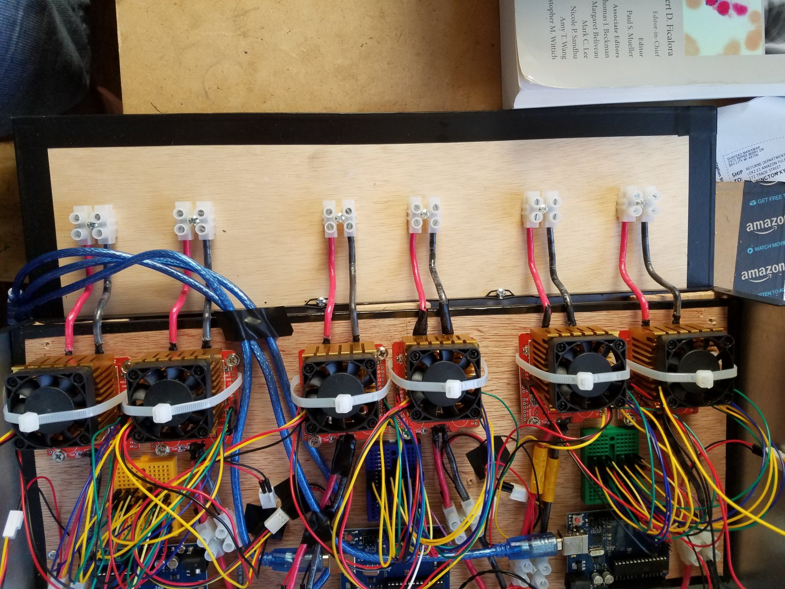

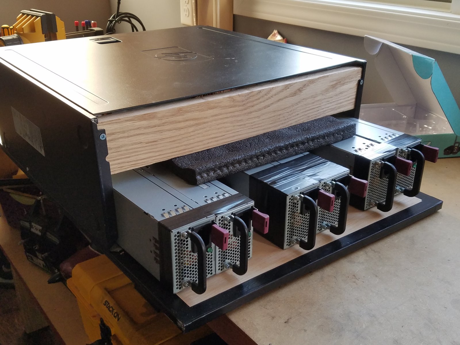

  10. BondeX
    BondeX Active Member
    Feb 11, 2016
    142
    EE
    Michigan, USA
    1,501Coins
    +76 / 0 / -0

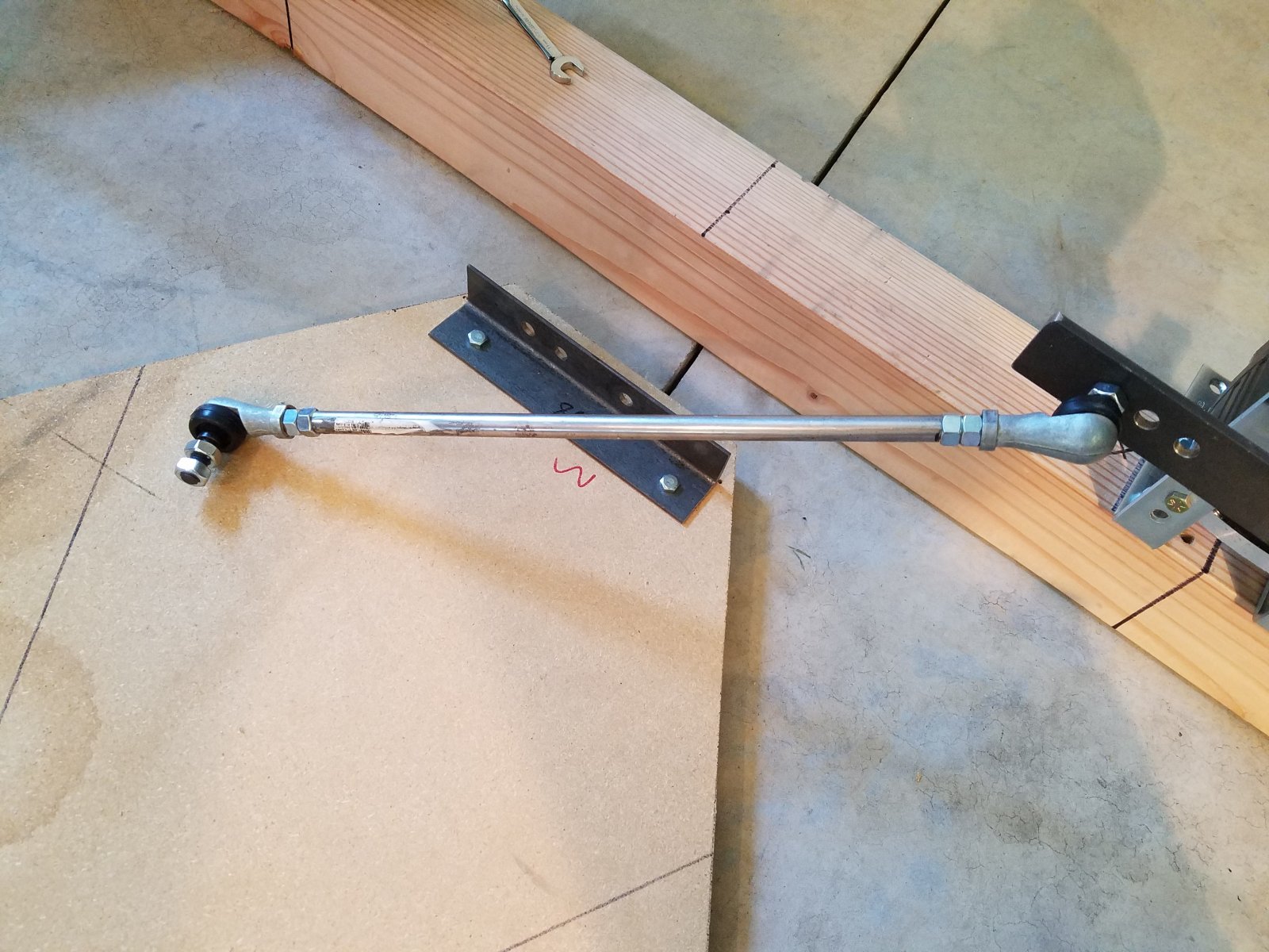

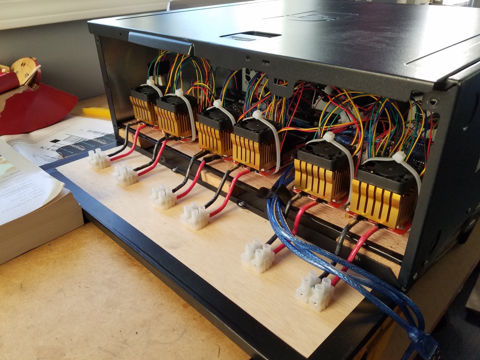

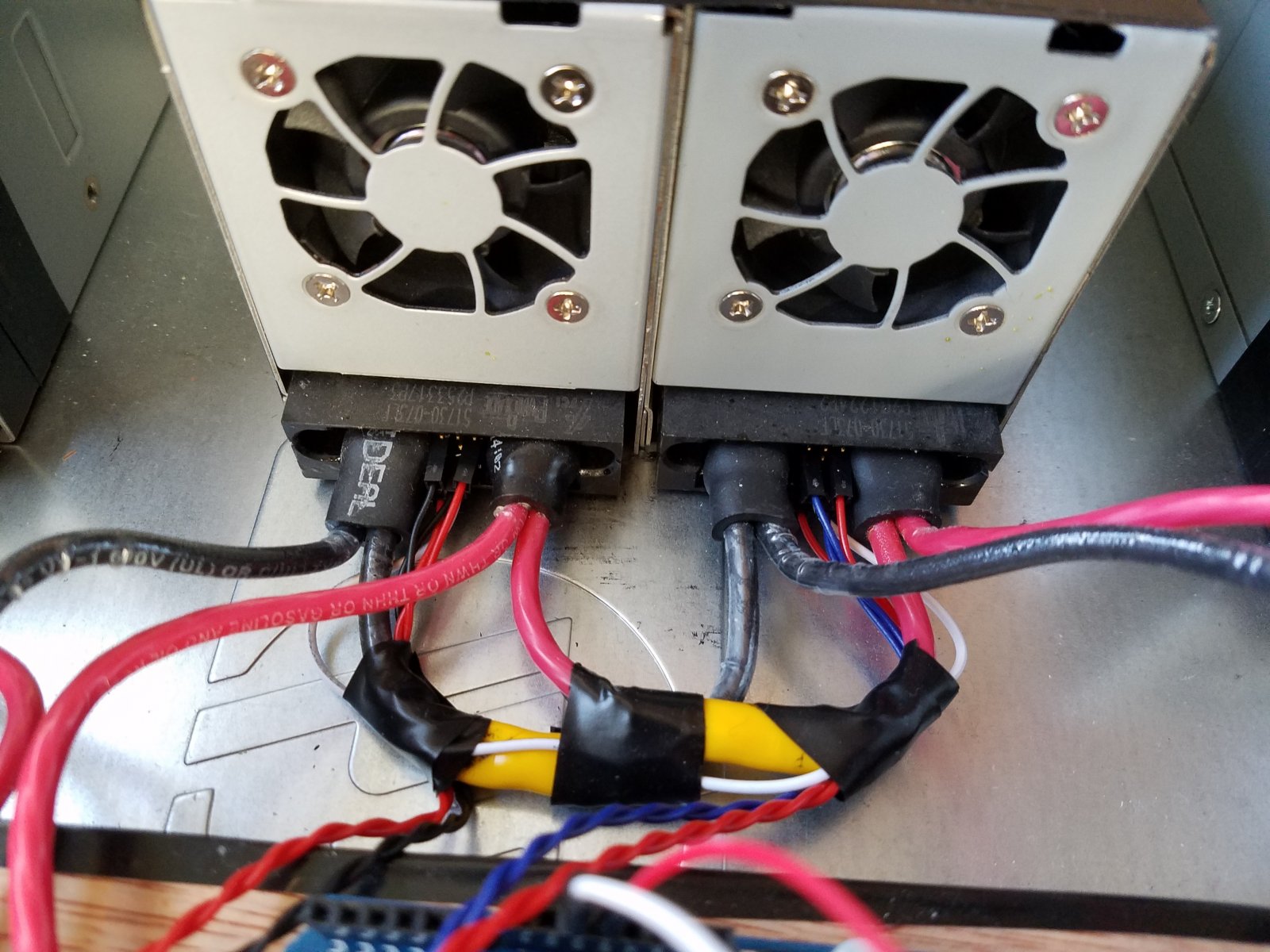

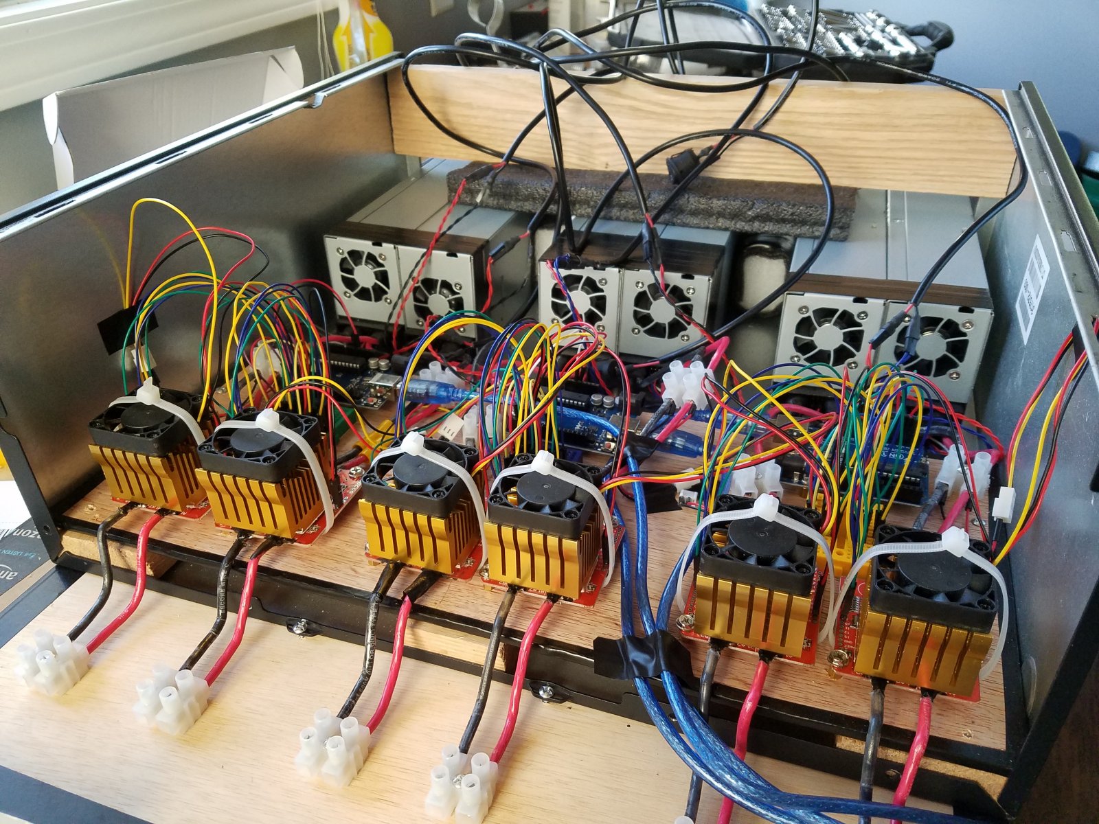

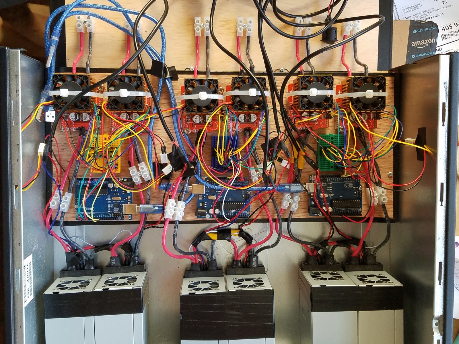

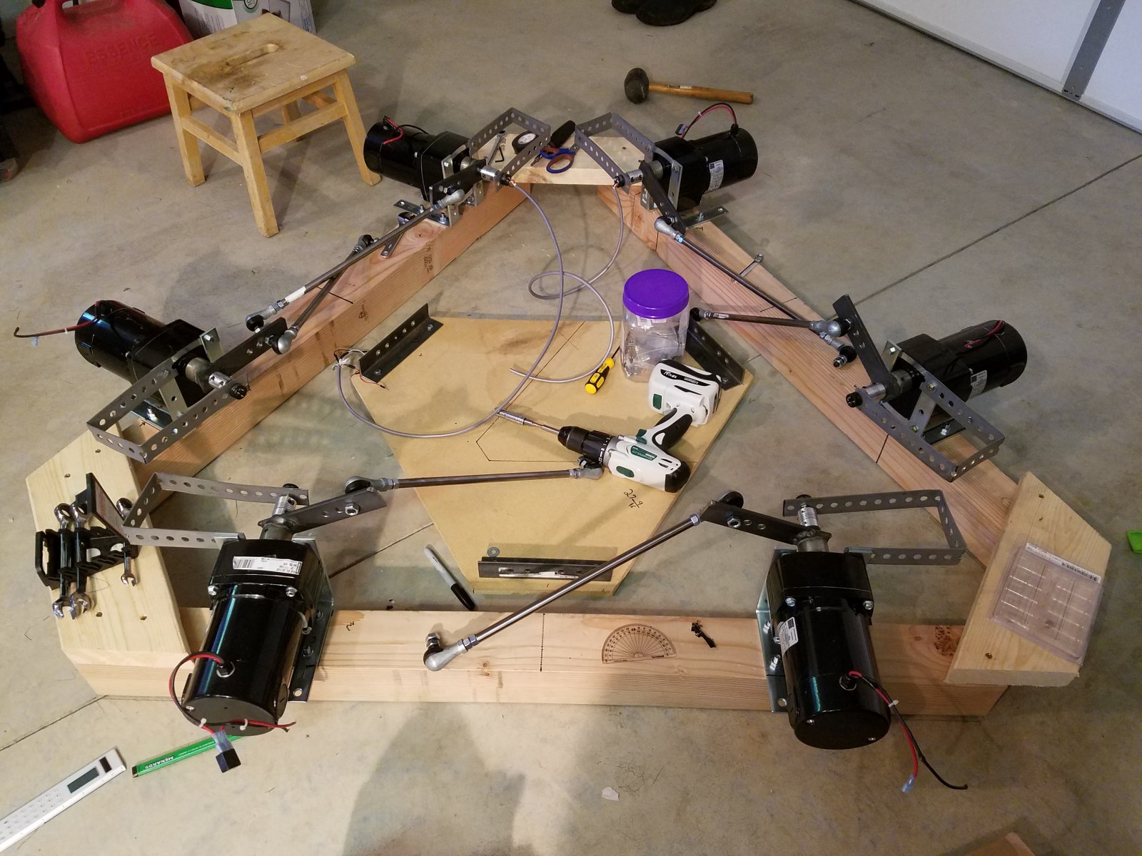

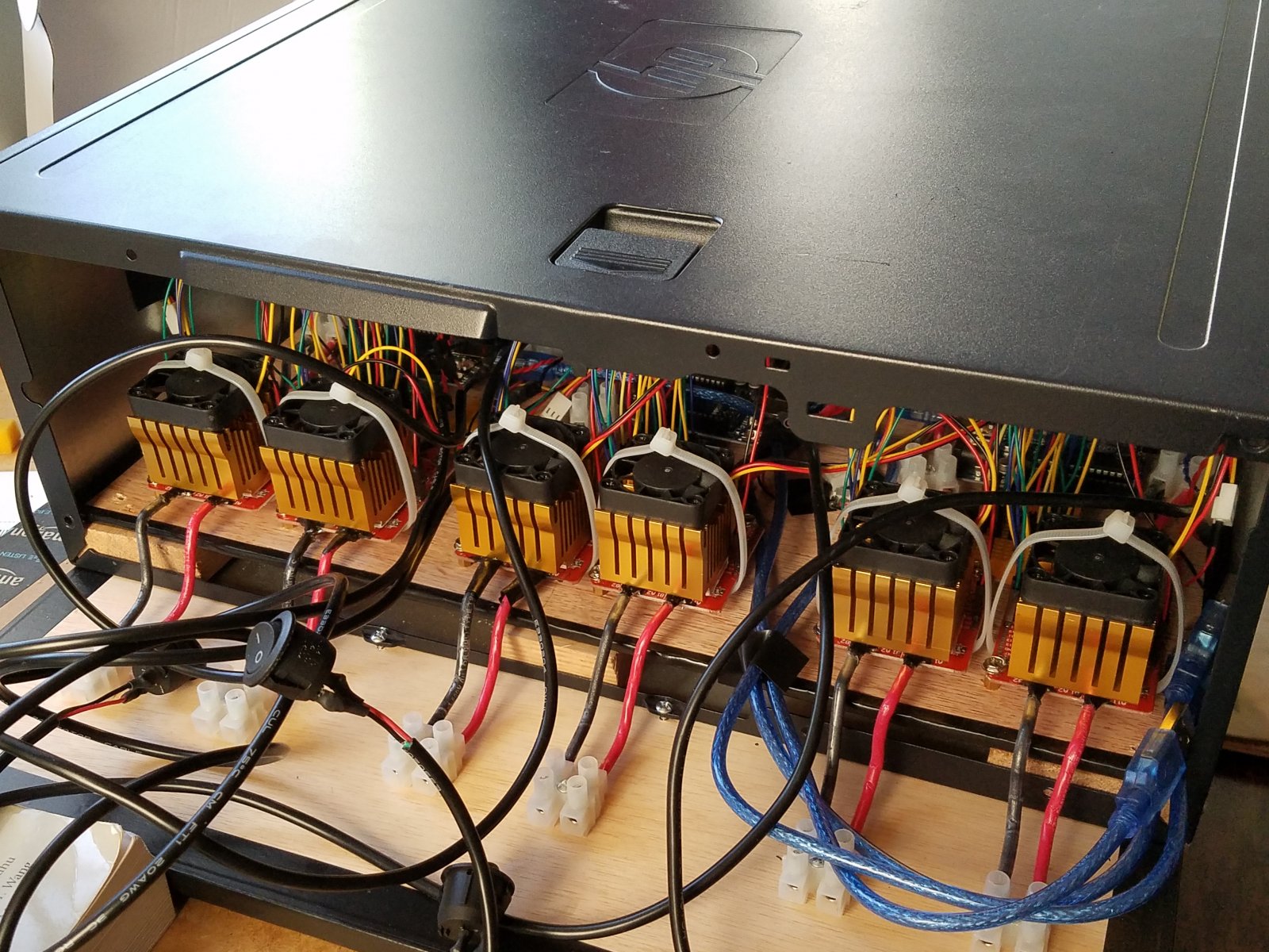

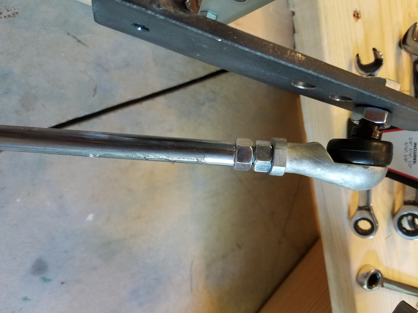

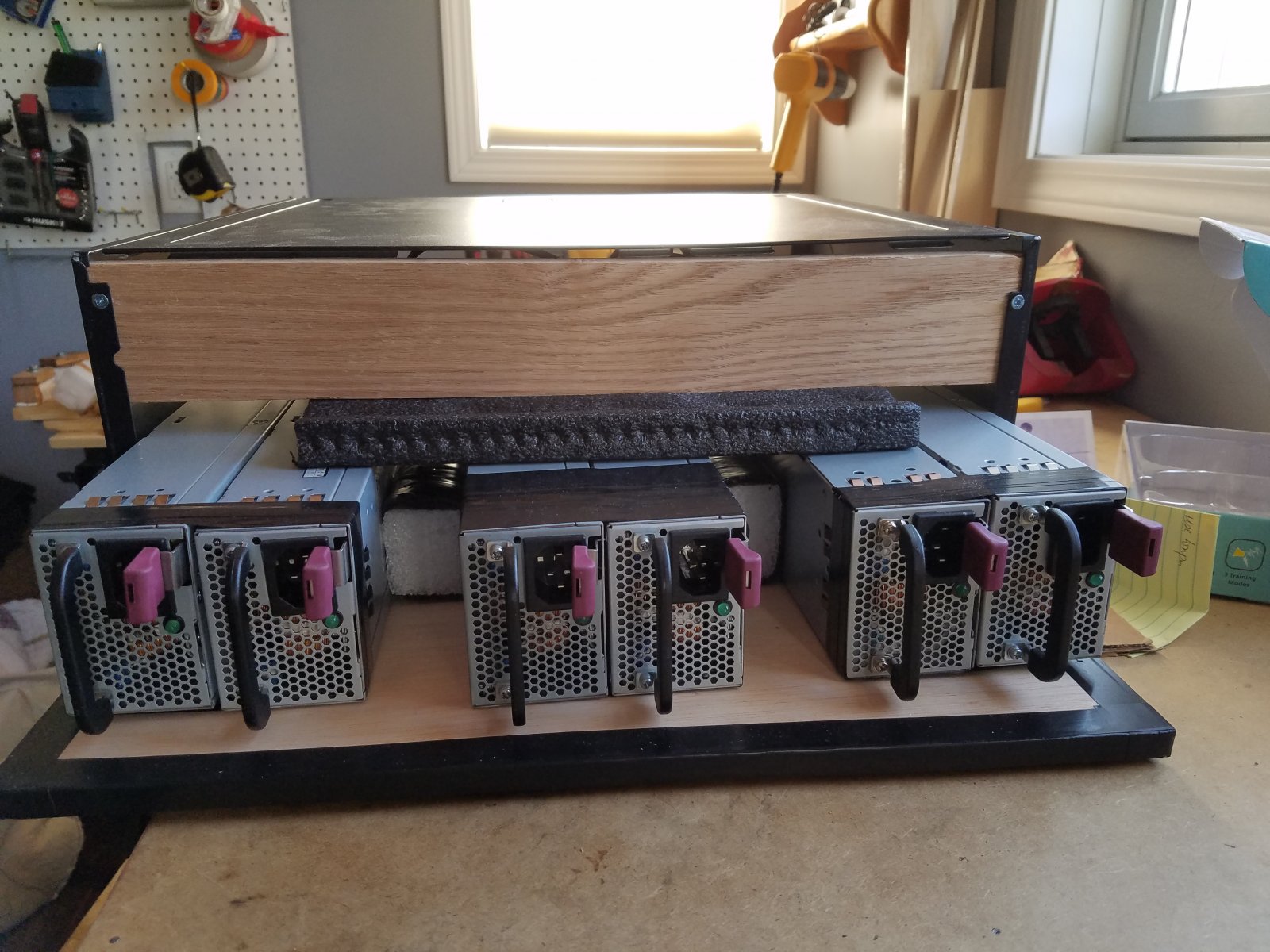

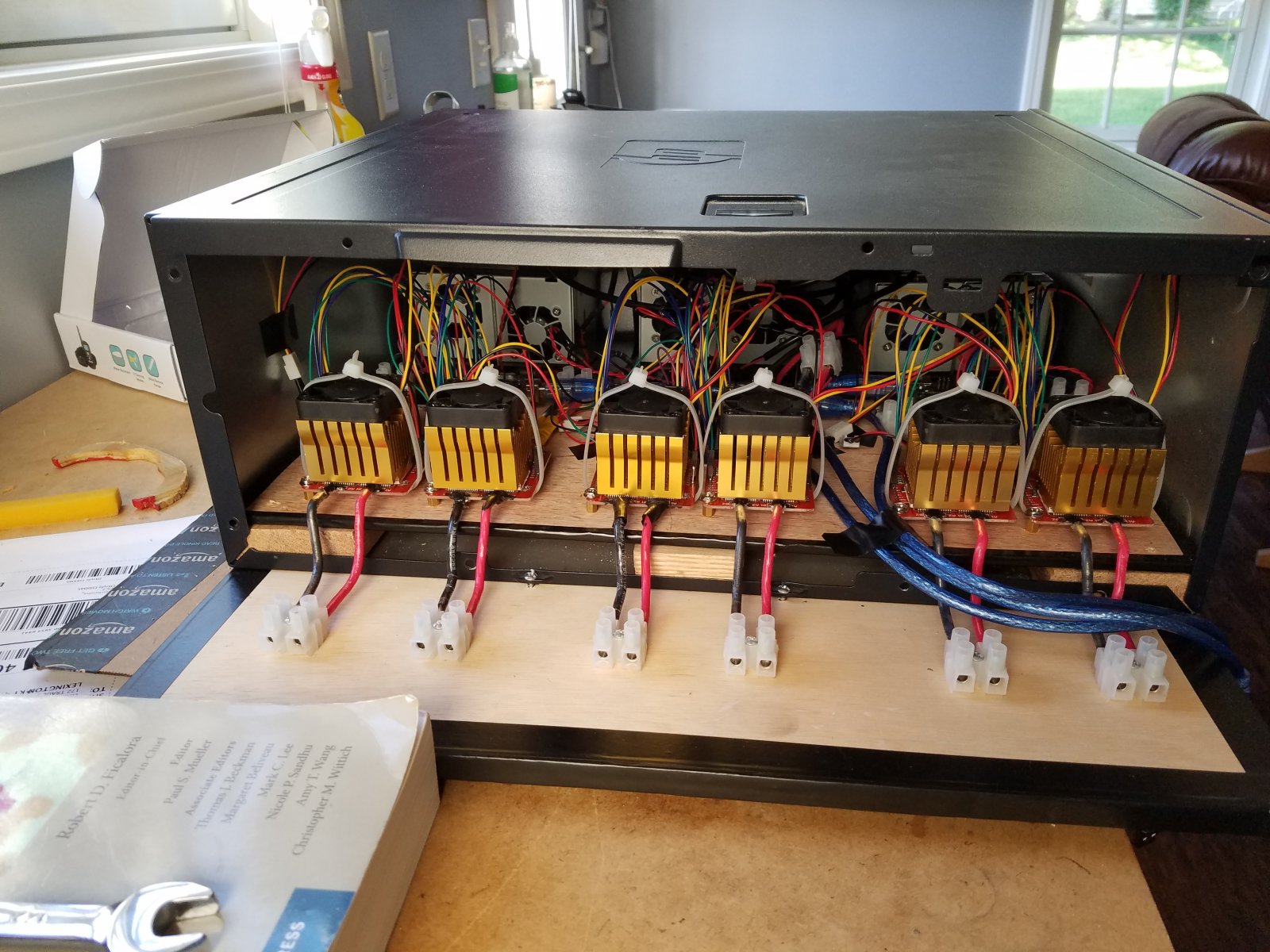

    Ok, so finally got all the electronics done and tested each MM & PS with SMC3. Mounting rods are done and feel very sturdy, just need to apply loctite on the nuts and ball joints. Platform is very sturdy and has no play whatsoever.
    Need to solder 4 Hall sensors and I should be ready to test motion.

    Your control box looks amazing. I hope I can get mine that neat when the time comes. Can't wait to see the progress!

    I am trying to figure out how to assign AXIS. I am looking at @vulbas's assignment and I am wondering how did he come up with these values and why are some different for lets say Roll, for Axis 1 & 2. Is his assignment a good starting point? Axis 1 = Motor 1, Axis 2 = Motor 2......?

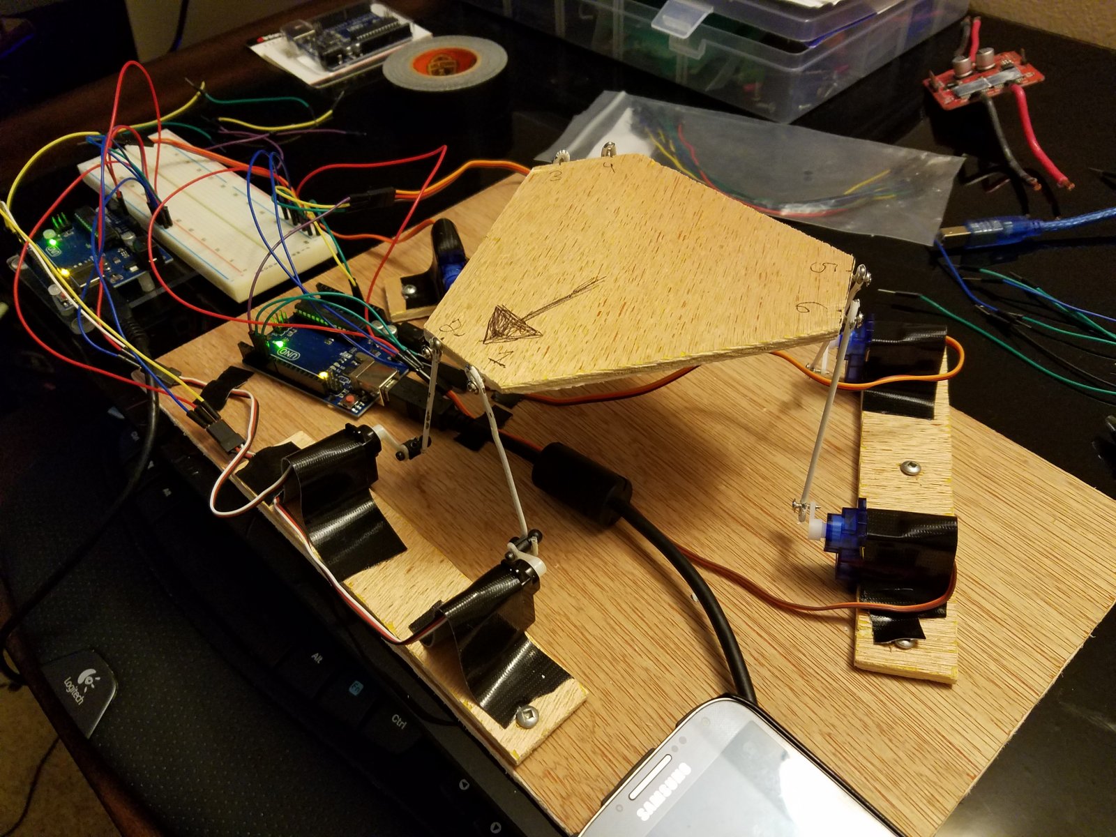

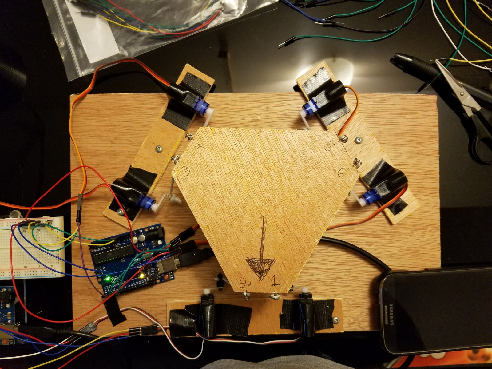

    Well since my sim is an hour away, I needed a way to understand how SimTools Axis assignment and Interface worked. I built a mini replica of my 6DOF and used two Arduinos/Interfaces.
    On the actual sim do I need to have Startup Output and Shutdown Output populated?

    just started playing around with simtools on my 6dof, my layout is the same as your replica. i used the above dof assignments from vulbas as a starting point and everything worked pretty much spot on straight away, which was a nice suprise!
    as seattime said some of the movements are not completely flat ( we need to wait for simtools 2 and math plugin for this??) but its pretty much there.

    Alright, so I finally tested motion and so far so good. Just debating whether I should mount my Obutto Ozone on top of the platform.
