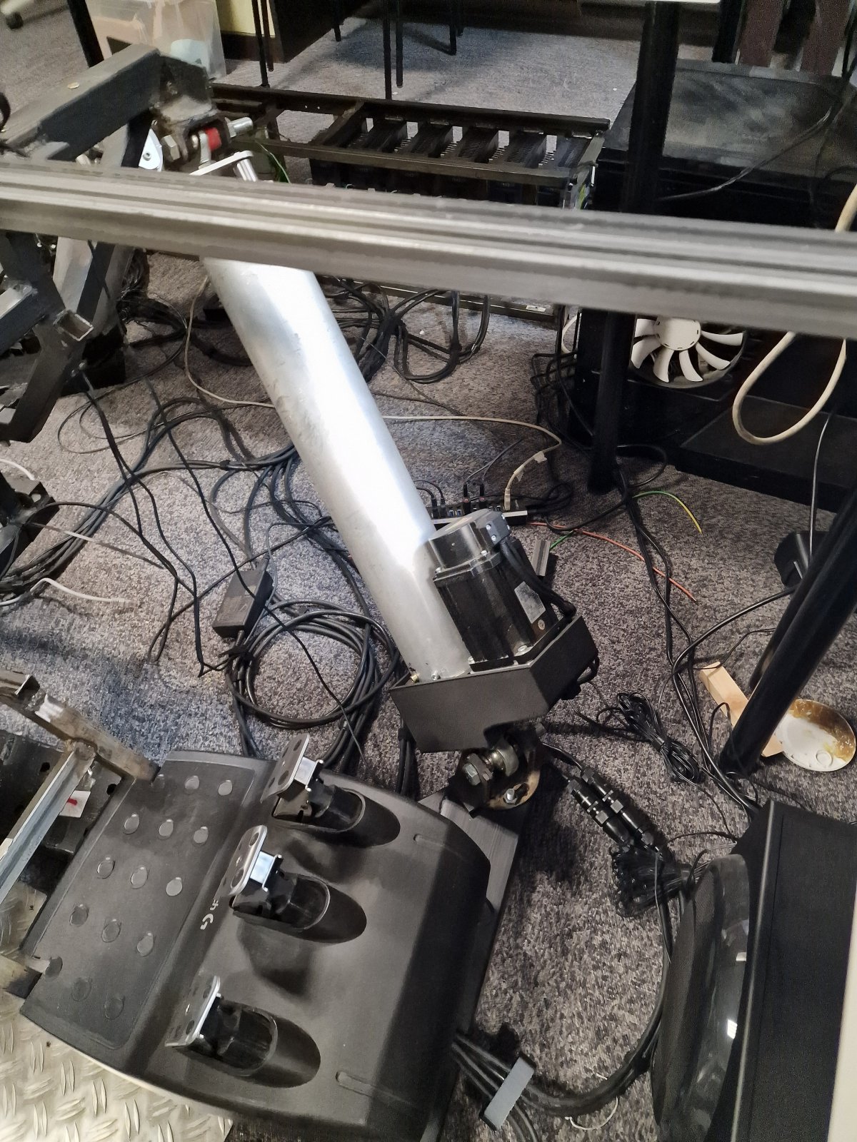

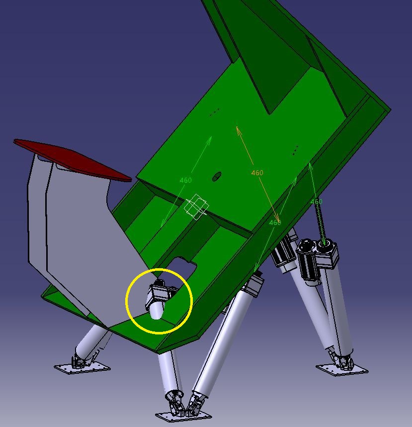

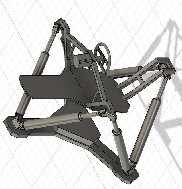

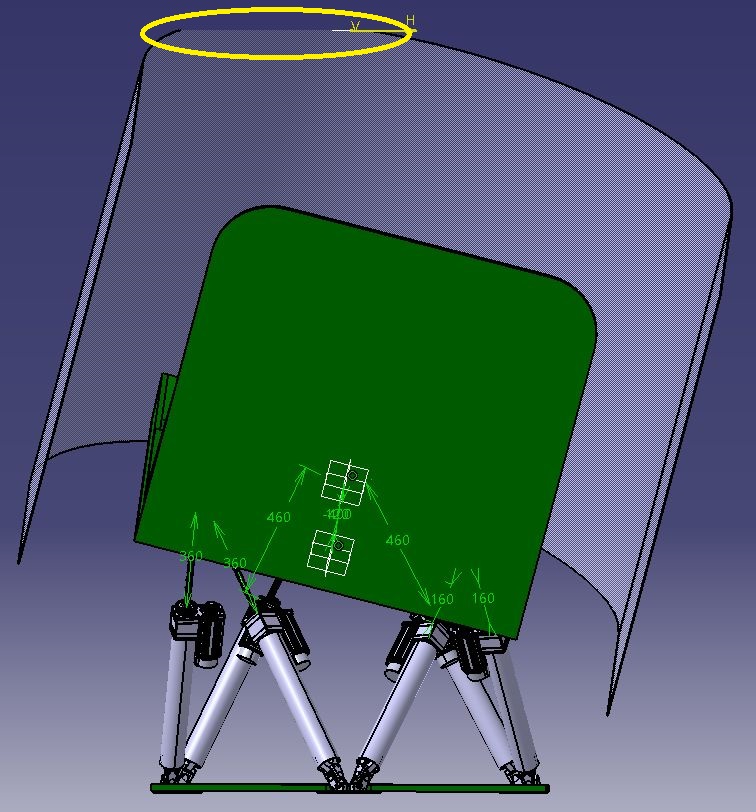

    While designing my rig I ran into the problem that there are poses possible that cause collisions. There are internal collisions where the actuators hit the rig structure.
    Or external collisions where parts of the rig hit the floor or the ceiling.
    I know, my rig is very special. It has two seats so it's larger than most others from the beginning. I also made the decision (against all advices) not to use VR but instad install a big curved screen. I have to admit that it would be much easier to avoid collisions if I made it like most others do: use VR and place the actuators in a circle around the rig instead of below the platform. But with two seats (1.4m width) that would require even more space and an actuator stroke of >1m to achieve reasonable roll and pitch ranges.
    And even with the "easy" way of placing the seat between the actuators it is still possible to have collisions.
    With pitch down and yaw at the same time the pedal board could hit one of the actuators. So I'm sure I'm not the only one with this problem.

    The collision in the first picture in post #1 can be avoided by limiting pitch to +/-30° which should be enough for most cases. If you want to do loopings you need a cardanic suspension with +/-360° range instead of a stewart platform, anyway.

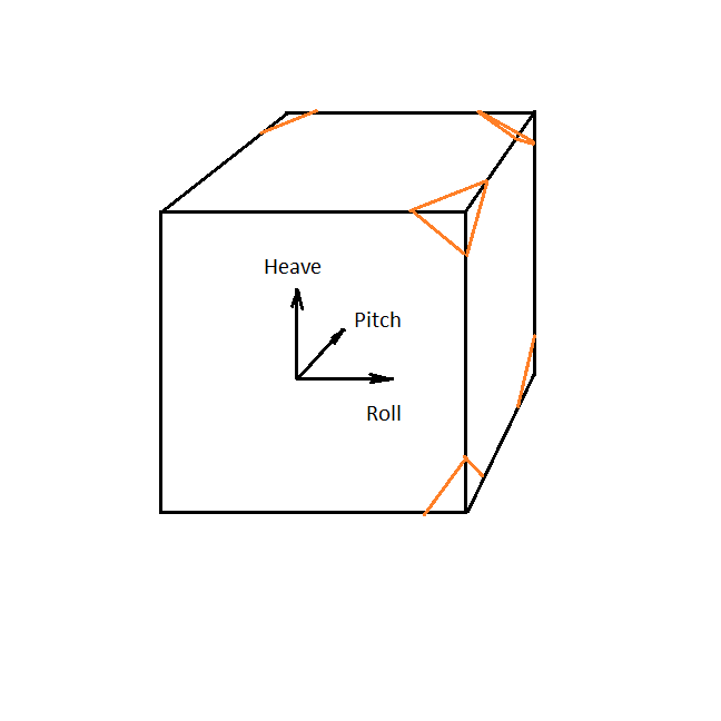

    Most collision cases happen where multiple extreme poses occur simultanously, for example extreme pitch and extreme roll. In extreme heave positions (all actualtors fully extended or fully retracted) the stewart kinematics is self-limiting, e.g. no other movements like pitch, roll, sway or surge are possible, anyway. But with heave centered poses can add up to problematic positions.
    So what we need is to "cut the corners" of the space of possible movements. Let's consider the 3-dimensional space of heave, roll and pitch.
    The vertical and horizontal walls of the cube are the individual limits while the cut corners mean that the limits are stricter when two or more variables are at the extreme values simultanously.
    For a stewart platform the space of possible movements has 6 dimensions which is difficult to display on a 2D screen. But mathematically it's still possible to calculate distances, shapes and angles in 6d-space.

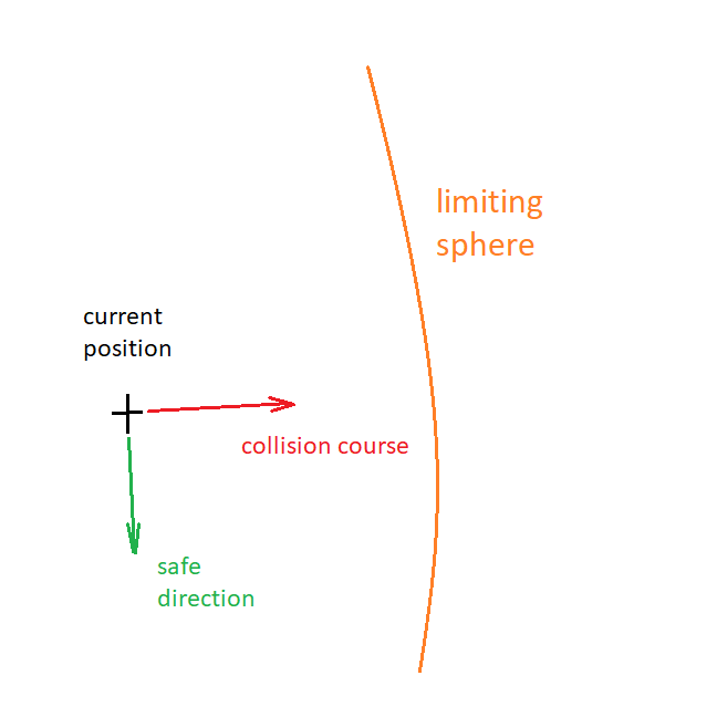

    The possibility to calculate distances is important to foresee possible collisions. If the current position becomes closer to one of the walls of the limiting polyhedron we can slow down the movement before actually hitting the wall. A 6-dimensional "ball" would possibly be easier to calculate than a polyhedron with many surfaces.
    If the distance to the limiting sphere is greater than the braking distance for the given speed we have to do nothing at all. If it is smaller we have to check the vector component in the direction towards the sphere. If a "collision course" is detected it has to be slowed down. A perpendicular movement (parallel to the sphere) is harmless.
    The problem is that by cutting off the corners of a 3D cube we don't remove much volume. So the limitations are not that severe. Extreme positions for all degrees of freedom at the same time do not occur very often. But in 6D space the corners possibly have more volume than the enclosed sphere.

    That's great!:thumbs The singularity/angle limit will surely solve my internal collision problem (see first picture in post#1). Do you already have an idea how to implement custom collisions? calculating a true 3D model of the collision sensitive parts of the rig would be the most universal aproach but computationally intensive and complex and error prone for the users to setup.

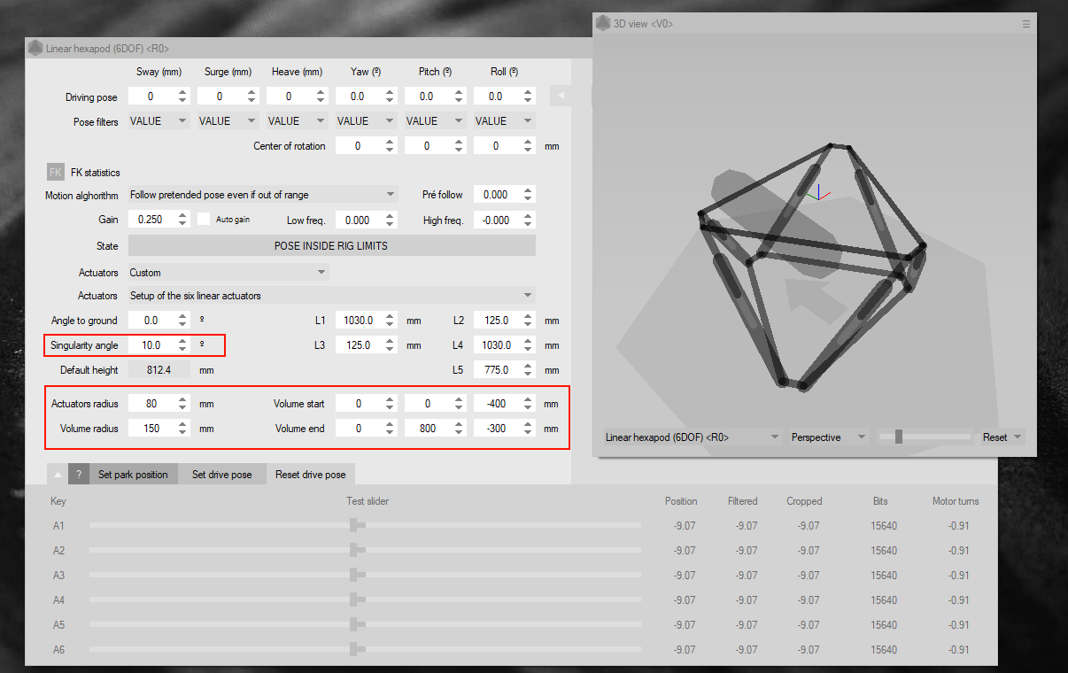

    So What Mover does for now is colision with pedals and singularity.
    Singularity is to avoid the actuators being on the same plane of the top platform. We set the minimum angle allowed and the rig doesn't move.
    With the motion alghorithms you can allow movement making it work like a kind of logistic, decreasing movement near the limits.
    For the pedals you define a 3d vector (start and finish) and it's radius (also the radius of the actuators).
    If the axis are to close, there's risk of colision and the rig acts like in singularity depending on motion alghorithm.
    The axis is visible in the 3d view and enabled if you set the radius (radius=0 is disabled)
    Here in colision
    The axis/volume as a start and finish defined by 3D points and you can set any axis...
    What you can also do for now is use the pose filters to limit movement with crop, allowing different values for each of the dof's and minimum/maximum.
    What I plan to add is triangle and plane colisions. Planes/triangles will be assigned to fixed or moving parts.
    You set 3 points in space, assign it to base/top (fixed/moving) a say if that is a triangle or a plane.
    Any intersection is a colision. This is an idea for now and should have some problems, but would allow many solutions.
    Another idea is basic volumes like the cylinder, sphere, pyramid, cone, cube colisions where we define them like above. In reality they could be multiple triangles.
