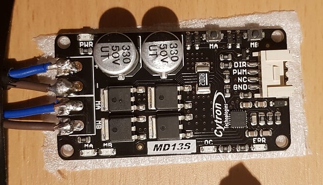

    I did some research on which components to use. A lot of threads suggest the usage of sabertooths as motor drives and the motors from motion dynamics.
    Due to the prices and difficulties of shipment, I decided for some not so usual components.
    This is what I've got so far:
    1x MD13s motor driver: https://www.cytron.io/p-13amp-6v-30v-dc-motor-driver

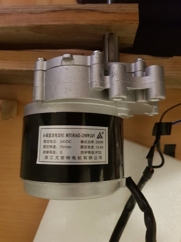

    1x 24V 250W 75rpm Wheelchair motor: http://aliexpress.com/item/32719954216.html

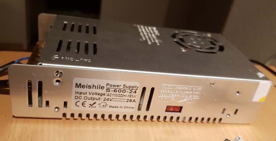

    1x LED 24V 600W Power Supply from amazon:
    My idea now is to set up a test bench and test this whole setup. If everything works then I can go foward and buy an extra five of these for the 6dof.

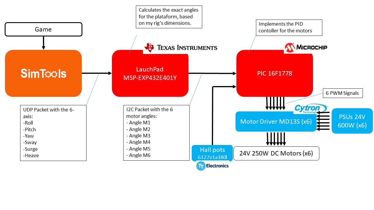

    I wanted to give some more information on what I plan to make.
    As an electronic engineer, I enjoy building electronic circuits and programming microcontrollers, so a lot of my decision where made based on that. I want to build my rig with rotary actuators, but I was not completely satisfied with how Simtools converts the axis to the motor angles with its profiles.
    First thing I decided was to use a microcontroller to use Steward Table maths to calculate the exact motor angles that I needed. This way, Simtools will only export independant axis information and no advanced profile is needed. For this I choose the MSP-EXP432E401Y from Texas Instruments, as it has a lot of processing power and a dedicated floating-point unit to calculate all the matrices, sines and cosines needed for the math.
    After that I decided to use another microcontroller to get the angle data, measure the positions with the hall -ffect potentiometers and implemente the PID controllers. (It would be possible to use only TI's microcontroller, as it should be powerfull enough. But this way I though it would be more fun).
    To be easier to understand, I made some schematic on how things should be connected:
    The coding of the two microcontrollers is practically finished. I assembled a test bench with the one motor and one hall effect pot to test the whole thing.
    I'll be posting some more details and pictures on the next days.

    Hi. I will be attentive to the progress of your project. I am waiting for the components for a 2DOF. I tell you to buy 2 engines equal to those of your project. I will receive them in the next days. I'm going to use arduino uno and BTS7960. I have seen in a Youtube video that the DOFREALITY platforms use the MD13S controller with ARDUINO UNO without having to install heatsinks. If I get to have problems with the BTS7960 they would be an option for me too. I do not know if for these controllers I can use the same arduino programming as for the BTS7960.

    Hi Arielnac. Nice to know that you are interested. I already did some tests with small loads with the MD13S and my motors. They seem to work well. I could not yet test with full load because the wooden levers I've built were not strong enough. I am replacing them with metal ones, but my building skills are somewhat limited.

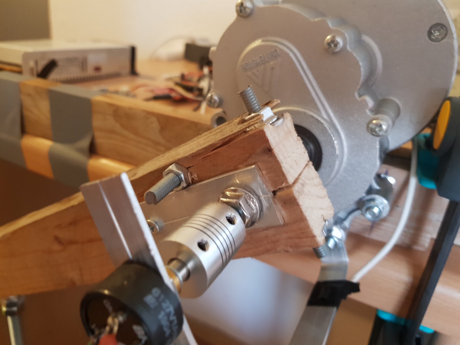

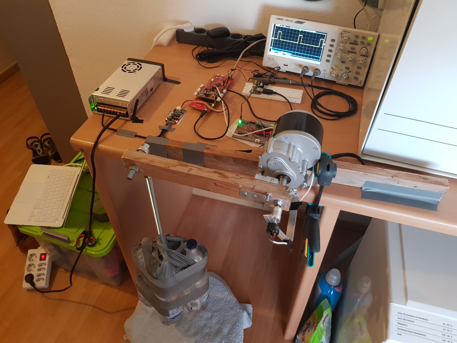

    As promissed, here is the test bench I used to evaluate the setup:
    The idea is to test the following components:
    - 250W DC motor
    - 600W Power Supply
    - MD13s motor driver
    - Hall effect potentiometer
    - TI controller (with my own code)
    -Self made 'booster pack' for the TI controller (with my own coode)
    On my final design I intend to use a 10 cm shaft to connect the motor to the 'legs' of the 6dof plataform. For this test I used a 30cm shaft to multiply the effect of the used weight by 3.
    I am using 6kg of test weight here to test one motor, which multiplied by three equal 18kg per motor. For a plataform with 6 motors, that would be a total of 108kg.
    The video below is a recording of a 'step test' that I created. The motor is on a fixed position and a sudden step of 15 degress is comand by the controller and back.
    In the video, the motor stays on a fixed position until around second 17. After that it steps to a higher position and 2 seconds later comes back to the original position.
    Everything works fine, however the wooden shaft I built breaks at the end. If you listen carefully, around sec 20 a laud crack sound can be here... Here is a foto of the result:
    Now I will probably need some help fabricating a new shaft. I currently don't have the tools to make it from iron and I do not know if this is something possible to buy. Anyone with a suggestion?

    Hi. You should make a lever like this in metal.

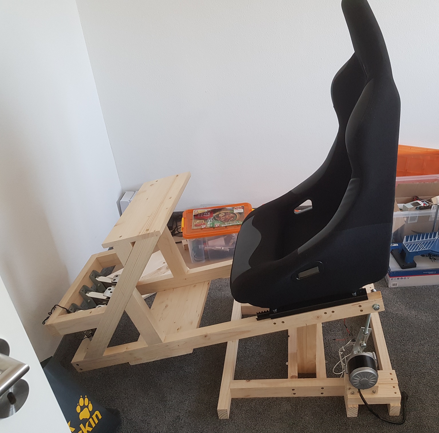

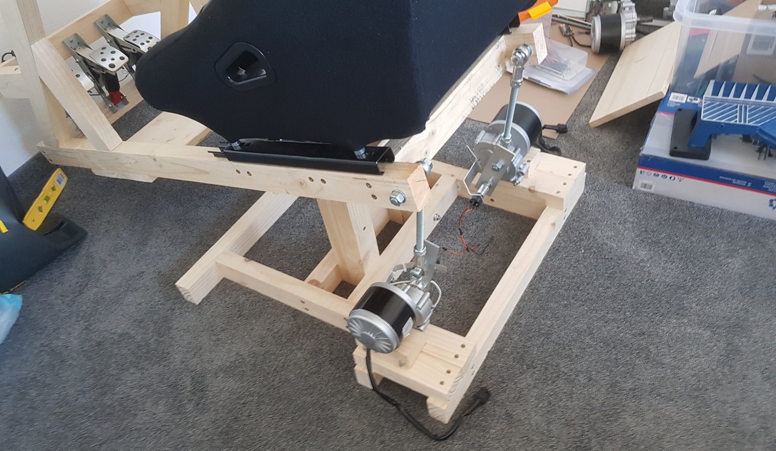

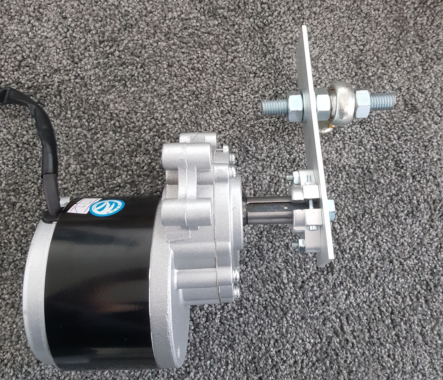

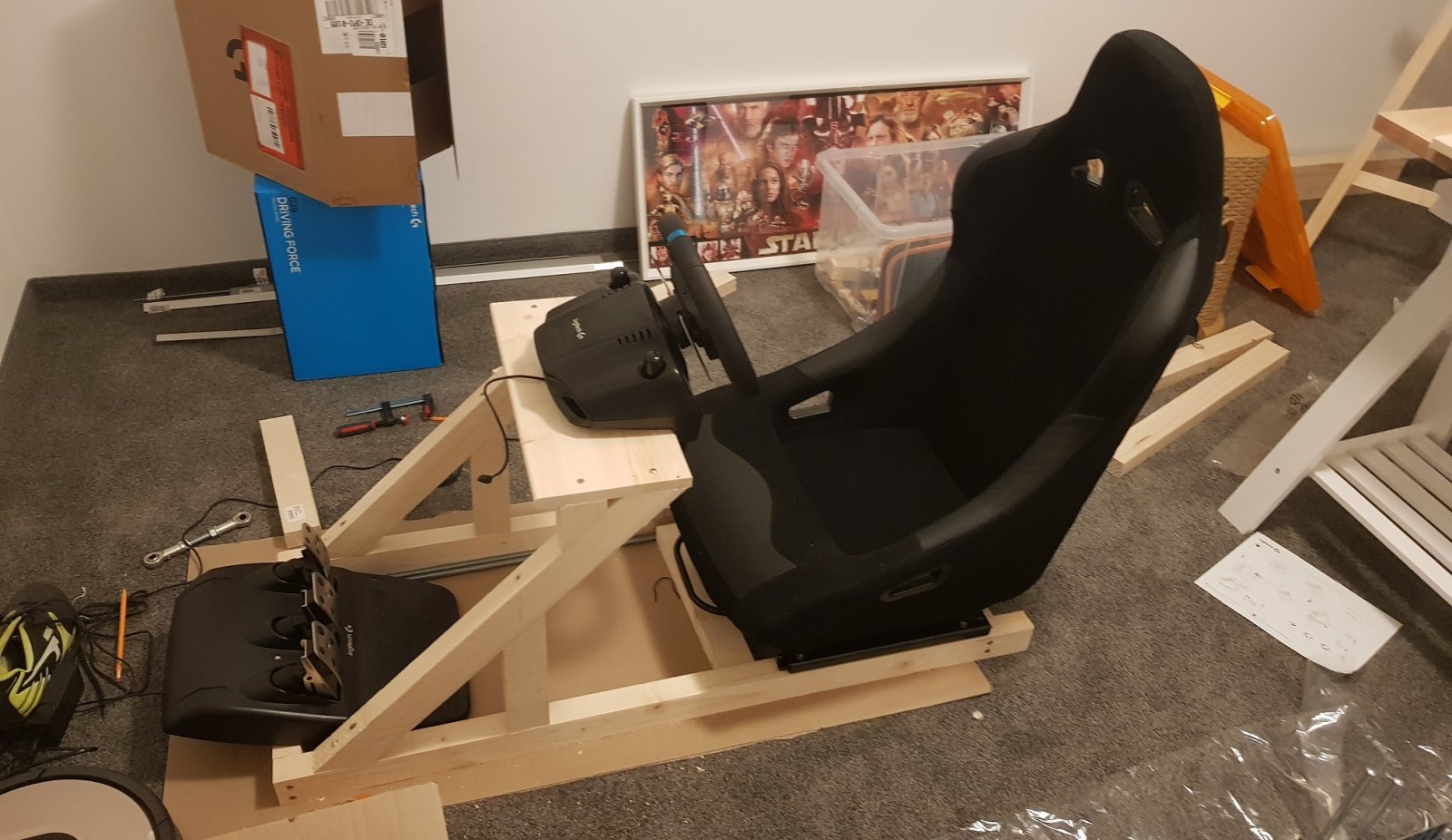

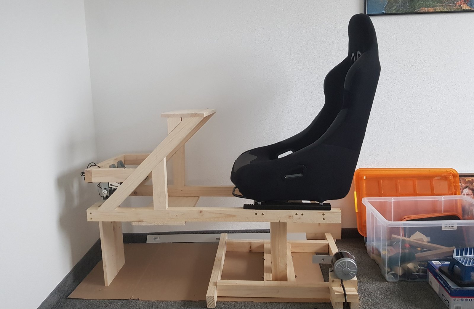

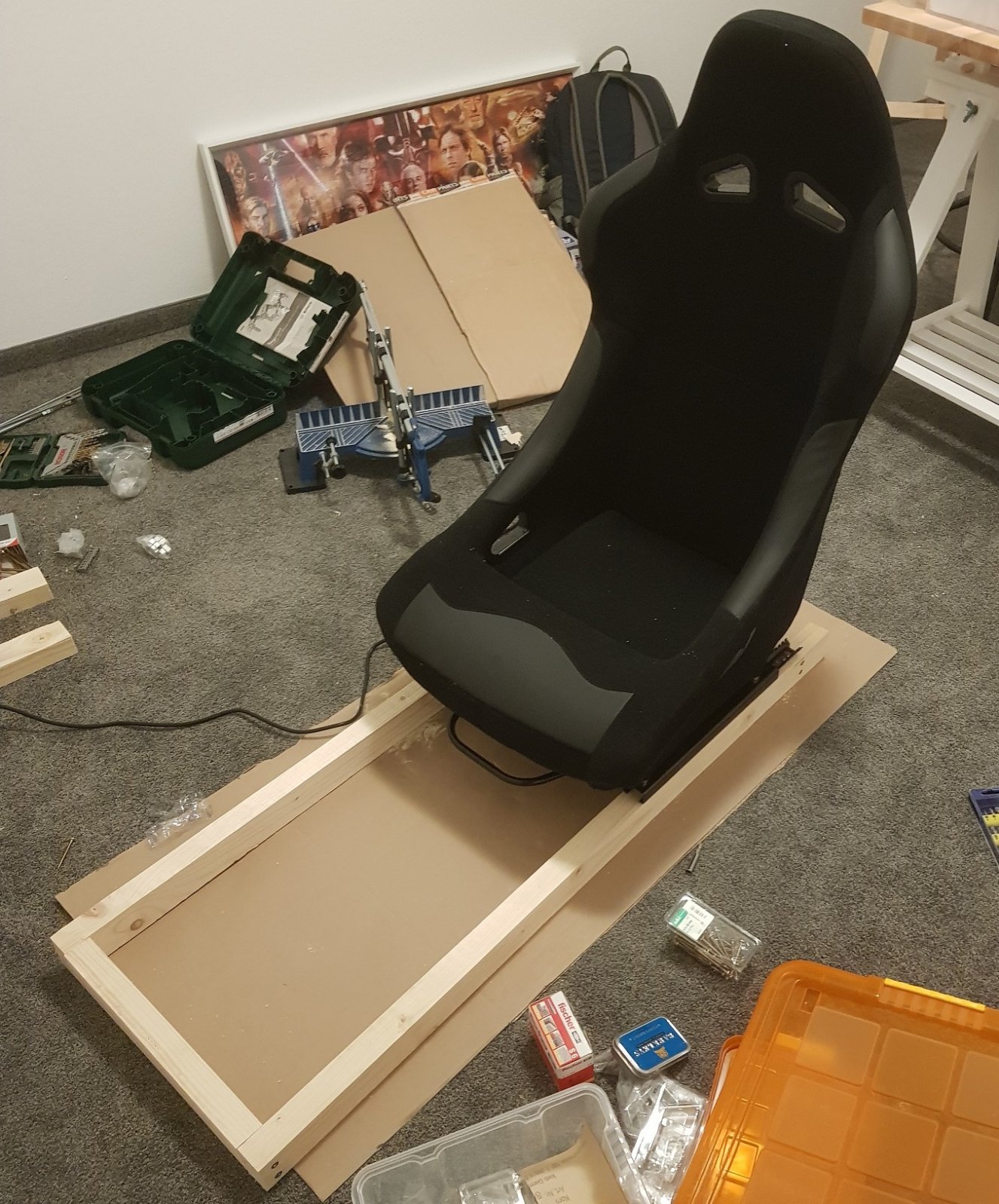

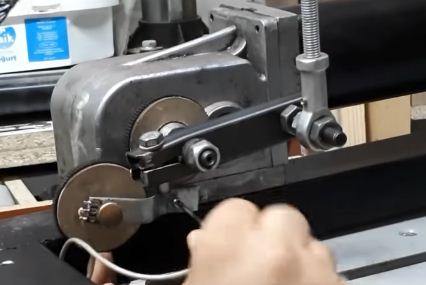

    It has been some time since my last post. I worked quite a lot on my rig, however I downgraded it to a 2DOF. Due to the complexity and size (and my lack of building skills) I decided to simplify the build.
    Here are some pics of the progress:

    Today I want to post the first video of the plataform in action. There are still some adjustments to be done, but I am very happy with the results already. This is me testing it with LFS:
  14. Arielnac
    Arielnac Member
    Nov 20, 2017
    79
    Argentina
    65Coins
    +34 / 0 / -0
    Hi. It would be convenient to improve the fixation of the motors. When you manage to calibrate Simtools well you will achieve movements that will subject the engines to more leverage.

    Hi. I am also using these motors in a 2DOF. They have a lot of power. I weigh 79Kg and I have tried reloading myself on the front of the platform to overload the motors and they have no problem to move.
    But remember that these motors are for 24V and I am using them at 18.5 so that I don't have problems with the BTS7960. With 12v these motors will not work for you.
