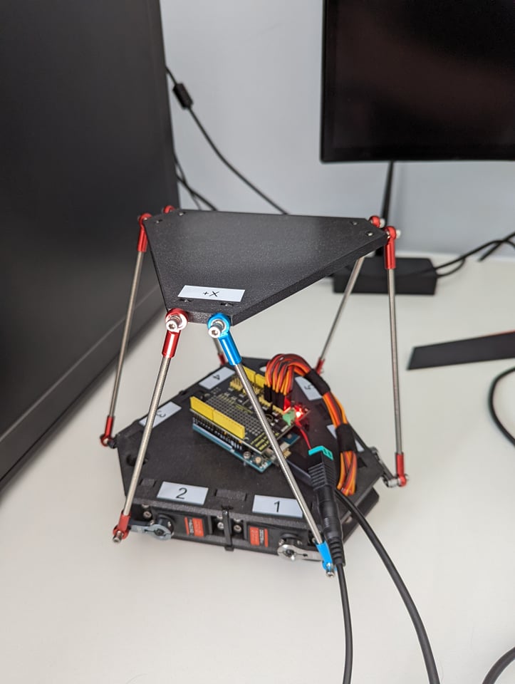

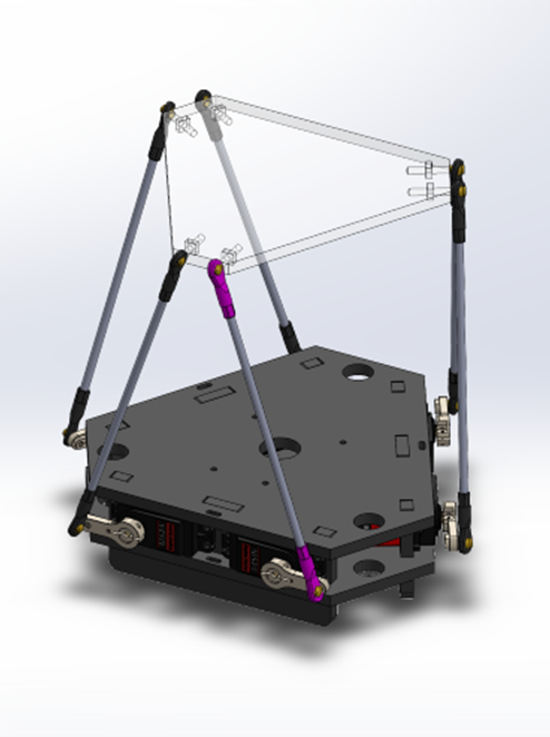

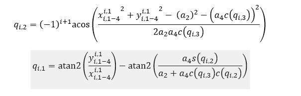

    Hey I'm a little new here I have been lurking and reading others posts but its about time I share my own project. I have been building a scale model of a platform and trying to integrate it with SimTools.
    The platform is a relatively simple design with six RC servos used to drive the legs. I have a strong background in math and robotics so I "threw together" the complete inverse kinematics model if the system. I can go into detail late but for now here is what it looks like.
    274094964_1370085123506043_3028074299716603210_n.jpg upload_2022-2-21_13-43-15.png

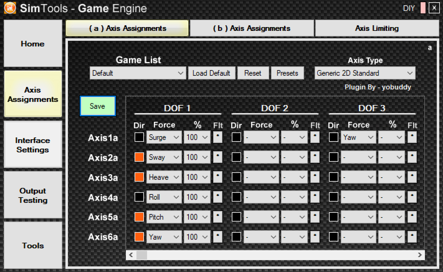

    I’m having some troubles with incorporating Simtools with my 6 DoF platform. I do know it works as I have done some basic trajectory mapping and the platform behaves as expected.
    Now I think that I have 2 ways to proceed. 1) I can bring my IK solution into the axis assignment so Simtools outputs the joint configuration directly. Or… 2) I put the IK solution into the Arduino and just have Simtools output a desired platform configuration. (X,Y,Z, Roll, Pitch, Yaw).
    I was struggling with coding the axis assignment, so I decided to do the latter and move the computation of joint angles to the Arduino. I wouldn’t mind some guidance on this if anyone has input on how to get Simtools to output after IK is applied. For method 2 it seemed fairly straight forward to set up the axis assignment using the default 2D with each of the output axes corresponding to one of the DoF defined in by the software.
    With this method I just need to parse the Serial data put out by simtools. Now I was struggling here too, I am using a start of line char “ “ (space) to indicate where in the incoming stream of bits the Arduino should start reading. This led me to the following interface settings:
    But I am getting juttery behavior when I use the test output. Now I wanted to verify that I am parsing the bits the way I should be so I built a little Serial Sniffer that takes the serial data and displays to an LCD. Which seems to get the right bit and a steady signal, but still its seems to move randomly. I’m not sure what is going on so I thought I would post and see what advice I can get from the forum.

    I did figure some stuff out. There was a problem in that version of the code with how the with how the platform config is parsed from the char output of Simtools. with straight double conversion the values go 1 -> 128 then -128 -> -1 for the second half of the ASCII table, so I added a little loop to take care of that. Also because the Arduino is doing the heavy lifting in terms of calculating the IK solution a send frequency below 15ms is just too fast for the platform to handle.

    can you tell us more about the 'inverse kinematics' ?
  6. Derek Smith
    Derek Smith New Member
    Nov 26, 2021
    98Coins

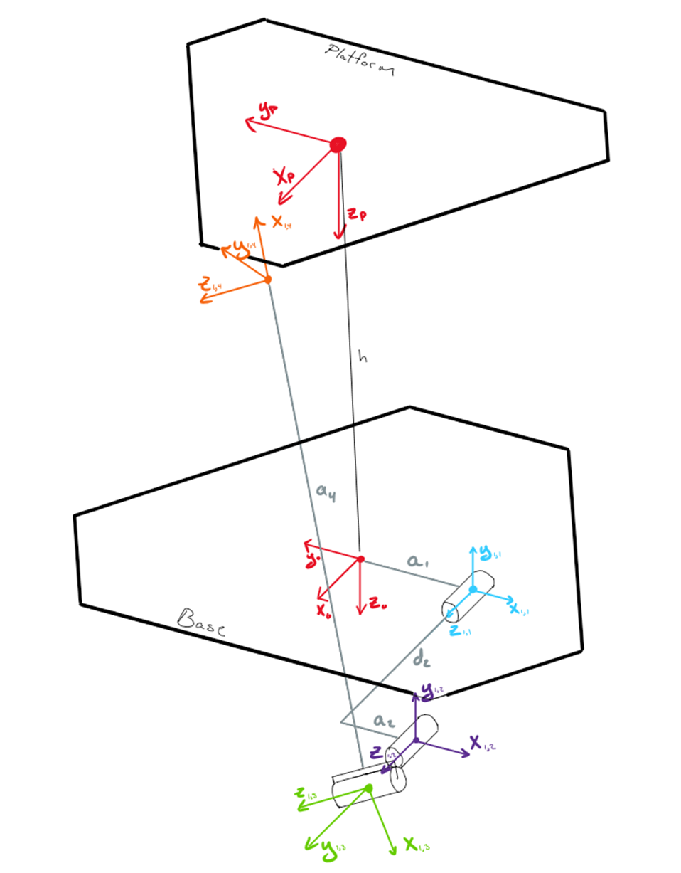

    Sure it is a bit complicated so I will give the cliff notes:

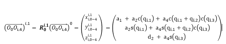

    I started by defining a series of linked coordinate frames using something called the Devanit-Hartenberg (DH) Method for each leg:
    Using this method you get a series of transformation matrices that relate each of the successive frames. I found that representing the O0->Oi,4 frame to be convenient as it show that because I used to rotation axes that are in line any movement in the normal direction is completely taken up by the 3rd joint angle. upload_2022-3-13_14-7-38.png
    No the other two joint angles q1 and q2 are coupled in a non linear equation so I used a projection of the leg to solve for the other two angles. I used the plane that is orthogonal to the rotation axis of the first two joints (Normal to x_i,1 and y_i,1)
    Then used the cosine law to solve for the other two angles keeping in mind that every other leg either has an "elbow up or elbow down" solution:

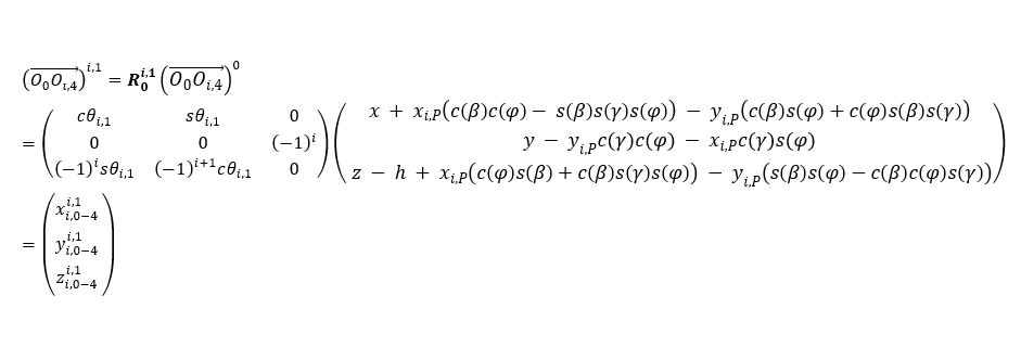

    next problem is to get the coords of the O0->Oi,4 in the local i,1 frame. I used a bunch of linear algebra operations and simplifications but it reduces to:
    finally separate for just qi,1.
    Its a bit of a bear to do by hand so I just put everything into matlab and coppied the output into the arduino program.

    So when using Simtools in it base form only gets you a linear approximation of the motion of the platform. So even if you tune it very well, when you get to distances that are farther away from the origin (center of motion) the movement of the platform will likely break down. On the other hand when you uses an inverse kinematics solution you solve for what the joint angles should be given a platform position. This means that the position of the platform will be accurate even at the limits of auction angles. At this scale I get about 70mm of movement in the horizontal and 35mm in the vertical which is pretty good .
    When studying robotics you'll find Inverse Kinematics is one of the first topics covered. The challenges here is that its in 3D so the math gets a bit hairy and the solution doesn't just pop out when you describe the joint variables.

    Your interface output dont have identifier. They are just a straight numbers. Maybe the arduino program get confused which number belong to what axis.
    Your setting is <Axis1a><Axis2a>.........<Axis6a>.
    What i write in my program is [R<Axis1a>][P<Axis2a>][H<Axis3a>][V<Axis4a>]
    R for roll, P for pitch and so on.
    Edit: I use codes from SMC3 as example
    Edit: Just noticed you use space to mark start of message so my reply above is not relevant.
