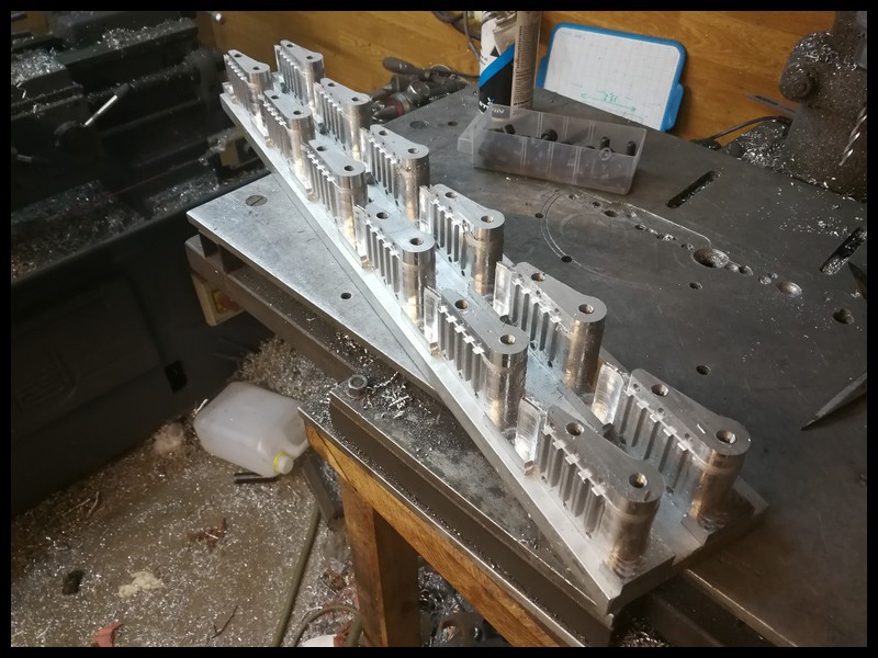

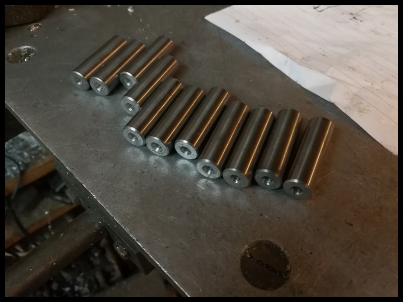

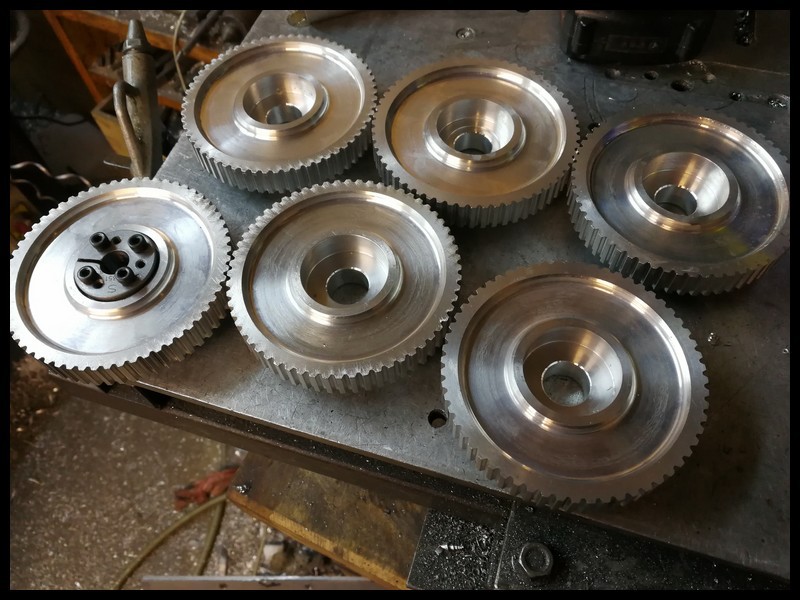

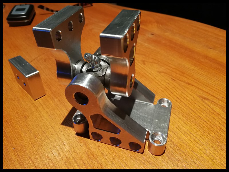

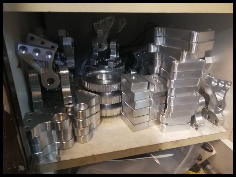

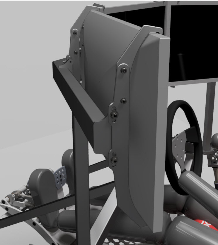

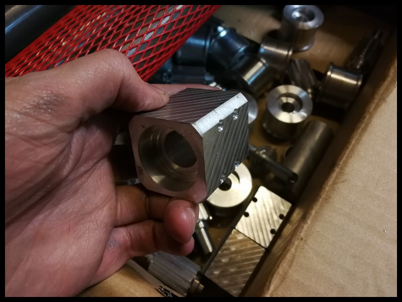

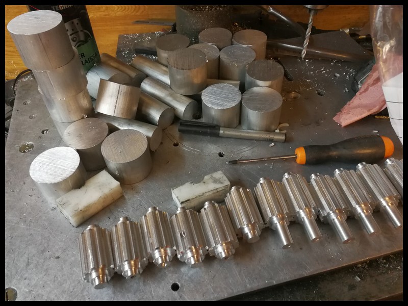

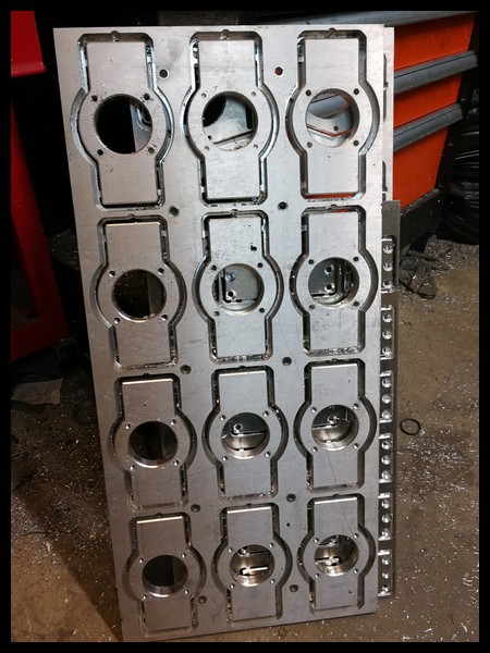

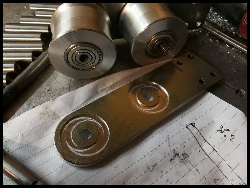

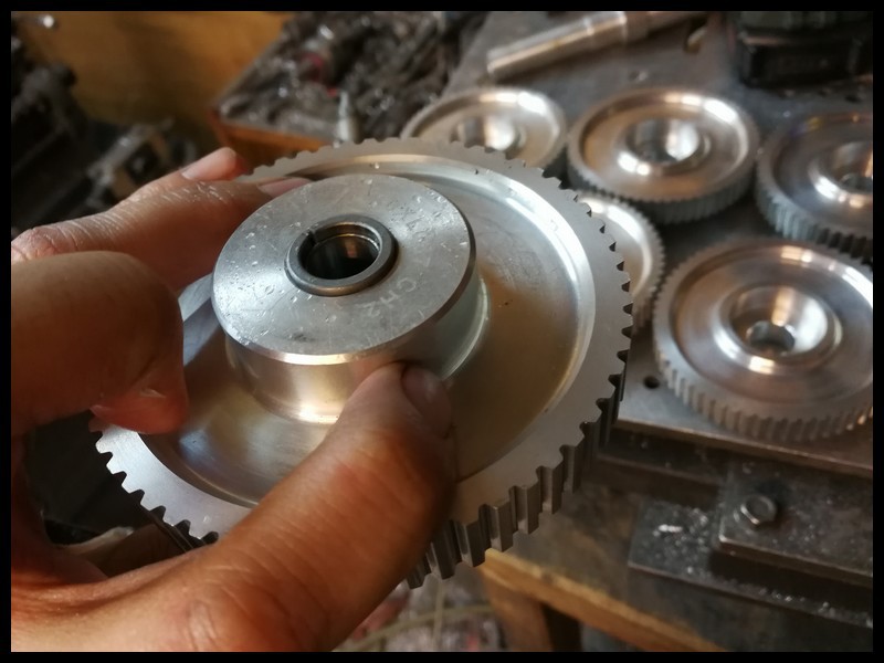

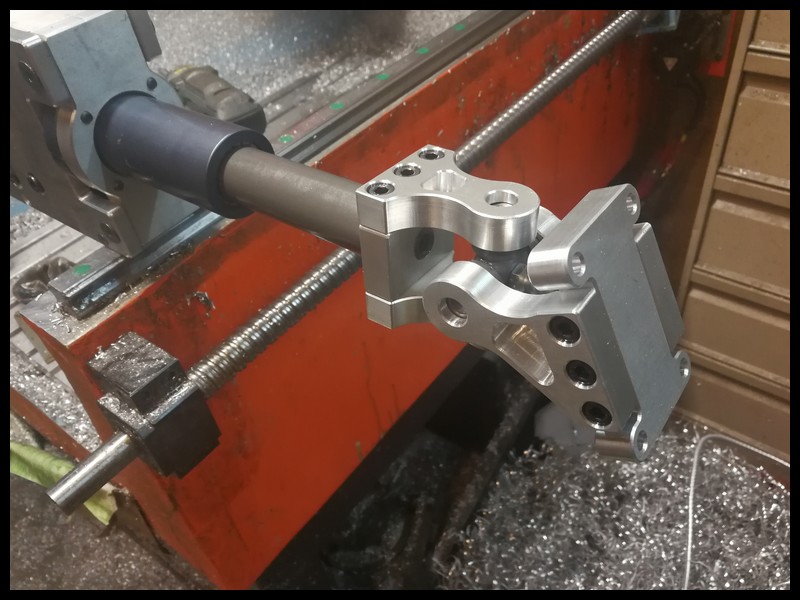

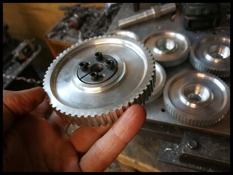

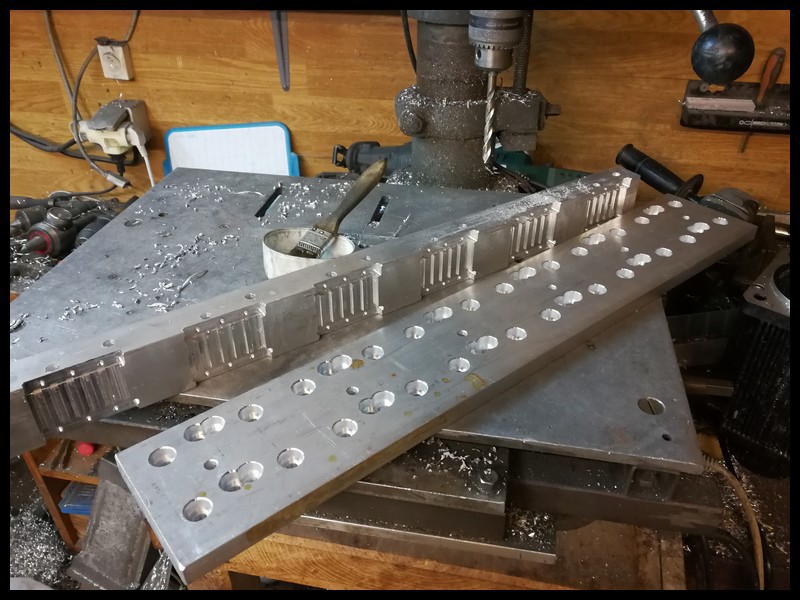

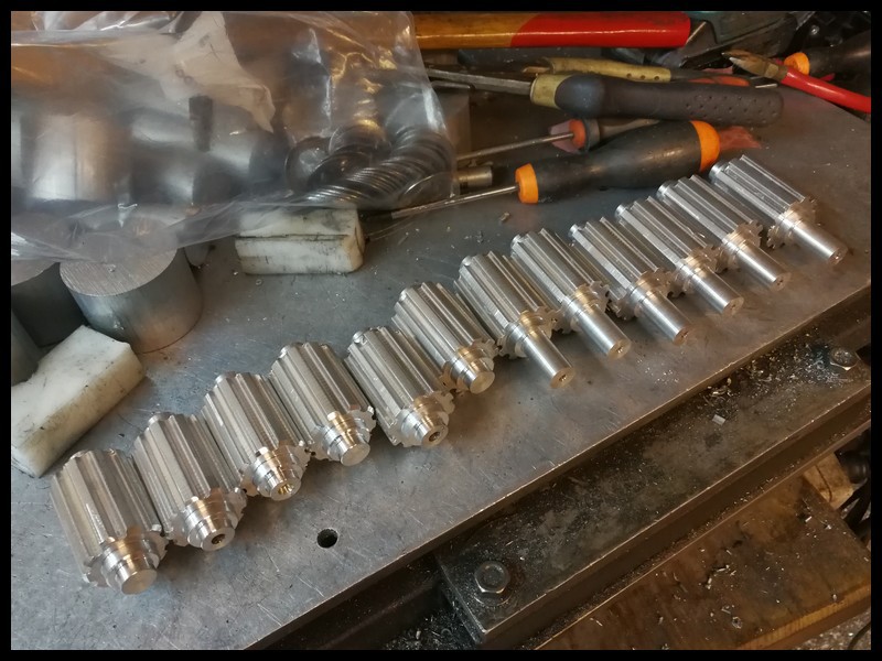

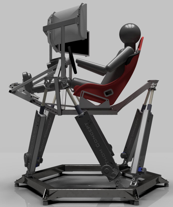

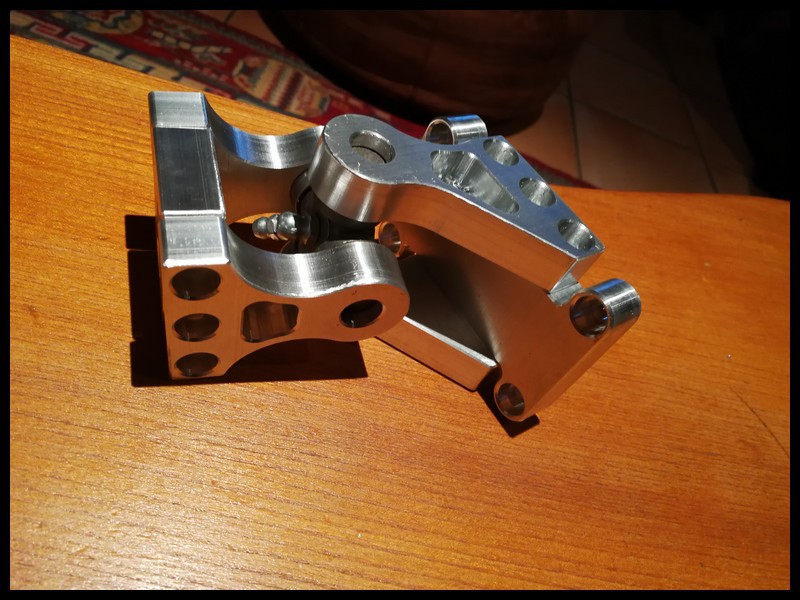

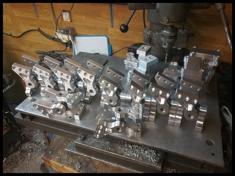

    Hi all!
    Thomas, 27 years old, new on this forum, from France ( sorry for my bad english)
    Here is a little presentation of my 6 dof project.

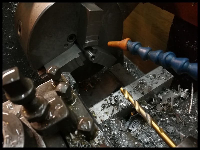

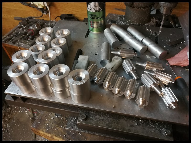

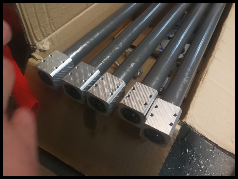

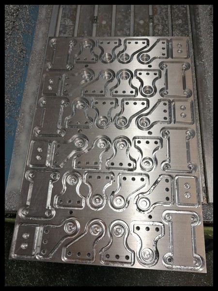

    3d modelisation is almost end, and I have allready made two prototype of linear actuator last years...
    the first had many design defect and was a little shit but the second worked almost fine
    the first:
    the second:
    now I am currently building 6 new actuator, that are almost end, and frame and cockpit building will start soon.
    here is some spec:
    -6x 400w ac servo motor powered by 6x ioni pro HC drive.
    -actuator force 60kg (135kg peak) and 625mm/s , 420mm stroke.
    -aluminium cockpit, suspended mass 135kg ( include 80kg driver, OSW, pedals, triple screen and seat)
    -in static position each actuator load is 30kg ( 50% of the nominal force and 22% of the max force)
    -zero play, all actuator have precharged bearing and transmission system that ensure me to have absolutely zero play, same for the DIY cardan join articulation
    here are some picture of 3d and already realised work:
    that's all :)

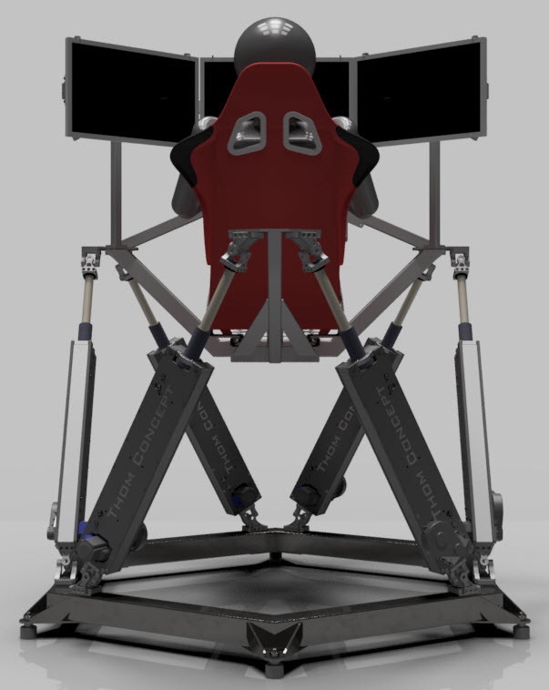

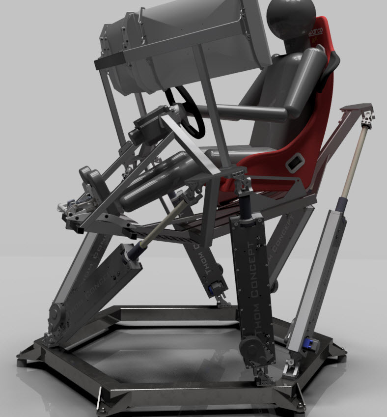

    AC motor, 6DOF
    oups I have forgot to put 3d...

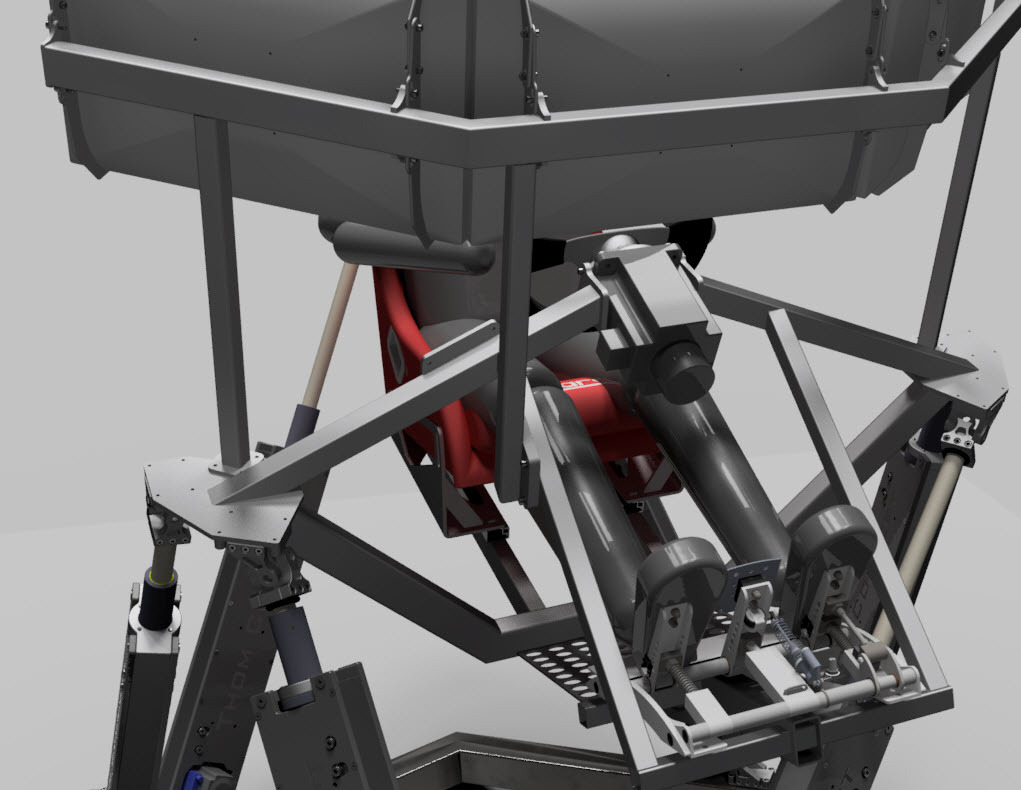

    here is 3d:

    DC motor
    Really great actuators!!! Especially like your joints!
    Do you know, how much one of it costs?
    And why don't you just use some VR-glasses, instead of 3 monitors?
  6. Rider63
    Rider63 Member
    Dec 10, 2017
    16
    273Coins
    +33 / 0 / -0
    AC motor, 6DOF
    thanks you, actuator cost me around 350€ of material, without motor. but many many hours of work.
    about monitor, as you can see on picture it can be unmounted, I will start with monitor because for the time I think VR resolution is not high enough. when it will be good enough I will play with VR. ( and win about 20kg of weigh

    AC motor, 6DOF
    this build is for me, but if it work well and are reliable, maybe I will sell actuator kit, reliability is the most important thing and will determine if I could sell it or not. I have no doubt about performance.
    but when I look at te time to make it, I'm not sure the price will not be too high. It's not really design to cost. ballscrew system will be beter for cost.
    I did not count the spent time, I started to build actuator this summer, but not spent 100% of free time on it.

  13. Rider63
    Rider63 Member
    Dec 10, 2017
    16
    273Coins
    +33 / 0 / -0
    AC motor, 6DOF

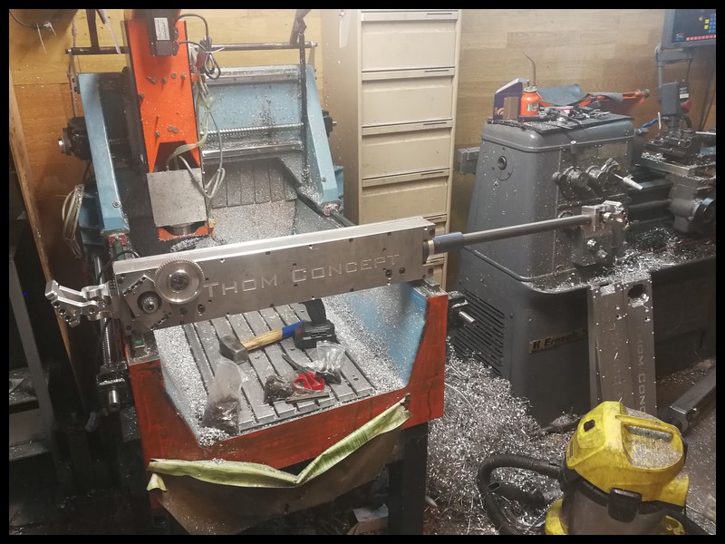

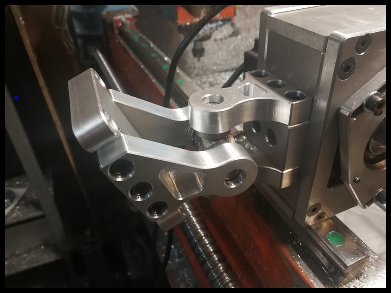

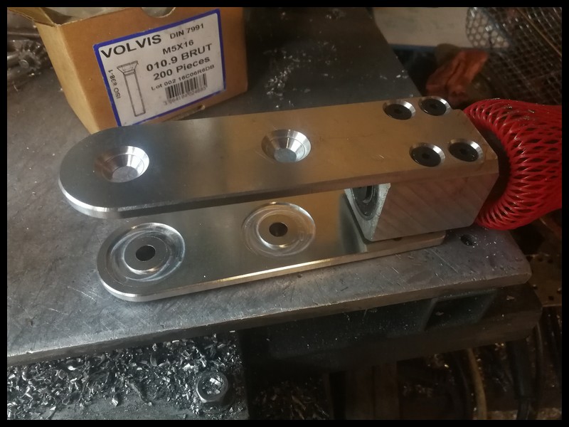

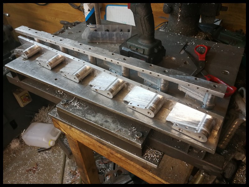

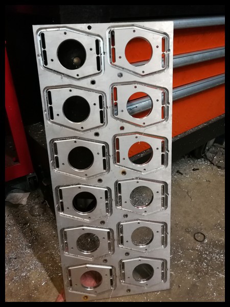

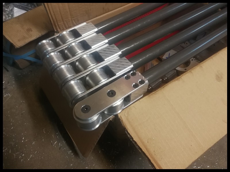

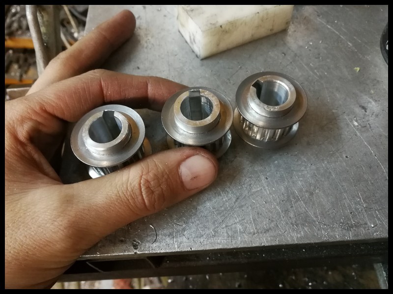

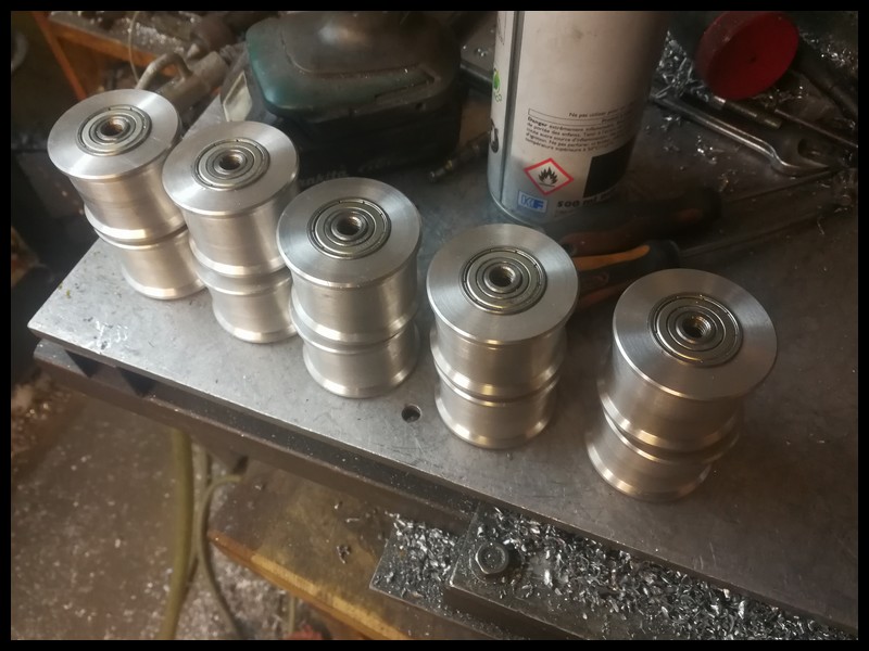

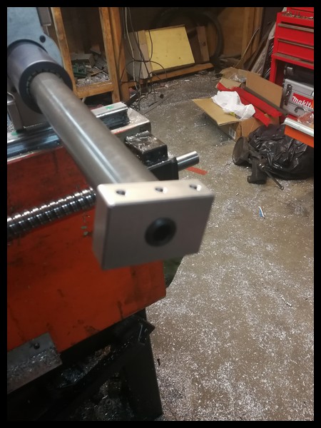

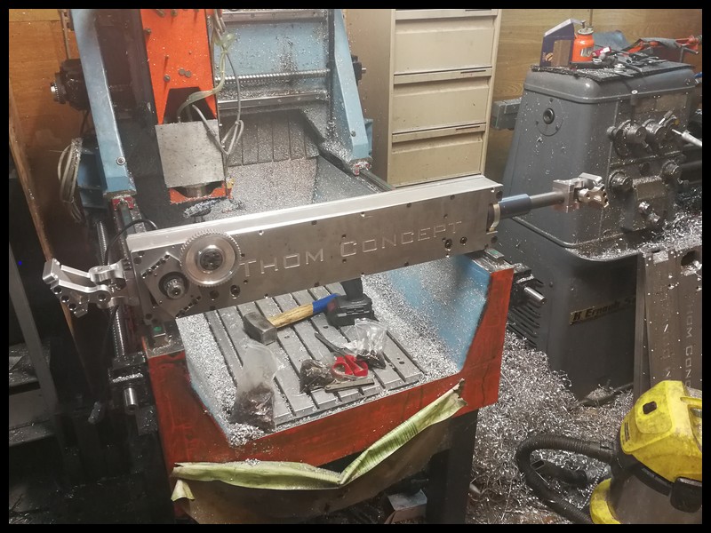

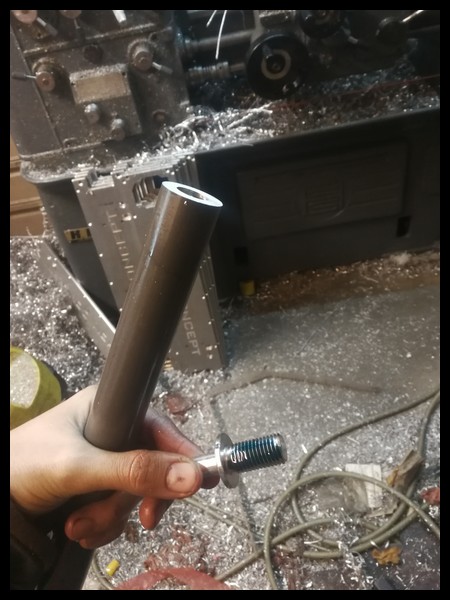

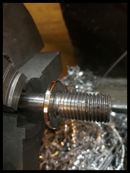

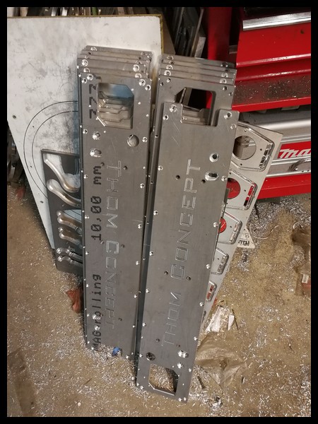

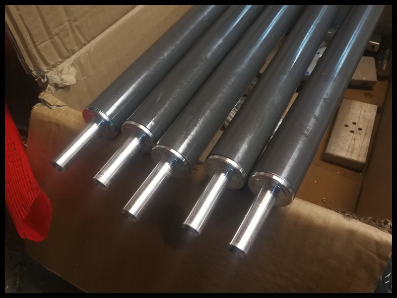

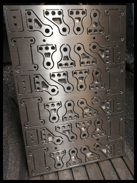

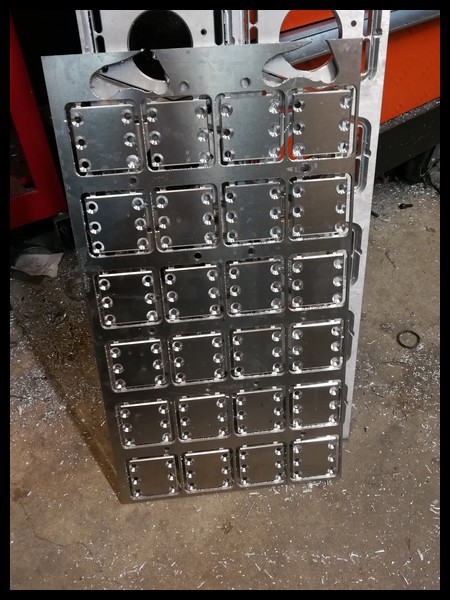

    Hi, first actuator are finished, the 5 other are almost finished... ;)
    here is some picture:
    • Like Like x 6

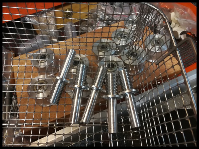

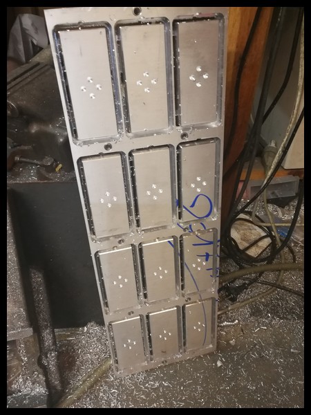

    Hi all
    somes new of my project,
    cutting of steel sheet for the base on the plasma cutter of a friend:
    [​IMG][/url][/IMG] [​IMG]
    cutting of all tubes (aluminium for cockpit and steel for base):
    here is my screen pliers:
    I also have cut and bent seat mount, I have another friend who have a bender, yes I have the good friends ;) :
    and now there is the aluminium cockpit, first time I weld aluminium, so it's not art welding but I thinks it will be strong enough
    that' all :)
