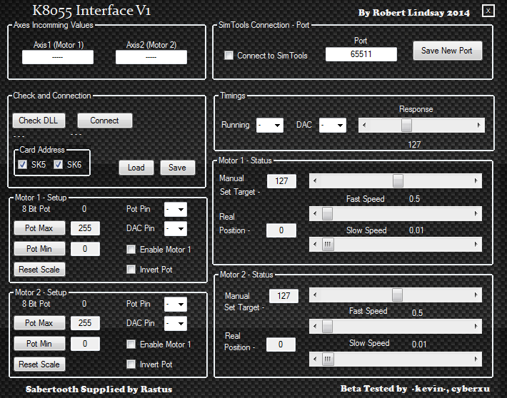

    Im in the middle of finishing off code for a K8061 to run 3x sabertooths to run a 3 to 6 dof sim off one cheap controller.
    No code will be require by the user like in my existing K8055 application that successfully controls one Sabertooth.
    BTW Mat did you finish your Ard code to run a Sabertooth, your existing code fails.
