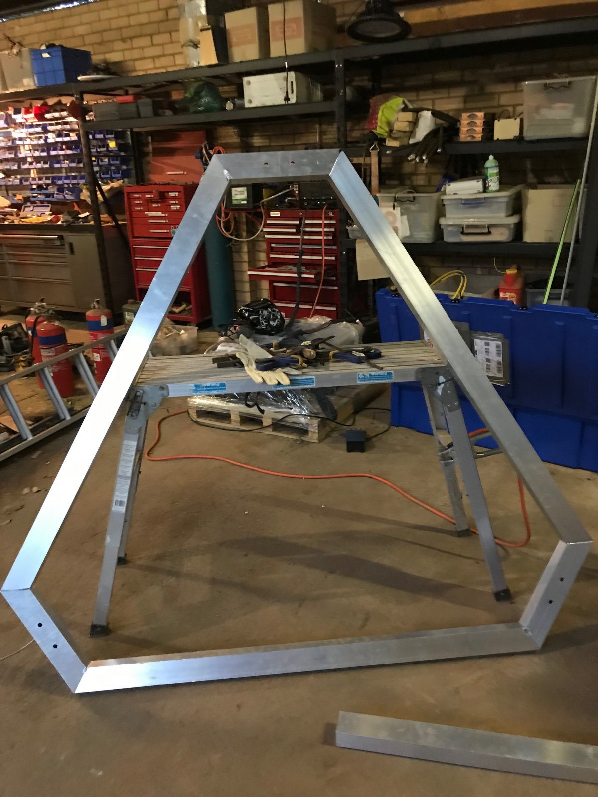

    IMG_1725.jpg So today began the aluminium base frame, cut and tack tig welded.
    Getting excited now.
    Tomorrow the upper frame

    Nice aluminum frame! :thumbs
    I'm trying to find someone in southern germany able to do aluminum welding for a reasonable price, but so far no joy :-(
    Intuitively, I agree! Unfortunately I have very few rational arguments for/against that. Depending on the actuator length this would be a quasi-regular octahedron. If anyone knows any mathematical papers on the topic, i'd appreciate.
    Cheers,... Dirty :)

    i made my bottom frame out of wood. but will be using steel for the top frame.
    looking forward to see your top frame, your bottom frame looking very nice!

    Hi guys. Why is it work takes up so much time, still trying to get to the top frame. I think I might be 100-150mm to long on the long edges of the base frame but not sure. Think I'll just continue and shorten later

    Unless your going to attach it to the floor somehow, I would always make the base out of steel so it has some weight/stability. Even with a steel base (although not that heavy) + 6 Actuators/capsule, my old 6DOF stewart platform use to often lift itself off the floor and travel. But it is of course always good to keep the top frame as light as you can.

    Hi seat time, I figured with my body weight would be enough to keep it down. At 100kg
  17. SeatTime
    2,572
    What happens is that 100 kg turns into 100kgs + of inertia when the rig is moving fast. Just something to keep in mind and for anyone else building a 6DOF base that there is no need to go to the trouble of building it light.

    Seatime is right. It is a good thing to keep the platform light (because of inertia), but the base is better to to be heavy and stable. Your weight won't keep it down. Exactly the opposite. 100 kgs trowed in a direction has a great potential to bring many things with it, like a light base.

    Thanks guys, didn't think of it that way. So now the choice, diet or fab a steel base? Then steel base it is....lol
    I think for testing I'll stay with the Ali base until I decide the exact diemensions and then just fab it up.
