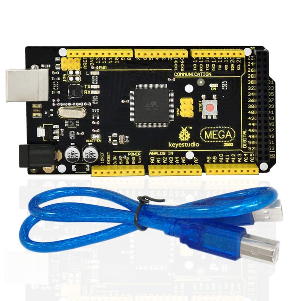

    - Arduino Mega
    - SMC3 - Code

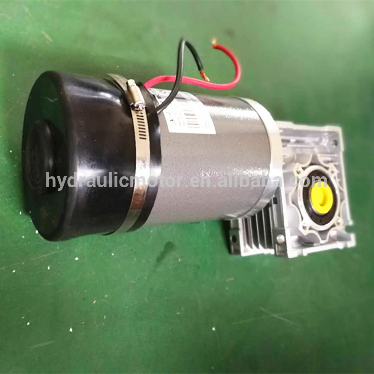

    24V 800W DC motor with 1:25 ratio (Updated 14.10.2019)
    https://www.alibaba.com/product-det...809.html?spm=a2700.8443308.0.0.20083e5fUqlcdp
    I took the motor with 4.5nm

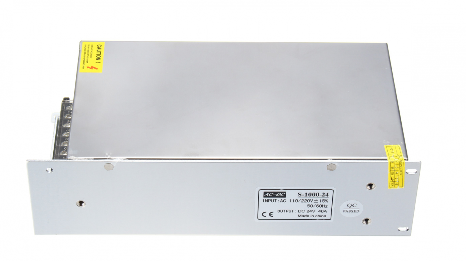

    https://www.robotshop.com/de/de/sab...14eqtnnULz1nV-k4lbSam8qctQ-MBwJxoCTqUQAvD_BwE

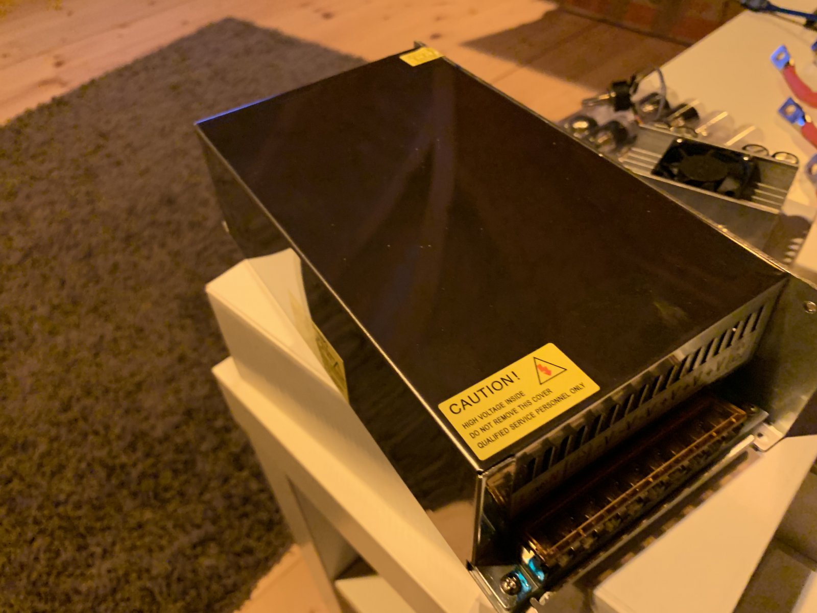

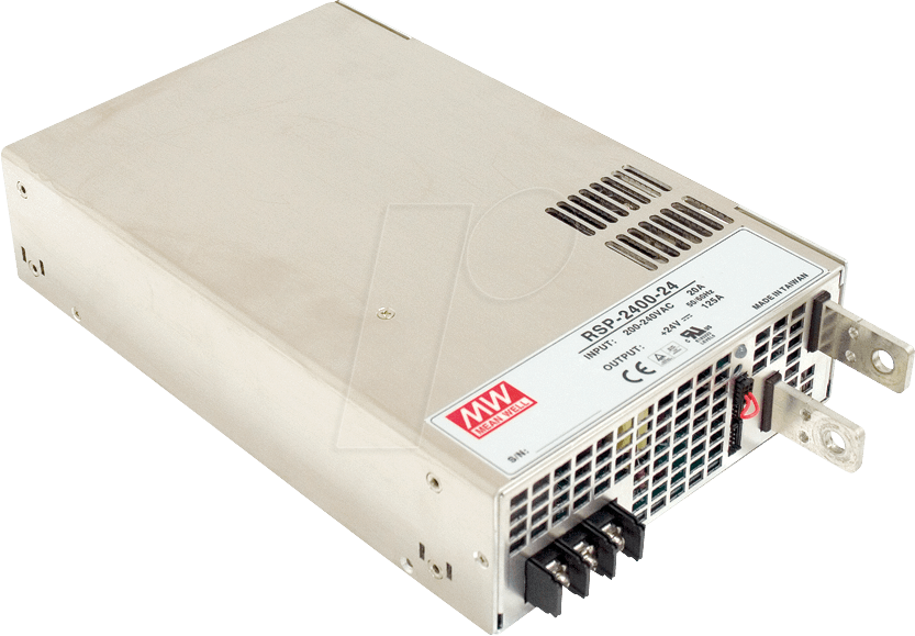

    1x 24v Dc Power Supply 2400W (updated 14.10.2019) (instead of 2 Power supplys)
    https://www.reichelt.de/schaltnetzteil-geschlossen-2400-w-24-v-100-a-mw-rsp-2400-24-p147903.html

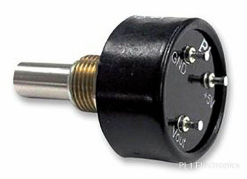

    Rotary Pot
    https://www.ebay.de/itm/Bi-Technolo...-0-2V-20V-To-1-/173617021337?oid=173400069527[​IMG]

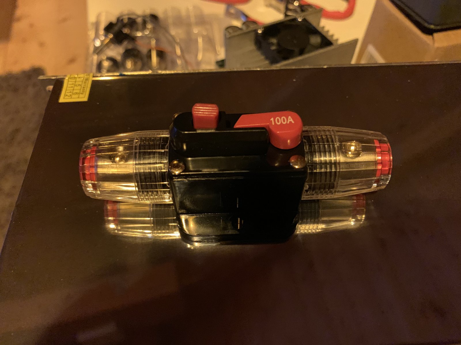

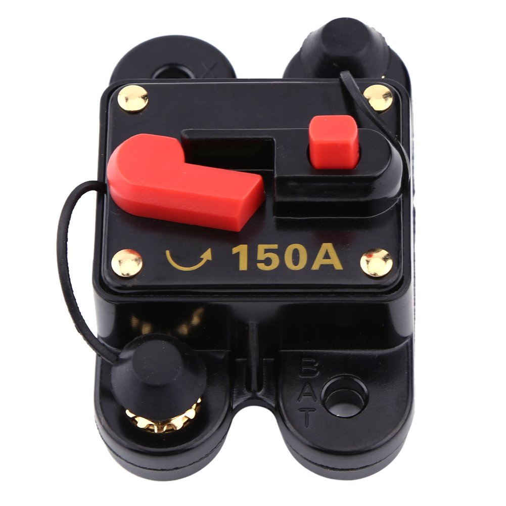

    24V 150A Fuse for two motors

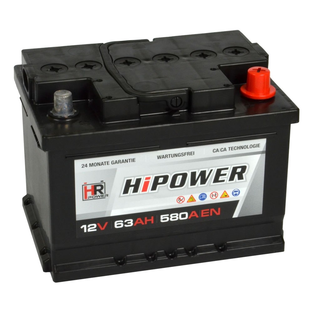

    2x 12V battery for the regen ( but how much Ah do i need?)
    will this battery be ok?
    Or are these to big?
    https://batterie24.de/Autobatterie-...GF5mem2HBbcKfbDXIsa0Yx2rkTK6tMRhoC7u4QAvD_BwE[​IMG]

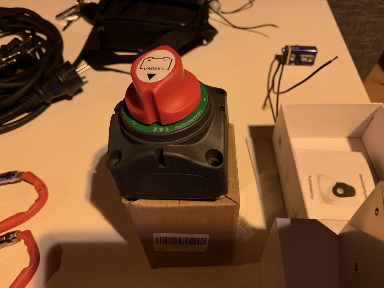

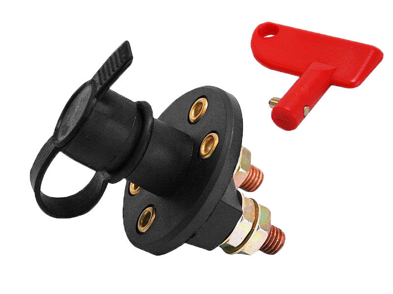

    Disconnector in the negativ Wire from the Battery/Power Supply to the Sabertooth
    https://www.ebay.de/i/153159360292?chn=ps[​IMG]

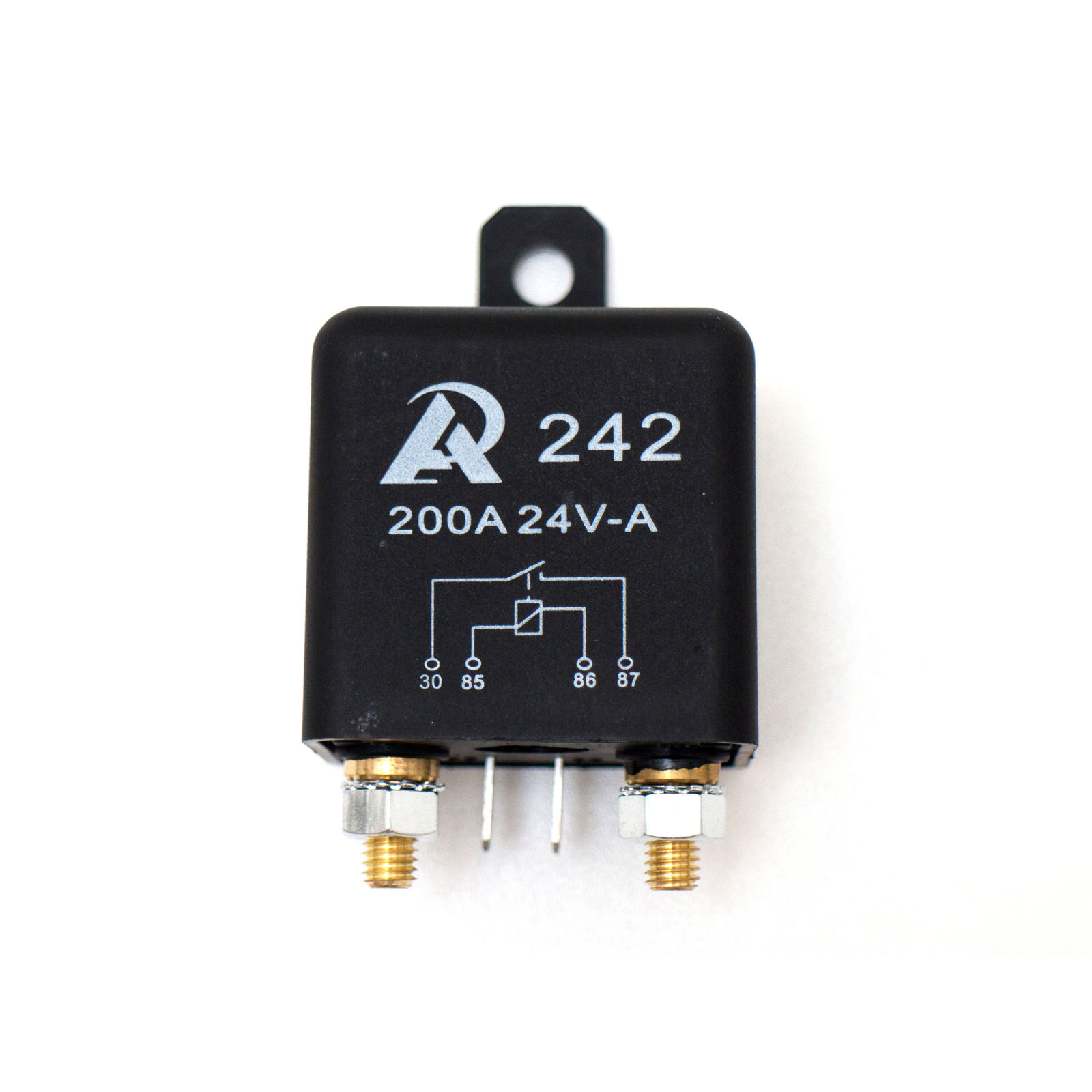

    24V Relais to disconect the motor from the Sabertooth with an emergancy Switch
    https://www.ebay.de/i/121299159407[​IMG]

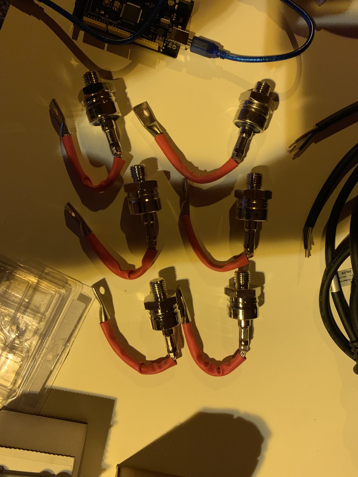

    Do i need the Diode between Power Supply and Battery?
    Which one do i need?

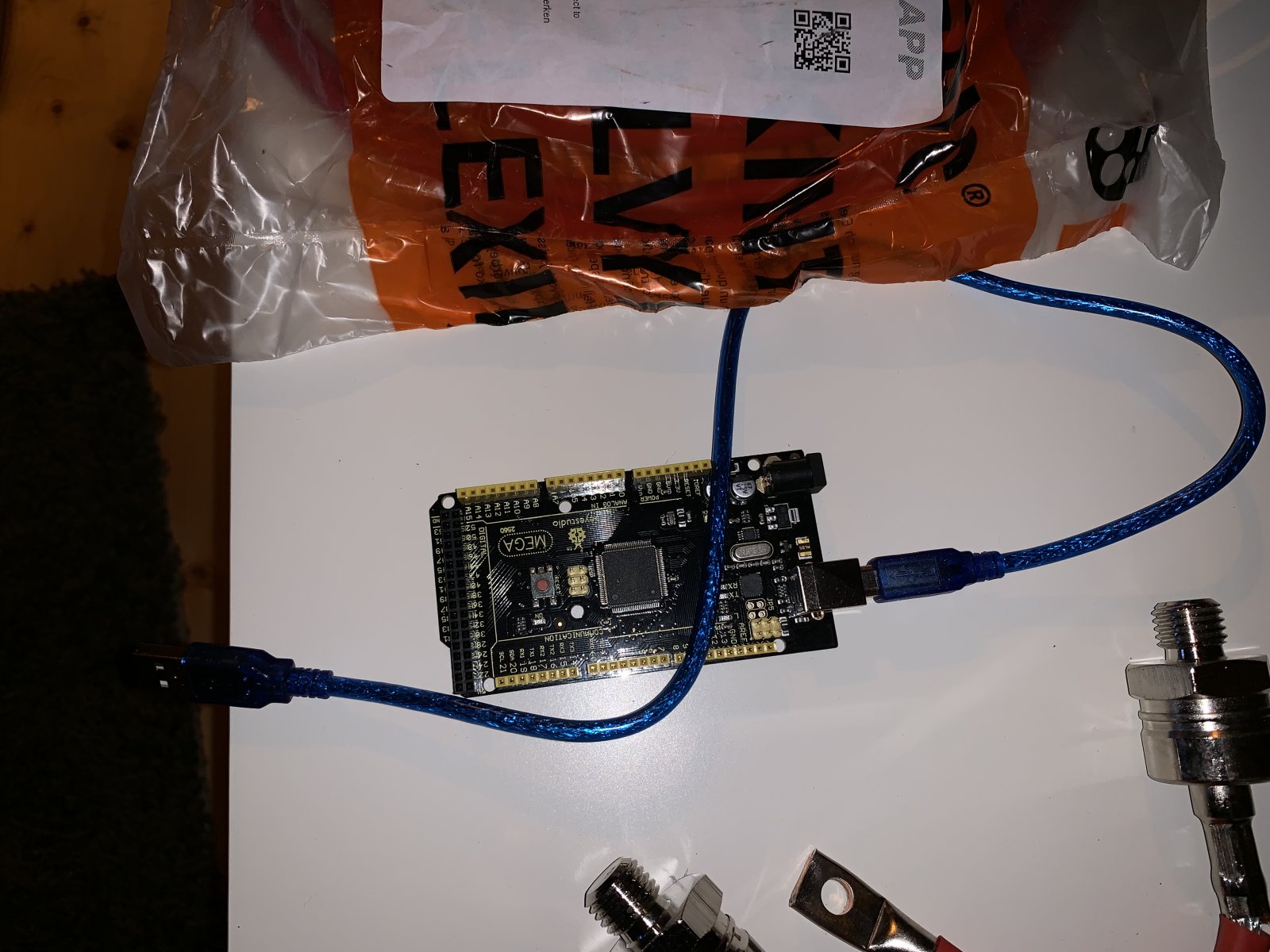

    Does SMC 3 work with Aruino Mega plug and play?
    Or should the sketch be modified?
    How much Ah should one 12V battery have?

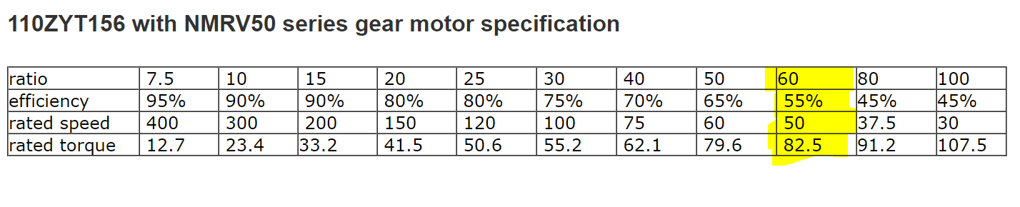

    Calculation:
    - Length of the Arms on the Worm Gear
    The torque of the Motor with 1:60 ratio is 82.5 Nm
    82.5 Nm / 9,81 = ~ 8,4 kg with Arm length of 1 Meter
    with 20cm Arms:
    8,4kg x 100 /20 = 42kg á motor
    42kg x 6 Motors = 252kg
    with 15cm Arms:
    8,4kg x 100/15 = 56kg á motor
    56kg x 6 Motors = 336kg
    with 10cm Arms:
    8,4kg x 100/10 = 84kg á motor
    84kg x 6 Motors = 504kg
    is this correct?
    So normaly i can use 20cm Arms?
    Or shoud i reduce the Ratio, for more Speed?
    What is more important? Speed or Power?
    Thanks a lot

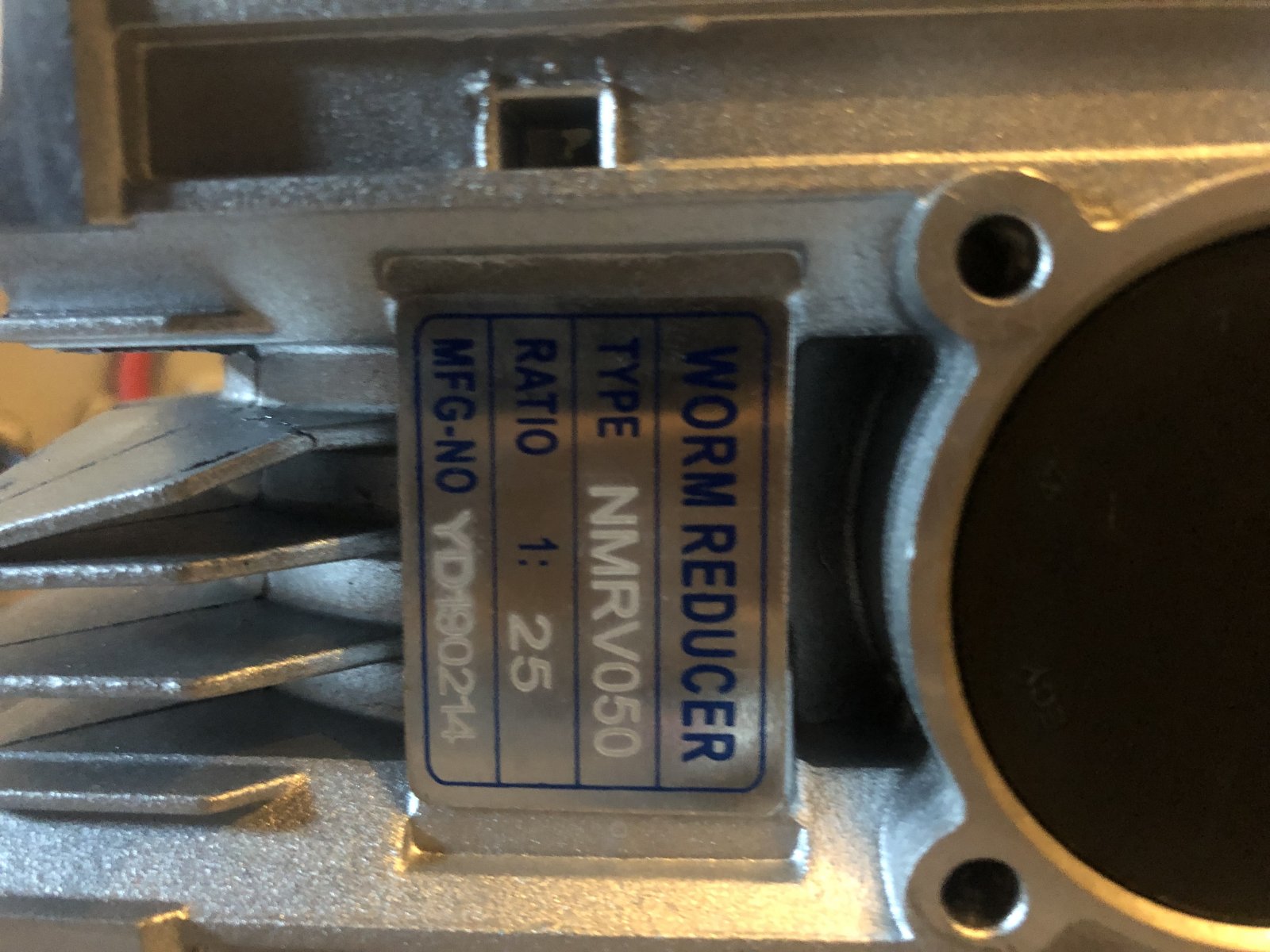

    UPDATE 14.10.2019:
    I orderd the motors with a ratio of 1:25 and a different Motor!!
    see above
    motors have 4.5nm without gearbox
    ratio is 1:25 -> 4,5 x 25 = 112,5nm on the levelerarm
    112,5nm / 9,81 = ~ 11,5 kg with Arm length of 1 Meter
    My Levelerarms are 20cm long
    11,5kg * 100cm / 20cm = 57,5kg per motor *6 = 345 kg for all 6 Motors
    and yes it is a little bit to much POWER :D:D:D:D
    No problems with temps (14.10.2019 only short testing)

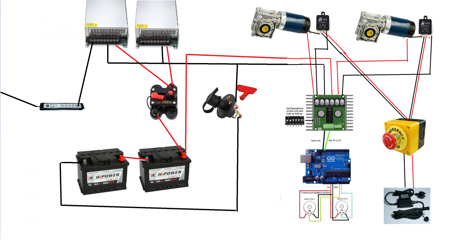

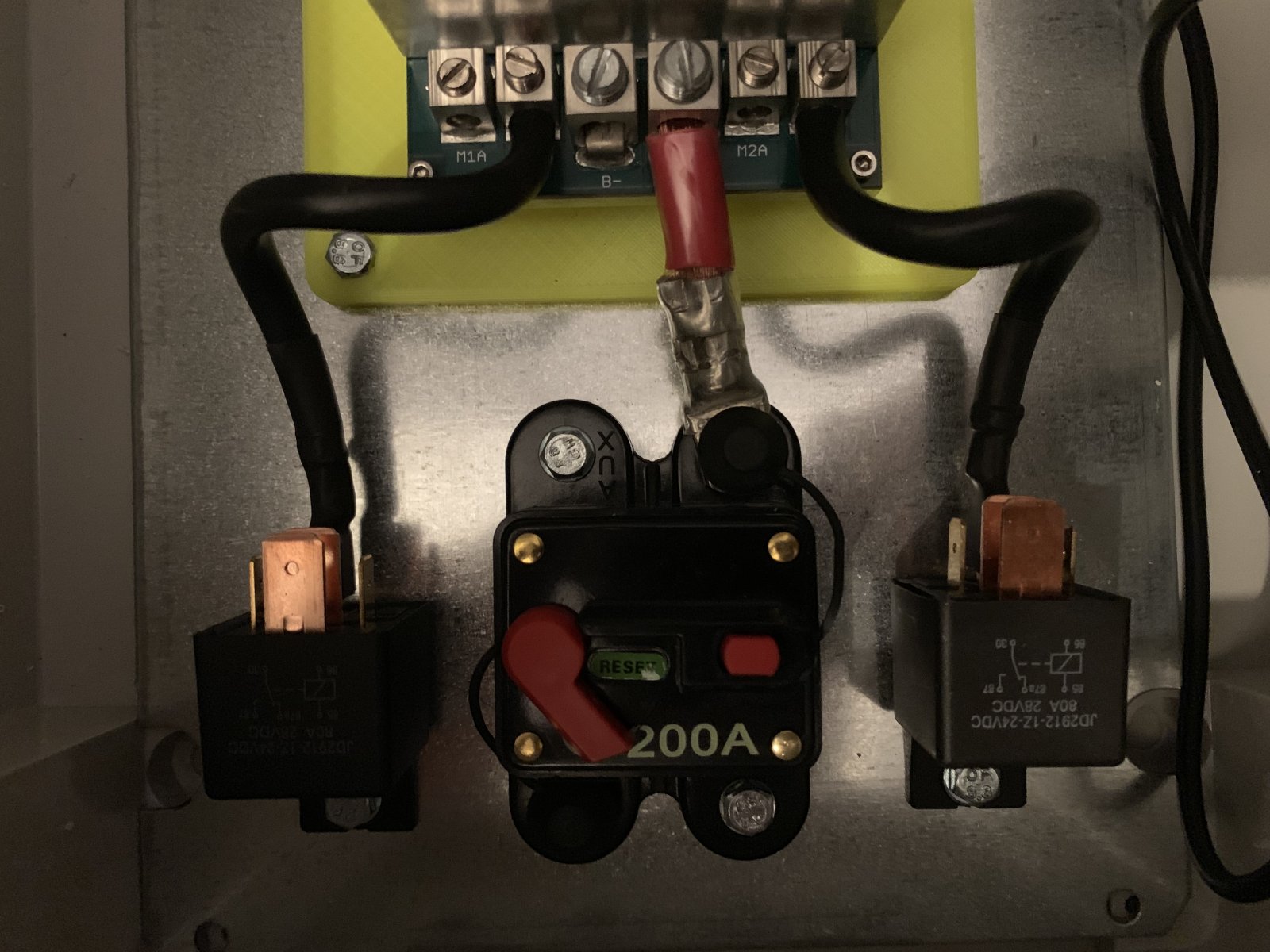

    Here is the Wiring diagram :nerd
    Not the best but i think i should work :D
    What does the Experts say?
  3. BlazinH
    BlazinH Well-Known Member
    Oct 19, 2013
    2,145
    Oklahoma City, USA
    16,665Coins
    +1,839 / 32 / -1
    Diode, no. Mega plug and play yes, no mod needed. Batteries shown should be more than enough.
    I don't have a 6dof so I won't attempt to answer on torque.
    Wiring looks okay to me but while you don't need diodes for the batteries you may need some on the power supplies to isolate them from one another or you may not.

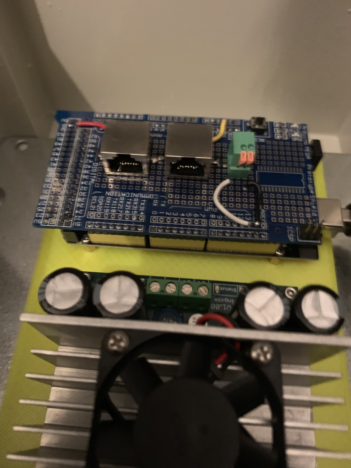

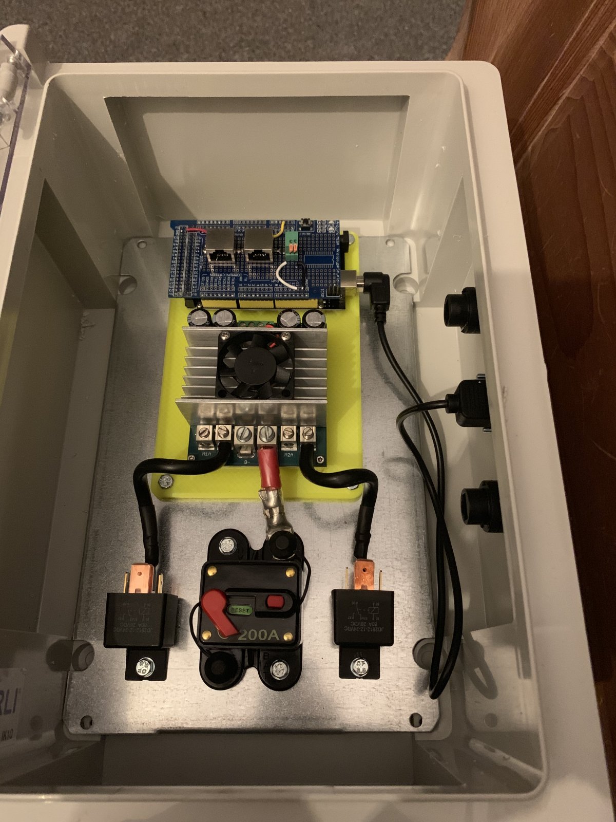

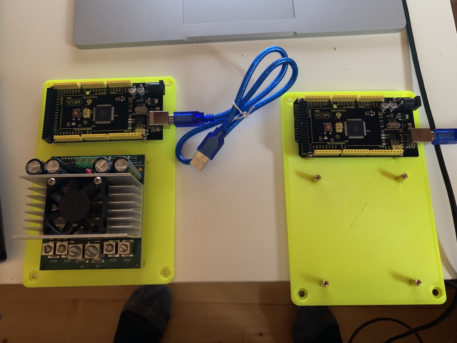

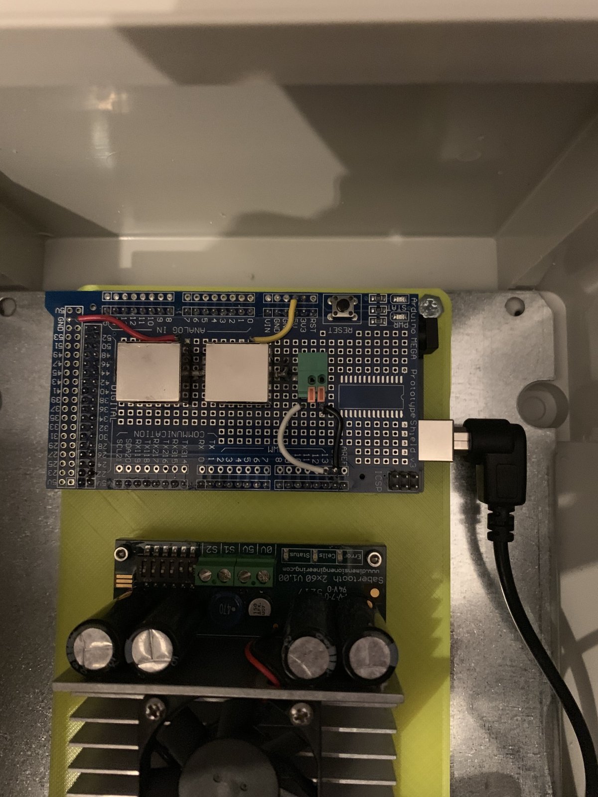

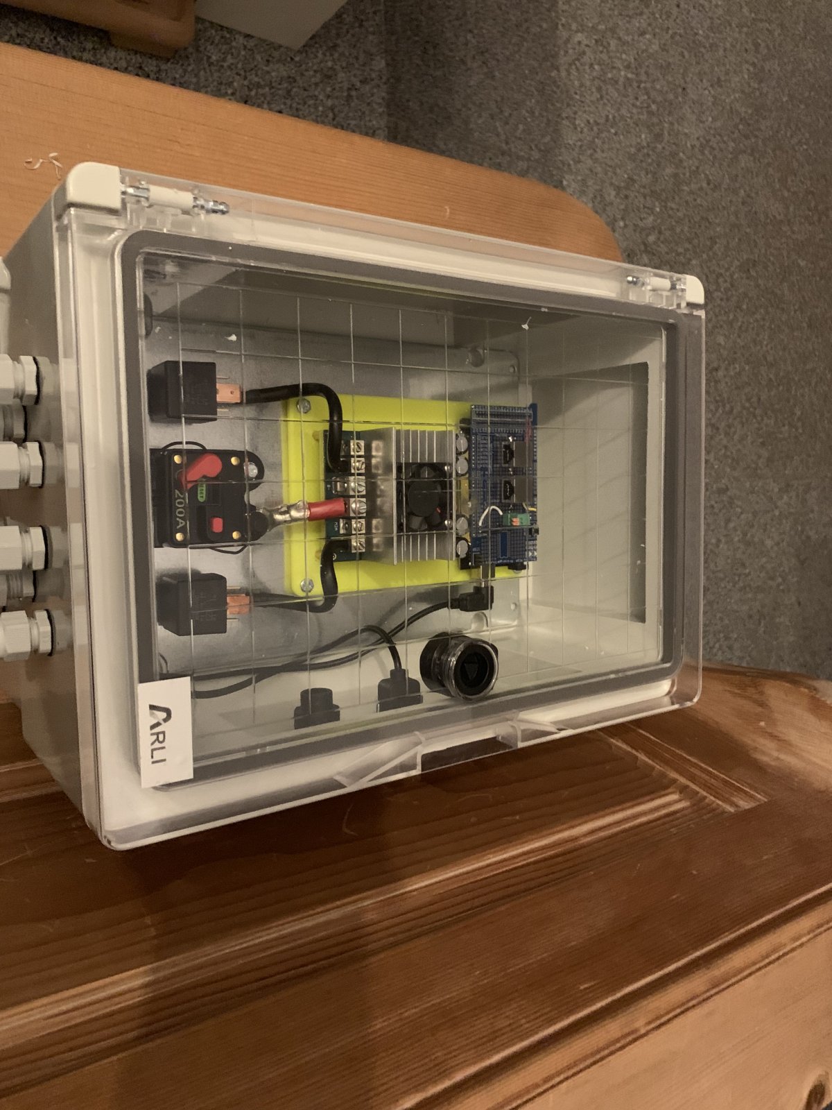

    The last week i got a few parts vor my sim.
    I designed a mounting plate for the Arduino Mega and the Sabertooth 2x60.
    Now i need a Box for all my Parts.

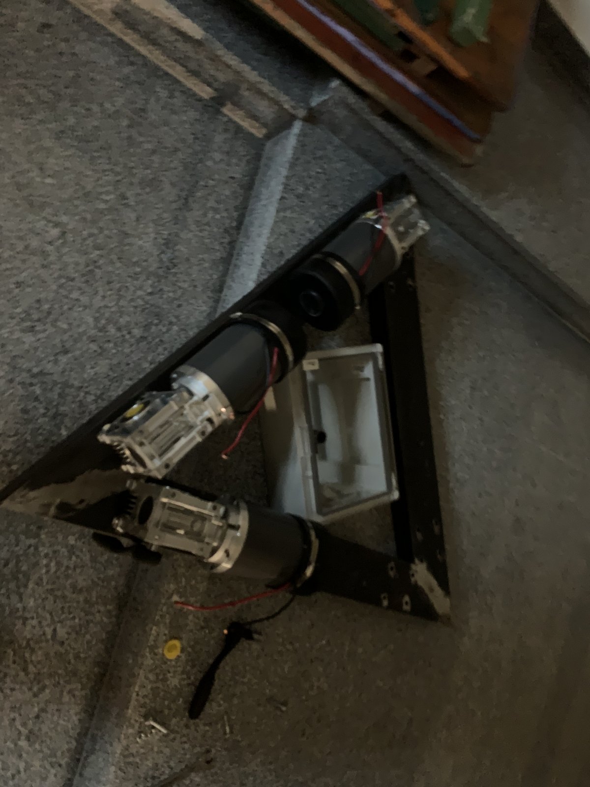

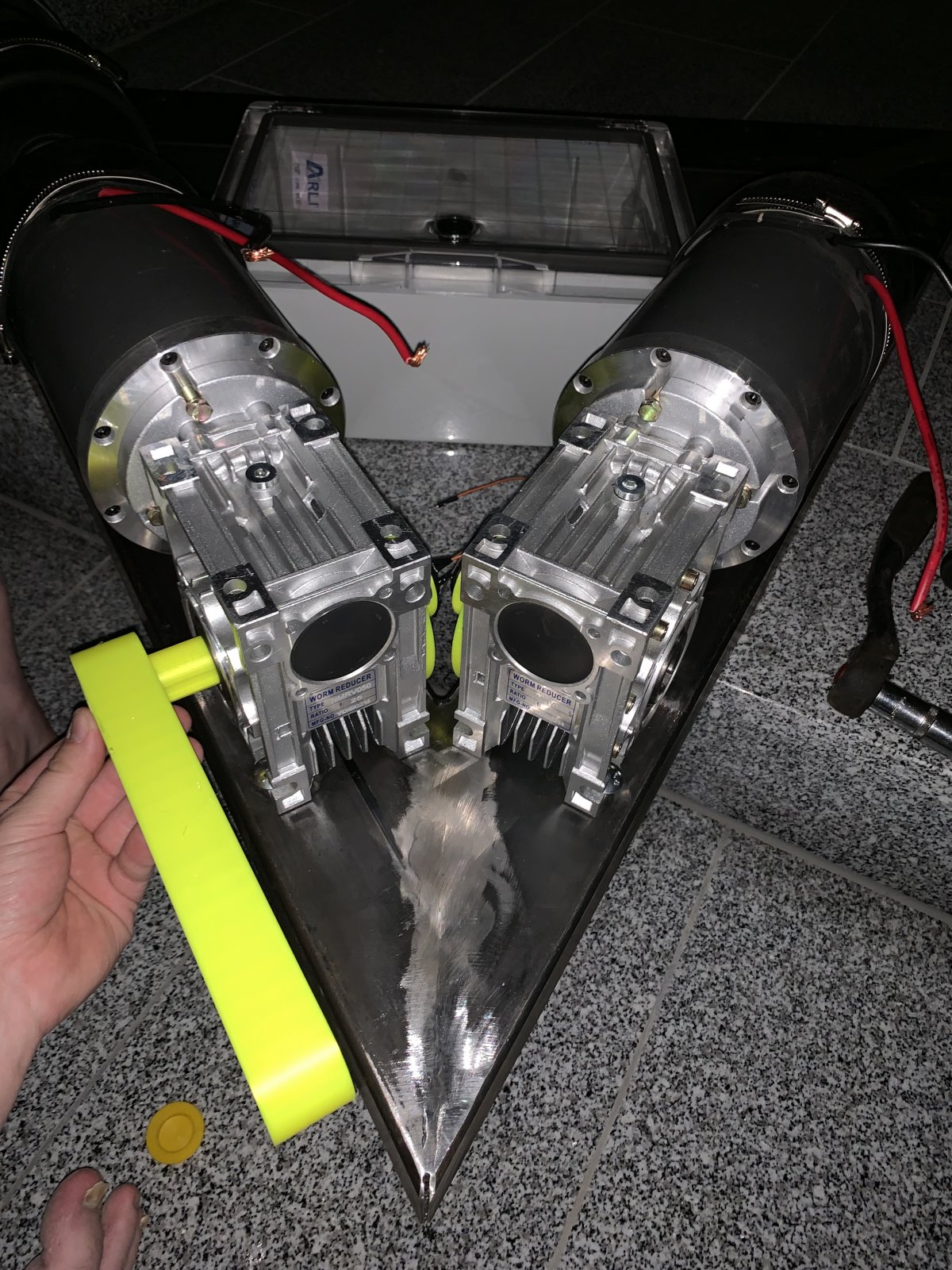

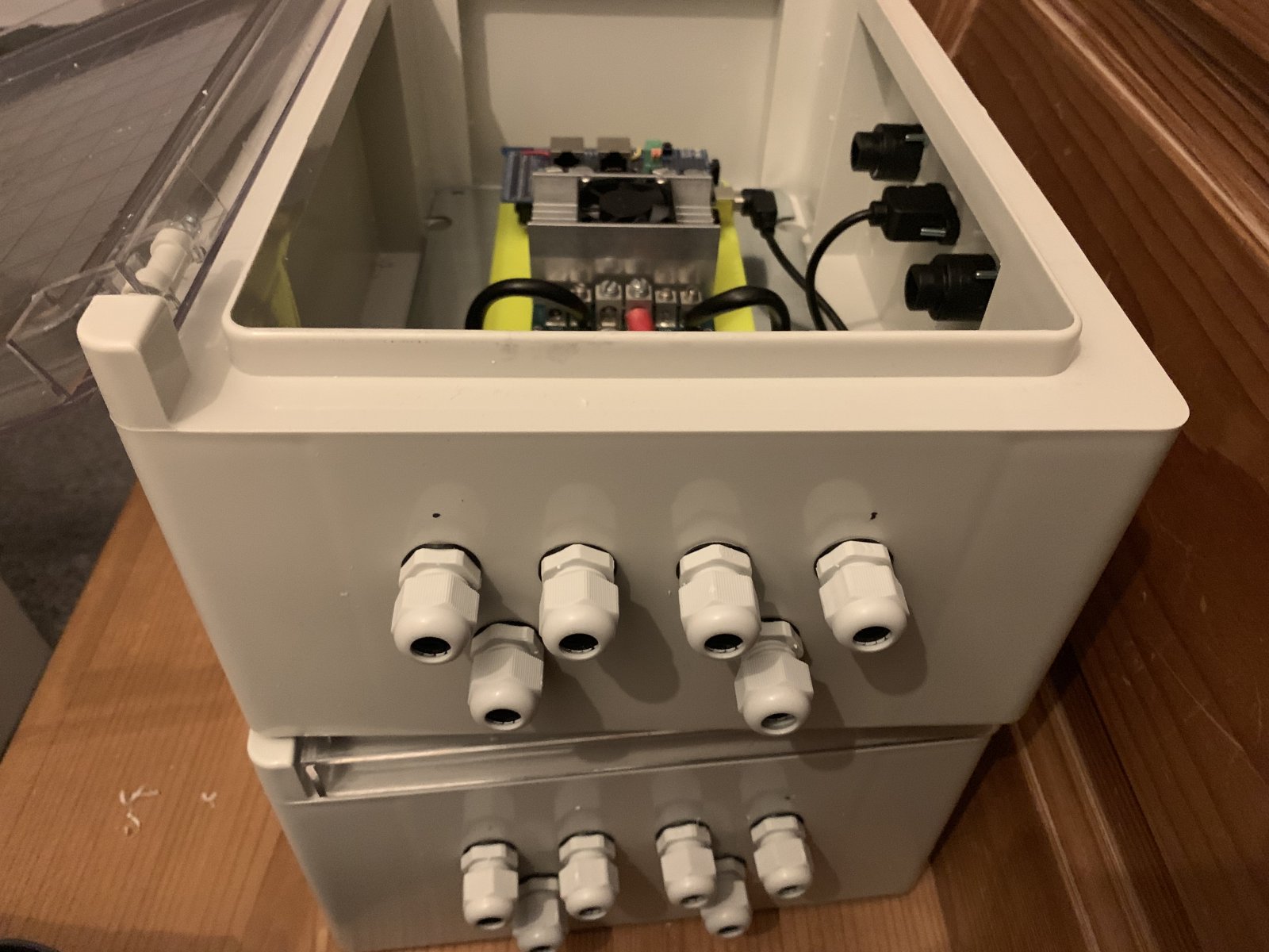

    Small Update.

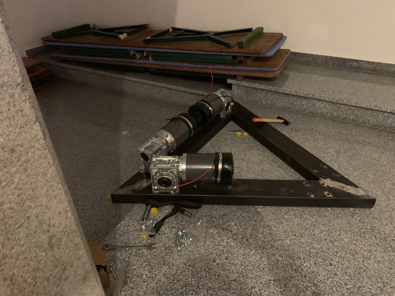

    Now i have to finish the 3 Motor Boxes.
    Wire the motors.
    Install Power Suppleys and Batteries.

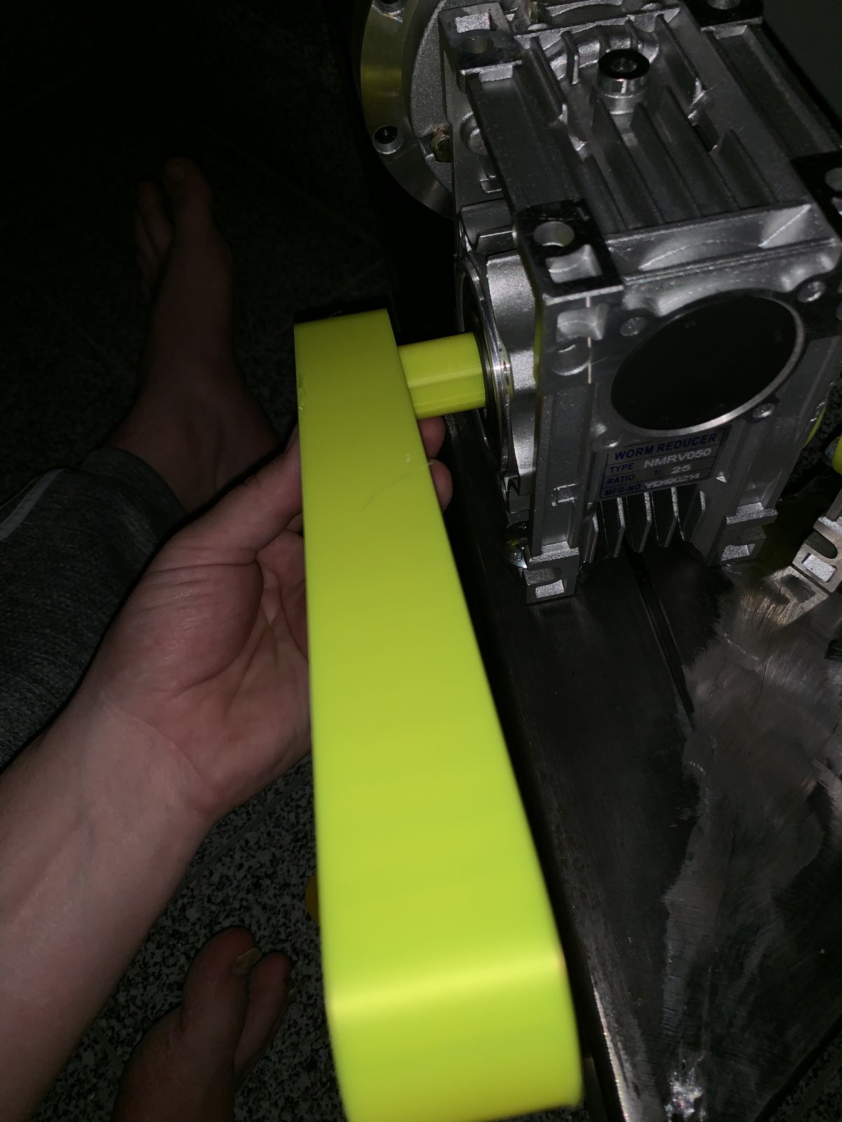

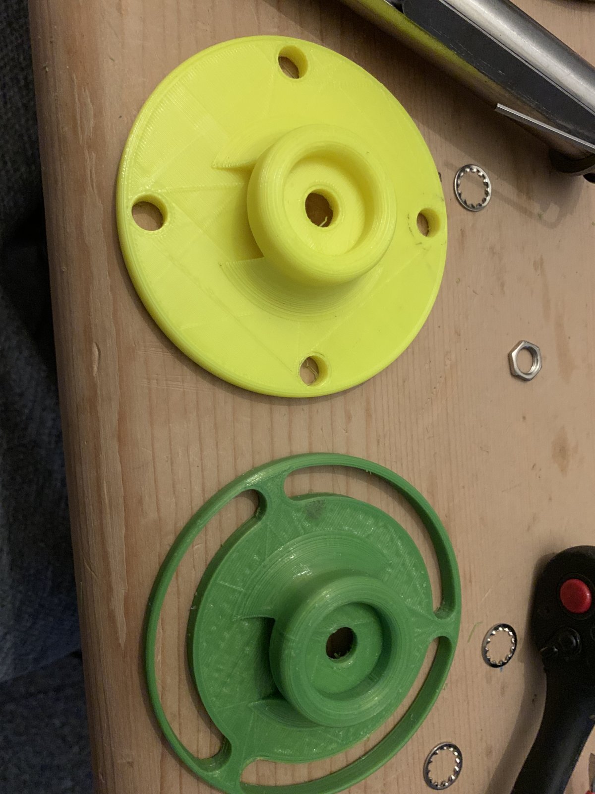

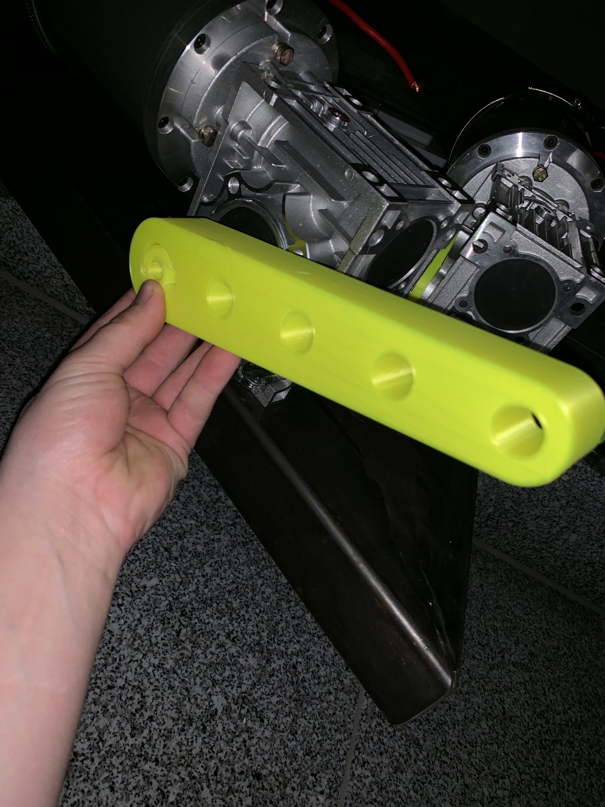

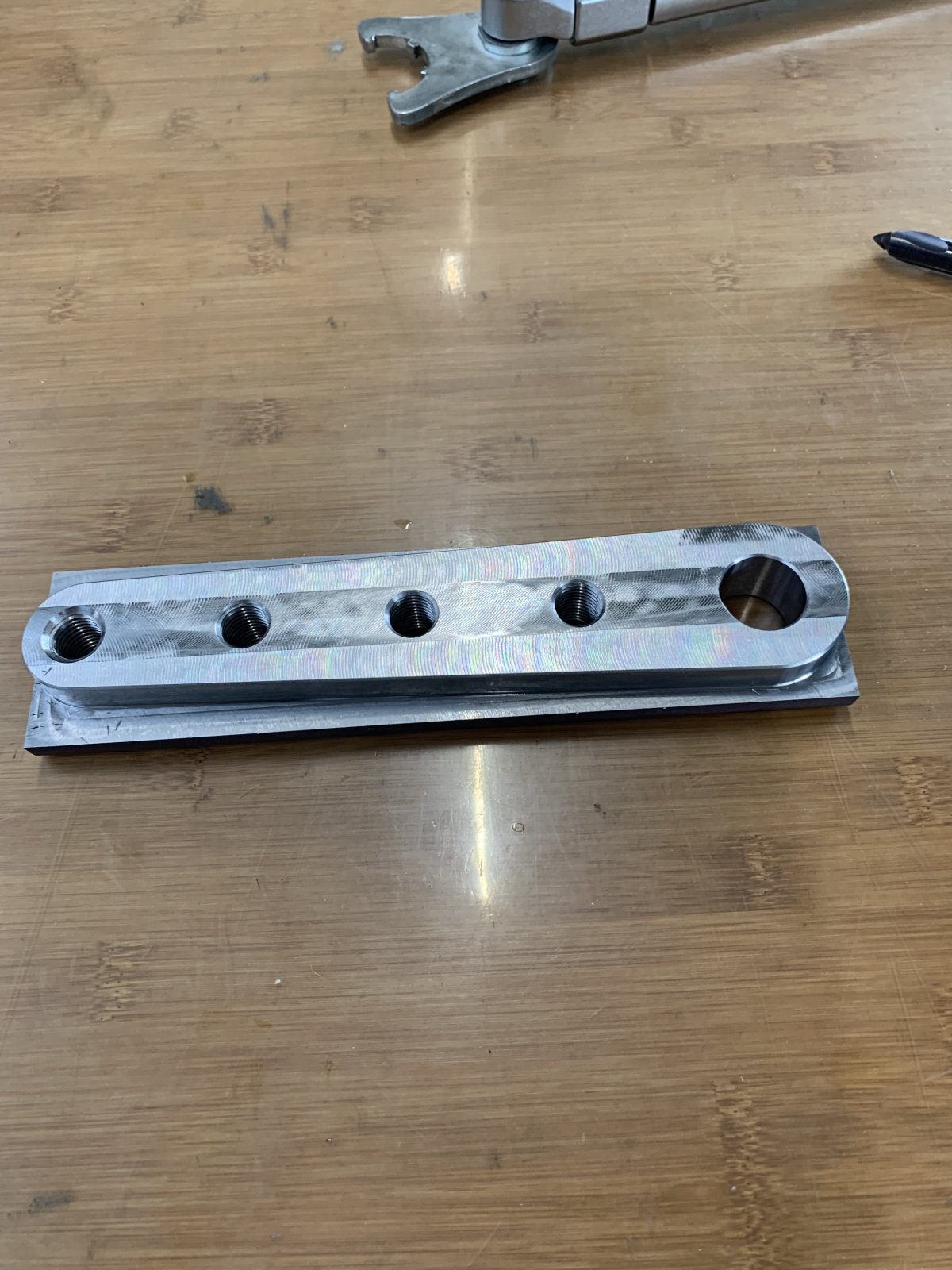

    Today i made a new design for my Poti Mount.
    Should be easier to adjust.
    Yellow old
    Green new

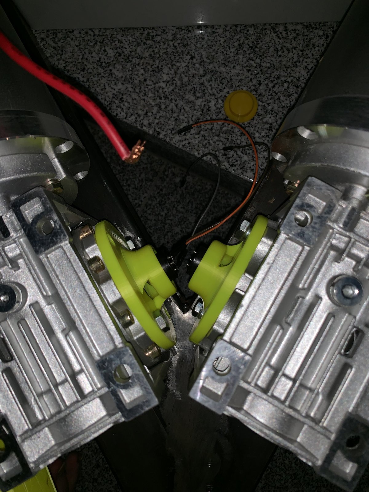

    Some new Impressions

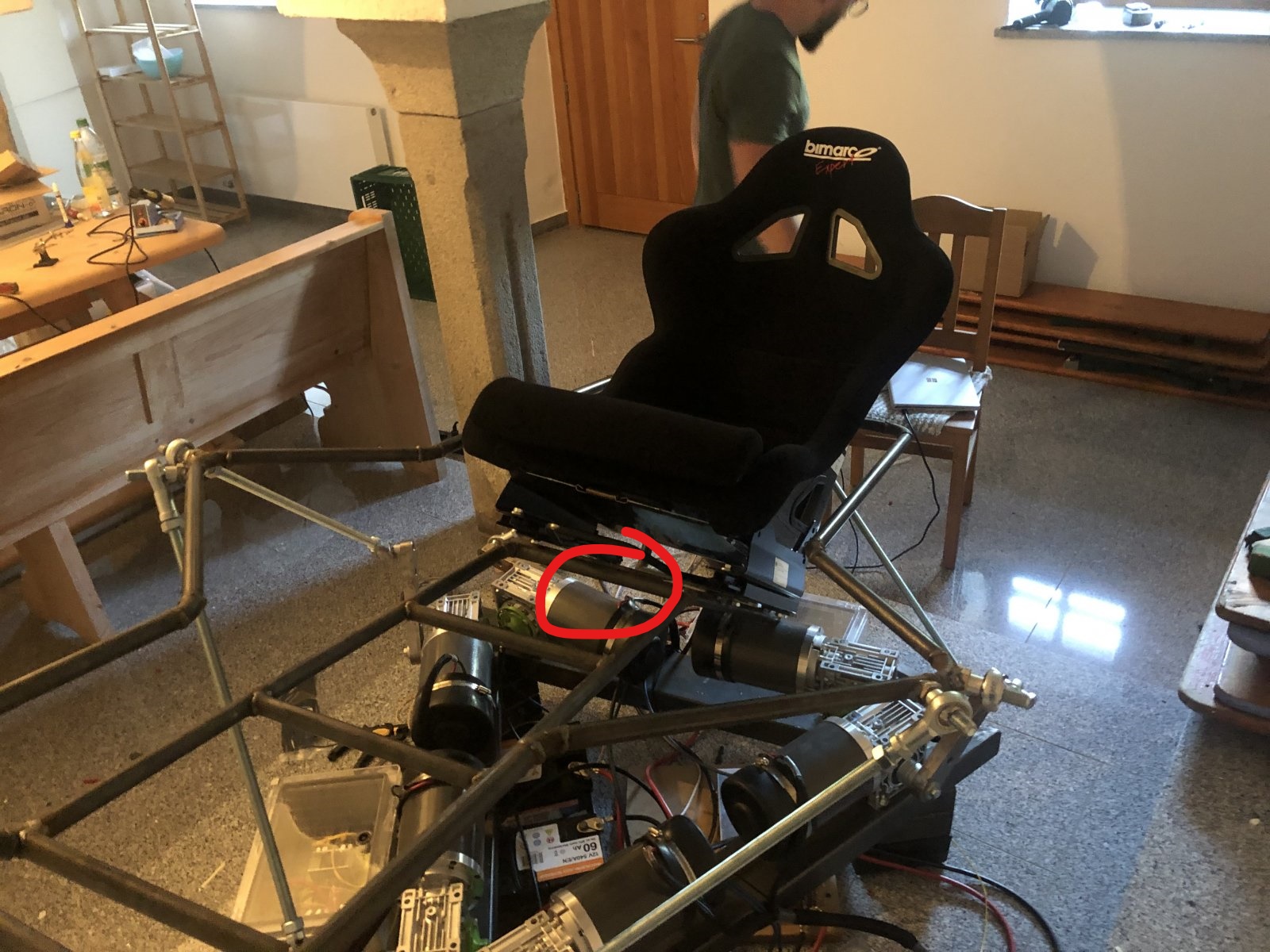

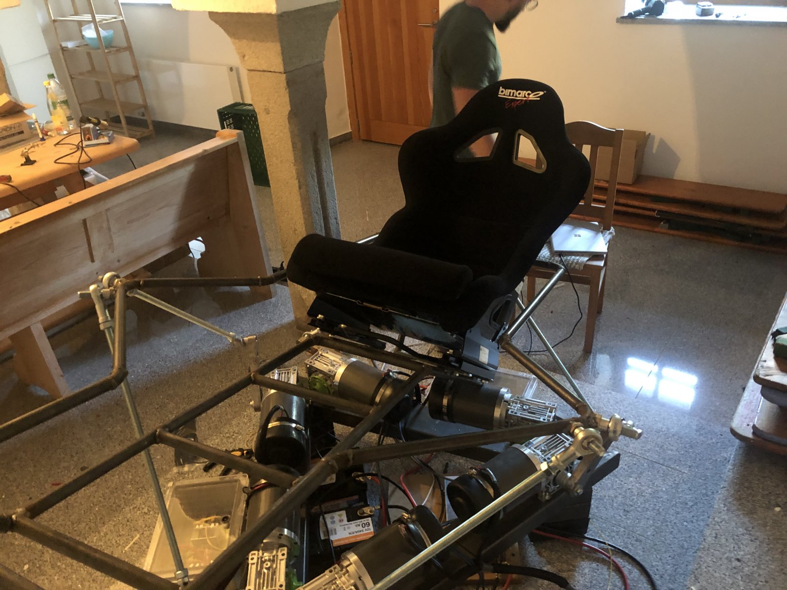

    Yesterday i tryed to start my rig.
    Pitch Roll and Heave works great.
    But Yaw Sway and Surge dont work correct.
    When i change the surge slider the rig operats like pitch?
    But why??
  15. Jürgen Schon
    Jürgen Schon Member
    Dec 6, 2018
    39
    57Coins
    +25 / 0 / -0

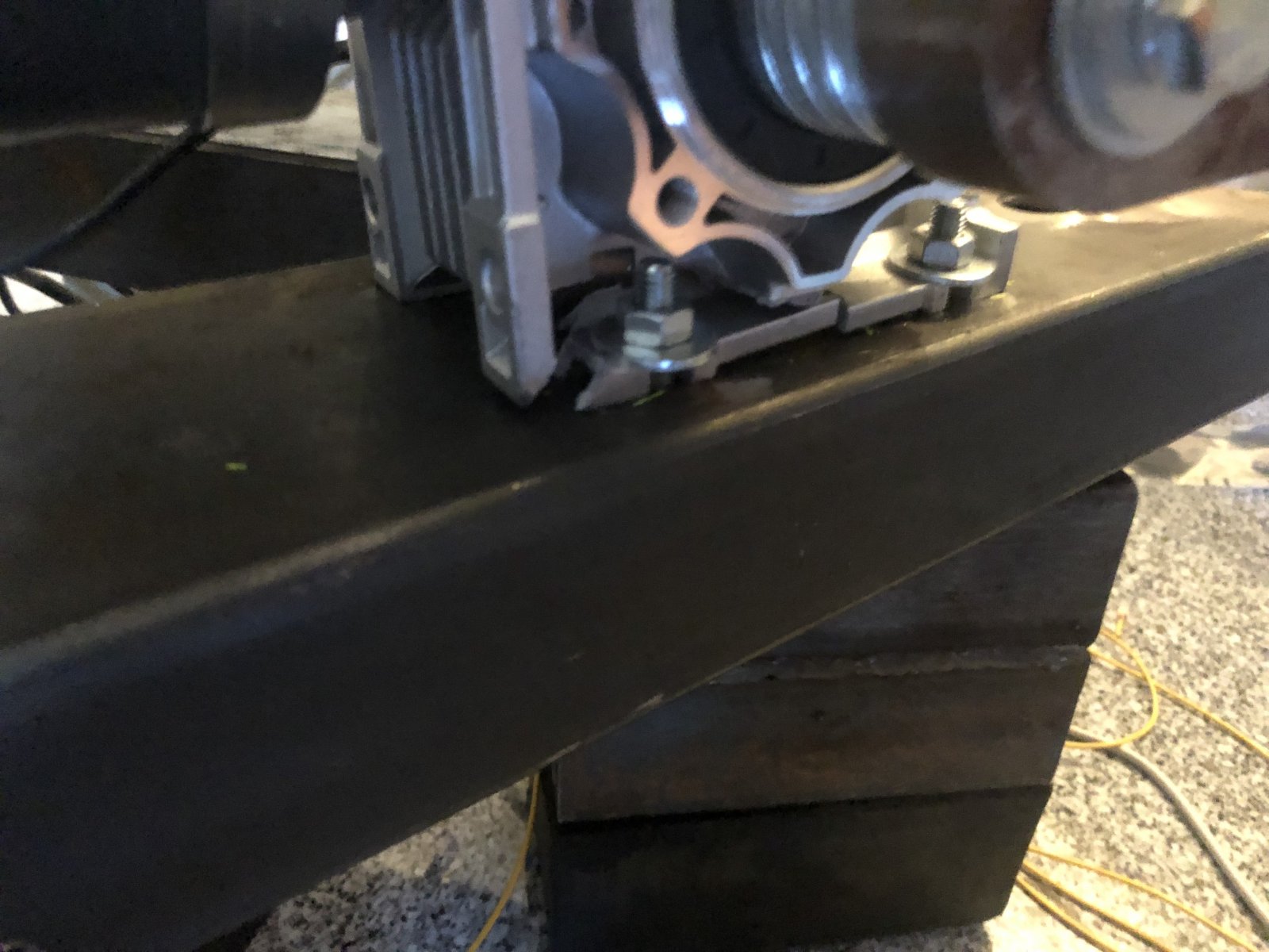

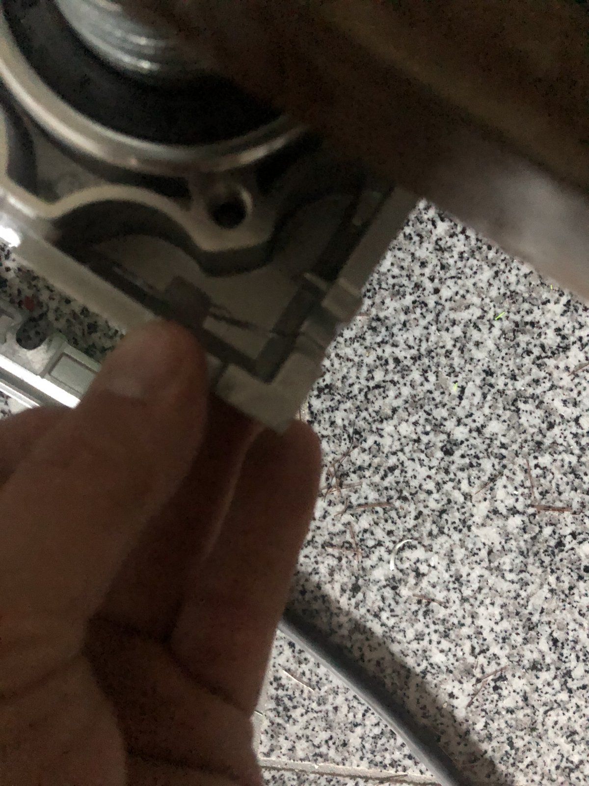

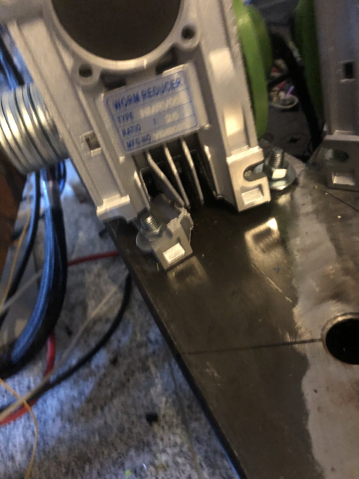

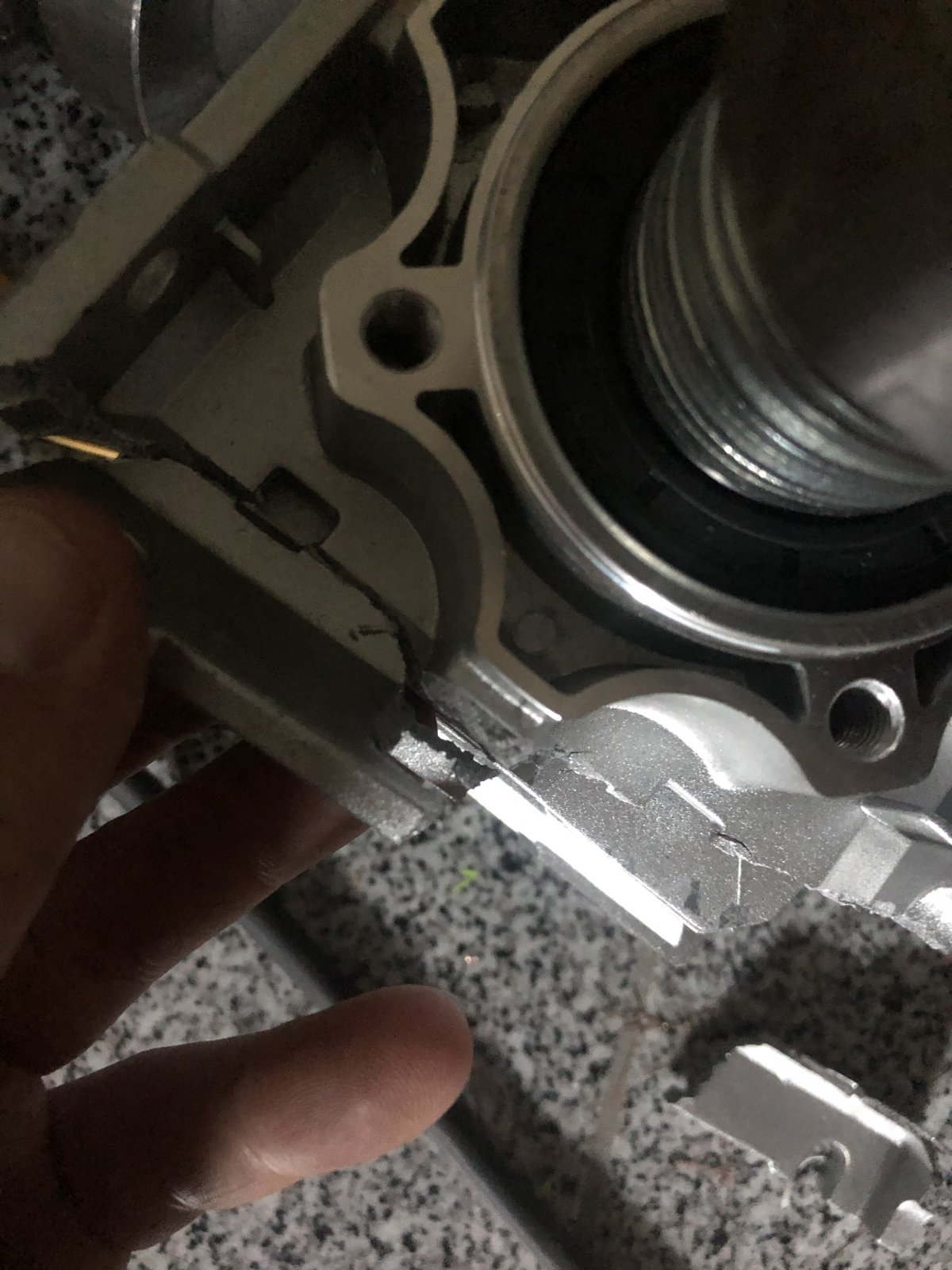

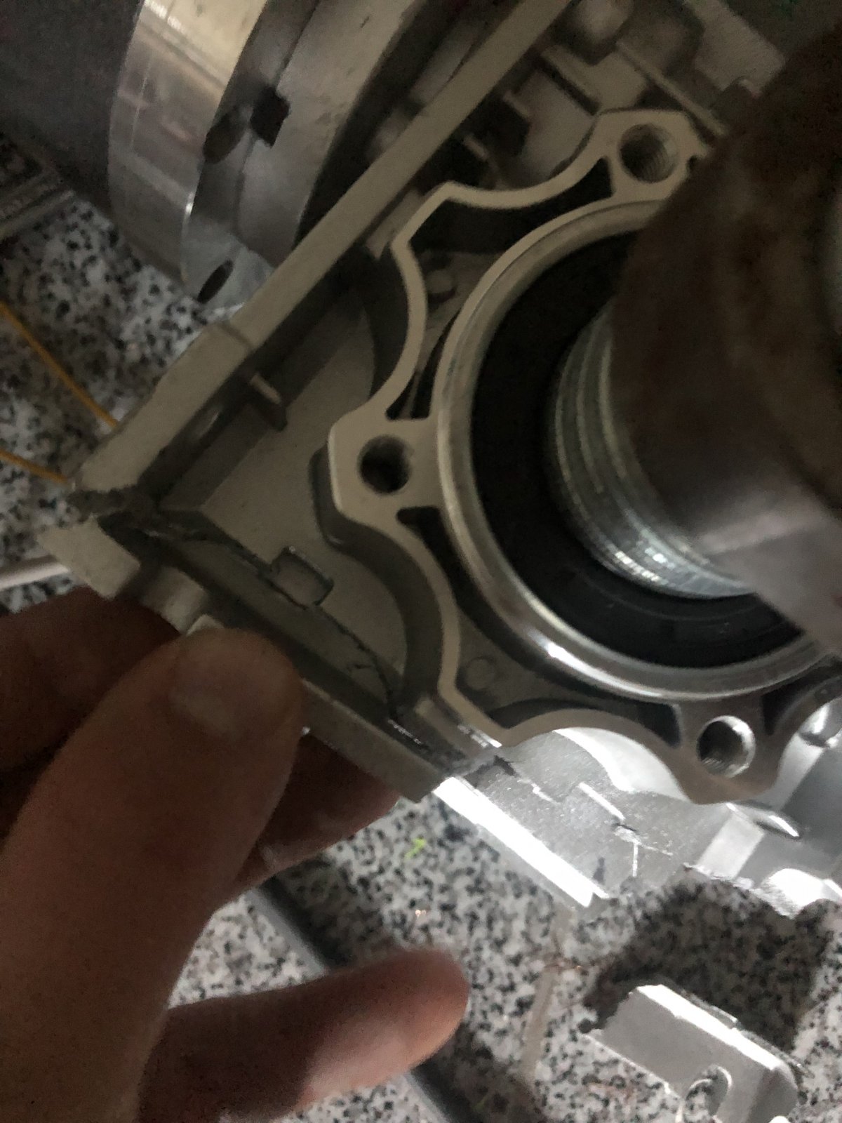

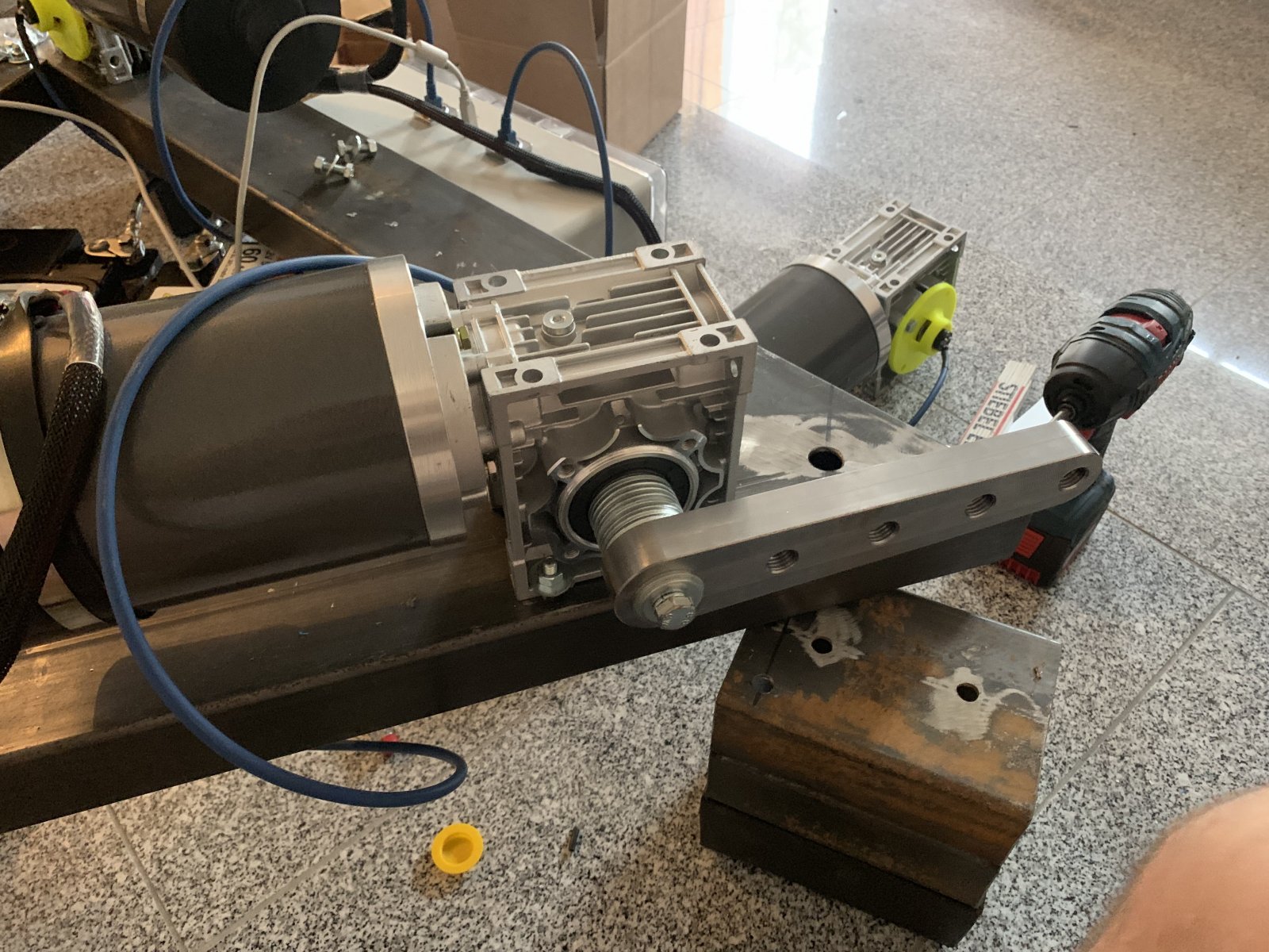

    After a loaded test i destroyed one gearbox -.-
    2FB783AA-3141-4244-B360-B117F621ECB0.jpeg 7BDF817D-C958-4026-9645-0419E1DF8847.jpeg 1F5AFC9D-6821-480A-AB30-DBB62E3A1E31.jpeg 85B09E56-B8A9-4B24-97AE-DF2776C71CCF.jpeg B74F1611-6BE0-4A6D-8676-2DA16CA3E843.jpeg 64B4683E-51F0-45CA-90EF-58F662CE9323.jpeg 100171AF-94E7-4BEB-96C9-29E1A2C33D56.jpeg

    That is a real tragedy.
    Was it just load or is there torsional flex at the mounts that contributed to the failure?

    The real tragedy is it appears to be made out of pot metal. :(
  18. Jürgen Schon
    Jürgen Schon Member
    Dec 6, 2018
    39
    57Coins
    +25 / 0 / -0
    The top rig hit the motor -.- and i was to slow to shut it down.
    A friend of me can weld it. ( he thinks so :D ) Inked6DOF SIM FAIL_LI.jpg
