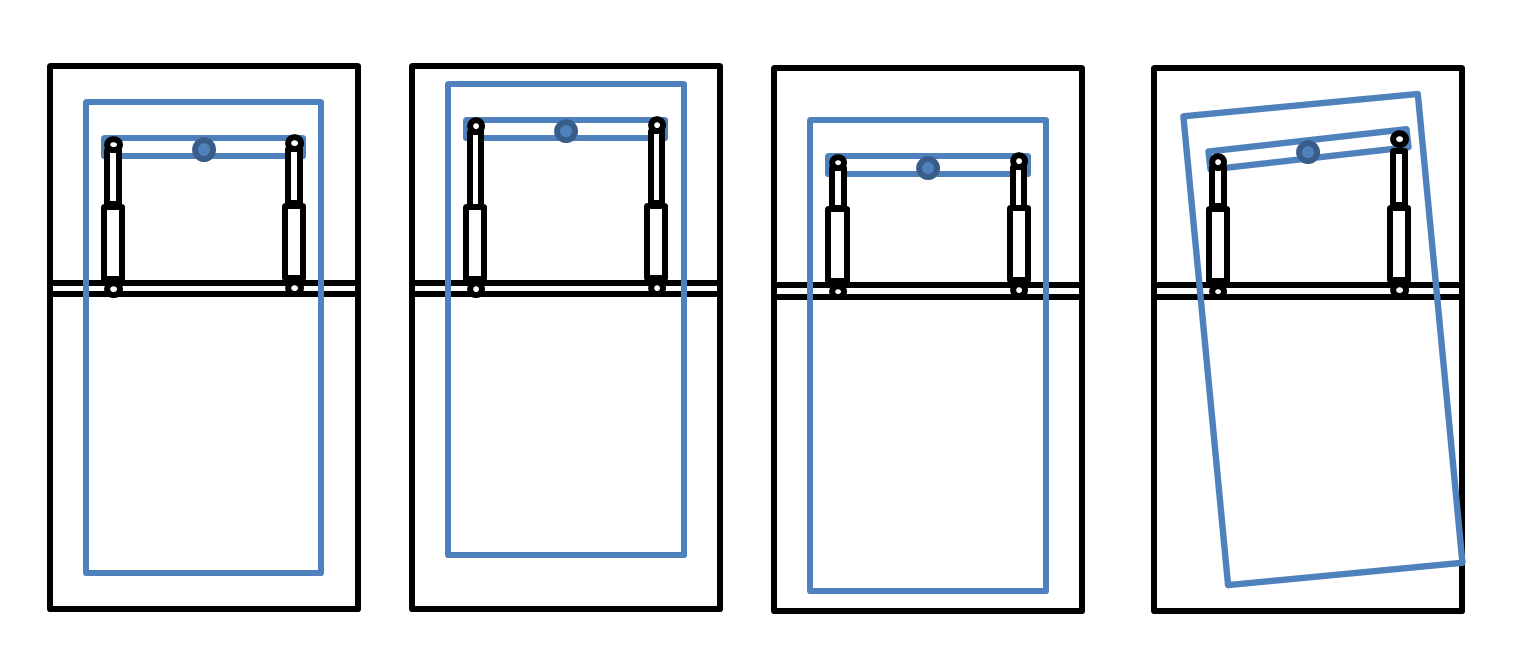

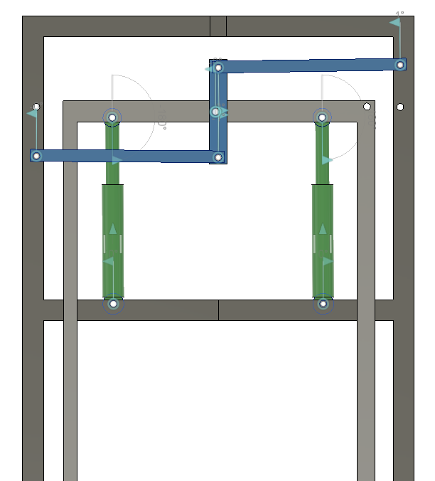

    I am in the design phase of a 5DOF racing simulator.
    The idea is a 5DOF rig with a 3DOF design as a base, D-Box style with 4 actuators as legs.
    One option for making a compact design is making a yaw and surge platform that is controlled with 2 linear actuators pushing on each side of a pivot point.
    When both actuators is activated in parallell its surge and when they are in opposite direction its yaw.
    Example in the attached drawing.
    I have tried to get into Simtools documentation to find if and how to accomplish this.
    6 actuators in total, 4 legs and 2 for yaw, surge.
    Thanos AMC-MDBOX is the controller.
    Is this possible and what would the settings be like?
    Anyone have similar experiences or any ideas?
    (I did a more complex design at first, then I did notice a discussion on the D-Box group on FB with this idea (not there anymore?)).

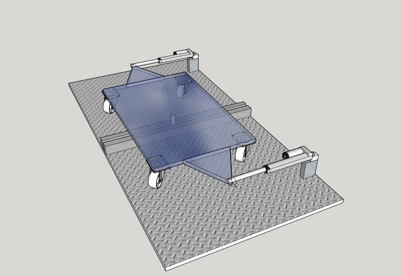

  2. Thanos
    Jul 6, 2017
    1,370
    Electronics Engineer
    United States
    2,848Coins
    +1,070 / 9 / -0
    Interesting idea, but I don't think it will work as intended... You are missing lots of support and guide points that are needed for such combined function. See a design below (slapped together in 10 mins....) that shows combined sway and traction loss. As you may notice, the base is free to rotate and slide, but held in place in three points from which one is a linear guide...

  3. Hocky
    Hocky Member
    Aug 30, 2018
    51
    126Coins
    +25 / 1 / -0
    Hi Thanos,
    Thanks for your input, I hope production of the controller is going as planned!
    I know the linear guide that has to be in the design, no problem there, its in the design but not in the professional powerpoint drawing :)
    Have not tried it in 3D yet. Maybe I could skip the linear guide if I put the actuators in an angle in or out. Would make some minor unwanted movements probably.
    I did have more problems how to design for the seat belt mounting points.
    Got a design that makes it possible to mount them on the top platform (with the legs) or on the yaw/surge platform.
    Makes the belts tighten on just the surge or surge + leg movement...what is most realistic, probably just surge?
    My initial worry is if Simtools can handle the design of the yaw/surge?
    Thanks!

    Try 3D design, one that has some physics if possible so you can move the objects and visually see the issues and what you need to do to get proper motion.
    I'd suggest against using belts, especially attached on servos... These beasts can produce too much force that can be dangerous for seatbelt application (broken ribs etc...).
    Simtools can mix any axis or motion cue type. with proper mixing axis you can achieve correct motion cues for any type platform.

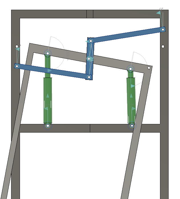

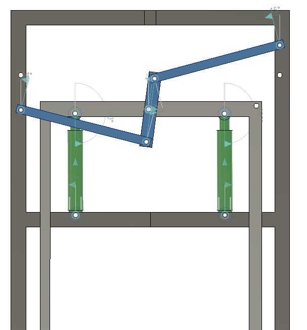

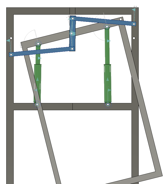

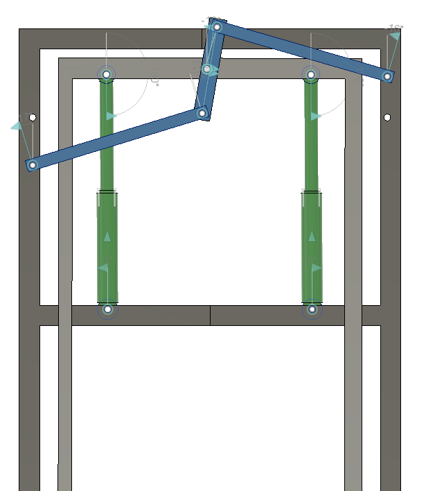

  7. Hocky
    Hocky Member
    Aug 30, 2018
    51
    126Coins
    +25 / 1 / -0
    This is one of the ideas for linear motion control.
    This design I know from building car racing rear suspensions, a Watt linkage.
    Should be rather simple, stable and cheap.
    Could also be done with a linear guide bearing, some simple other guide...
    Regarding the seat belts I need to make shure there are some springs, rubber band or something that takes care of the ribs, before breaking them :)
    (is there a way in Fusion 360 to do a motion study export to movie?)

    Just as a data point: Next Level Racing has a new commercial system using this sort of approach, though they've put the actuators the other way around so that they produce sway instead of surge, and can also do traction loss:
    It looks like they have a rigid base with linear actuators moving in fixed channels, and then at a guess the platform might attach to the actuators with a bearing in the front and some sort of slot in the back?

    I really don't think that would be possible to have both surge and traction loss, you will face lots of technical challenges to make it work.
    Sway and Traction Loss, yes, as you can see in the video, it does exactly what I presented above in the simplified design I made with the two actuators push both front and back of the platform, in unity to create sway, and the back alone for traction loss.
    For Surge, perhaps you would need another "layer" that will move the whole platform front-back. I say layers because that's what you essentially need for this:
    Top layer: 4DOF actuators mounted vertically for Heave - Pitch- Roll.
    Middle layer: 2DOF actuators mounted horizontally for Sway - Yaw (Traction loss)
    Lower layer: 1 actuator mounted horizontaly for Surge.

    For the record I have not gone thru with this idea because of the intertia of the movement.
    It will be alot of weight on the rear of the rig and the actuators need to push all that.
    Maybe not a problem but I will go for a more conventional style with one actuator in the back for traction loss.
