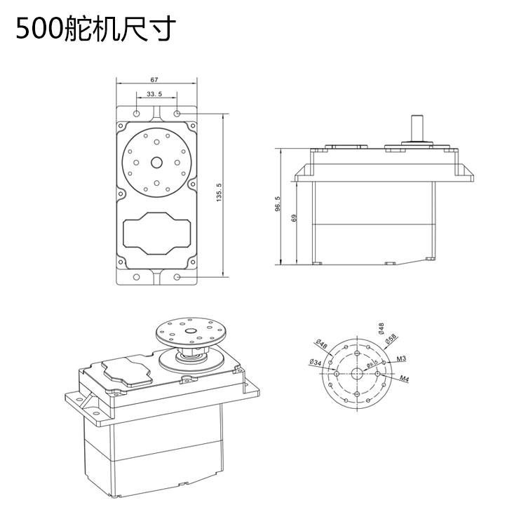

    Well it's encouragingly chunky. I emailed the suppliers to get dimensions. Compared to my KingMax 65kgcm, which is 66mm*30mm*57.5mm, this one is 135.5mm x 96.5mm x 67mm.
    Is it crazy to think of using this for a platform, not just a g-seat? With a 10cm lever, 120 degrees of movement would give 20cm vertical displacement in 1 second and it could cope with 50kg. I don't know what the real speed would be with a load of 50kg, but on a 6DOF and a platform weight of say 150kg each would only need to lift 25kg.

    Parameters are great. But I think there can be issue with overheat in closed case.
