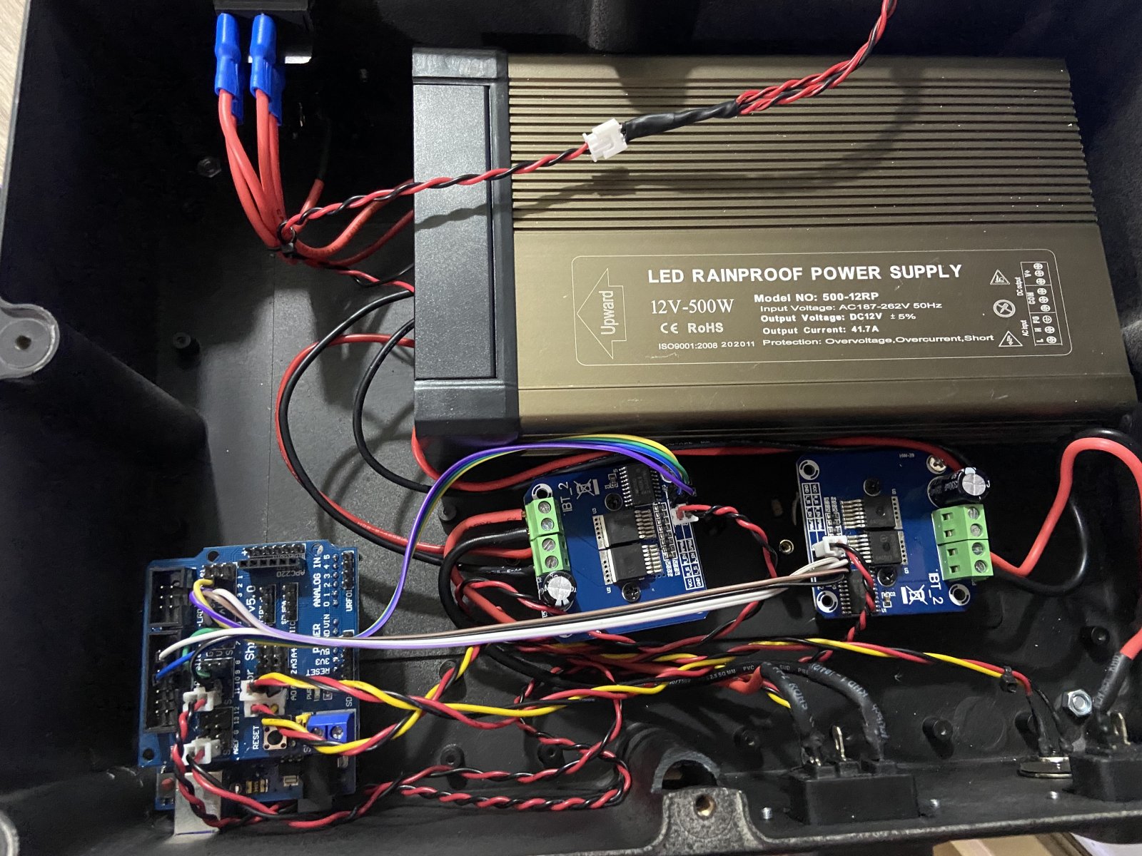

    Hello guys, I am LeTrung and I am from Vietnam .sorry about my English.
    Few years ago I was built 2 DOF motion simulator, It's working perfectly and I was very happy. This is my last 2 DOF Simulator :
    Now I am building my simulator with 5 of DC motor 12v for 5 DOF (Surge/Sway/Pitch/Roll/Heave)

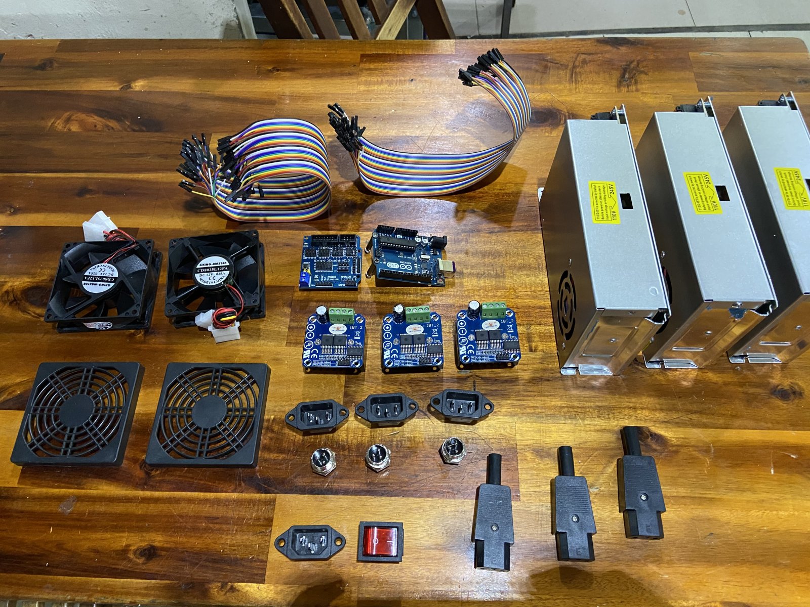

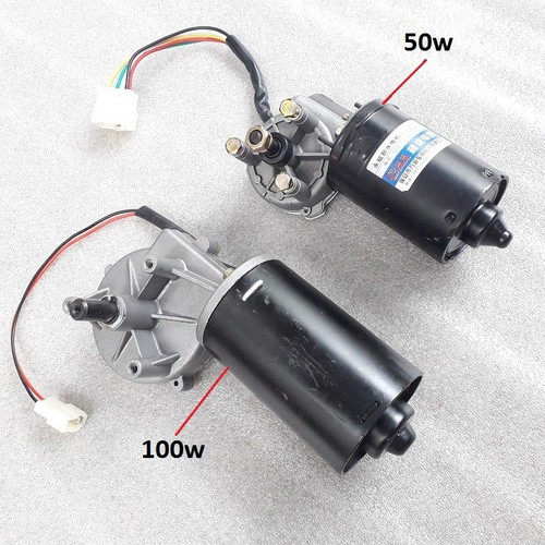

    My components :

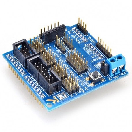

    -2 x Arduino Uno
    -2 x Arduino Sensor Shield

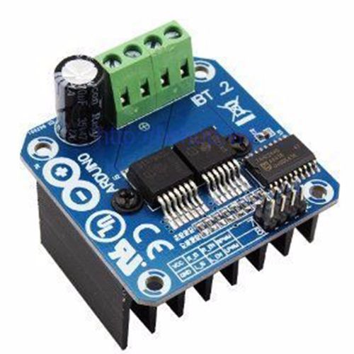

    -5 x ITB-2 motor Drive 43A
    -2 x 12v/50w Wiper Motor & 3 x 12v/100w Wiper Motor

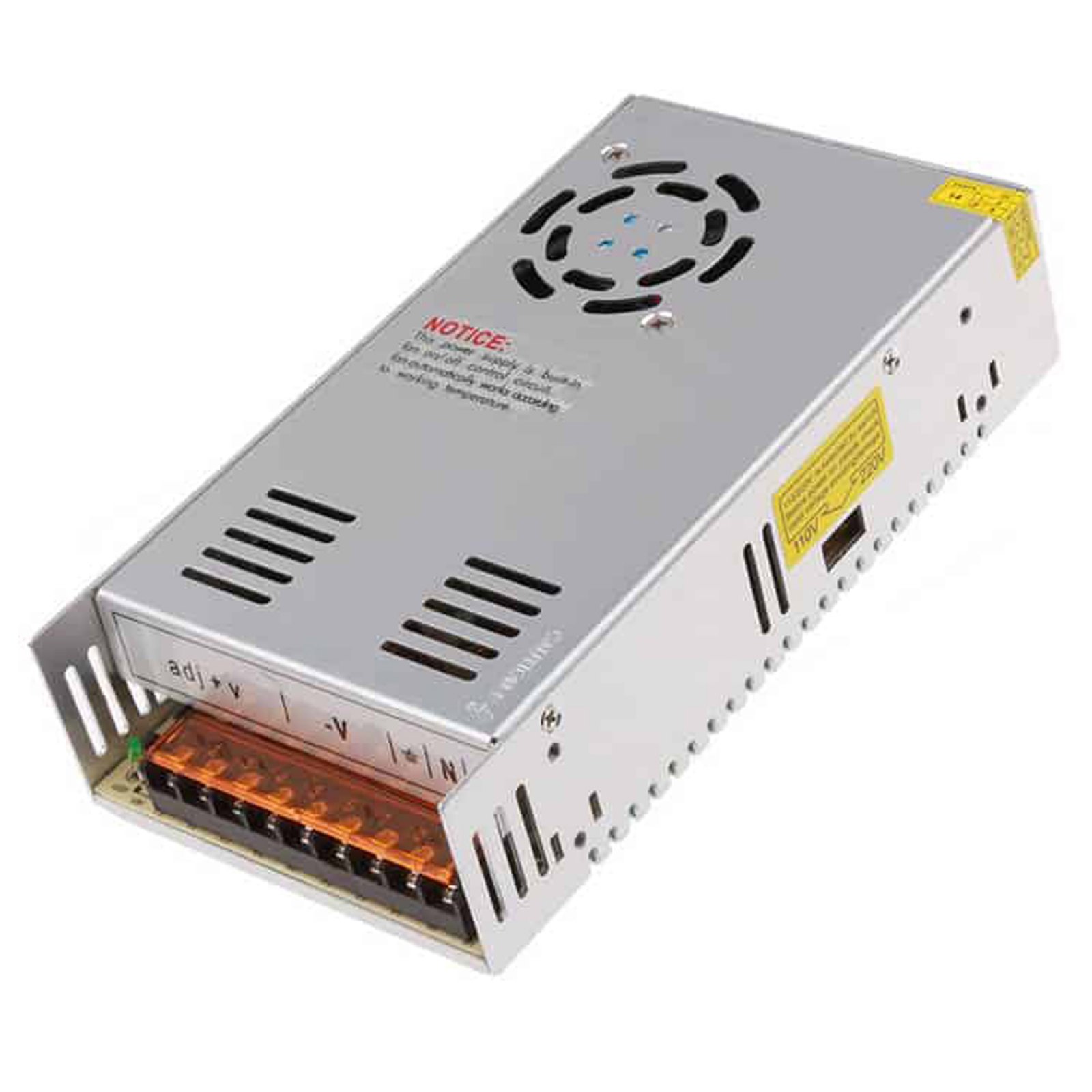

    -1 x Power Supply 500w & 3 x Power Supply 240W
    - SMC3 code and software
    - Simtools
    - 40x40 box steel
    -30x30 box steel
    ... and more !

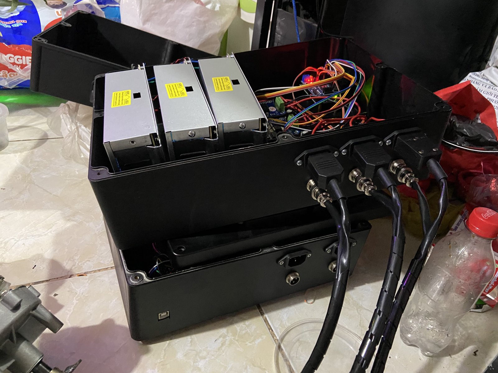

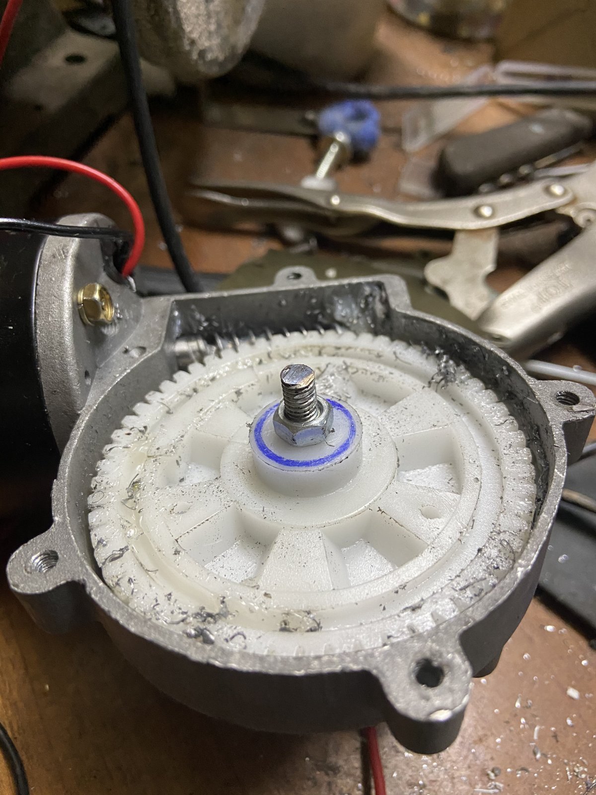

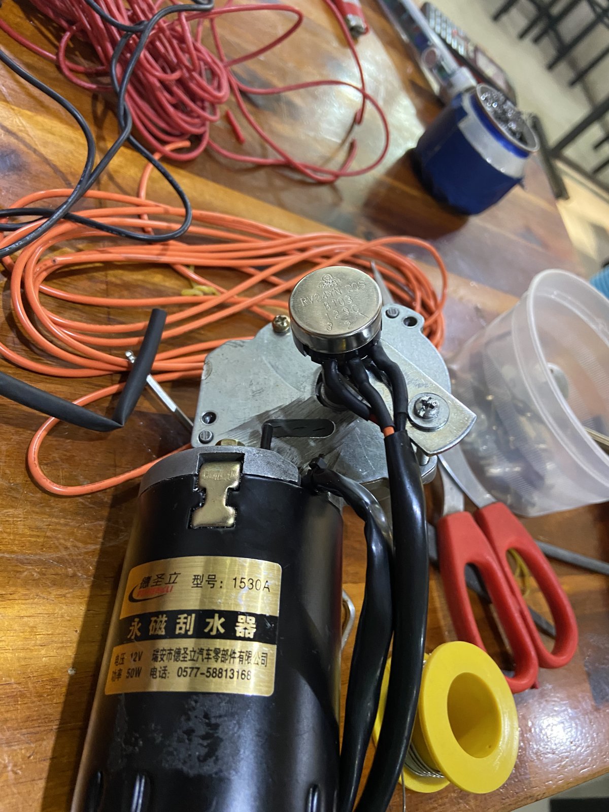

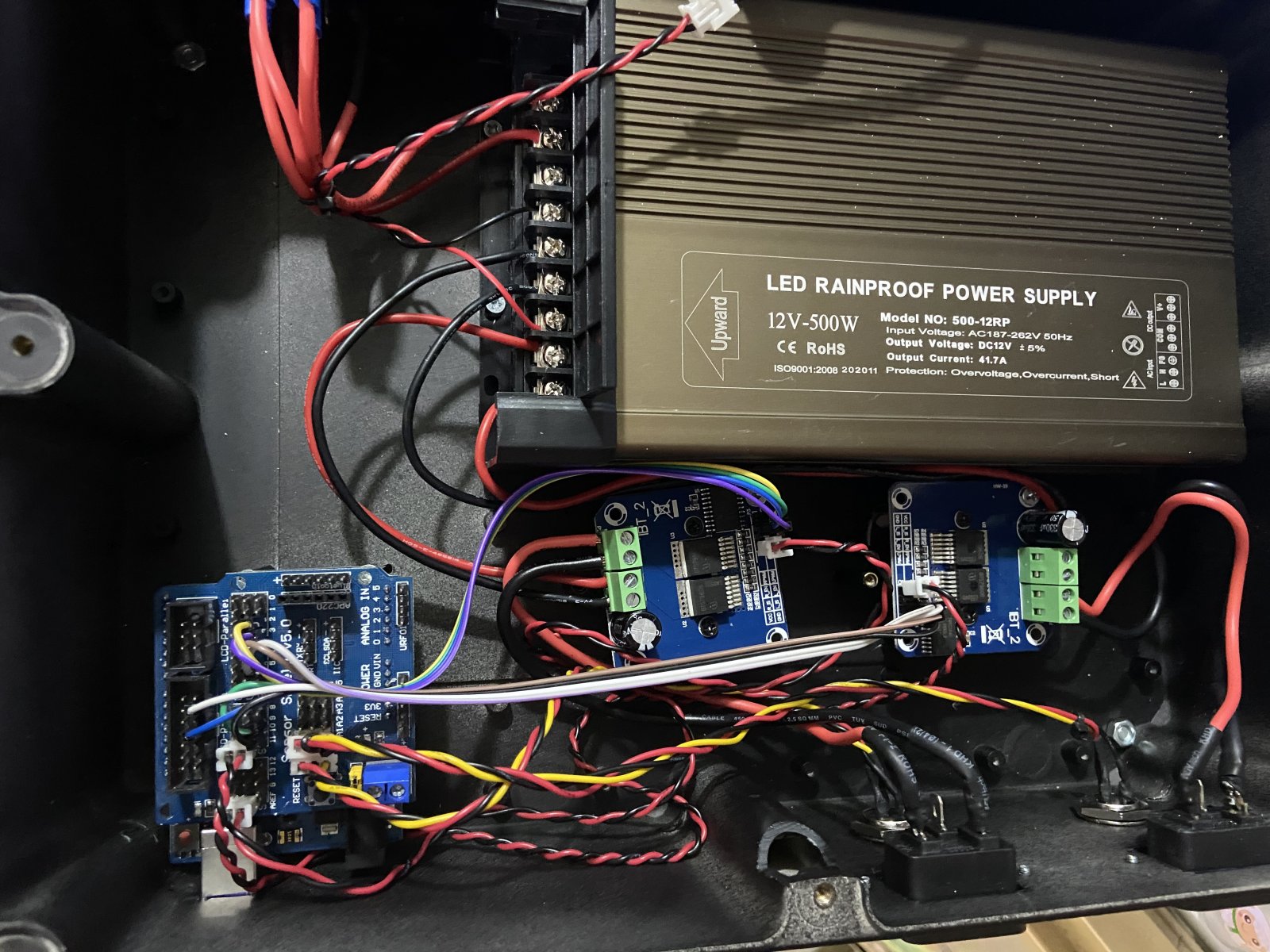

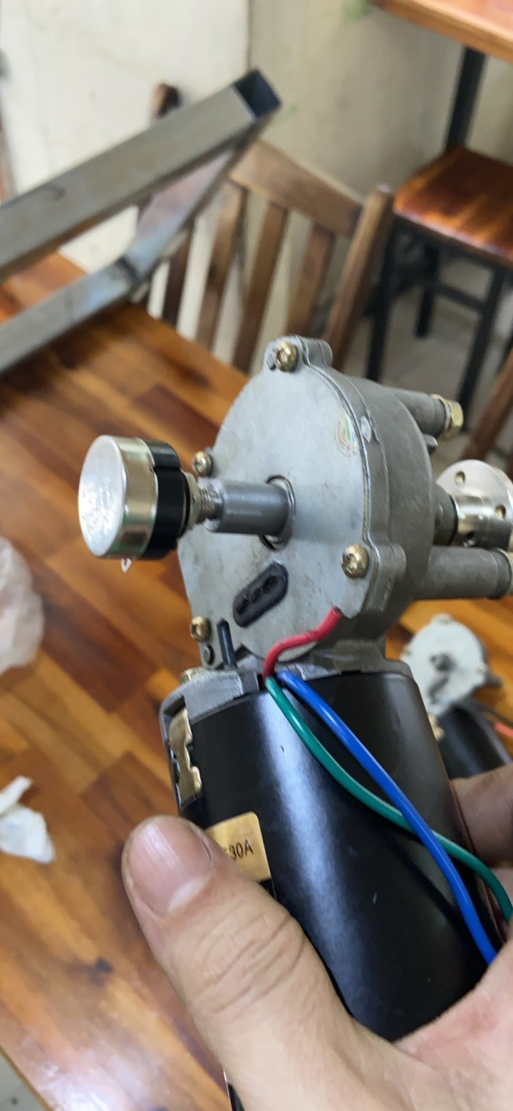

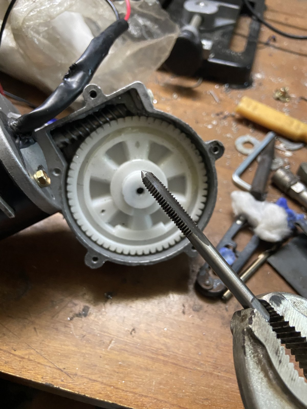

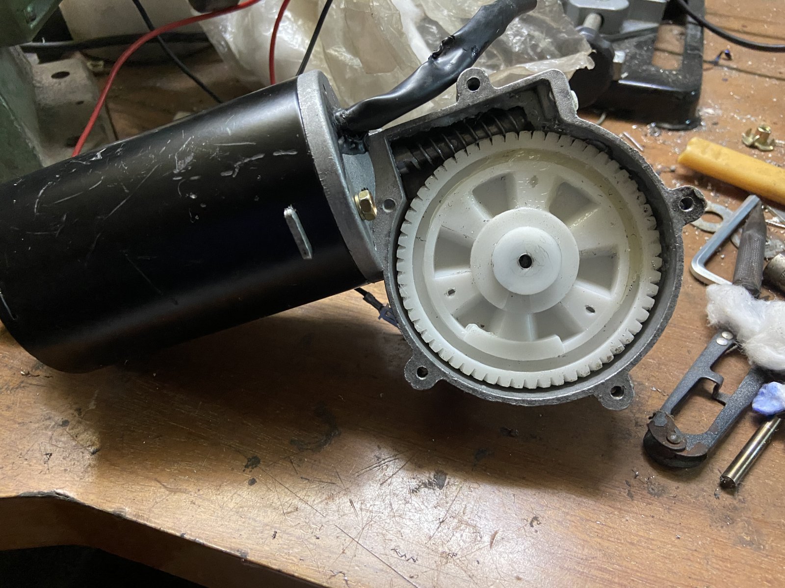

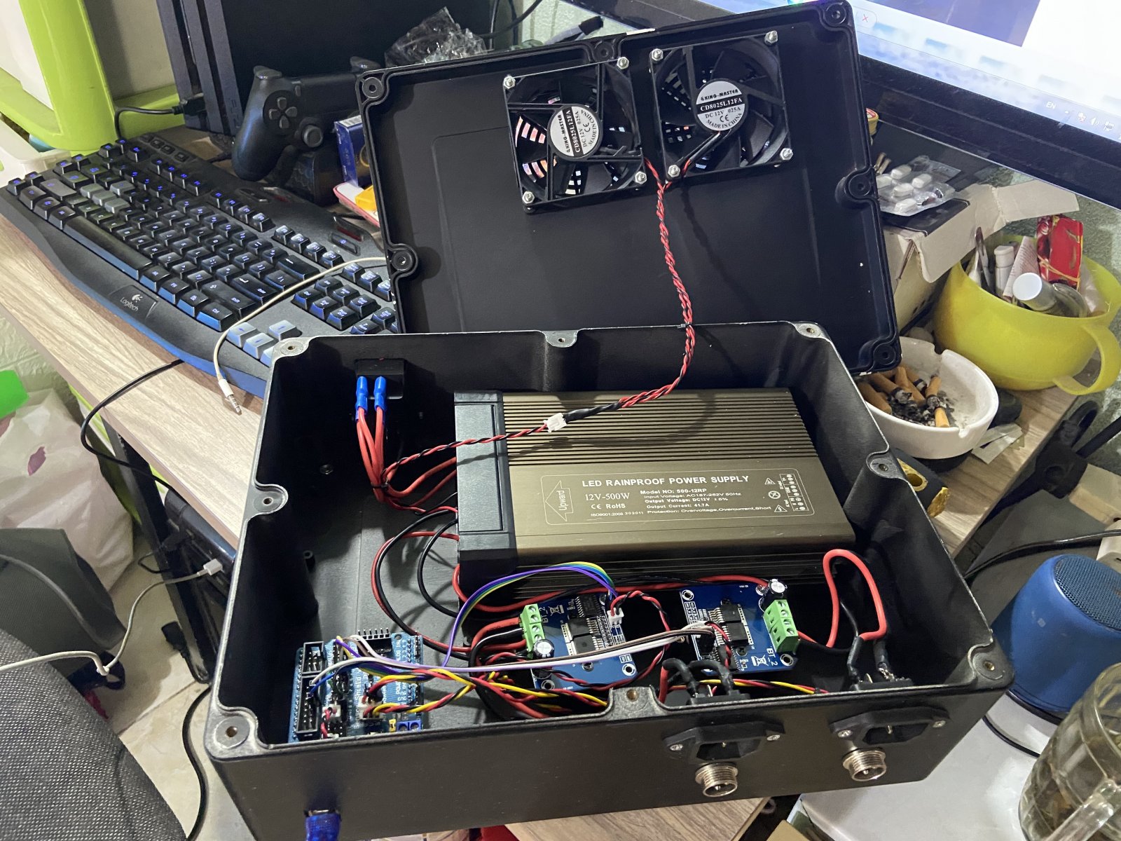

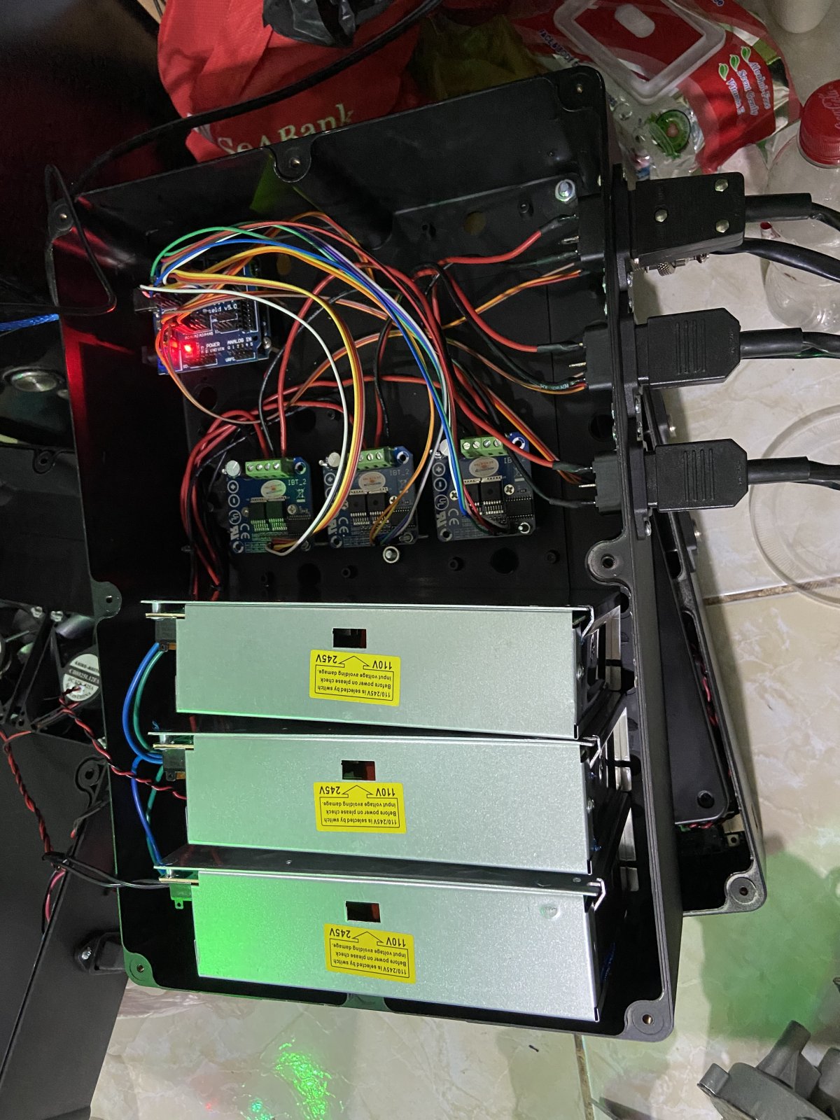

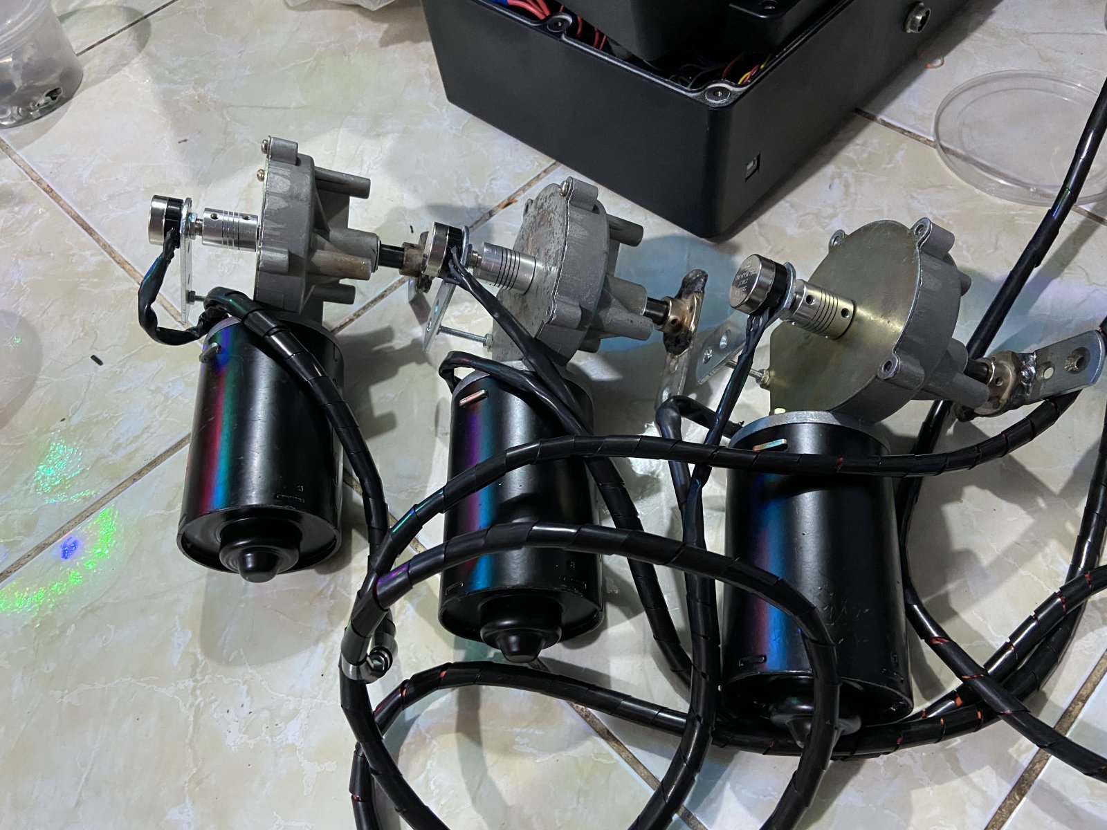

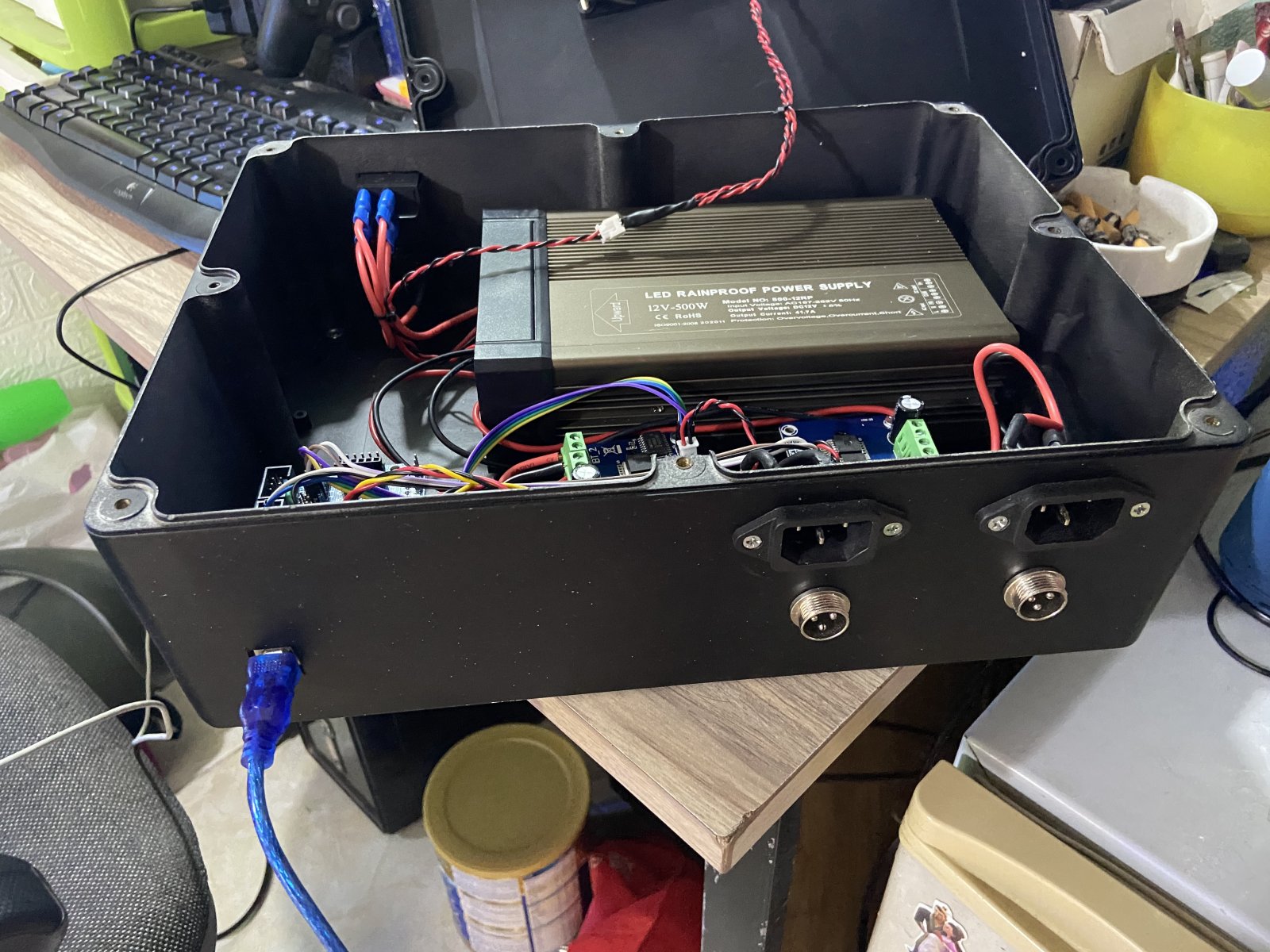

    1- Building Box Controller

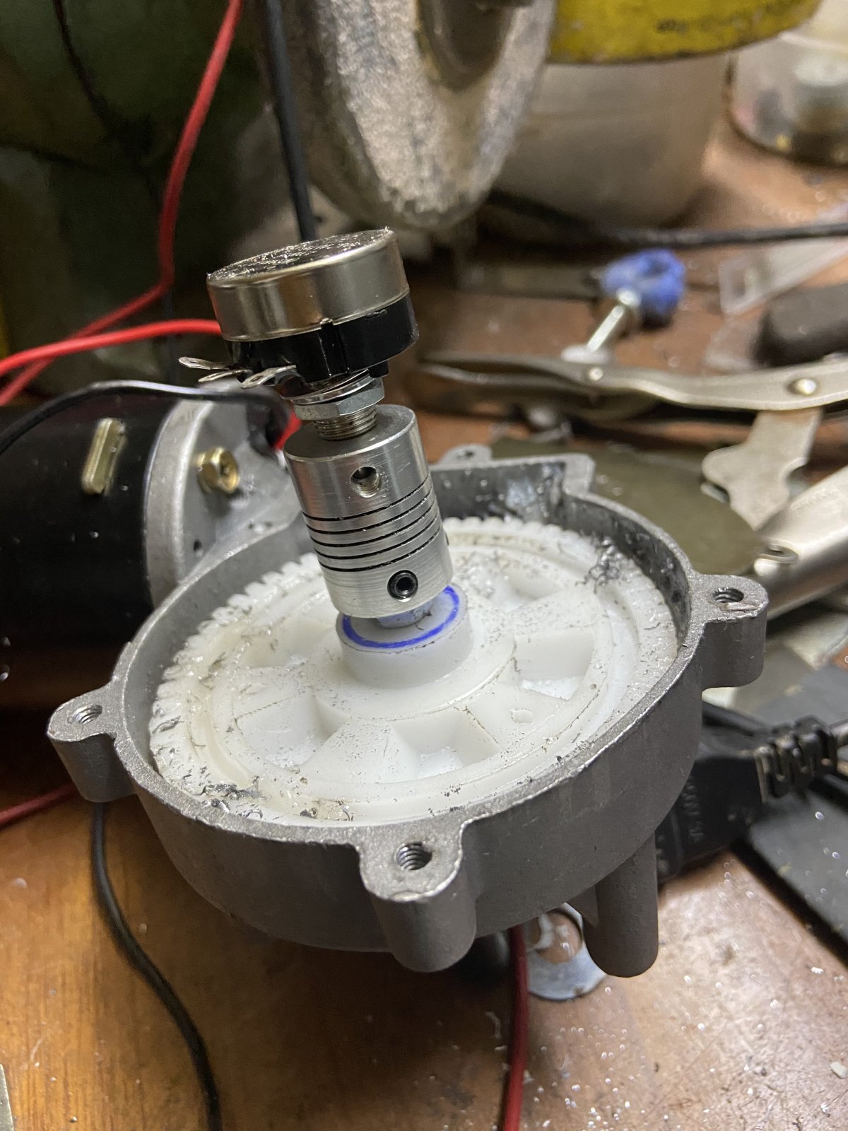

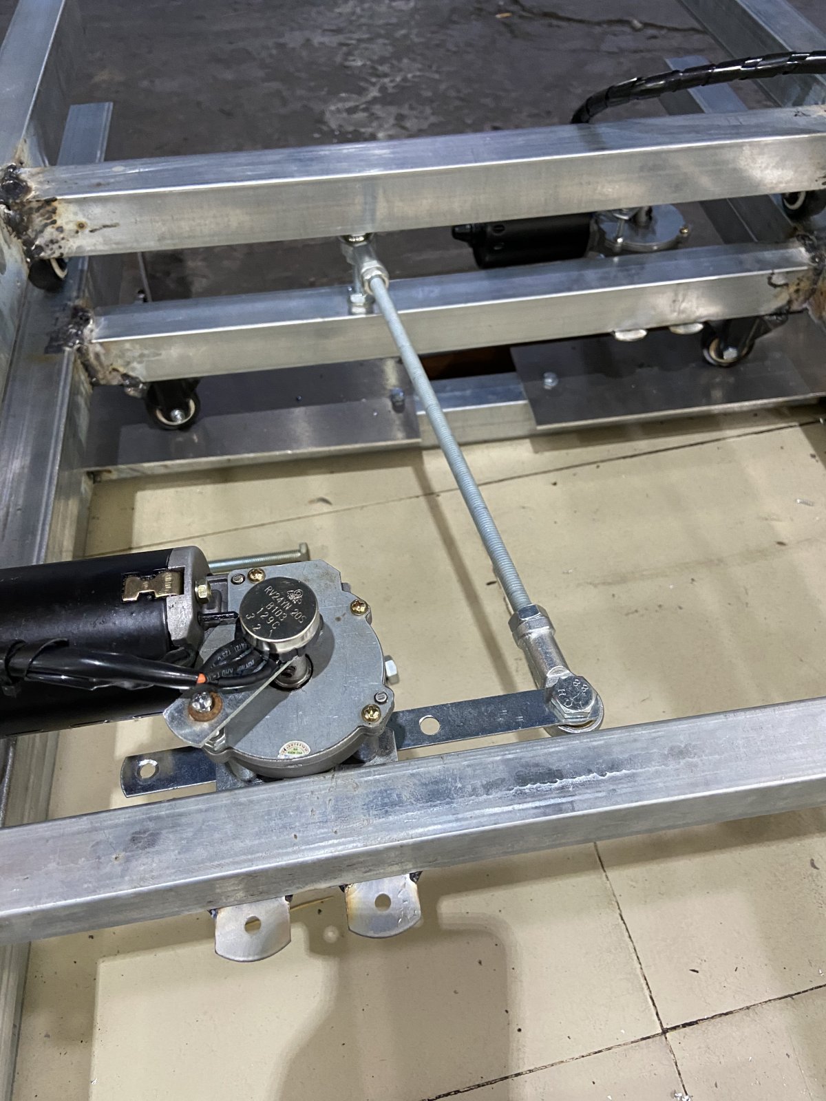

    2- Attach

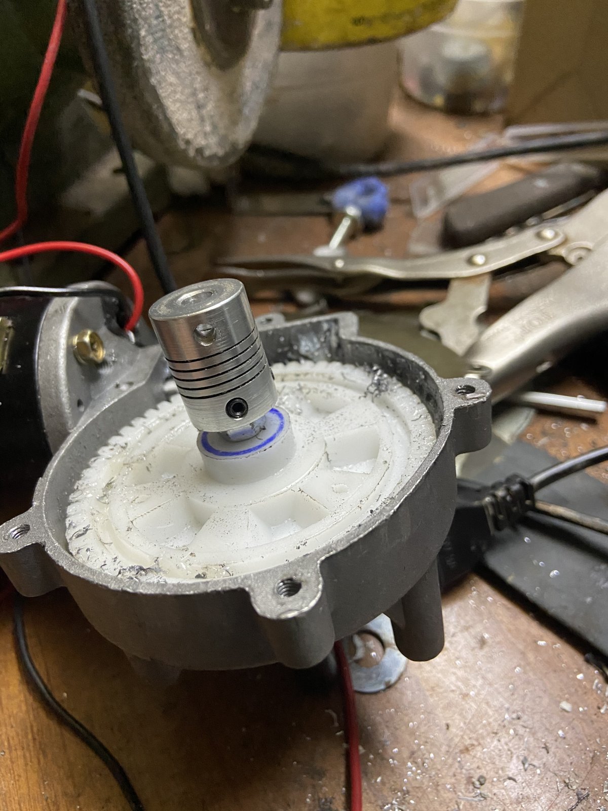

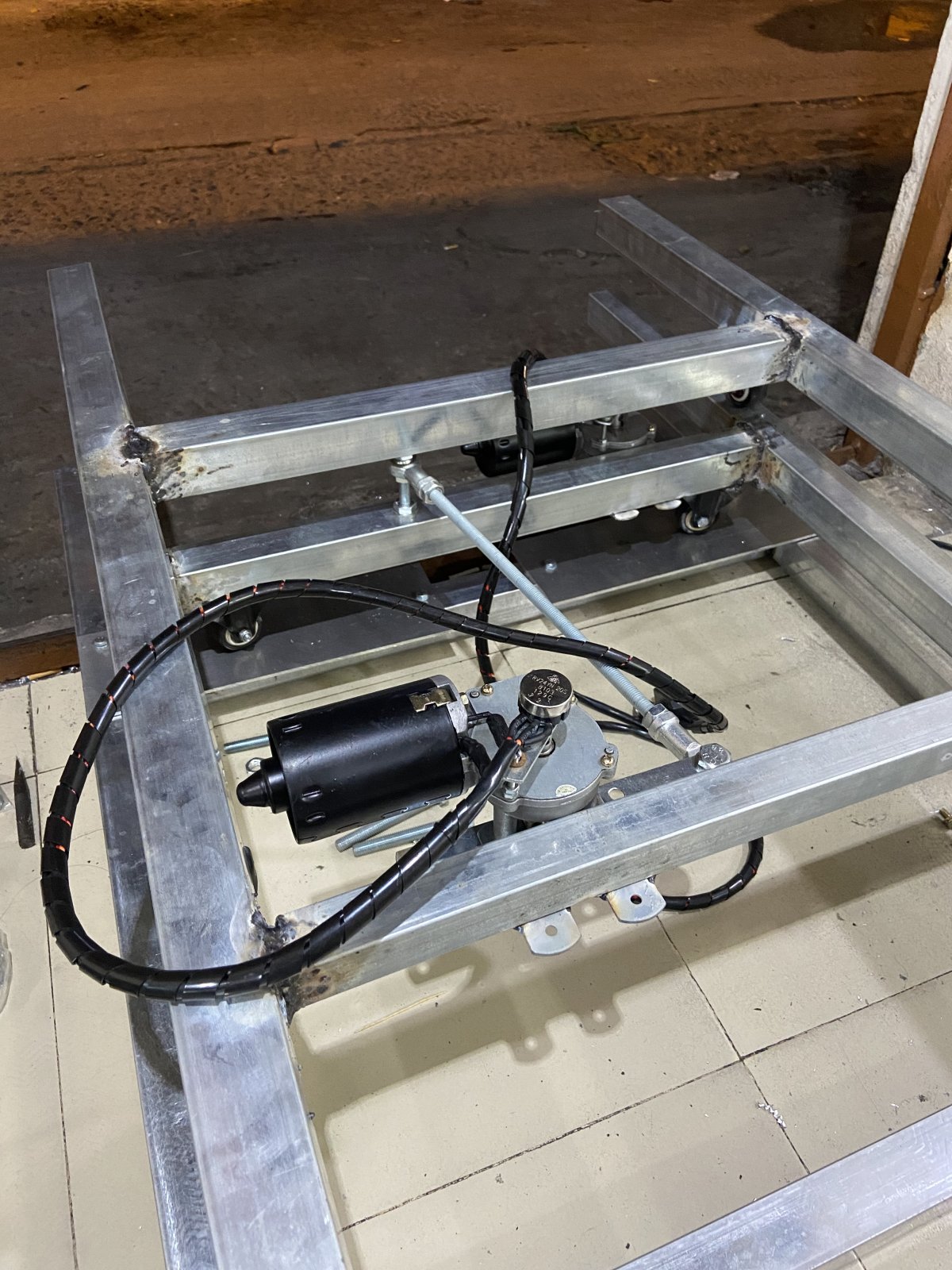

    potentiometer with motor 12v/50w :

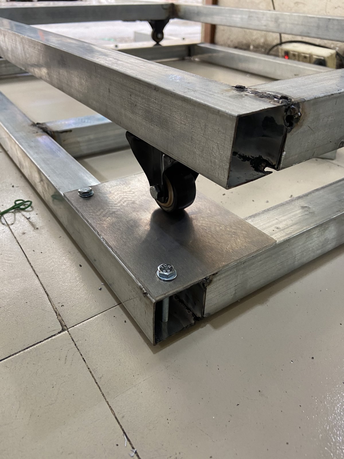

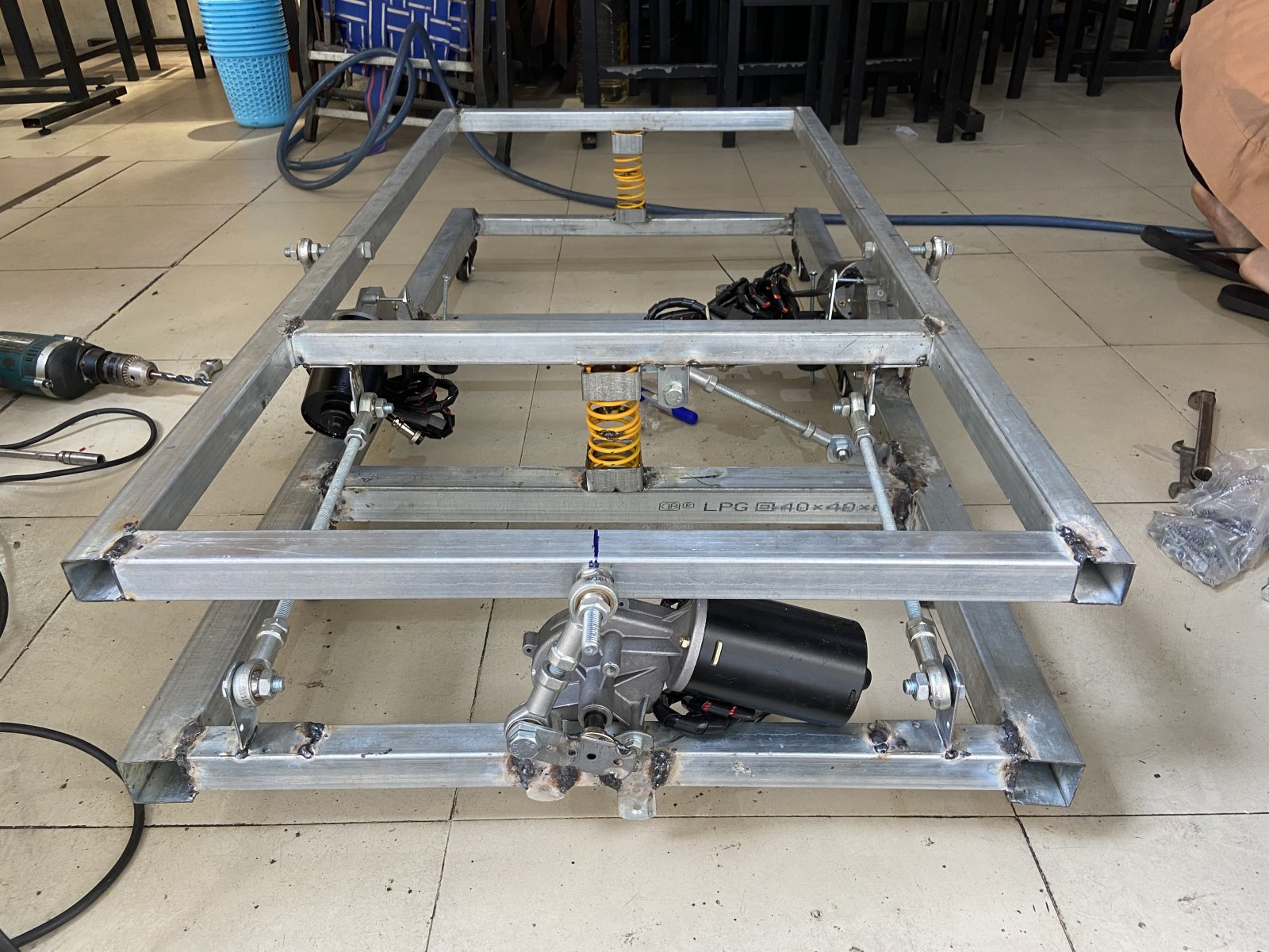

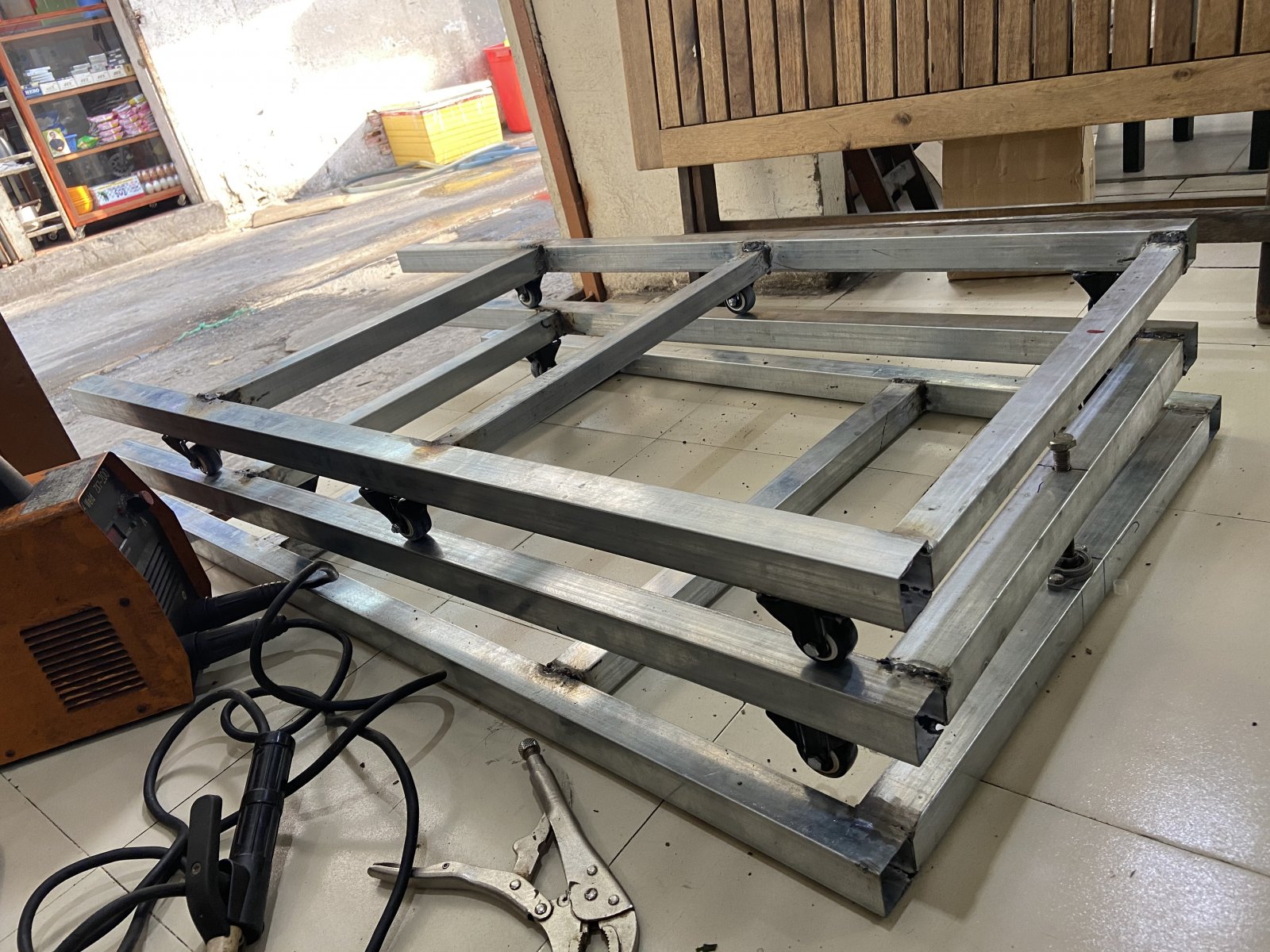

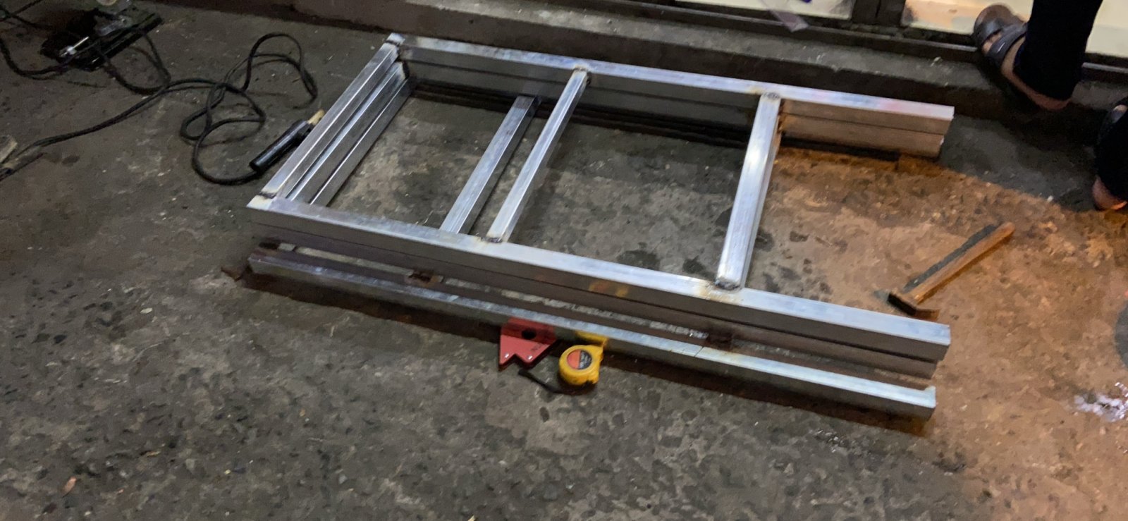

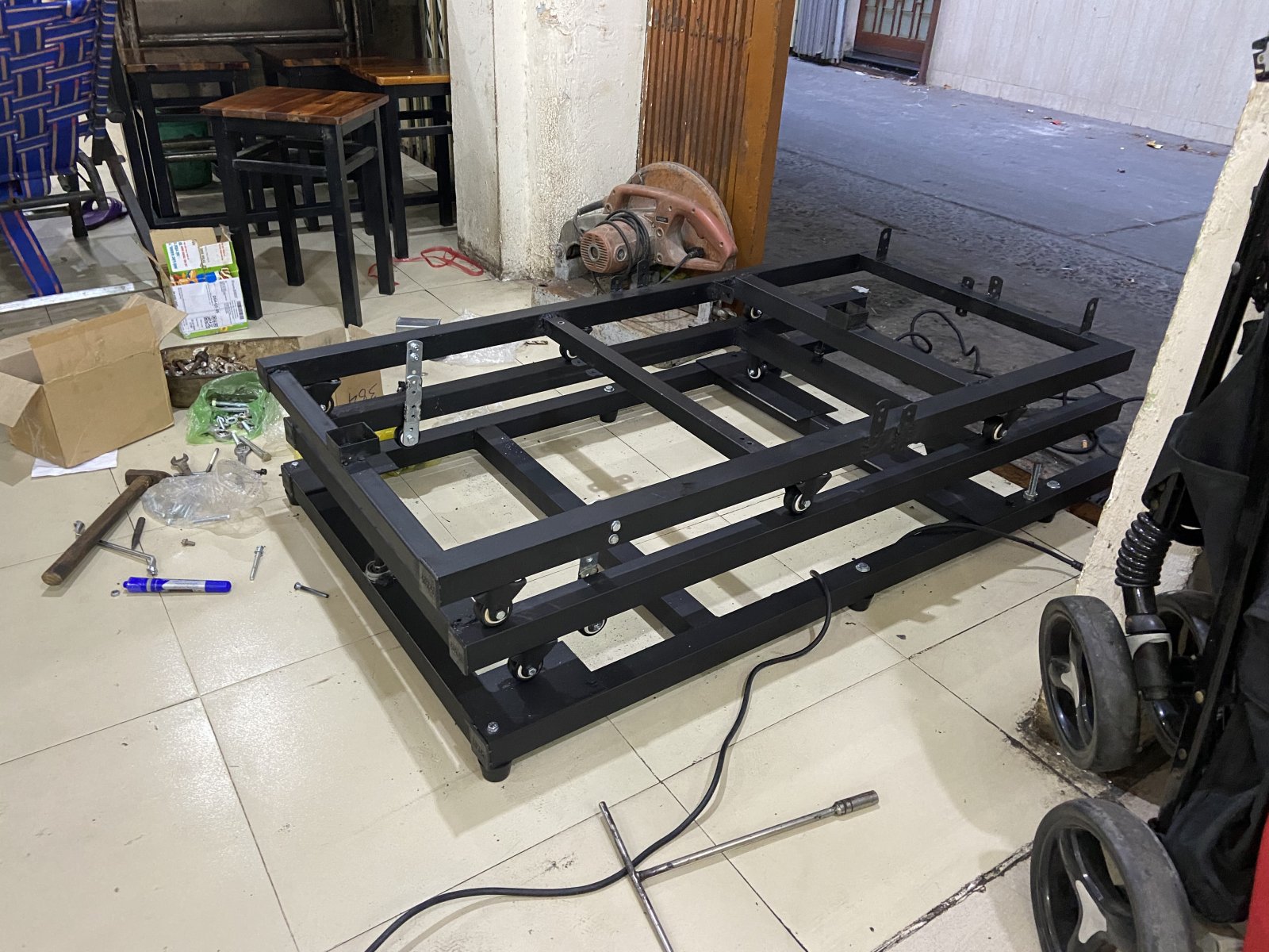

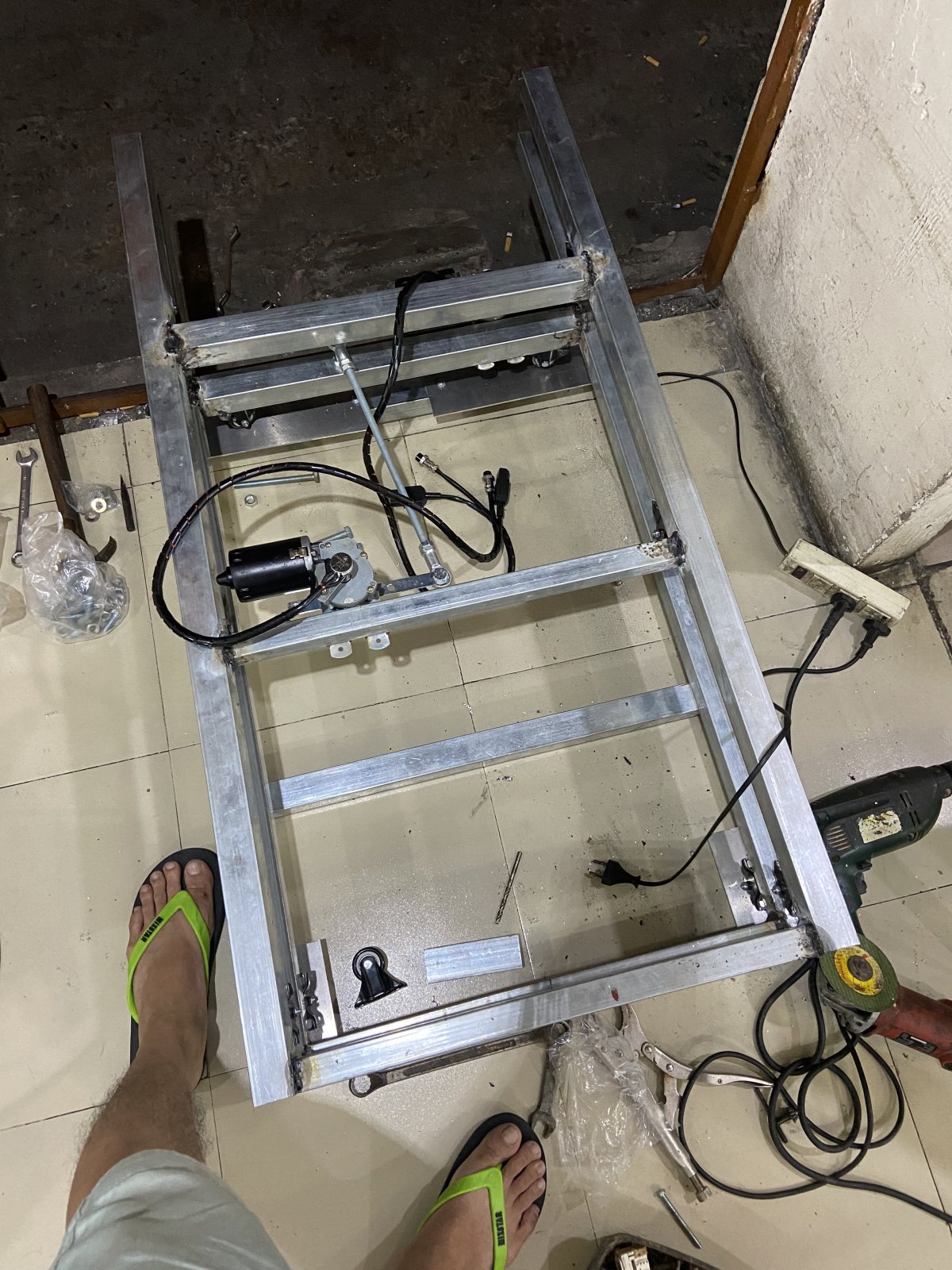

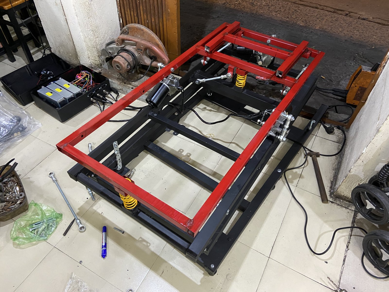

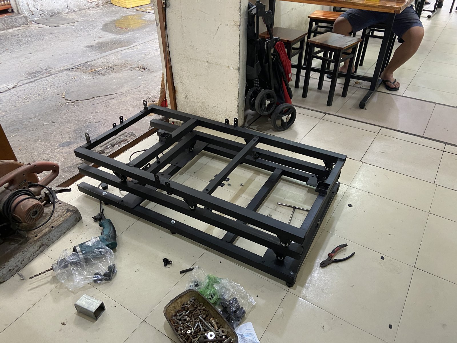

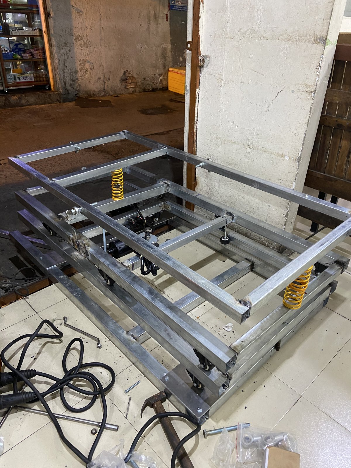

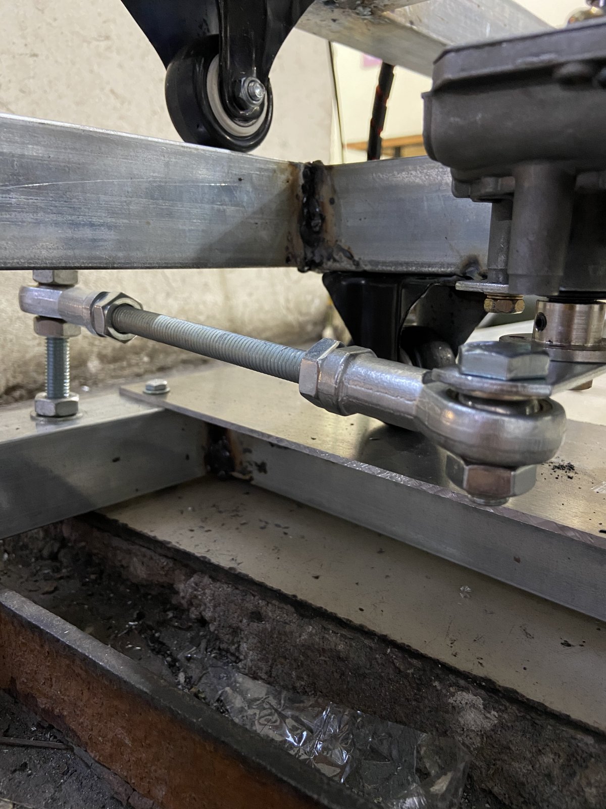

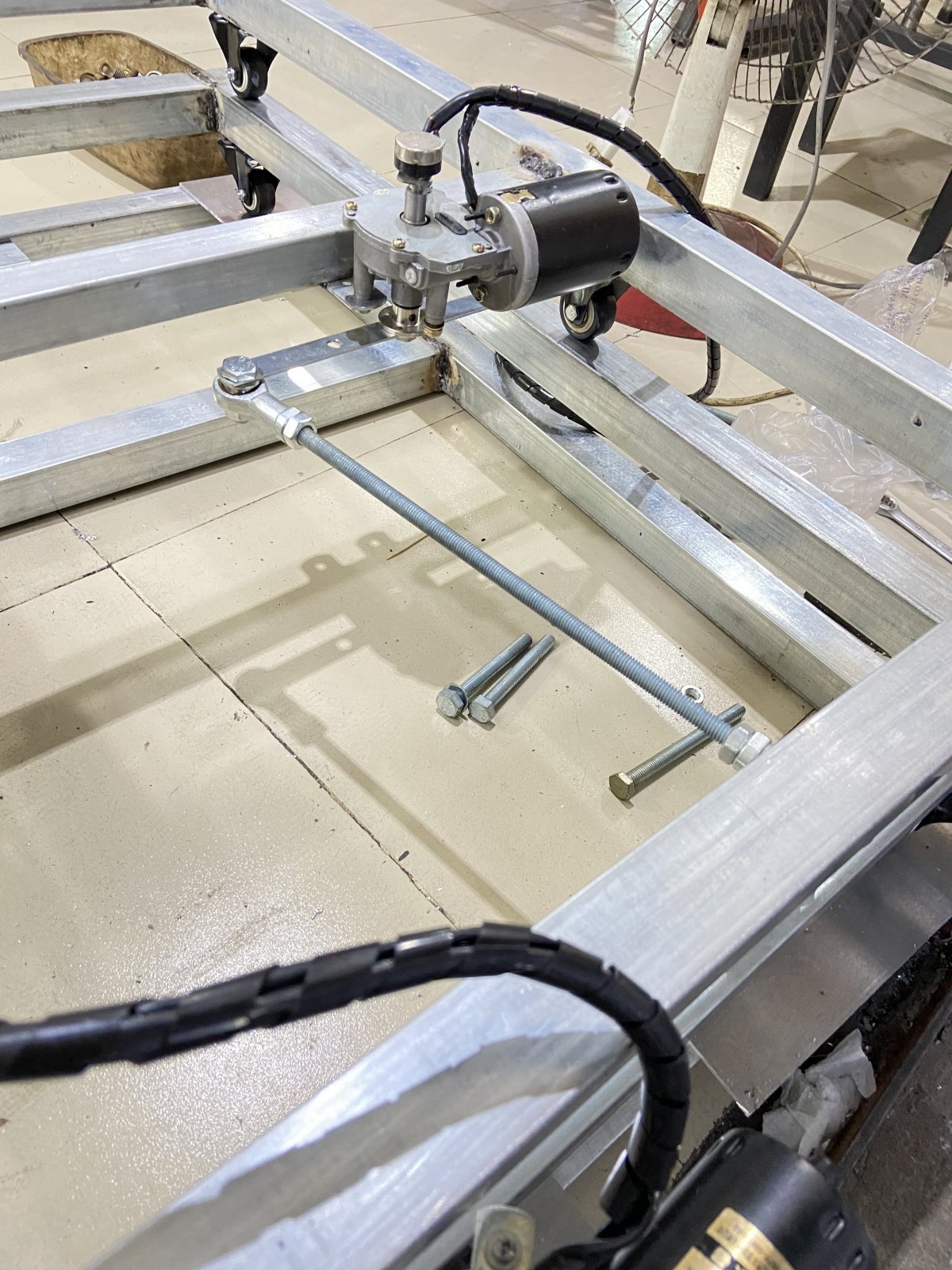

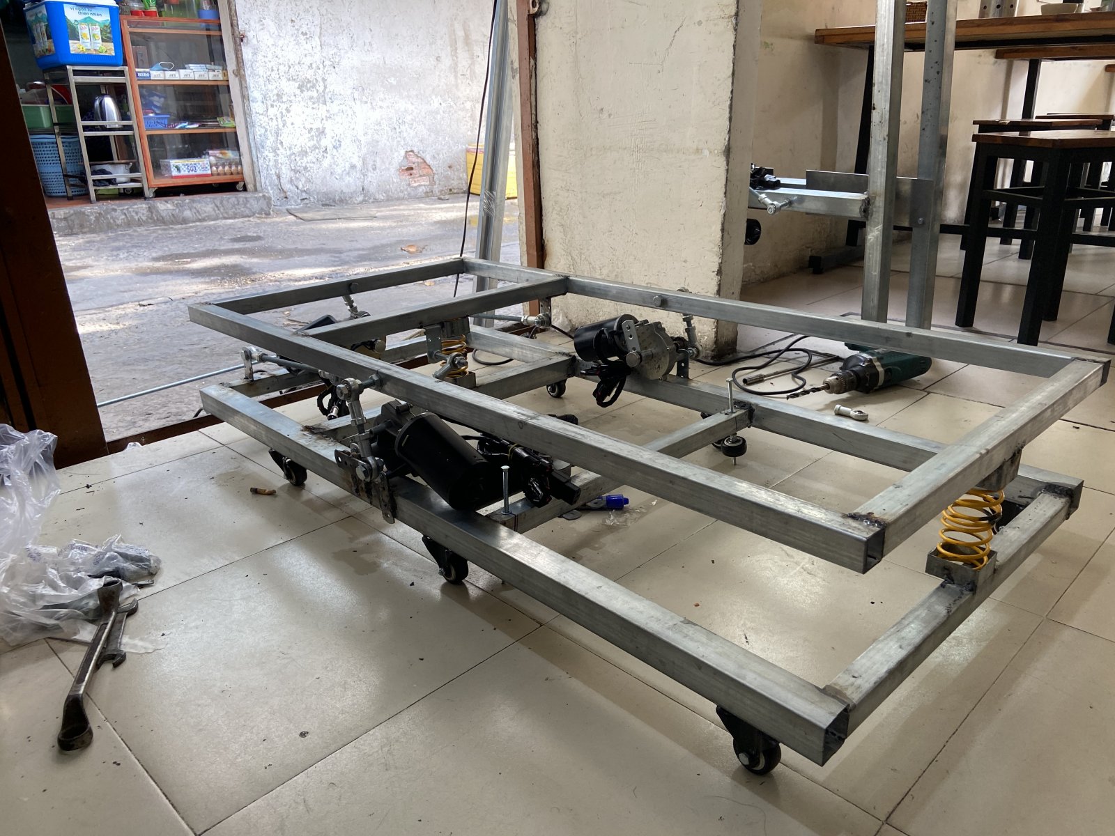

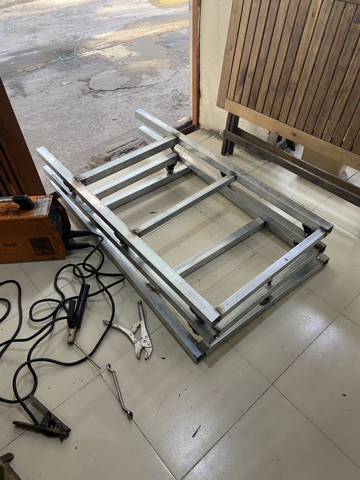

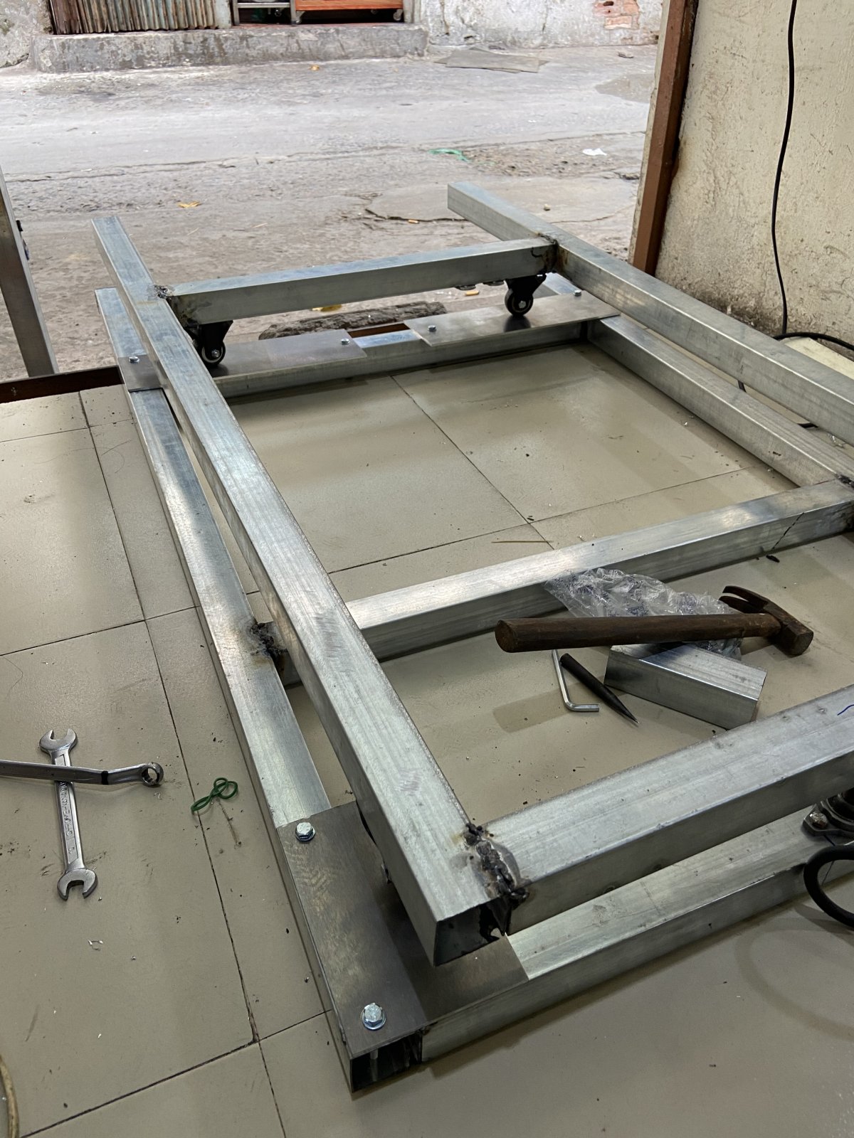

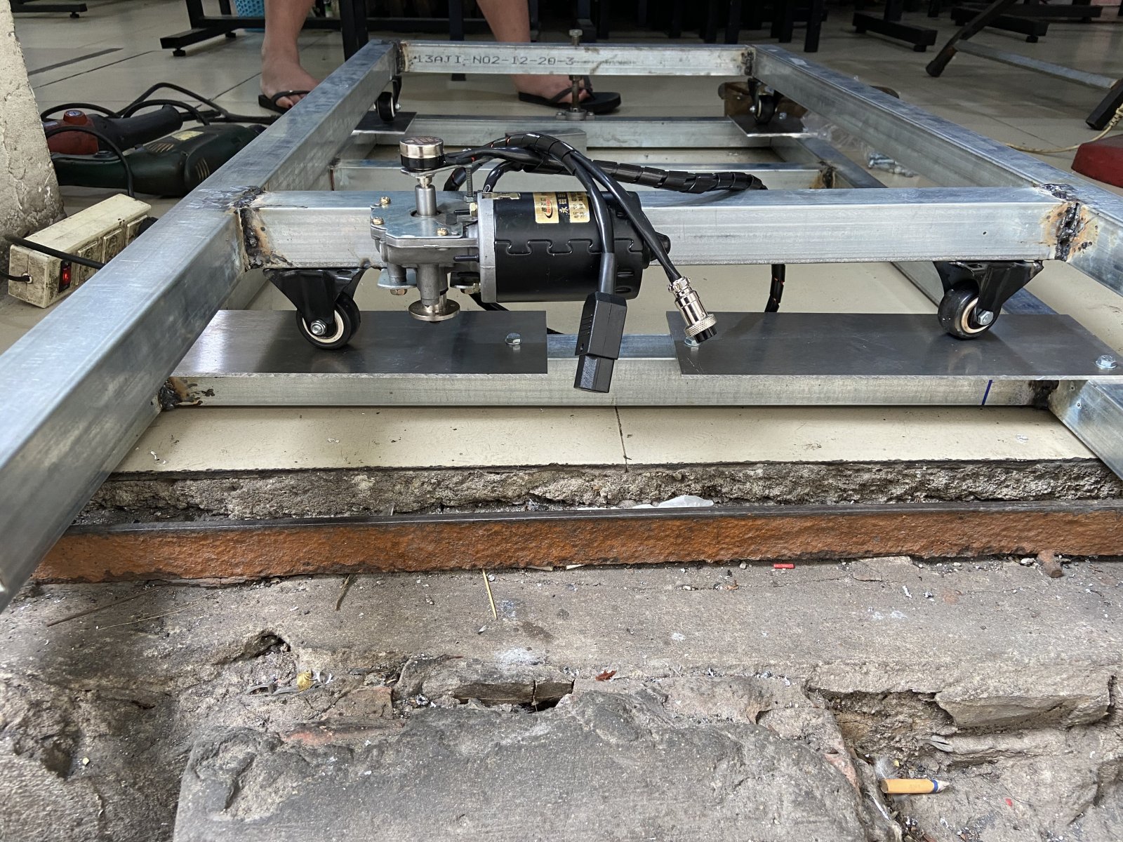

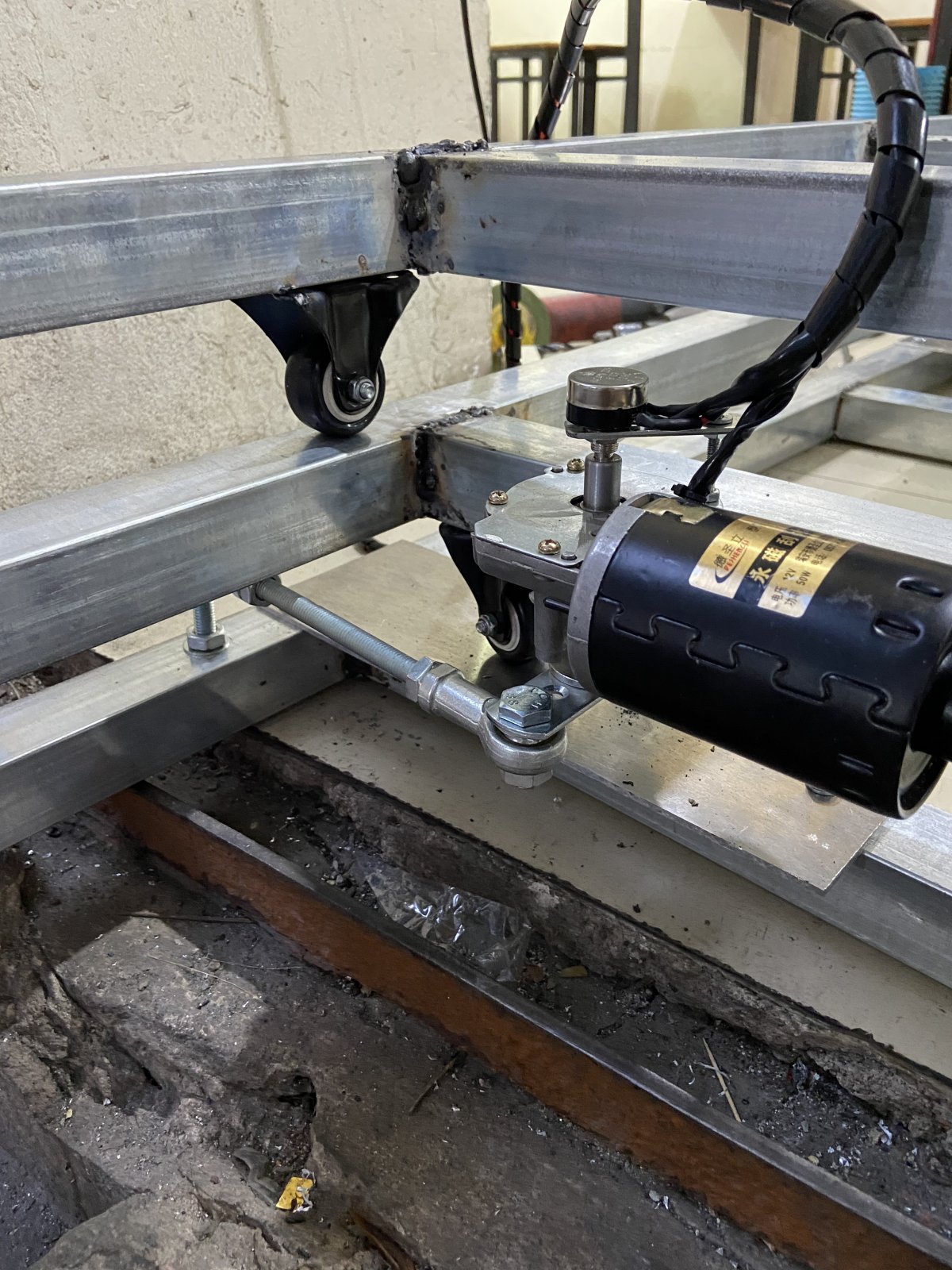

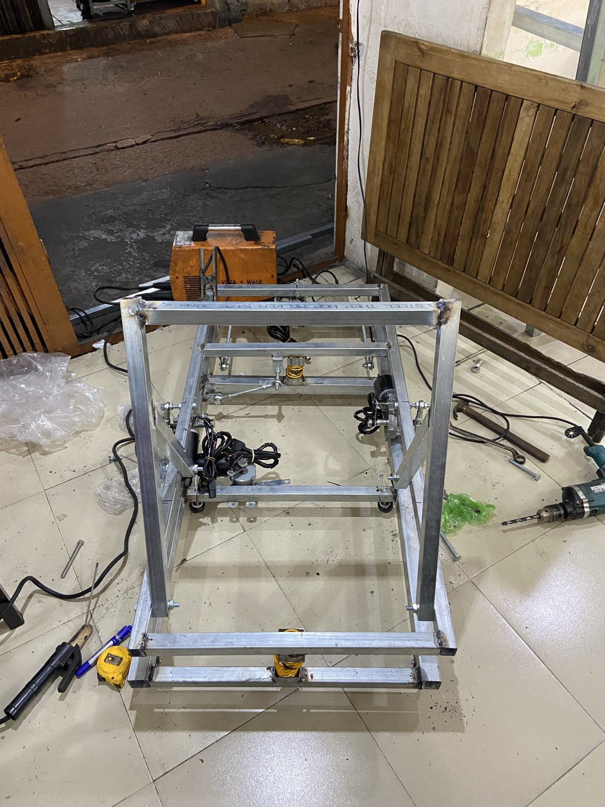

    3- Building the platform ( Surge & Sway/Yaw):

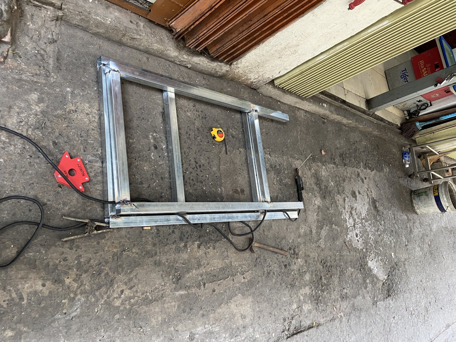

    -Welding by myself, I know it is terrible :grin
    -3 rig, 1 for Sway/Yaw, 1 for Surge
    -Welding wheels for rig

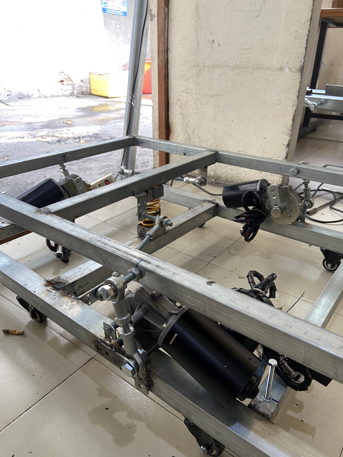

    - 1 motor for Sway/Yaw
    - 1 motor for Sugre
    to be continued ...

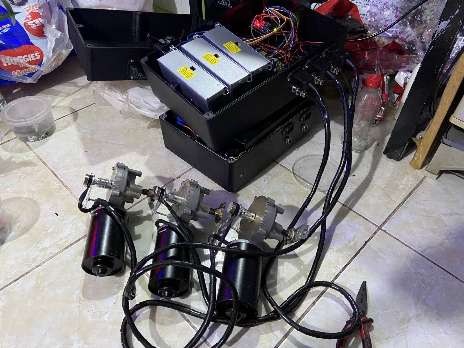

    ***Now I am going to building the Box controller for 3 motor 12v/100w with the rig for seat & wheel drive stand.
    Keep on update ! ***
    Thanks for watching, guys !:thumbs

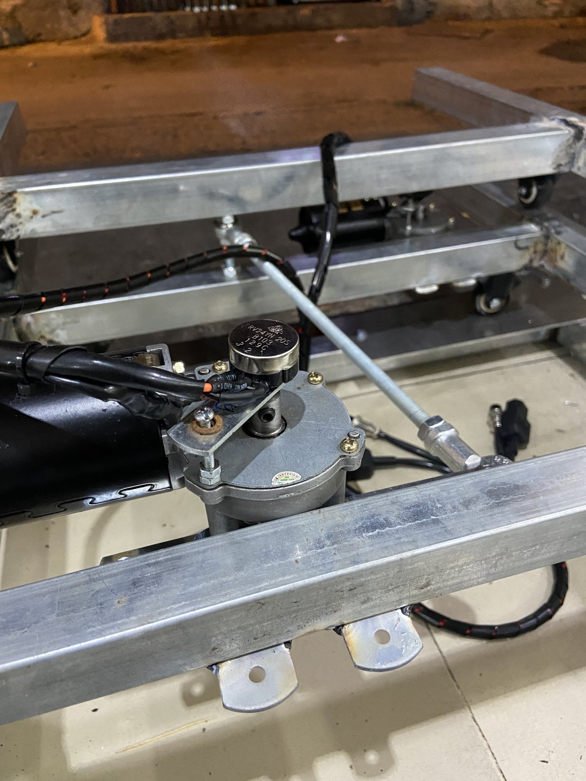

    Great! Can you please upload some pics about the sifical connection between pots and viper motor?
  3. cubizme
    cubizme New Member
    Aug 31, 2011
    12
    17Coins
    +27 / 0 / -0
    DC motor, Arduino
    hello, I will take a picture soon for you. But now I have a simple solution for pots and motor

    Thanks, good idea!!!

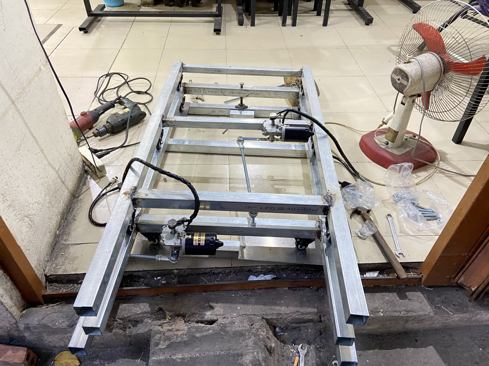

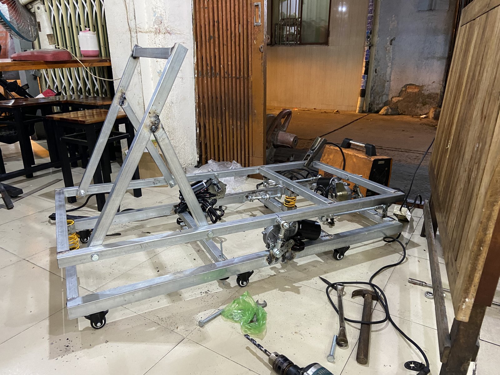

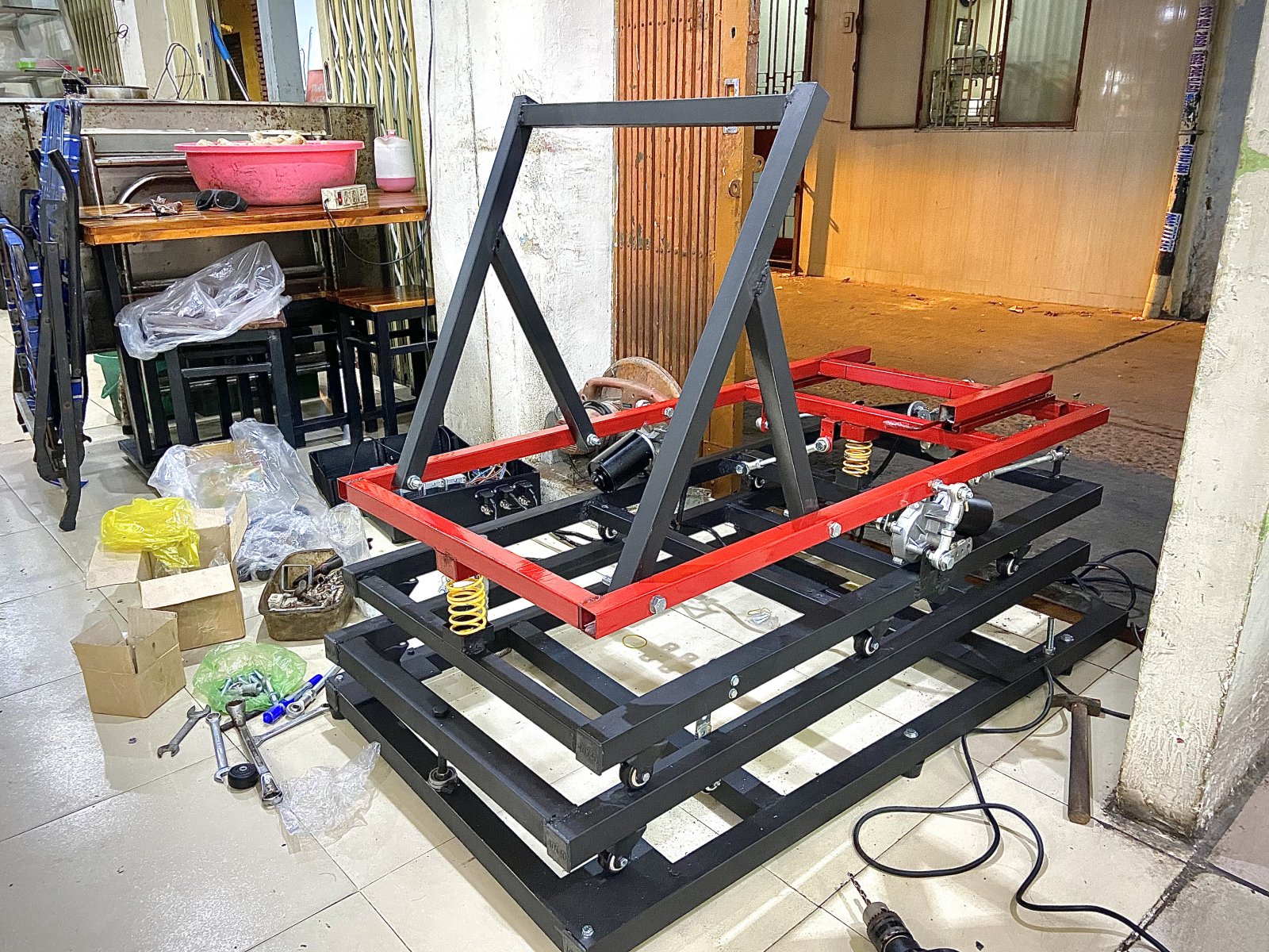

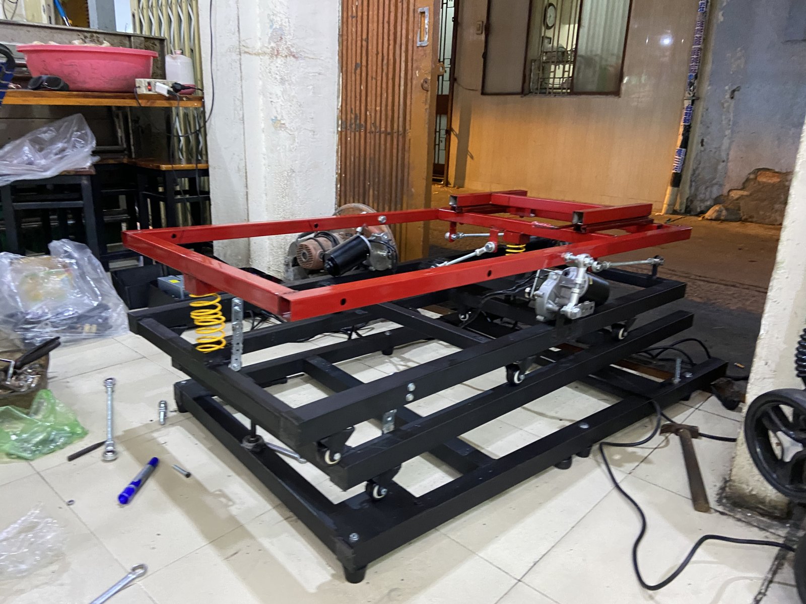

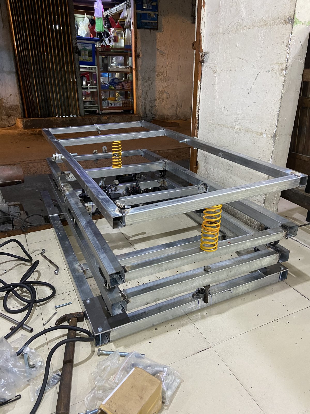

    Update 15/1/2021
    Building platform & Box controller for 3 motor
  6. cfischer
    Sep 7, 2015
    389
    Colorado
    2,783Coins
    +269 / 1 / -0
    Is that metal galvanized? You might get better welds if you etch that crap off with muriatic acid.
    A bit late for that advice now I know.
  7. cubizme
    cubizme New Member
    Aug 31, 2011
    12
    17Coins
    +27 / 0 / -0
    DC motor, Arduino
    I just finish the controller box and 3 wiper motor. Test on simtools everything seem OK.
  8. cubizme
    cubizme New Member
    Aug 31, 2011
    12
    17Coins
    +27 / 0 / -0
    DC motor, Arduino

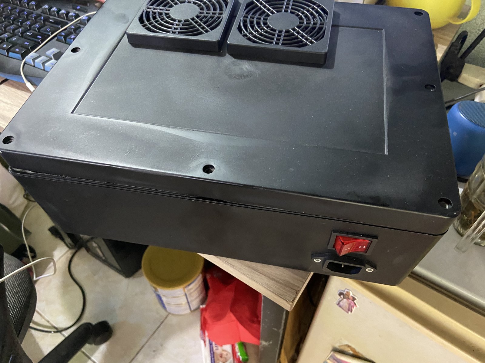

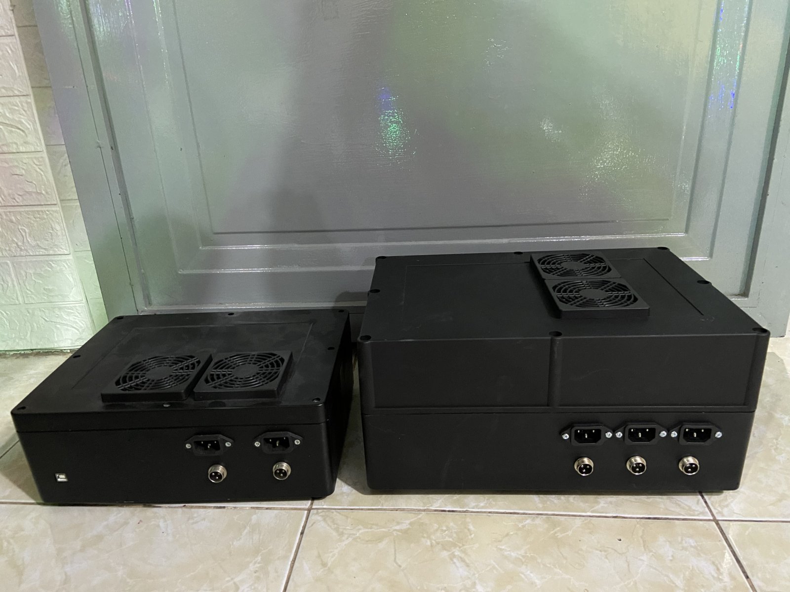

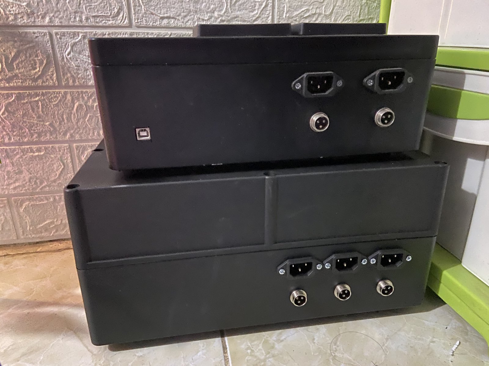

    Bonus : 2 box controller
    FF1FDFA6-F05B-4A29-B9A0-73C3225211D2.jpeg 6DD20DD5-0E1B-4524-983A-9CA0E5920453.jpeg

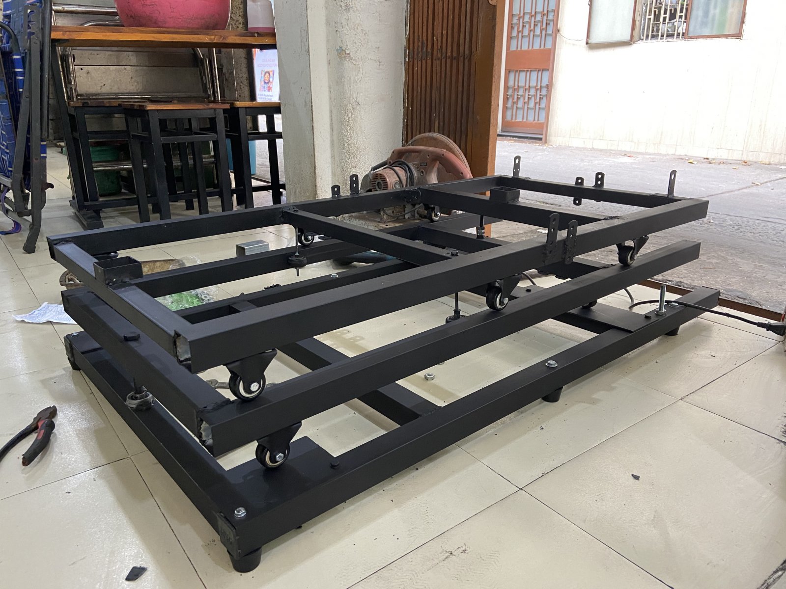

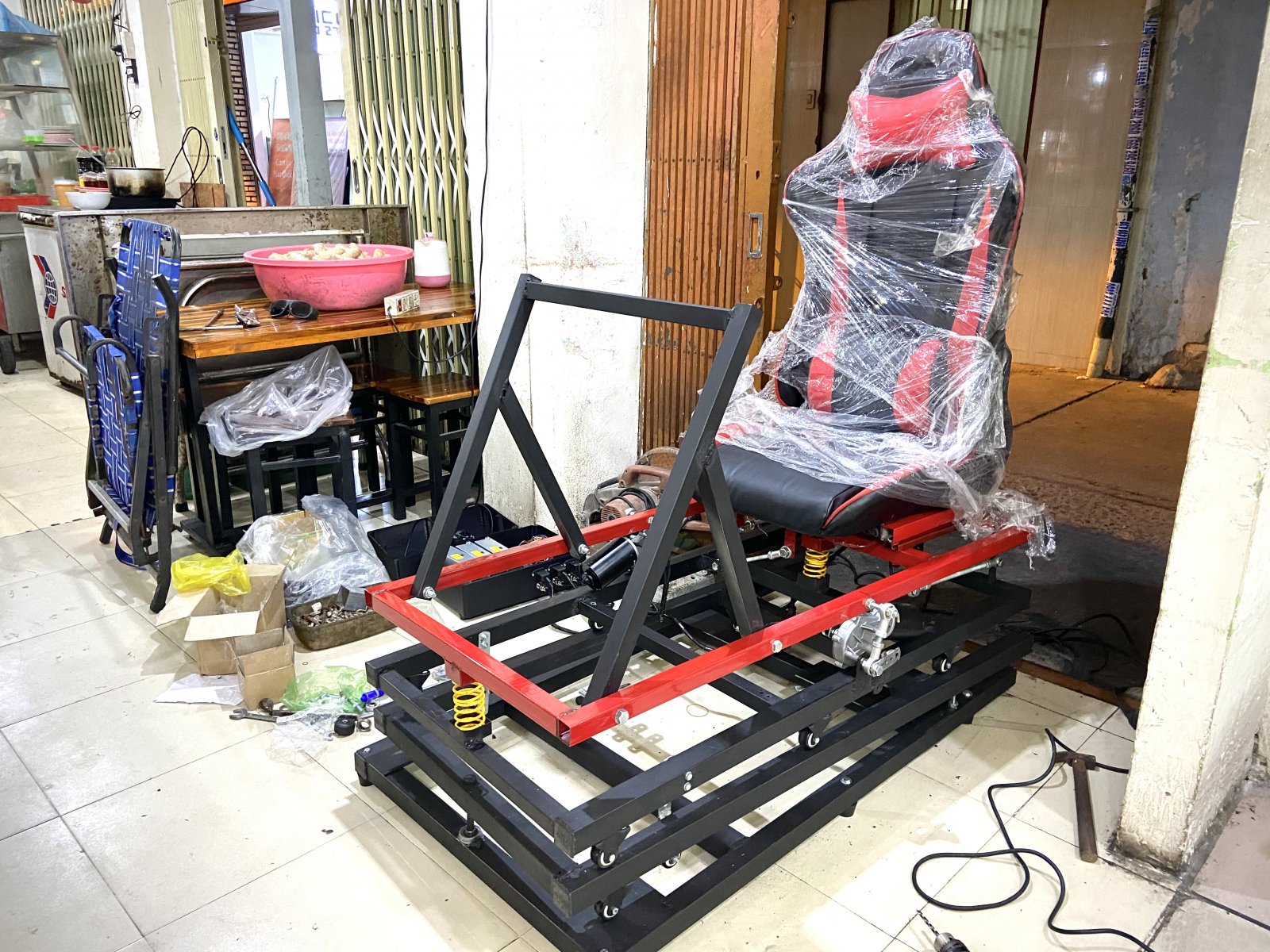

    Update 18/01

    My update 21/01

    hello, my rig almost finish, testing everything is ok, working good. This is my testing video :

    finally, I finished my project with a small change, but It working great, thanks for watching, guys.
