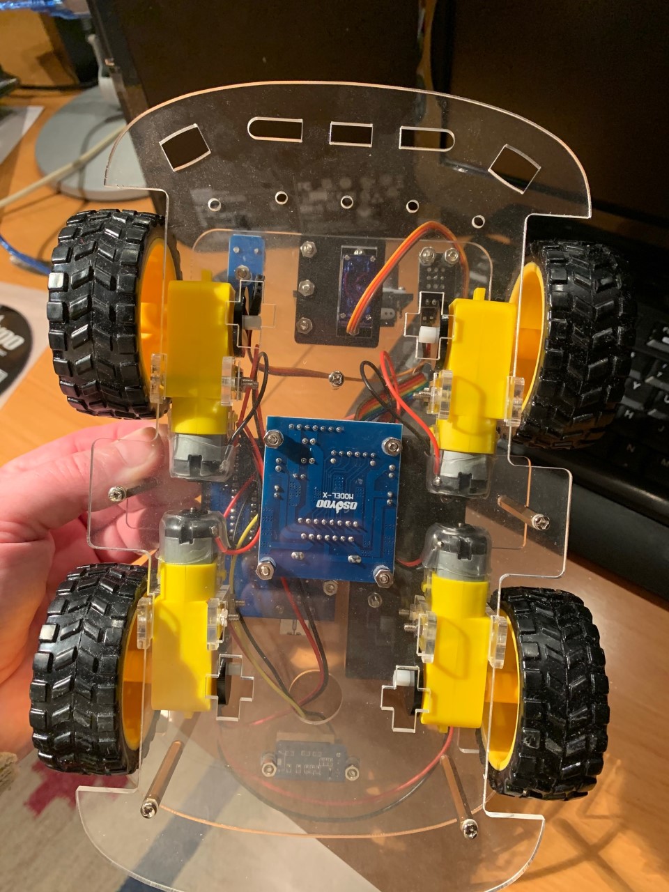

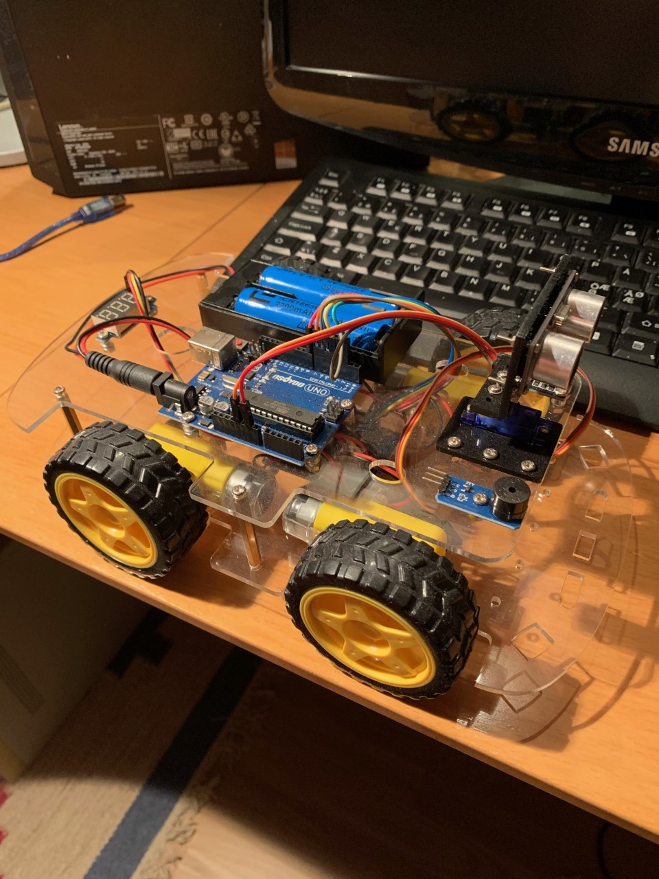

    So here is my Arduino car kit with my Arduino Uno on and a motor controller below.
    now we will try to make each wheel spin on demand from Simtools.
    what we are missing are the feedback to the Arduino af how much the wheel has spun.
    i am not much for a potentiometer as they will be broken fast as far as i know.
    i imagine some sort of encoder should do the trick. so i am trying to find out what kind of signal an encoder would give so i will know what to simulate right now were i do not have the actual encoders.

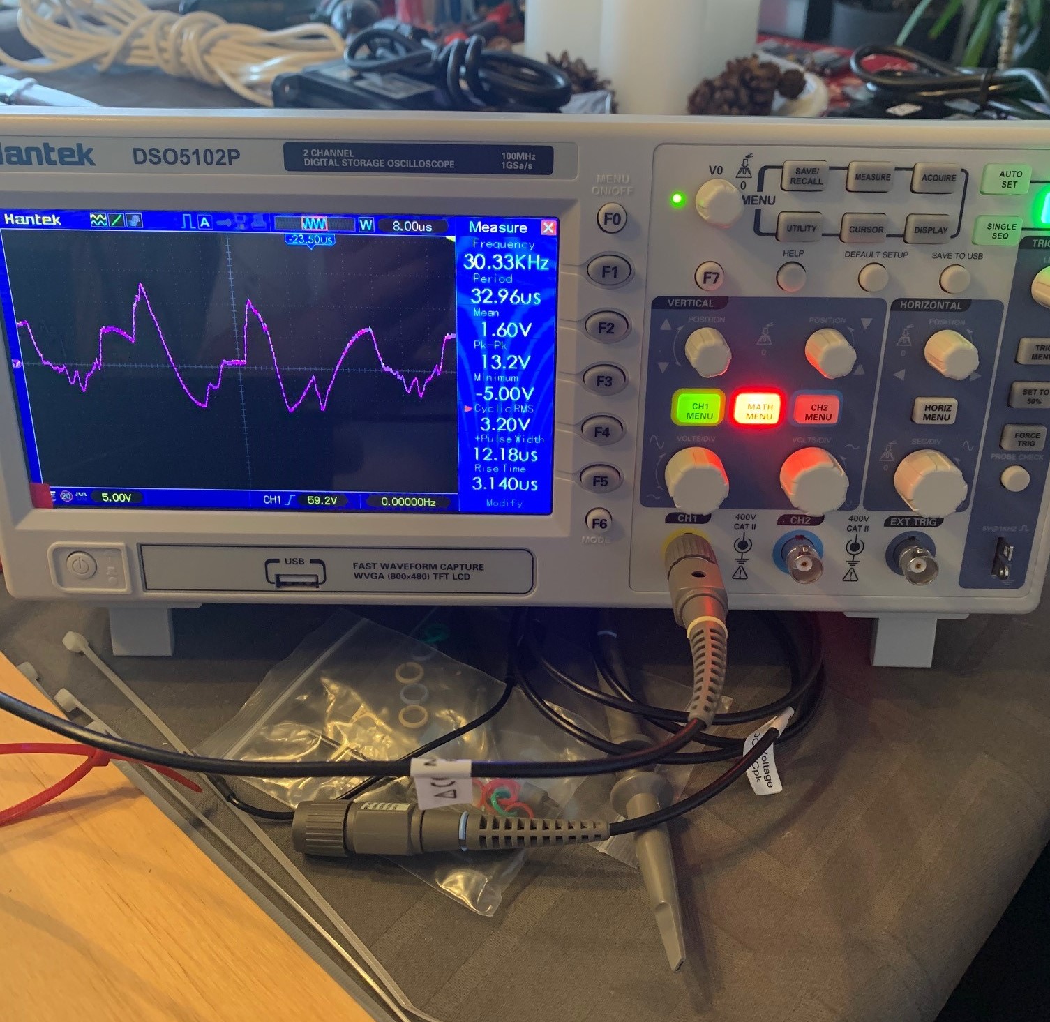

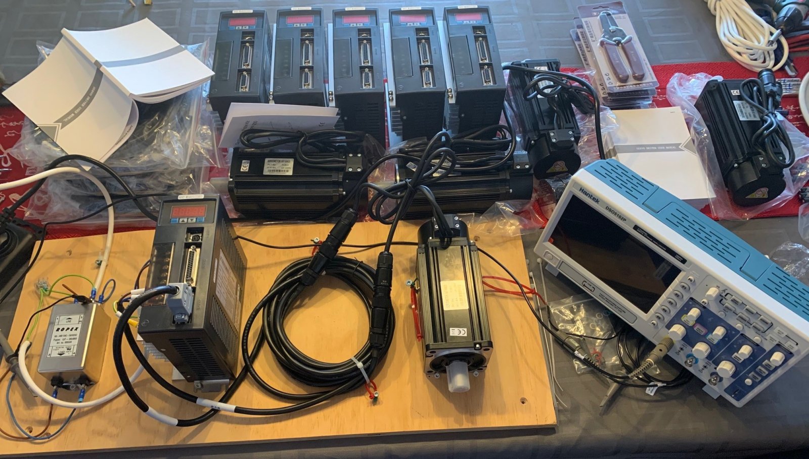

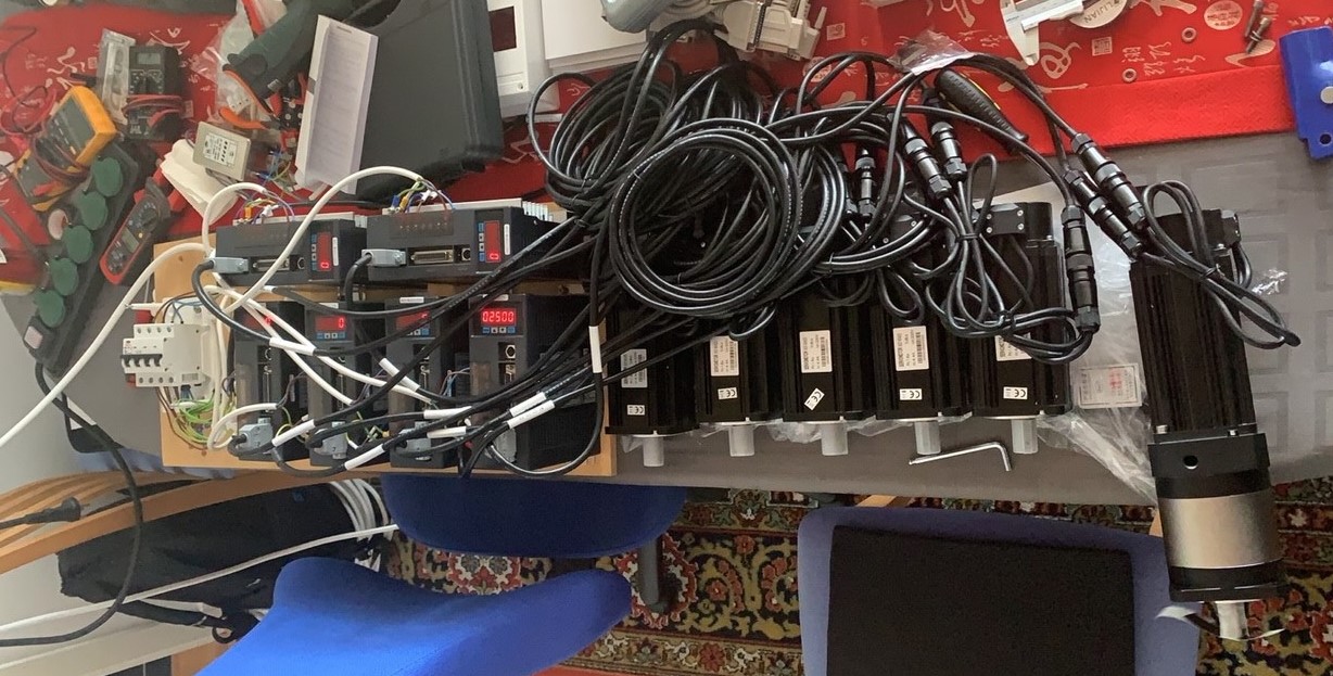

    Hi all again
    some time has past since my last post, but a lot of things has happend :)

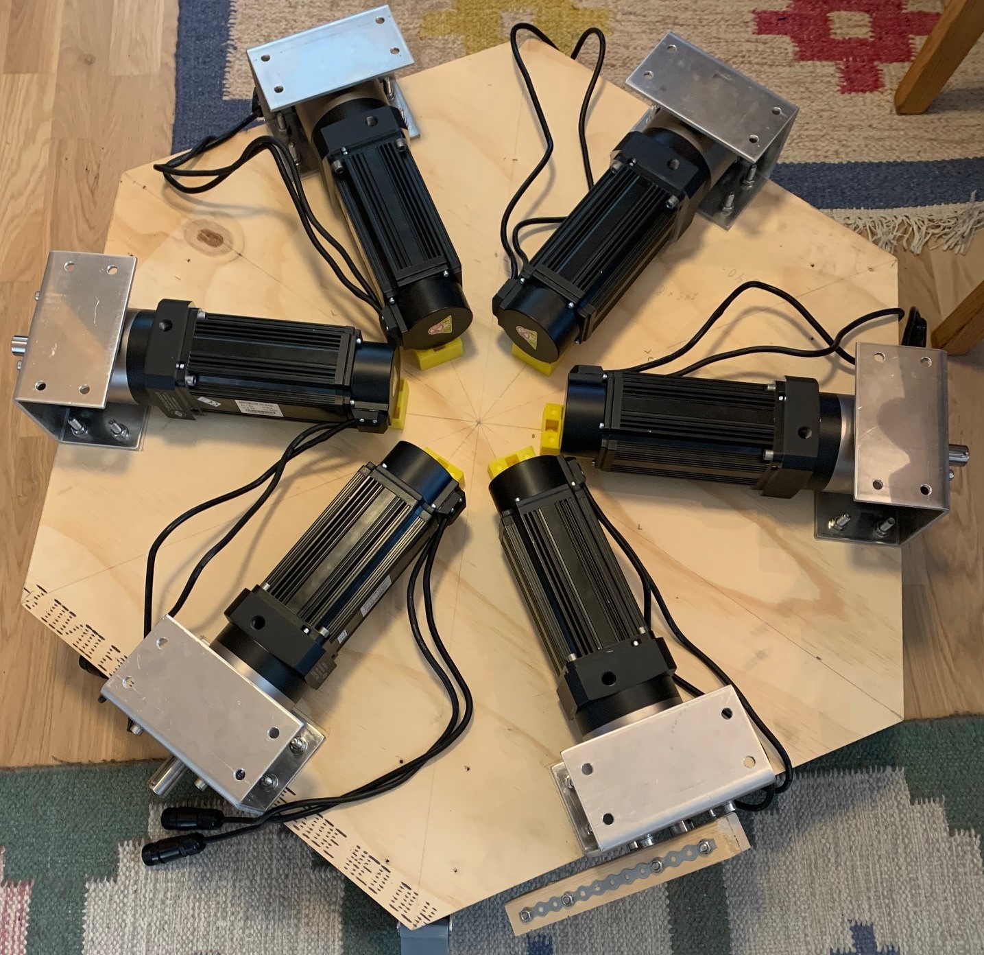

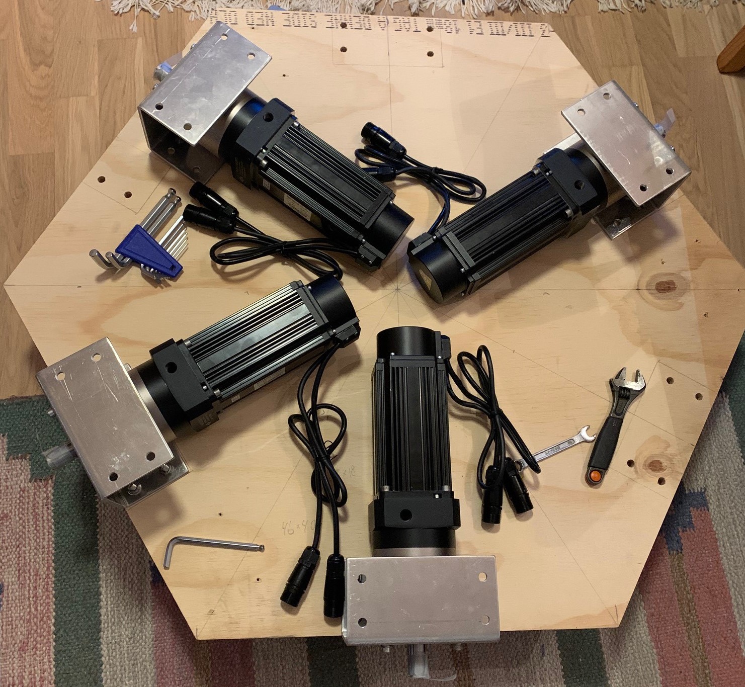

    I decided to go with the AC servo solution. I bought 6 pcs of 80ST-M4025 (220) at a 1000W.
    Hint:
    Be careful when buying stuff from china, i thought i bought 90ST version, as it was next to the 90ST version of the 750W... and it has turned out to be difficult to buy gears for the 80ST size.
    here i am testing them all to see if they work without any bad noises/errors.
  17. Stefan4DOF
    Stefan4DOF New Member Gold Contributor
    Mar 23, 2020
    19
    Engineer
    Denmark
    180Coins
    +13 / 0 / -0
    DC motor, Arduino, 4DOF
    Hi SeatTime
    Thx for you advice.

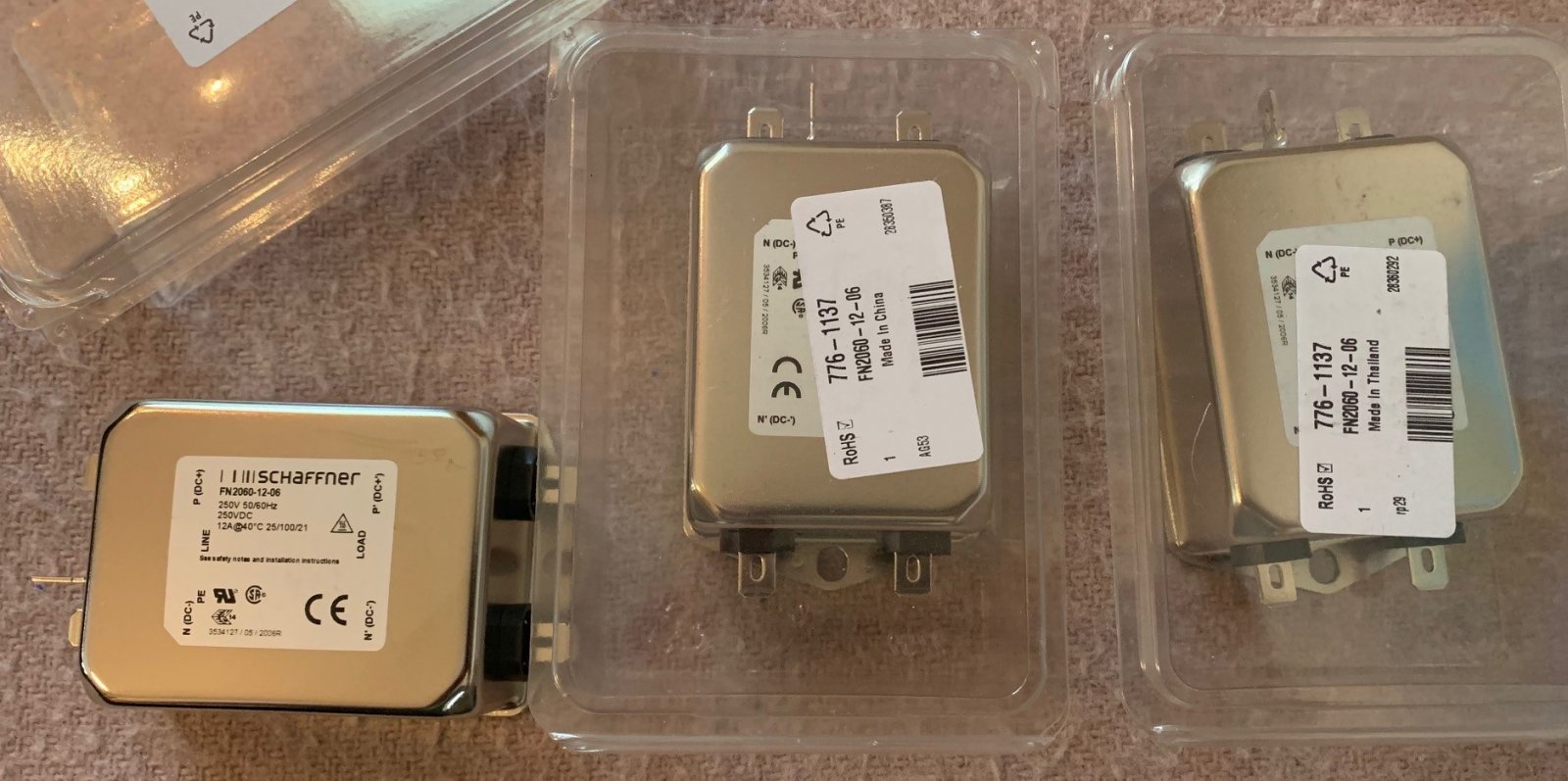

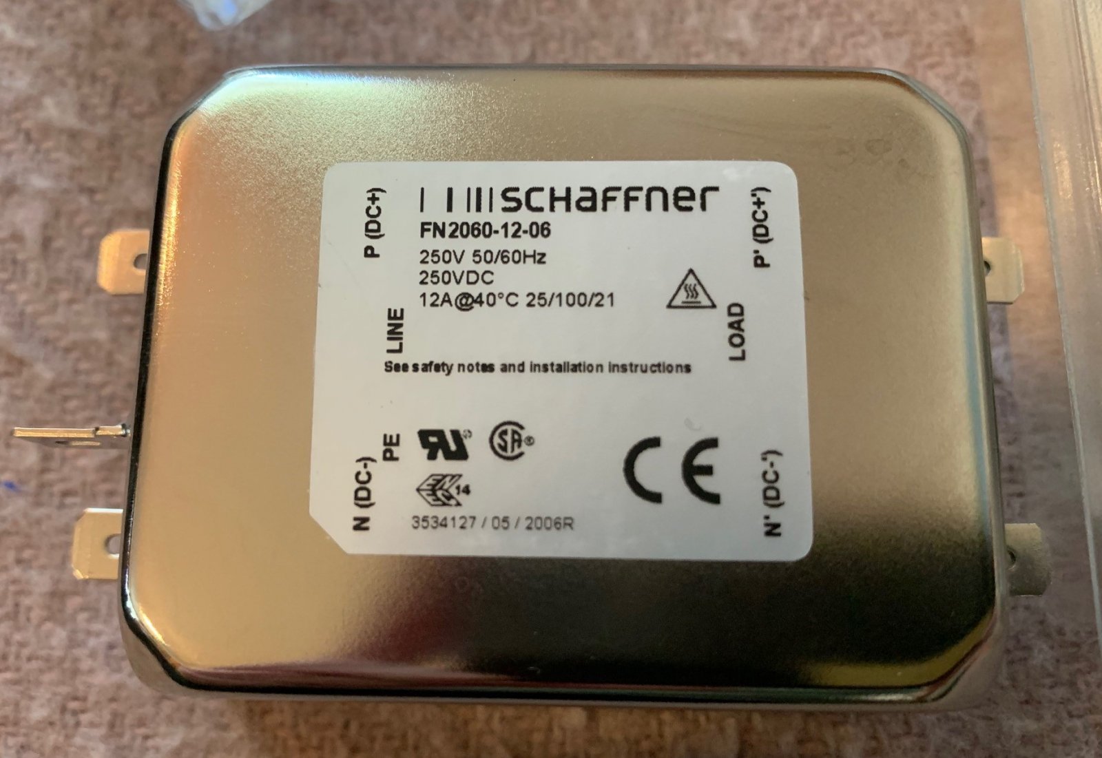

    when i tested the servos i borrowed a filter to put in between the power source and the drive (see post above).
    i also tried without it, and so far it has not given any problems.
    I have also tried to see if i could measure the "noise" but i could not conclude anything for sure of that.
    Just in case something happens i bought 3 filters to install later (2 on each phase). They should be a good quality and they did not cost much. :)

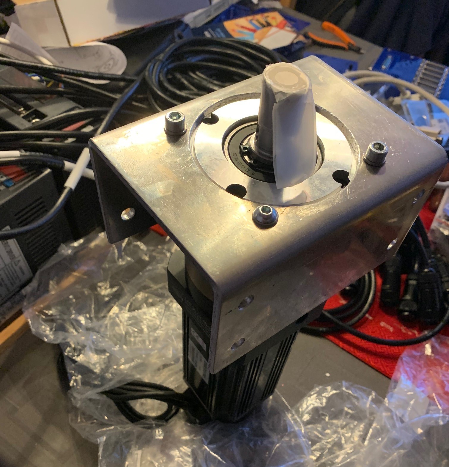

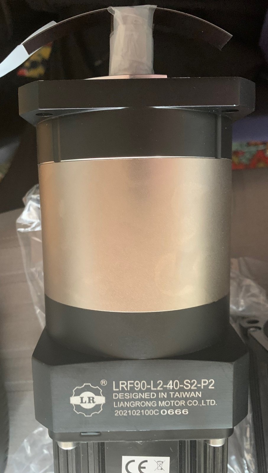

    GEAR

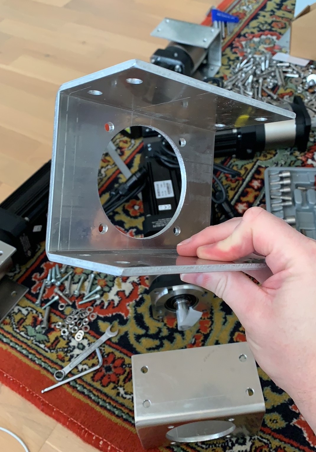

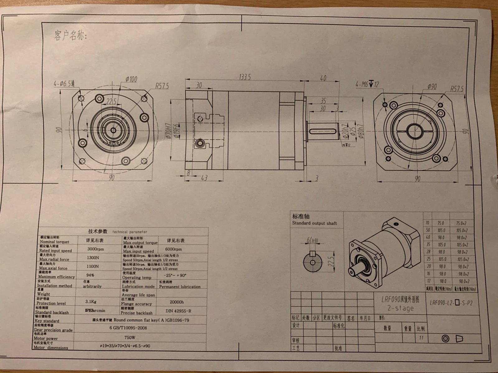

    In my hunt for gears i finally found someone in china that had a lot of different gears, but just not the one i needed. they seemed to be some sort of manufacture, but who knows :)
    anyway i wrote to him what i needed and then he asked me to send a picture of my email address, as i think it is filtered away when writing that on ebay.
    then a few days later he came back with a drawing of the gear he could make to meet my needs.
    Lucky i have a colleague that reads chinese :)
    But it seemed as a straight up drawing, and the price were not bad either. I ordered 6 pcs, payed and.....
    Did not hear much.
    then after 2 weeks i asked when they will be shipped? and they replyed that they were testing them...
    One week later i recieved a tracking number, a week later i recieved them. :)
    i then started testing them on the same motor and 2 of the said some grinding noises a few times, after that i recorded on video the testing of the remaining gears, but when i installed the first 2 gears again later the noises were not there? and i did not get those original noises on video. I can only wait and see what will happen.

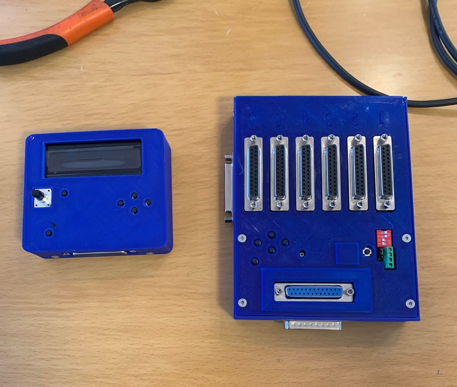

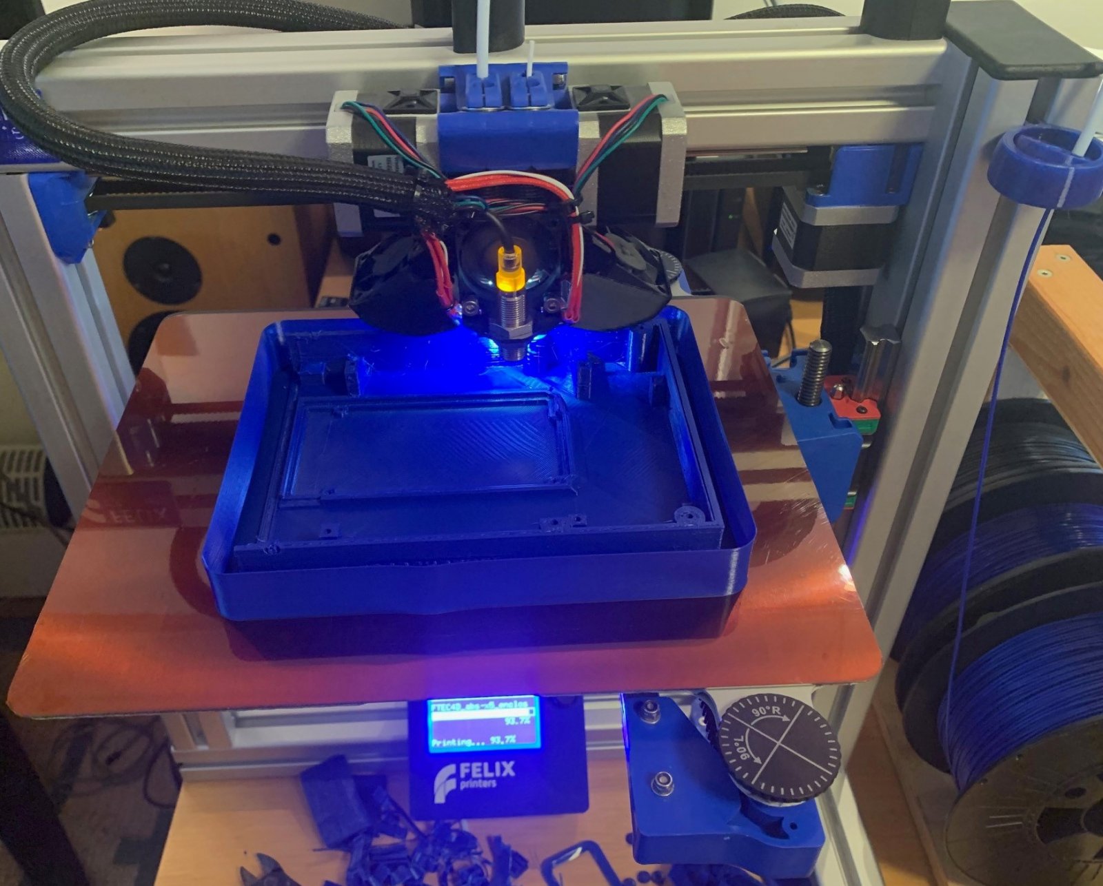

    CONTROLLER
    I bought the Thanos AMC-ASSD-15A solution, as i needed something that would not be too difficult for me to work with.
    I bought the one with remote display and recieved it fast.
    There are files on thingiverse to 3D print the housing, but it is not easy to find the parts for the remote version. and i printed the other set first, until i finally found the right files.

    ASSEMBLY

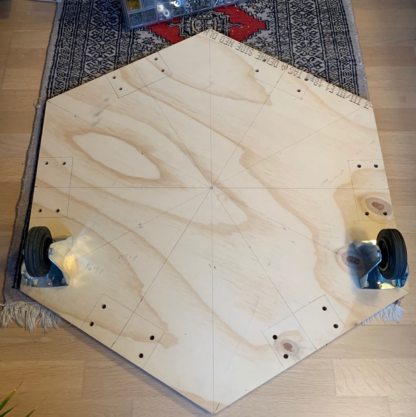

    I am going to make a test setup.
    with wheels..LOL
    I have made some brackets of 5mm aluminium, and are now installing it all.
