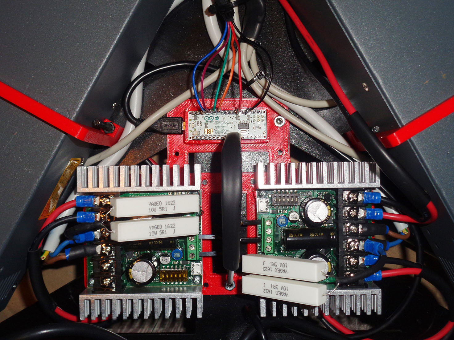

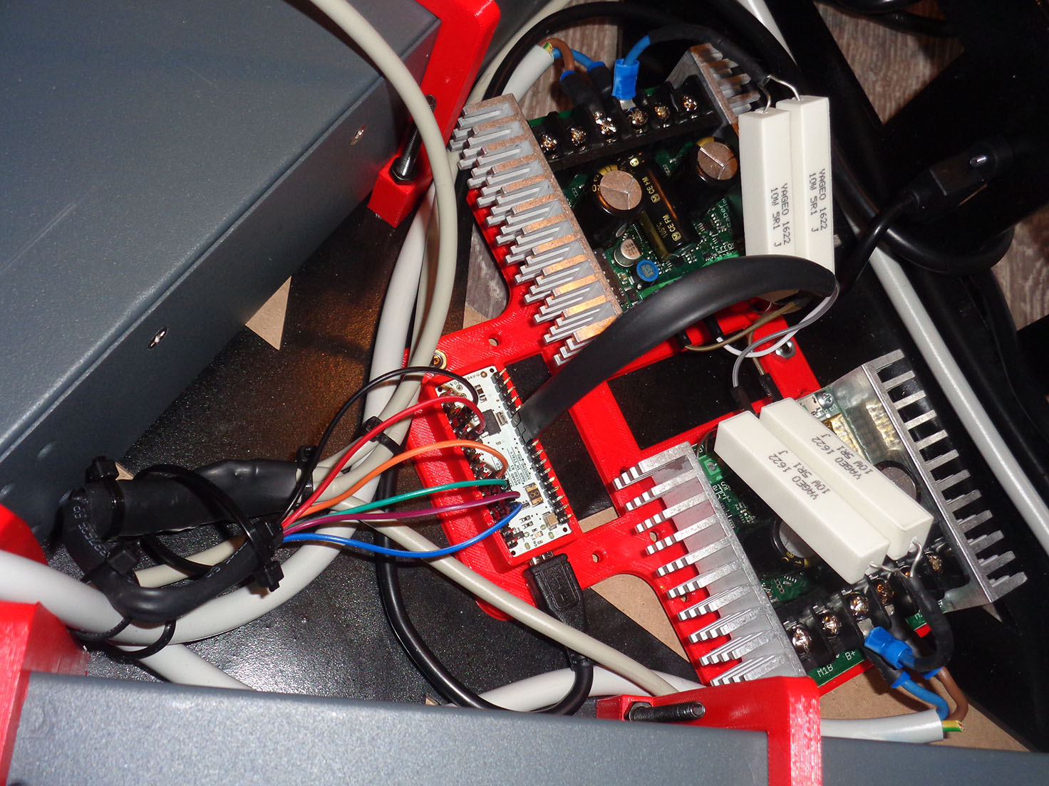

    It looks like they have the kit in stock, so I will be ordering mine on payday. I have looked at your video a few times and notice that you have what looks like resistors attached to your Sabertooths? Can you post pictures of your electronics?

    Yes, those are the resistors that come with the Sabertooth 2x32 to sink the regenerative current.

    +28 / 0 / -0
    What size resistors are you using?

    +63 / 2 / -0
    I'm using the 10W resistors that come with the Sabertooth package. There are 2 resistors in each Sabertooth box, which is enough for each board. Simukit provides installation instructions on their Youtube (French only):
    Note: the resistors must not touch any metallic parts so this is why I've installed them in an "arc" shape. I attached pictures of the electronics.
